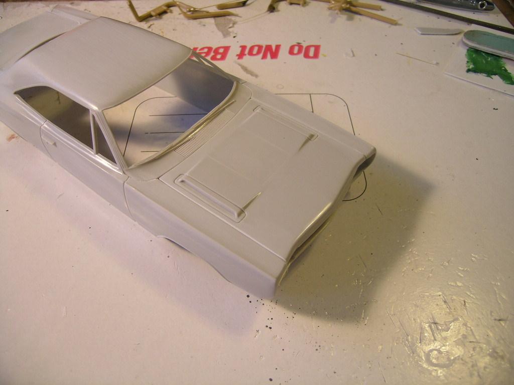

I love the quality of the body molding, very nice indeed. I have discovered a fairly serious problem (to me anyway) with the hood though, and will post photos later today.
Link to post
And here is the aforementioned problem; hood has a substantial gap (around .040 by a quick guesstimate), so I'll need to add .020 strips to both sides of hood to close it up tight. I'll be painting the hood attached (as I'll do with most of my cars), so this gap needs to be resolved before I can proceed.

Wow, that is a pretty big gap. I have built 1 about a year ago and gave it to my nephew which he still has but don't remember this problem. I will look next time I am over there. It's was also the same release as yours. Thanks for posting the picture of the hood as this is how I learn about different things with different kits and really appreciate it. I just got back into modeling a few years ago so I am still learning how to build really good so I might of missed that gap on mine but I'm trying to improve with each kit I build. Again thank you for sharing and I will be watching.    Jeff

I'm just lucky I checked it, Jeff. Normally I would have painted it separate, then added it, if I were fixing up the engine bay guts, but I want the hood firmly anchored in place when I paint/polish on this one.

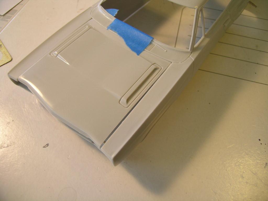

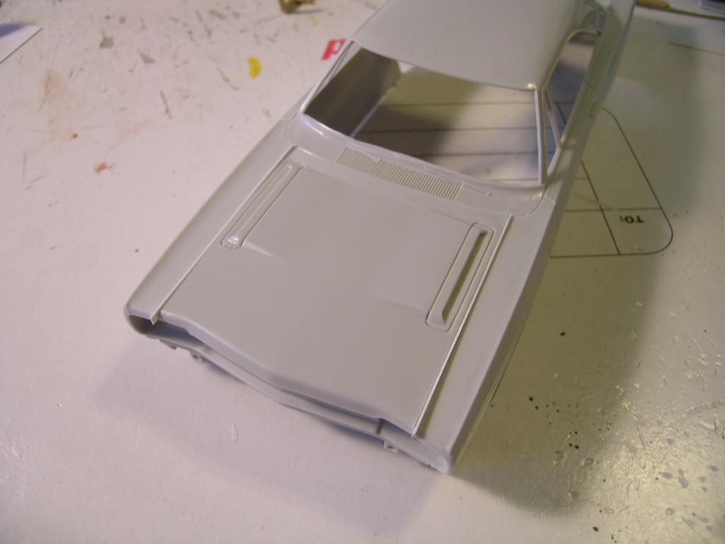

Gap turned out to be closer to .030 (almost exactly), so .015 strips have been glued to hood sides to close that gap. Once dry, I'll trim to size, putty as needed, then secure to body.

Be careful not to get it too tight Kevin.
Be mindful of paint thickness.
I've had a couple of projects give me a little trouble with the hood fitting perfectly before paint & not so much after 3 or 4 color coats & 3 to 5 clear coats.
I make sure now that I leave a bit of a gap to compensate for that.
Steve
