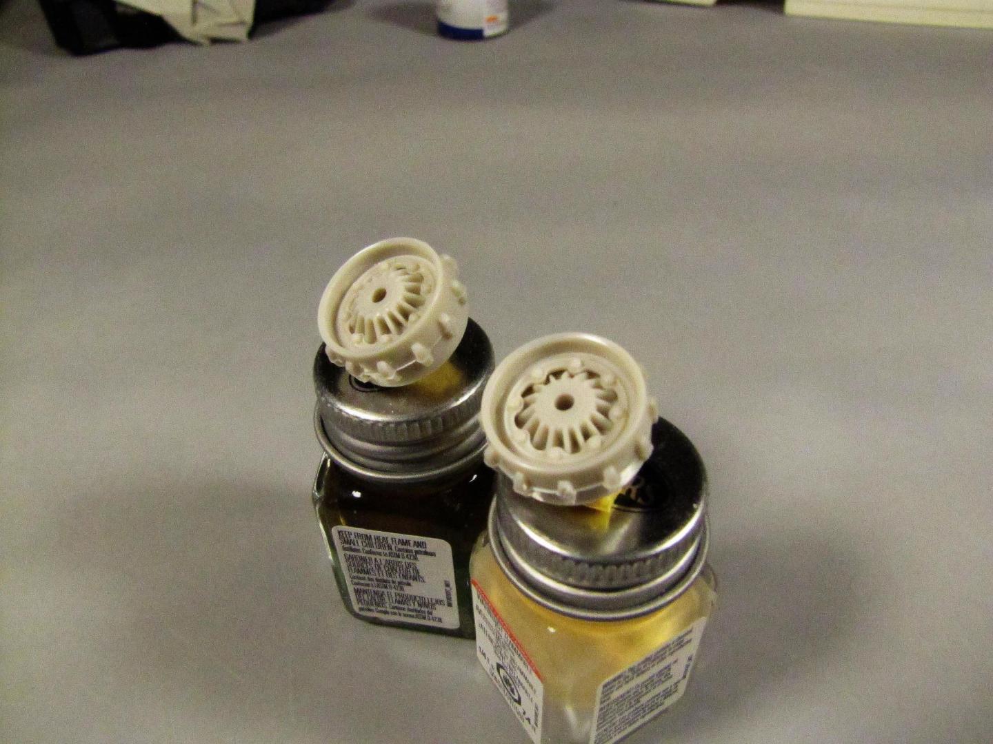

One observation I'm making of the wheels is the drum portion is sitting "too far back" in the rim, if one is to put together the wheels as they are out of the box. Also of note is the instructions (drawing) in the kit are not quite right.
Moebius shows that the wheels-----the brake drums in particular are to go from the outside of the rim, when actually they should go from the inside. Mistakes happen on the cutting room floor, but this is something to keep in mind when looking over the instructions. As you can see pictured here, the drum should be sticking out a scooch further than what's seen here. You can also see where I started to score around the drum to "break free" the lug nuts from the rim.
Pc315498
OK! It took a bit, but you can see here where the lug nut portion of the rim is broken free. My objective here is to thin down this section so that when you place the drum inside this section, it'll be further out into the rim, and more like the 1:1's that feature these wheels.

Here are the parts laid out before I began to piece everything back together. I did take some 600 grit sandpaper, and thinned out the "fins" on the brake drum ever so slightly. They could have stood to be a bit thinner when molded, but I can understand the molding process and how the manufacturer would not want these to be but so thin due to the fragility of these fins.
Pc315499
Here is the brake drum placed back inside the lug nuts section...........
PC315502
Here is the beauty ring placed inside the rim. Later on when I get around to building this fully, I'll add a couple plastic .005" steps or stops inside the rims as a positive location for the beauty rings.
PC315504
And here they are with everything placed back together..............
Pc315505
Pc315506
Note how the brake drum is further out from the rim than it was before. Further detail painting of the whole works should enhance the niceness of these wheels even more!
Pc315508
Now mounted in the tire. I have to give Moebius a lot of credit in making these wheels the way they did. These eight lugs have been done by other kit makers before, but not to the degree that's been done by Moebius. Manufacturing compromises have to be made to ease the process, but I'm of the mind that each part of a model kit has to be treated as a kit in itself.
These wheels are no exception and the extra time and care taken to make them appear correct will be highly worth it.
