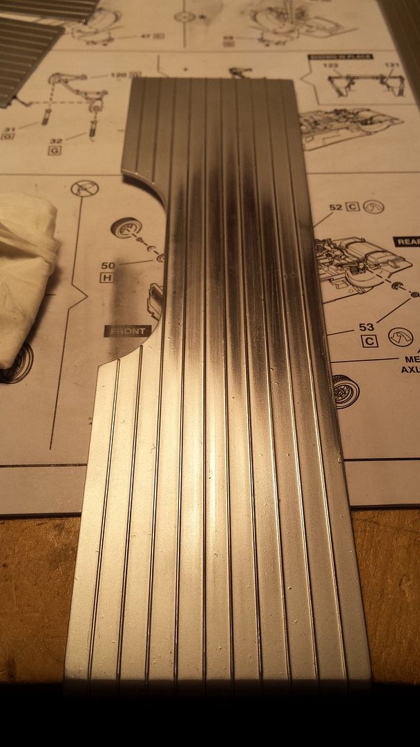

Painted some panels with model masters/testors aluminum plate metalizer (spray can) and let it dry for about 2 days and then tried to buff it... MAN what a pain in the butt!! I am using a paper towel as that's the only thing I've found that will really do anything. I've buffed for quite a while, and the only way I can get it to start changing is if I push down hard, and go fast to create friction/heat.
Were my spray coats too wet? Should I respray and just dust it?
Can I use an aluminum polish?
At the rate I'm going I wouldn't be done by next month and I'll probably break the parts doing it!

I tried a microfiber towel at first and couldnt put enough friction to it because of that. So then I switched to a paper towel and started getting results. But there's a fine line between too much and not enough... and it's very tiring and gets rather warm! I'll post a picture... just a sec.

You should be able to buff out that part in about 2 minutes.
Something is obviously amiss.
make sure you used the correct "Buffing Metalizer".
If not, get some & go right over the top of it & try again.
I've never had this sort of problem with metalizer paints either.
usually it will come off right on your fingers just from regular handling.

I tried bmf... and it looked great until the panel bowed in (since the ends are curved ) which it then became wrinkle city and I wasteda half sheet of bmf.
I said forget it and took my red scuff pad gently to it and now it as a brushed aluminum effect. Good enough.... not going thru that again any time soon. And yes, everyone, it was a buffing metalizer
