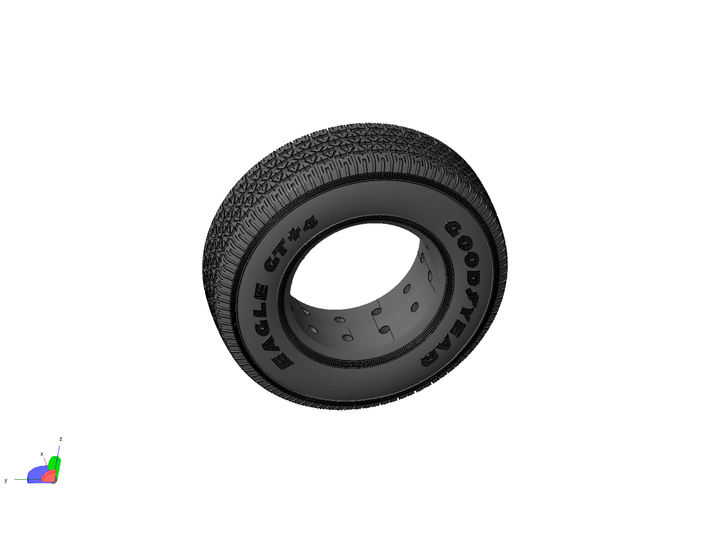

Greg Wann Posted April 9, 2018 Posted April 9, 2018 Joseph is making and sending four tires. I sent him a set of the wheels I made and he sized them accordingly. He does really nice work. I will attempt to make tires on my own. Hopefully it will be a success.
