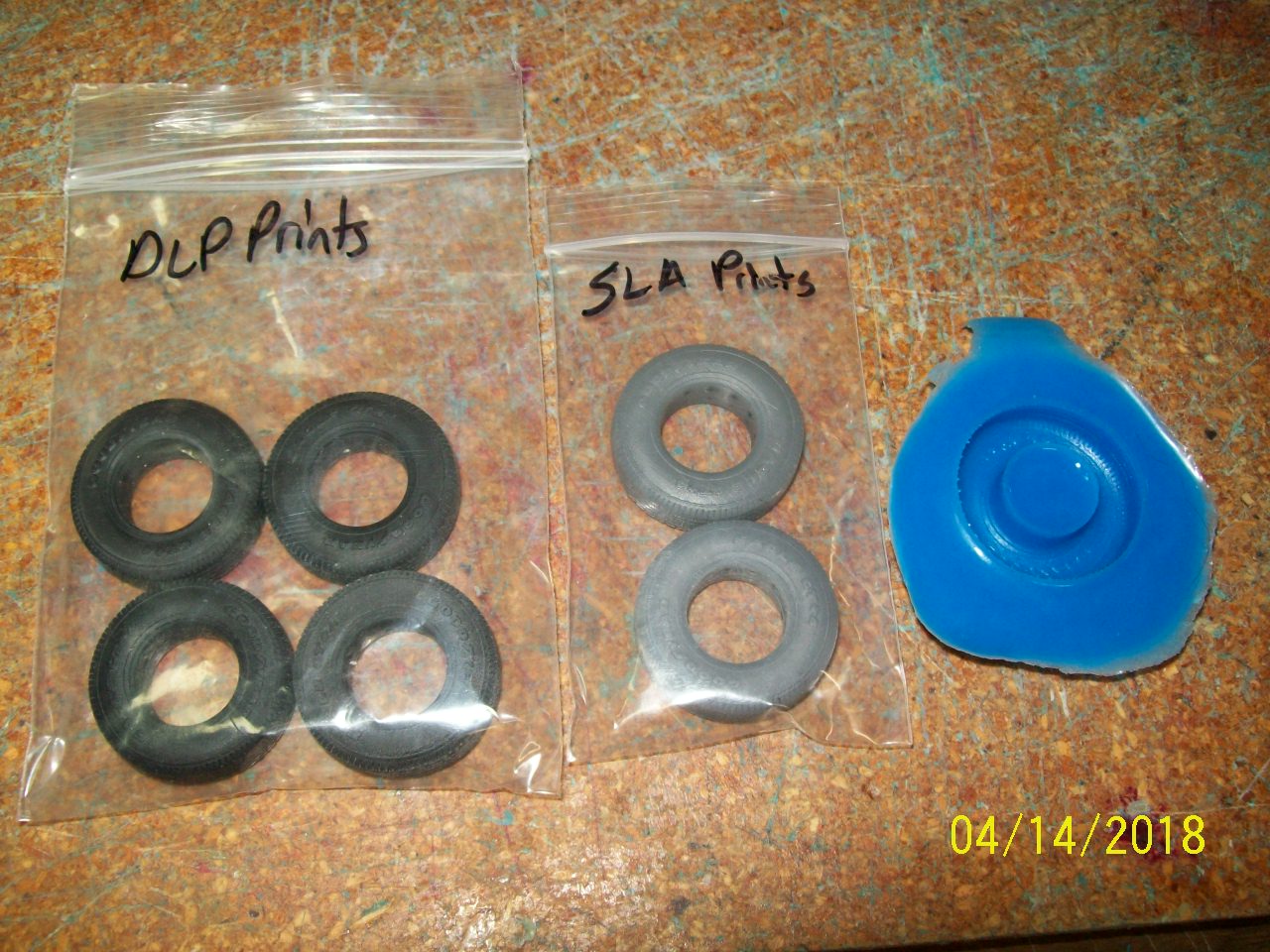

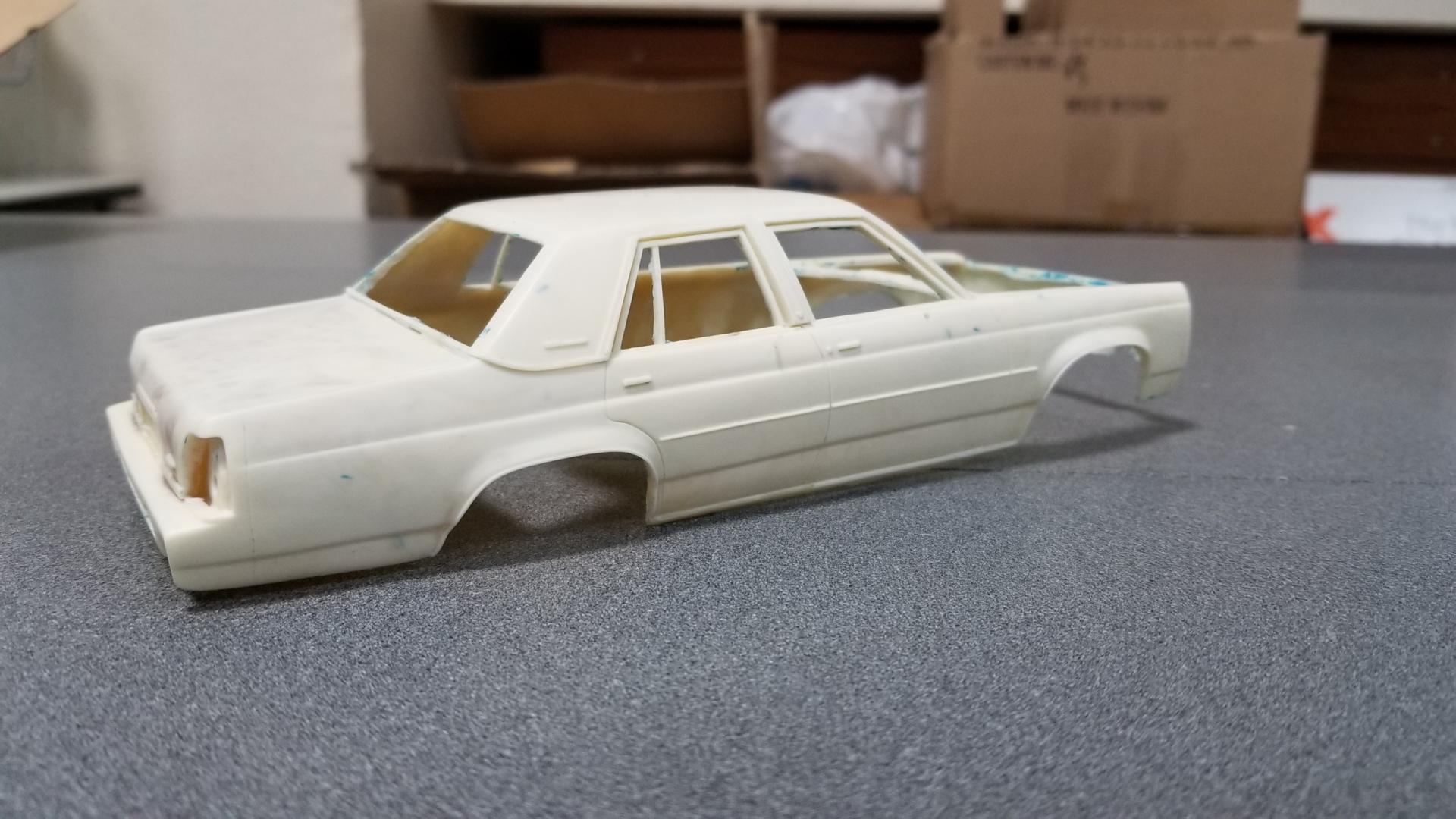

Greg Wann Posted April 15, 2018 Posted April 15, 2018 (edited) https://www.aeromarineproducts.com/ https://www.polytek.com/products/pt-flex-60-liquid-rubber https://www.reynoldsam.com/product/mold-star/ Here is the most damage the master suffered from being removed from the mold. It could have been worse. Here are the tires that Joseph made. This is going to be a PITA. Incompatible material issues can be a real problem. I only paid Joseph $45.00 to do the drawing work and making these tires for me. I thought this kind of work was going be more costly. He hand wrote a note that these tire materials could only be copied in silicone that is tin based. I purchased a half gallon kit of silicone that I thought was tin based but turned out to be a platinum silicone. I typically use the Mold Star 30 for mold making and I intend to make tires out of the Polytek material with some black dye added. SO.......I mixed up some material and the best I have for a match is the Mold Star 30 with the two SLA printed tires. Nothing I have liked the DLP material. I am in hopes of taking one tire and making a mold out of the 30, pull four good tires out of the resin I use and then create a good mold out of the Aeromarine 128. I don't think the Polytek likes the 30 material. Hopefully I can make these in a bright white resin like Joseph does and then they can be painted black so that the lettering can be sanded to create a white letter version. It's all about getting the materials to like one another. Edited April 15, 2018 by Greg Wann

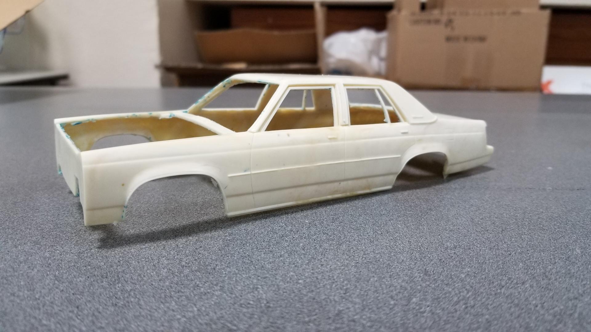

Maindrian Pace Posted April 15, 2018 Posted April 15, 2018 That break's not too bad, an easy fix. The body caused a good stir among the builders who saw it today. As an added bit of Master Caster theater, Greg de-molded body #1 in front of everyone for the first time, not knowing what it looked like anymore than anyone else did. It looked fine. Was there any question?

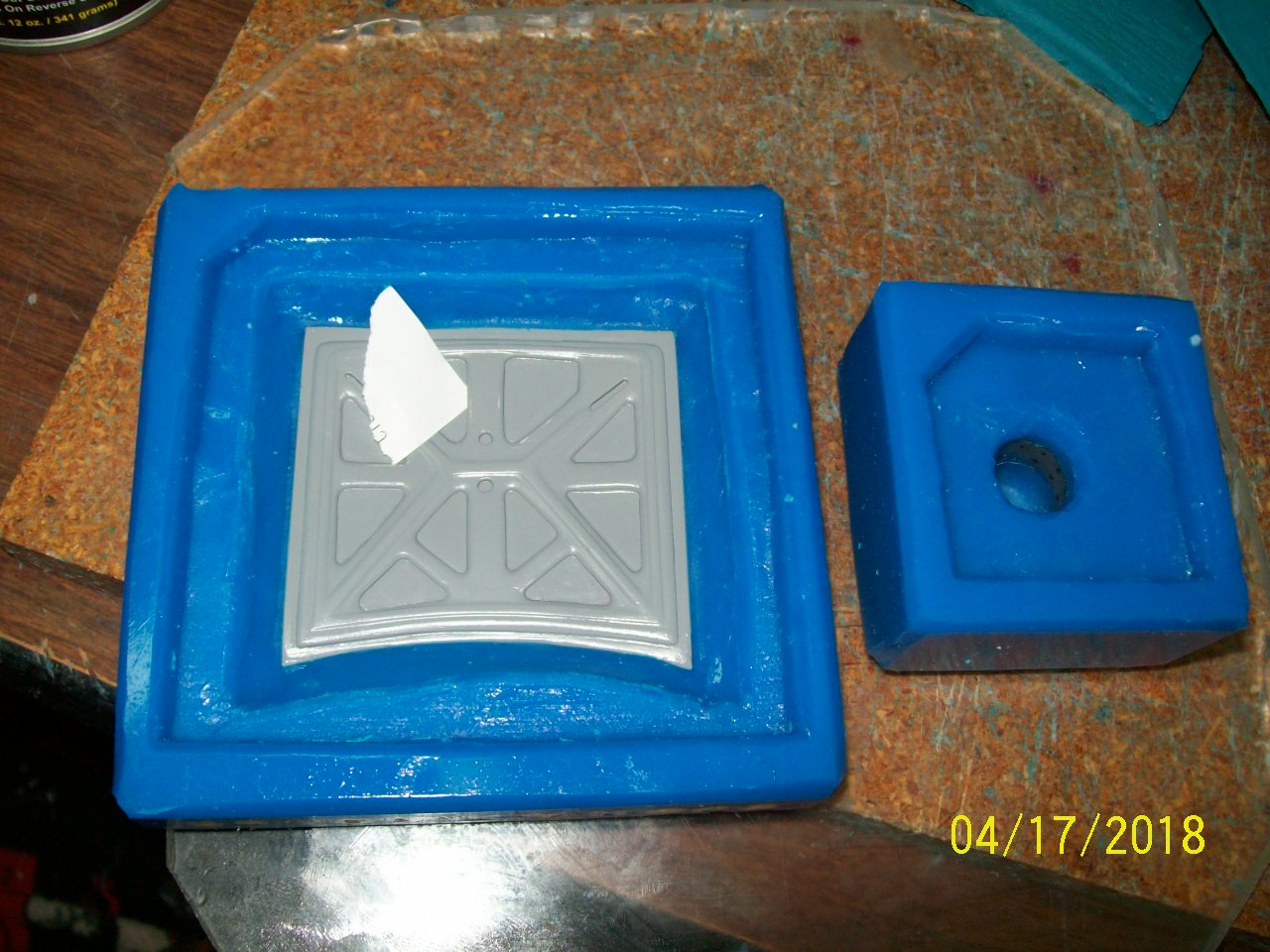

Greg Wann Posted April 15, 2018 Posted April 15, 2018 (edited) OK.....so once the mold has completely cured and taken apart and the master removed my fluid management venting system is installed. First I will point out that I had to trim the corners down to make it fit in the pot. Holes in the mold are easily made by simply taking a piece of K&S tubing and sharpening it on it's inside diameter. Place the tubes end where you want to make a hole. Firmly grip the mold in the area and push the tube in and give it a little twist while pushing. Careful as you go as you could get a core sample of your finger. It won't tickle either. Next photo is of the pressure pot. It is a converted 6 quart pressure cooker. The black round thing acts as a muffler as the sound of air pressure being released from the pot is quite loud and this will quiet it a good bit. Next photo is the holes get cut open to make the flash easy to break away for removal. The last photo is of the wedged shaped holes I cut in the mold these align with the holes in the plug. In the first photo is the sheet metal the mold gets cradled in as the resin is curing. This makes the sides nice and tight against the inner plug. As you will soon see, the flash in the window openings will be very thin. The dimples I create with the knife handle keeps the mold parts locked together firmly. I mixed and poured 80 milliliter of SMOOTH - ON TASK 8 resin into the mold. I then pick the mold up and tilt it around to cover the inner surface of the mold. I tilt the mold up to allow the resin to pool into the rear end portion of the cars area and work the end in first. This will force the resin to work it's way to the front of the body. Once the plug is in it gets set in the sheet metal. The sides get pushed together forcing resin up through the holes filling the trough that I cut in. It becomes a sort of well of extra resin. Since I don't really know what happens under 65 PSI, it all seems to work pretty well for me. If only I could actually patent it. If you are going to try to make bodies you can refrigerate the resin. It will give you about two more minutes of work time or potlife, but your casting will take longer to fully cure. Lots of patience is a must! This pressure pot is a PRESTO 6 Quart. This lid sealing design is important. This is the best one. If you are shopping a Goodwill or other store or garage sale and find one of this design of any size you should buy it. Edited April 15, 2018 by Greg Wann
Greg Wann Posted April 15, 2018 Posted April 15, 2018 (edited) OK....So I made this partial mold out of the 30 silicone. I mixed and poured some of the flex 60 in without any dye. The two materials seem to like one another. I made another one and added some black dye. I may have added way too much dye and it may take a long time to cure. Edited April 15, 2018 by Greg Wann

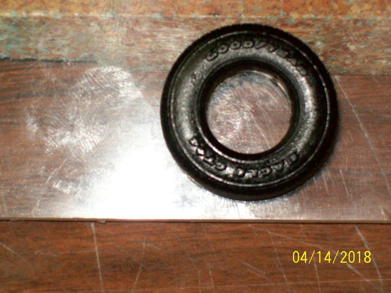

Greg Wann Posted April 15, 2018 Posted April 15, 2018 Here are photos of the second body. So I cut those little V shapes in the mold. These break away and don't really effect the body. I made these tires with a little bit of black dye. So far, so good.
MrObsessive Posted April 15, 2018 Posted April 15, 2018 Greg, I swear that looks just like it came out of a plastic mold it looks so good! I can remember when these cars were new, and never gave them a second look (unless being pulled over by the local police! ), but I'm very seriously thinking about getting one of these, just to simply build it factory stock. Ain't it funny how time can change your perspective on things?? I had to chuckle at this pic! From the future of 2043?? I'll be in my early 80's at that point and I'm not so sure I'll be building models then!

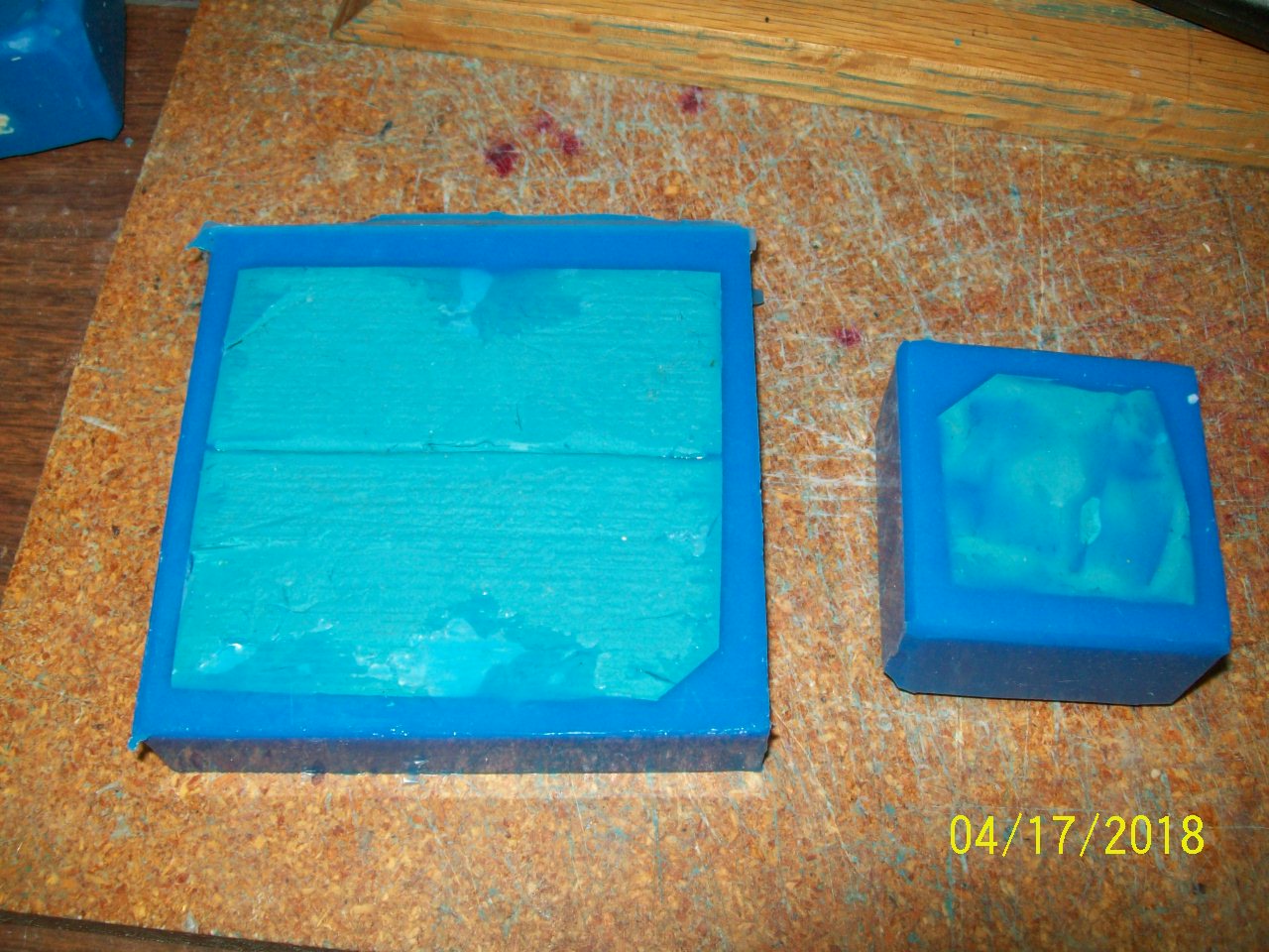

Greg Wann Posted April 17, 2018 Posted April 17, 2018 Here is the underside of the hood mold and tire mold. I trim away unwanted silicone edges. The GE silicone II I use to seal the mold box is not compatible with the MS30. The 30 will not fully cure when it is against the GE stuff making it goopy to touch so I cut it away. The clay I use is KLEAN KLAY. The clay is removed from the underside of the hood. There is a tire in the mold. I see trouble with the hood. Mike added this amazing detail but there are a couple of areas that are not GOOT N' TIGHT. The corner of the paper slides under the added piece. I will force some clay in these cracks and then continue with pouring silicone in. The tire has about a 1/4 inch of silicone over it. Peteski: I have pondered the question and I have an answer. This might not be a bad idea for most parts. I don't think it is a good idea for bodies. Here is why. Silicone is pretty heavy. Once silicone is poured in to the mold to form the male part, it would be too easy for the sides to be pushed away from the sides of the mold that first formed the outer sides The silicone would settle into the area making a bad mold. It could probably be better worded. Here is another explanation. Once the outer mold of the body is finished, great care is needed when removing the clay from within the master body. It is important to not pull the sides of the silicone from the sides of the master body. silicone can actually seep between to master body and the already cured molds side. This creates a "ghost layer" of silicone. It's a term I made up. When the first resin body is pulled from the mold you will look on the body for this ghost layer. On the body, it will appear as removed resin. Take a pencil eraser and attempt to peel it out. It might loosen on it's own after three or four pours as resin can reach 160 degrees in heat. Careful not to scratch the mold.

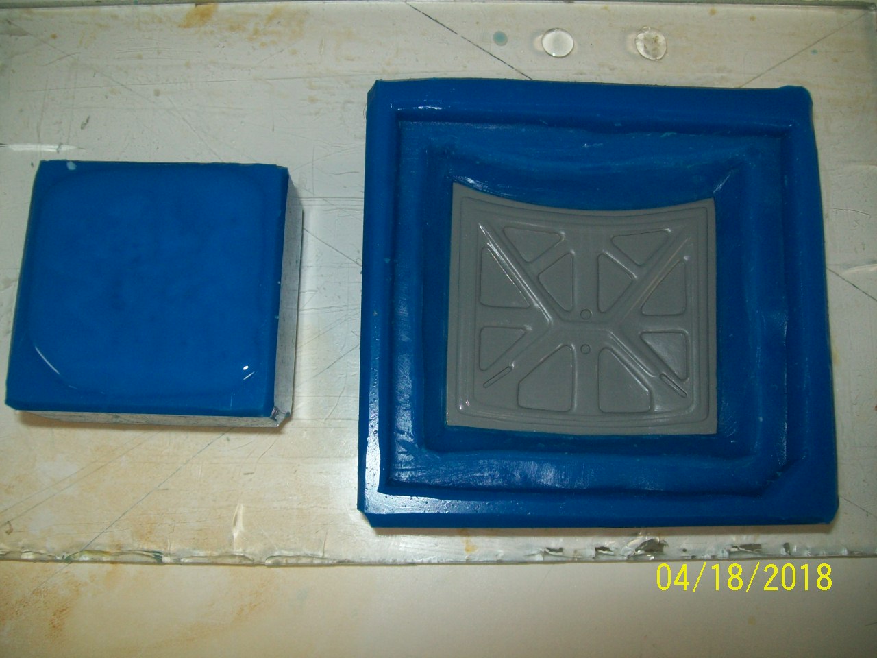

Greg Wann Posted April 18, 2018 Posted April 18, 2018 Here is the tire mold filled with silicone. I wanted this to set a good while before adding it. I suggested to Mike that we might add a texture under the hood that could duplicate the roughness of insulation in those areas by using sand paper. I suggested using his original stencil to draw an outline of the openings on the back side. Then I would cut them out and glue them to paper. Then I would pour silicone over the parts. I might be able to create these sections to their perfect size and then glue them down in the hood and then finish the mold.
