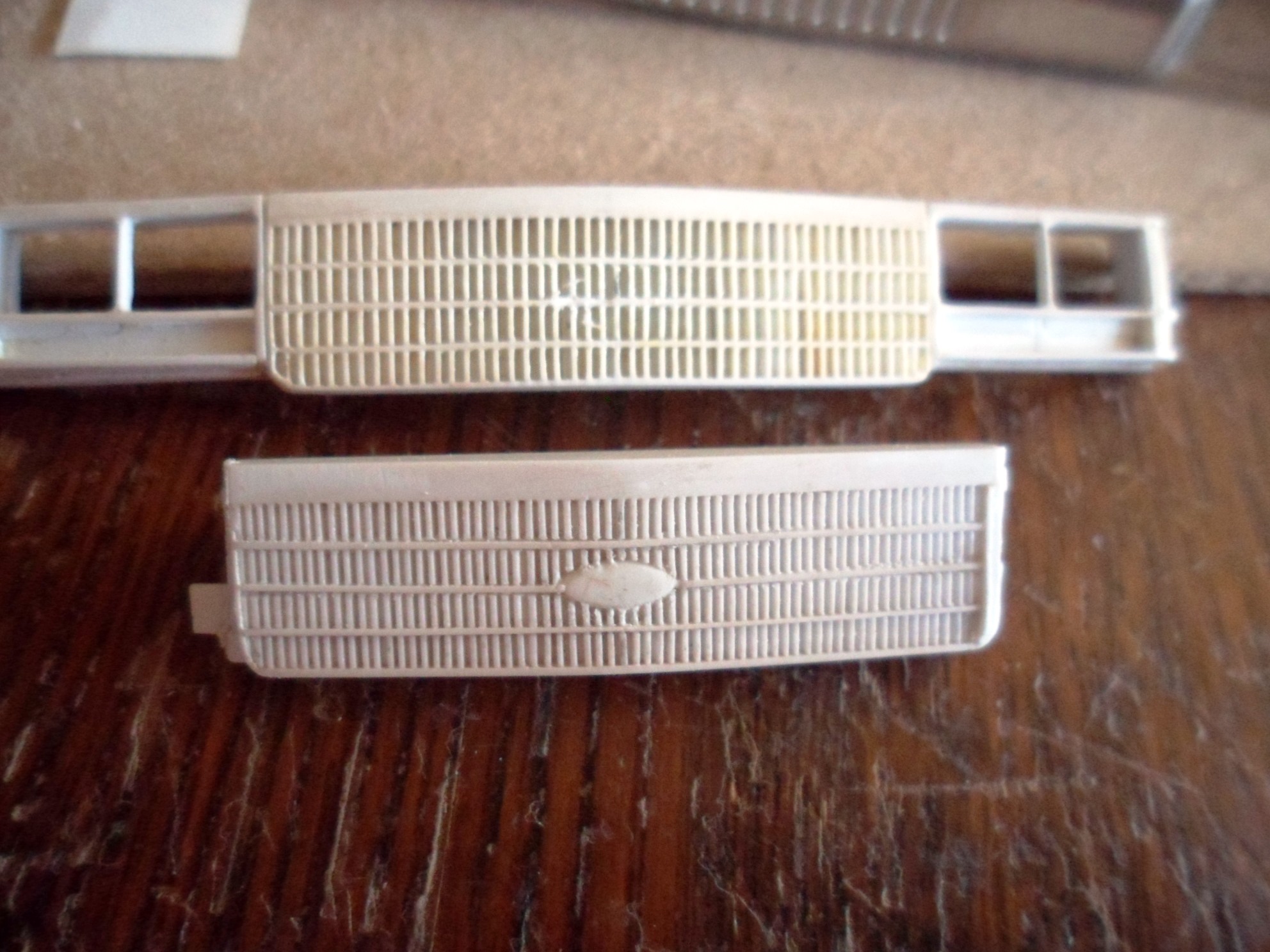

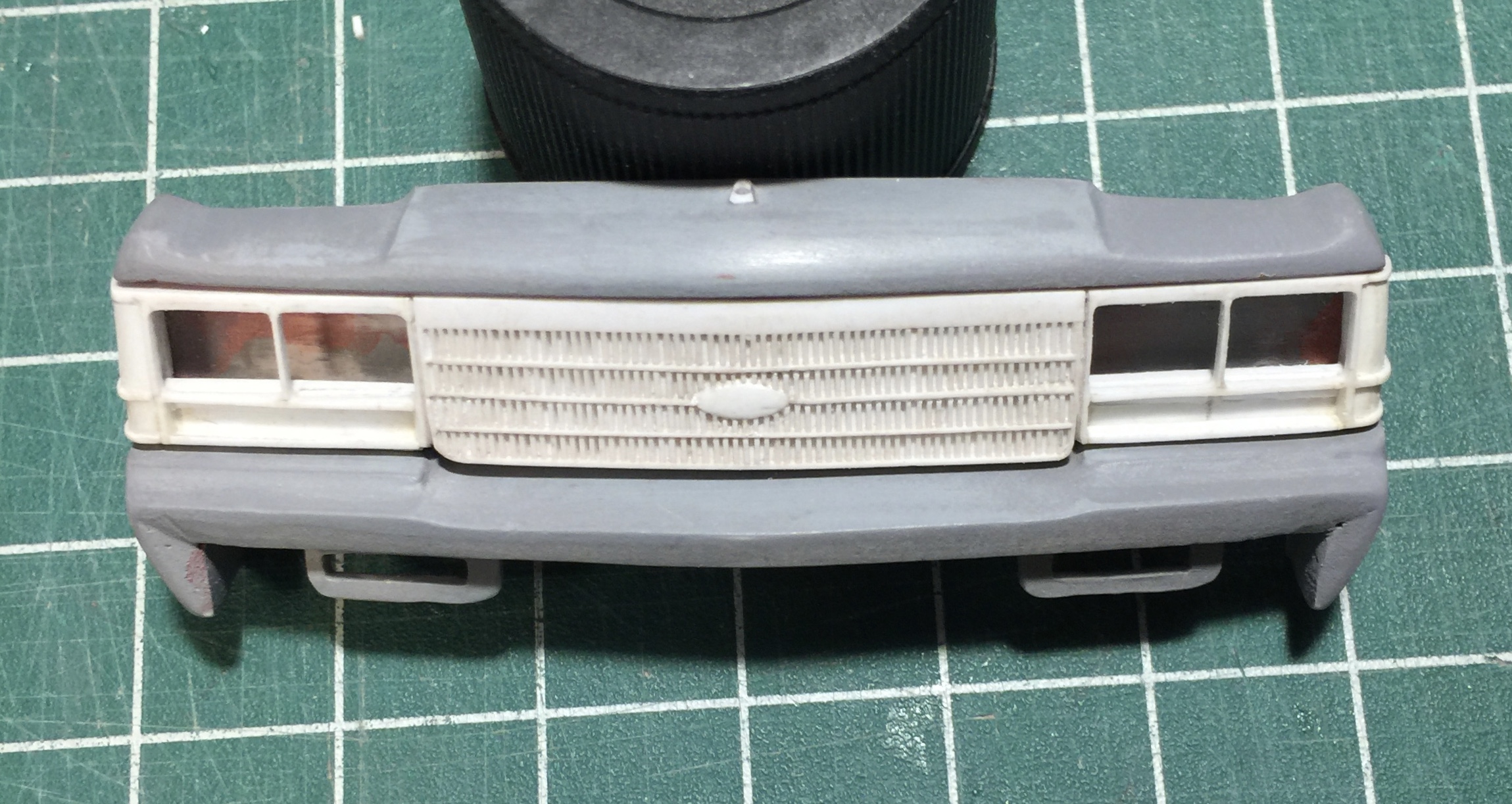

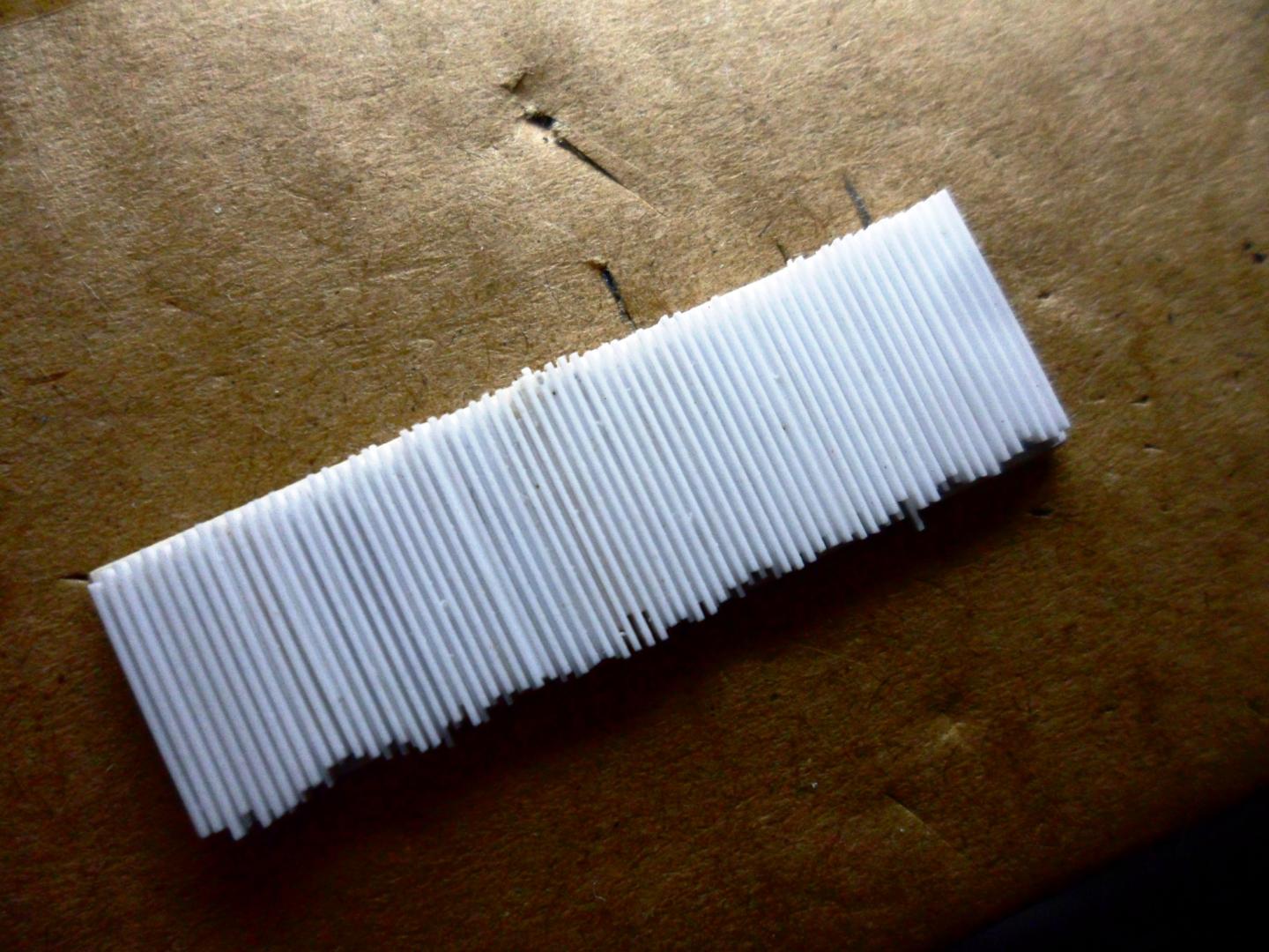

DEL Posted March 5, 2018 Author Posted March 5, 2018 (edited) Thanks Ronnie. As a fellow southern LEO of the 80-90's I know exactly what you mean about the CV's vs the Dips. And chevies. Those dips had a stretched vinyl cowhide seat that would have made a trampoline company proud. When we got the 86-87 Caprices & 87 & up CV's with cloth buckets we thought we'd finally got a seat that wasn't a twelve-hour torture rack. Right now I'm sharpening up the grille for the 91 and then Greg & Mike should be right on top of the body process. Hers' a pic of the new grille texture. Far more intricate definition than the first one. BTW this is the SECOND stab I made at the grille after spending 8 hours one the first one Saturday I had to trash in the end. Such is scratchbuilding. Following order is old grille, actual grille, new grille with finer & more accurate blade texture. Just gotta shoehorn it into that surround. Edited March 5, 2018 by DEL

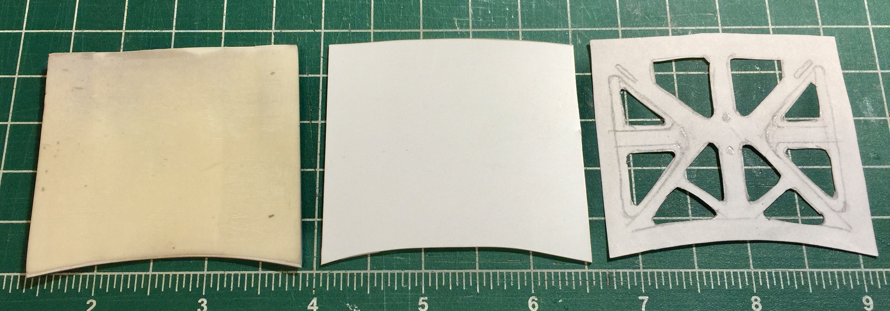

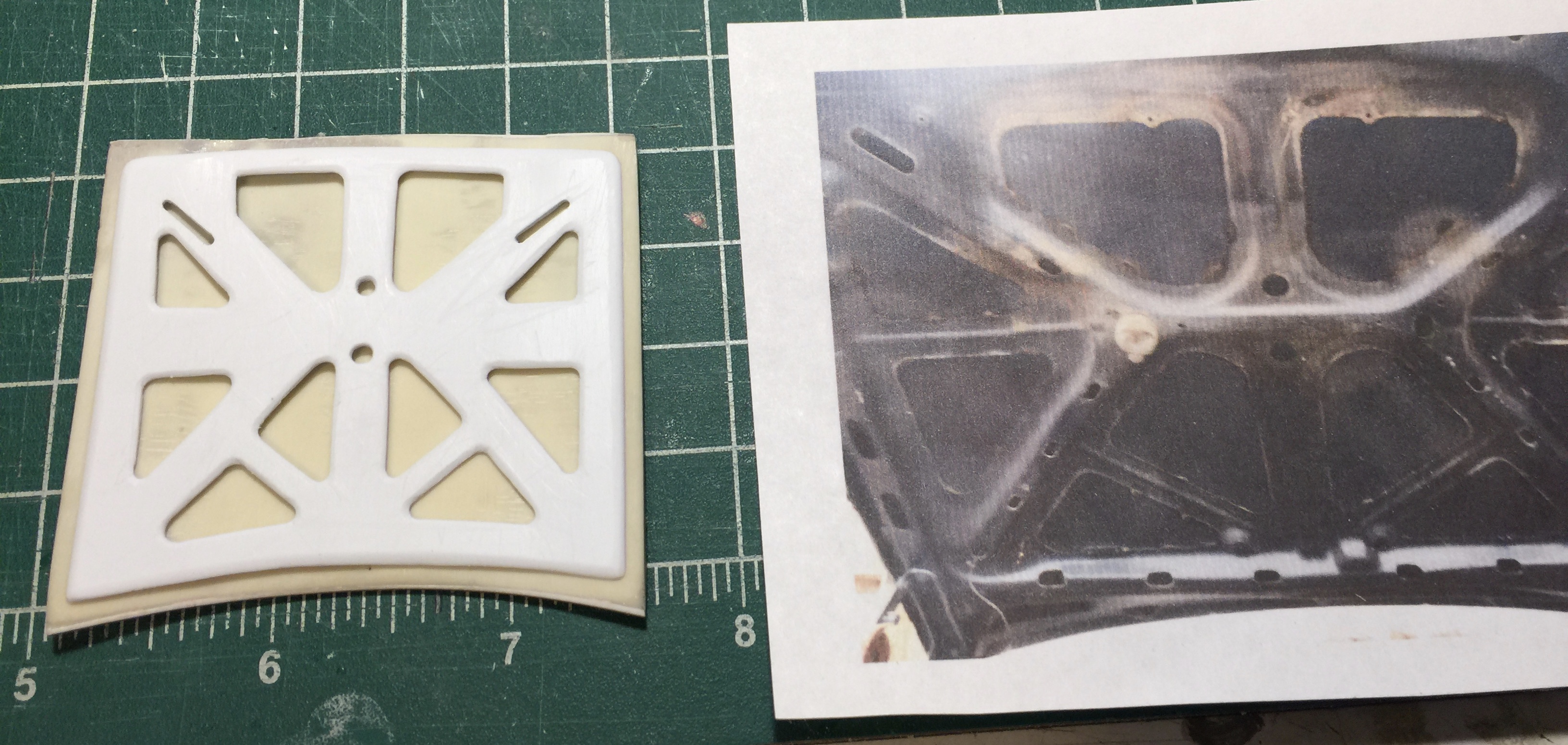

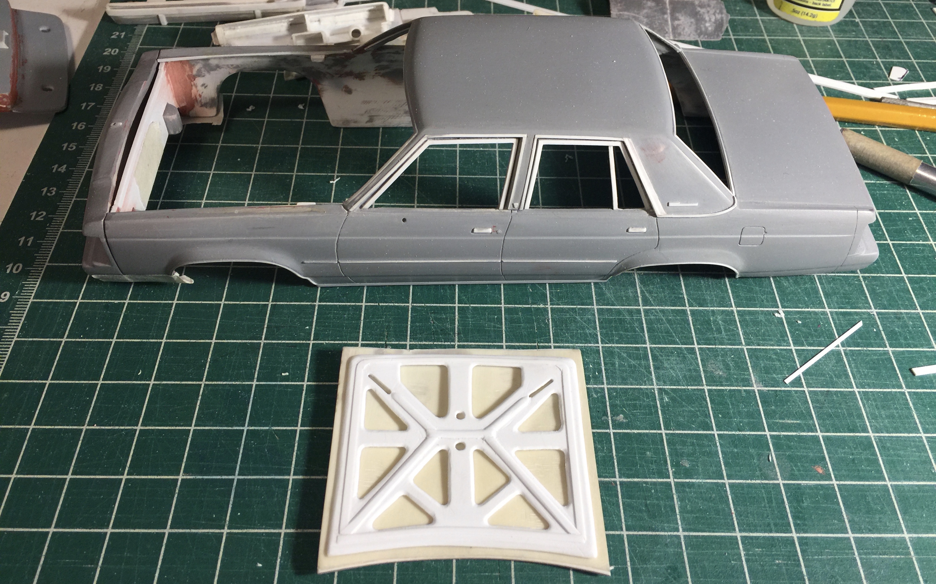

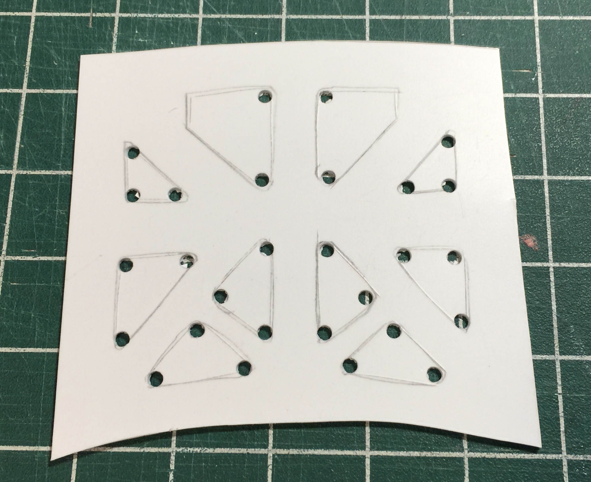

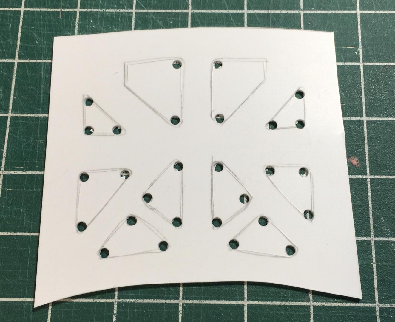

Maindrian Pace Posted March 8, 2018 Posted March 8, 2018 Working from a few pictures, I added some under hood detail. Starting with a sketch on paper, it was cut out and traced to sheet styrene, then that was cut and filed to shape.

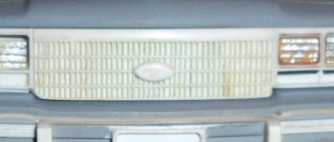

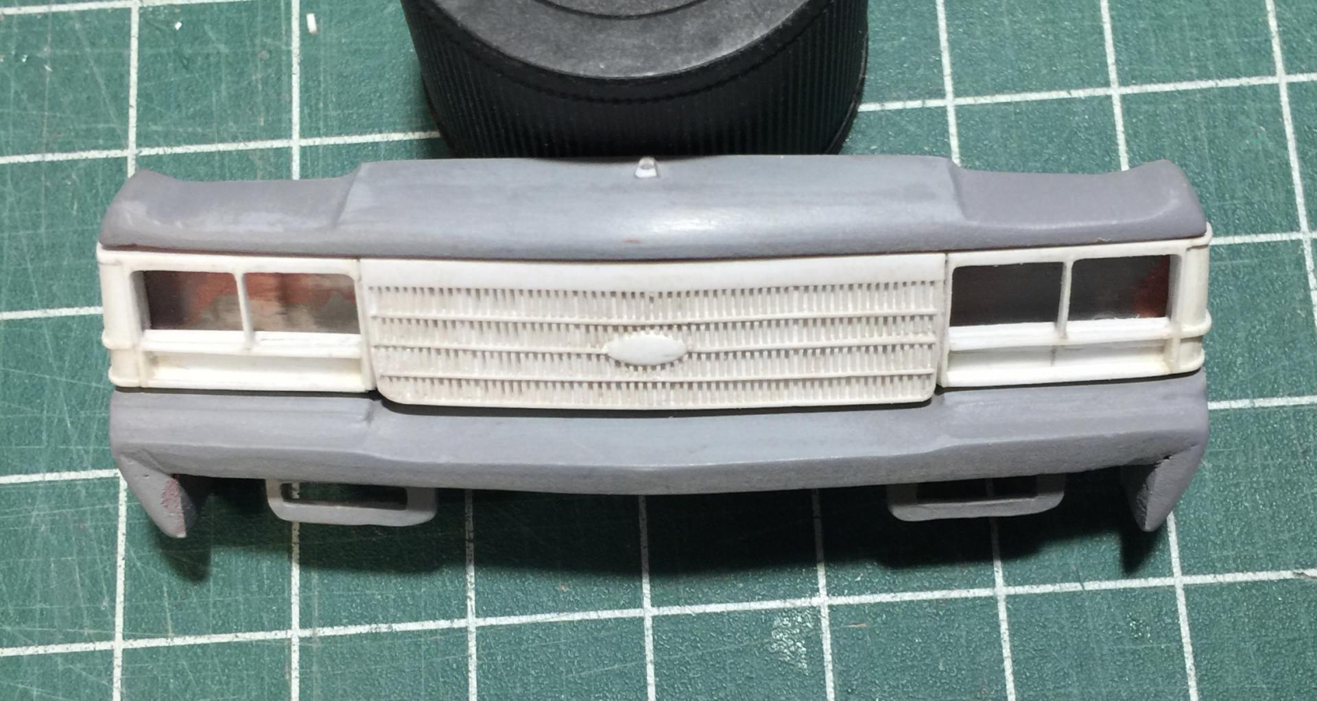

DEL Posted March 14, 2018 Author Posted March 14, 2018 (edited) Grille upgrade update. Pretty much done. Just neatening it all up. I also think the necessity of it made me do a little better job this time around. I even managed to inset the Ford Oval like Mike wanted.. Edited March 14, 2018 by DEL
Maindrian Pace Posted March 15, 2018 Posted March 15, 2018 Outstanding, Dwayne. About finished with the glass buck on this end.
Greg Wann Posted March 15, 2018 Posted March 15, 2018 (edited) It does look nice. Lots of tiny openings. Sure hope I can pull it off. Still might have to look into a photo etch part if it becomes troublesome. Here are some of the first Ford Police wheels and caps that Don And Carol gave me permission to reproduce for this kit. I am hoping to get the flash around the parts thinner, but this is not bad. I place around three or four pounds of weight on the mold and around 65 PSI of air to crush bubbles that could form in the resin. Proper resin casting takes good equipment, know how, patience and a somewhat controlled room temperature. Edited March 15, 2018 by Greg Wann

DEL Posted March 26, 2018 Author Posted March 26, 2018 Rob, That is the basic car I believe we will be offering now that we have the go-ahead on the proper dodgdish caps from the great folks at ModelHaus. At least, it was always my intention that it done with those caps. Those who want the full wheel covers can get them from any Lindbergh or Revell 97 CV kit. Or Greg MIGHT offer them as well as an option when ordering to keep a builder from having to scrap a whole kit for wheels.. As the kit itself is a 88-89 or 90-91 option based on the desired dash, column & wheel. Greg that is some great tire work and you garnered that skill some time ago, I see. Fantastic! I always wished a Goodyear Blue Streak like those used on copcars of the 70s to the 80's could be done. But I have NO idea how someone masters a tire for molding. Oh, and sorry about the bracing thing on the grille Greg. I already posted the pics of the old vs new grille prior. I can only say staying up late modeling can make you frizz-brained. Well, ME anyway. I mailed the grille to Mike last Friday so he should get it today or tomorrow. Like everyone else, can't wait. The ball is with Mike n Greg again now. I'm just another spectator...

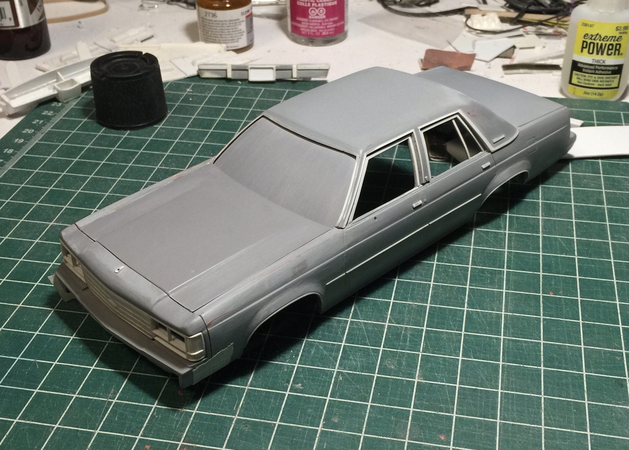

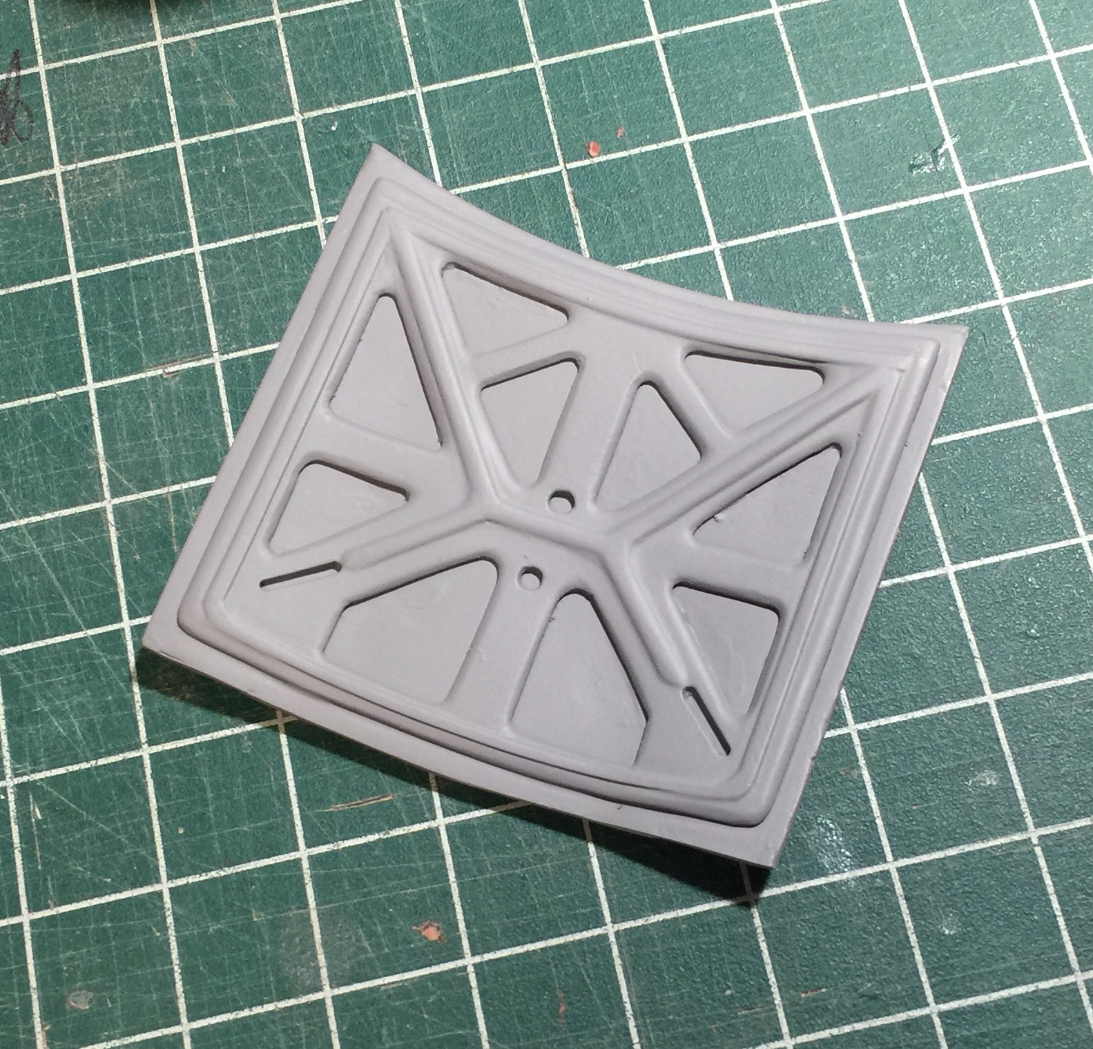

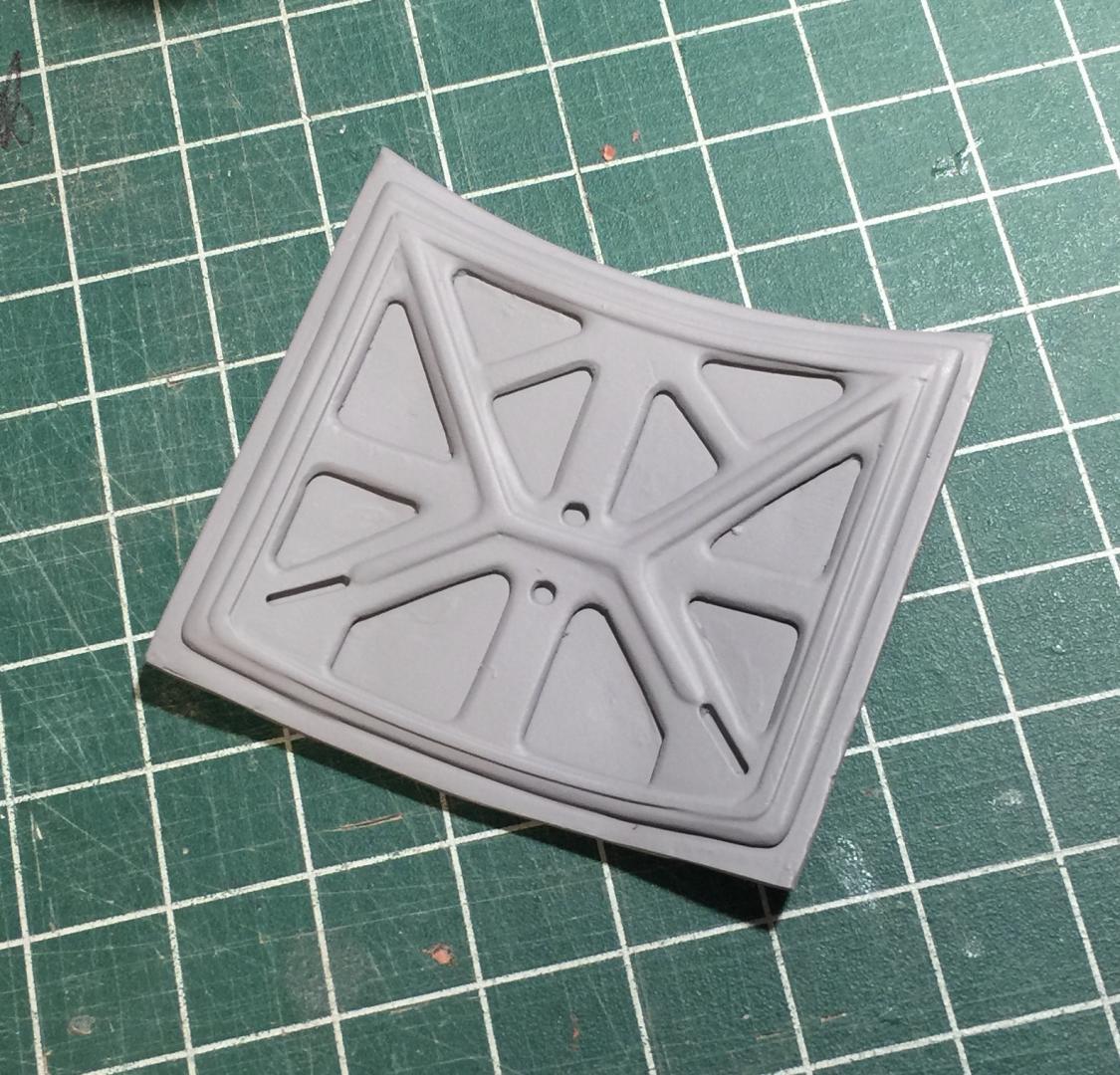

Maindrian Pace Posted March 26, 2018 Posted March 26, 2018 Got the grille today Dwayne. Thankya, thankyavurruhmuch. Dwayne sent along a nice, typed instruction sheet with illustrations that told of where slight modifications may need to be made to have the new grille fit the header panel. But... It fit perfectly anyway. The windshield master is done, rear window as well. The new hood is pretty much finalized... And the whole works is getting along quite nicely. Just a little bit of fussing here and there, some spot priming, and some micro-sanding and my work here is done. Give it about another week Greg, then it'll be ready for pickup and some Masterful Casting.

Greg Wann Posted March 27, 2018 Posted March 27, 2018 (edited) WOW! The top and underside of the hood looks really nice, Mike. That grille looks good but full of really fine detail. Fine detail like this is scary stuff. Silicone can be pulled from the mold when removing a part from it. If it gets too bad we just might still need photo etch grille detail. I am going to send a set of wheels to Joseph. He agreed to create the best possible masters for this project through his design work and shapeways printing. Don't know the cost but what the hay! He wants $12.00 for a set of tires. I am just going to suck it up and see what I can do. I have some of that Polytek stuff that has been around for awhile. I'm just going to mix some up and see if it cures properly. Edited March 27, 2018 by Greg Wann
