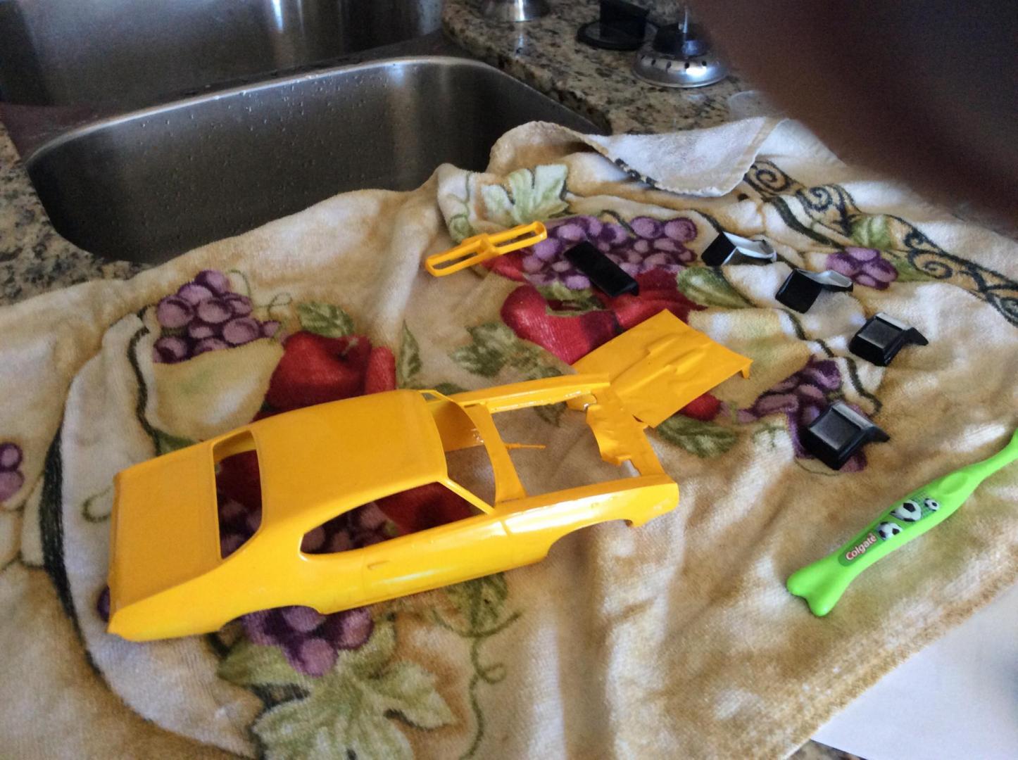

Eloveless Posted March 27, 2016 Share Posted March 27, 2016 So I recieved this kit in a 6 car deal. Just did inventory and all parts are here. Problem is he painted the hood, body, and bumper yellow. He had a mix of enemal and acrylic paint. How do I go about sanding this down without hurting the parts? I would just prime over it, but some parts are bubbled and has runs in the paint job. Any help would be great. Quote Link to comment Share on other sites More sharing options...

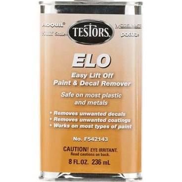

69NovaYenko Posted March 27, 2016 Share Posted March 27, 2016 (edited) I have used SuperClean and oven cleaner. The SuperClean did not impress me the oven cleaner (Easy off) works OK. My favorite number one go-to stripper is Testors ELO. II removes automotive lacquer, enamel, acrylic even automotive two stage clear-coats. Edited March 27, 2016 by 69NovaYenko Quote Link to comment Share on other sites More sharing options...

MrObsessive Posted March 27, 2016 Share Posted March 27, 2016 If you're unable to get ELO in Canada, eBay has it here. Amazon may carry it, but I haven't checked there. I've used it also in the past, and it's good stuff. Quote Link to comment Share on other sites More sharing options...
69NovaYenko Posted March 27, 2016 Share Posted March 27, 2016 I get my Testors ELO from CRM Hobby my local hobby shop. http://www.crmhobbies.com/ or e-mail them at crm@inlink.comI also found another sources at Hobbylinc http://www.hobbylinc.com/htm/tes/tesf542143.htm?source=froogle&gclid=CKP32pH24csCFYo2gQodZJoLHQAlso, once you get item stripped you can pour the left over into a container and reuse it several times before it`s depleted. Hope this helps Quote Link to comment Share on other sites More sharing options...

Nova-ss Posted March 29, 2016 Share Posted March 29, 2016 my experiences with elo has it can make plastic brittle. .so be warned. on the positive. .it does get any paint off......Chris Quote Link to comment Share on other sites More sharing options...

Repstock Posted March 29, 2016 Share Posted March 29, 2016 my experiences with elo has it can make plastic brittle. .so be warned. on the positive. .it does get any paint off......Chris x2. My 1969 Coronet stripped very well, but became full of little cracks. Once it was rinsed and dried, I ran Tamiya Thin cement over the cracks. So far, so good. Quote Link to comment Share on other sites More sharing options...

Jhedir6 Posted March 30, 2016 Share Posted March 30, 2016 I have used SuperClean and oven cleaner. The SuperClean did not impress me the oven cleaner (Easy off) works OK. My favorite number one go-to stripper is Testors ELO. II removes automotive lacquer, enamel, acrylic even automotive two stage clear-coats. Sorry to hijack your thread mate, hope you're making out ok with the GTO. As far as ELO goes, here in Canada I can have my LHS order it, for $18 a can, so I'd need about 4cans or more to make a bath big enough to cover a car, I'll stick with the IPA and SuperClean. Quote Link to comment Share on other sites More sharing options...
Mattsteel85 Posted March 30, 2016 Share Posted March 30, 2016 Sorry to hijack your thread mate, hope you're making out ok with the GTO. As far as ELO goes, here in Canada I can have my LHS order it, for $18 a can, so I'd need about 4cans or more to make a bath big enough to cover a car, I'll stick with the IPA and SuperClean.this stuff is super strong!! In the small tub I use for stripping i only fill it so it's about an inch deep and keep brushing and rolling the body! I've stripped 3 cars with one can and btw I wouldn't recommend leaving a car soaking in it overnight! I left an old engine n it overnight and it made the plastic wicked soft Quote Link to comment Share on other sites More sharing options...

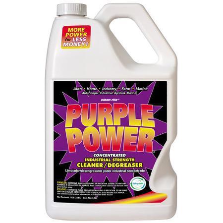

Dogfish_7 Posted March 31, 2016 Share Posted March 31, 2016 (edited) Purple Power degreaser can be a great friend in the removal of paint. It will remove most paints in a short time. Found in your US Automotive section in most Hardware suppliers. Edited March 31, 2016 by Dogfish_7 Quote Link to comment Share on other sites More sharing options...
