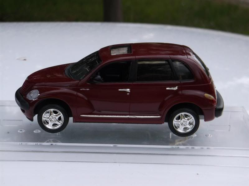

charlie8575 Posted May 11, 2016 Share Posted May 11, 2016 I have painted Tamiya lacquer directly onto bare plastic, and have had very good results. This is not cleared or polished. Charlie Larkin Quote Link to comment Share on other sites More sharing options...
