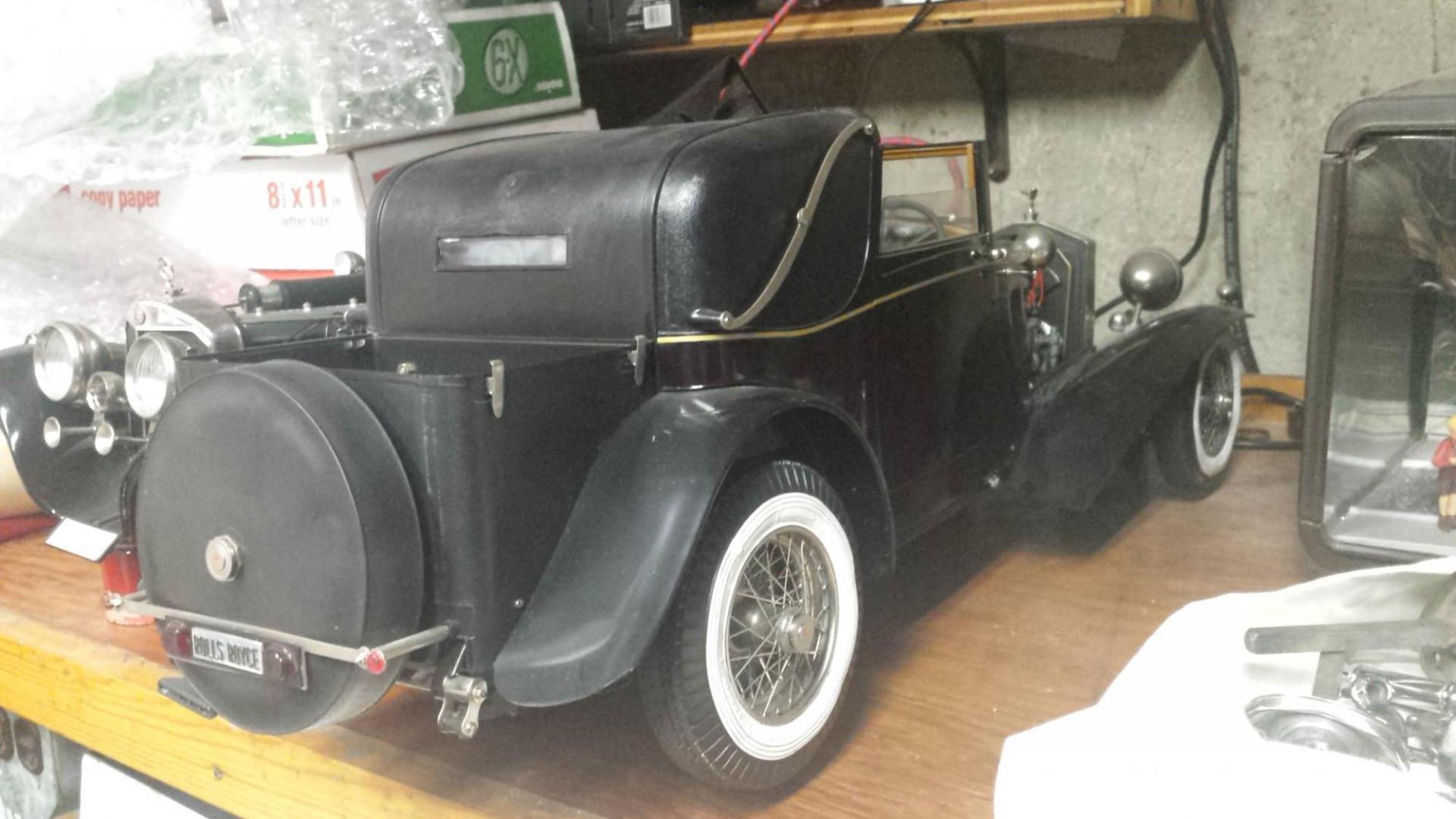

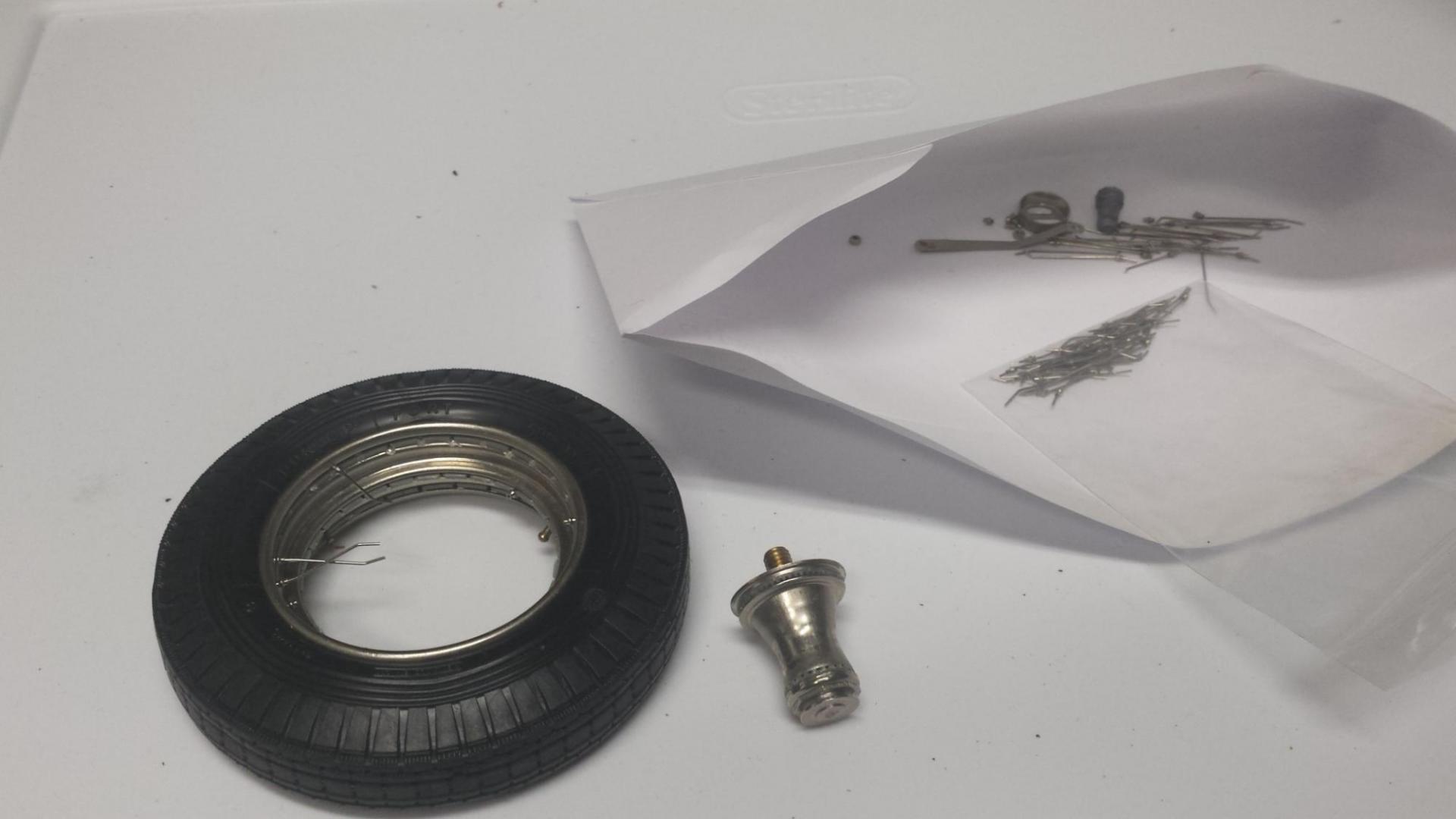

So the whole problem is with the wire wheels? The expensive answer, of course, is modelmotorcars.com. But contact Marvin Meit there for his opinion. He'll shoot you straight and is always ready to help, even if he doesn't sell you something.
Edited by sjordan2
Link to post
The only way to repair the wheel is to take it completely apart and rebuild it. And hope that you have enough spokes to actually finish it. If you want to give it a shot, I can send you the instruction manual, which of course covers wheel assembly.
Link to post
I checked and no, I'm short a few spokes. I assume these can be made or bought?  Thanks for the offer Harry.  I'll PM you my address unless you are doing this electronically.
Thanks guys.
Link to post
You'll need the kit jig, not just spokes Eric. Unless that wheel is just screwed together, you'll have to start from scratch. Contact Marvin, Dave Cox or Paul Koo for needed parts.
Link to post
I built one of those for somebody but I didn't have to repair it. But those wheels came with a built in fixture for holding the spokes in place. It was half built when I got it because two other model builders couldn't finish it and they never built a Pocher before. I have their Bugatti Type 50T that I built in '82 so that got me the job. So I finished it up and got paid $750 to do it too.
Link to post
