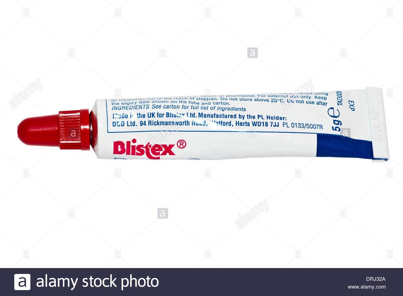

Once I get to the craft store I can collect supplies for the blower belt. The vinyl tape on the outside and the ribbed ribbon on the inside may work. I also found some very small ribbed caps from a tube of my wife's makeup that may work for pulleys. Something like this Blistex tube. Hopefully the size will be right.
Link to comment
Very cool idea about using the Blistex-type cap for Gilmer-belt pulleys. Let us know if the diameter is right. :D
