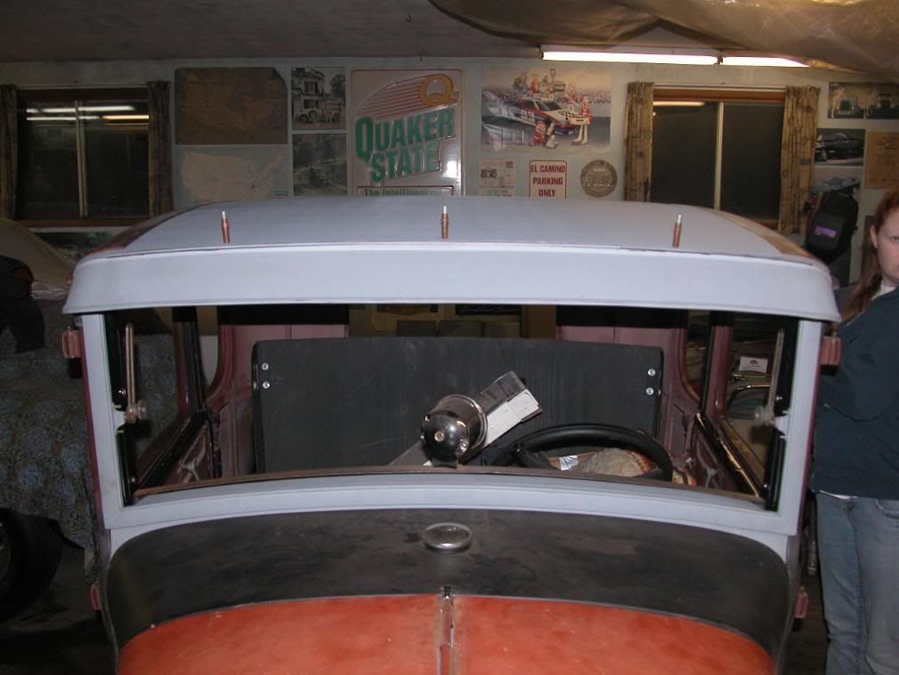

Ace-Garageguy Posted July 9, 2016 Share Posted July 9, 2016 (edited) PS. I sure would like to know what that compound-curved fill panel on the OP photo was scrounged from. Obviously cut from the roof section of something else. That's BY FAR the easiest way to do it on a 1:1, and about the ONLY way do do a nice clean job if you don't have access to an English wheel. EDIT: I LOVE Google. I did a reverse image search and found the original build thread on that car. The roof section is from a Volvo 122. Edited July 9, 2016 by Ace-Garageguy Quote Link to comment Share on other sites More sharing options...

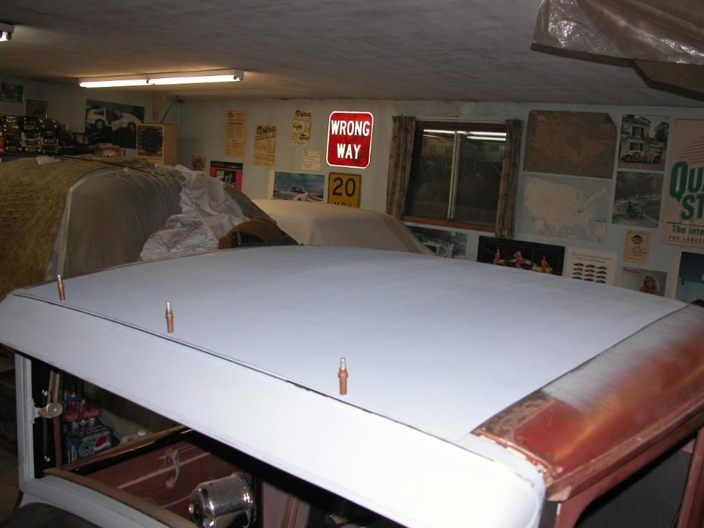

Toner283 Posted July 11, 2016 Share Posted July 11, 2016 (edited) PS. I sure would like to know what that compound-curved fill panel on the OP photo was scrounged from. Obviously cut from the roof section of something else. That's BY FAR the easiest way to do it on a 1:1, and about the ONLY way do do a nice clean job if you don't have access to an English wheel. Ace, We filled the roof on our 30 coupe as well. We used the roof panel out of an 81 malibu 4dr sedan. Used the rear 2/3rds of the roof skin turned 180°. Matched the compound curves of the car perfectly. Probably a lot easier to find than a Volvo 122 roof if you are going to fill a roof. Edited July 11, 2016 by Toner283 Quote Link to comment Share on other sites More sharing options...

Ace-Garageguy Posted July 11, 2016 Share Posted July 11, 2016 Ace, We filled the roof on our 30 coupe as well. We used the roof panel out of an 81 malibu 4dr sedan. Used the rear 2/3rds of the roof skin turned 180°. Matched the compound curves of the car perfectly. Probably a lot easier to find than a Volvo 122 roof if you are going to fill a roof. THANKS ! That's a great one to have filed away. That roof stamping must be on millions of that era GM cars. Quote Link to comment Share on other sites More sharing options...
