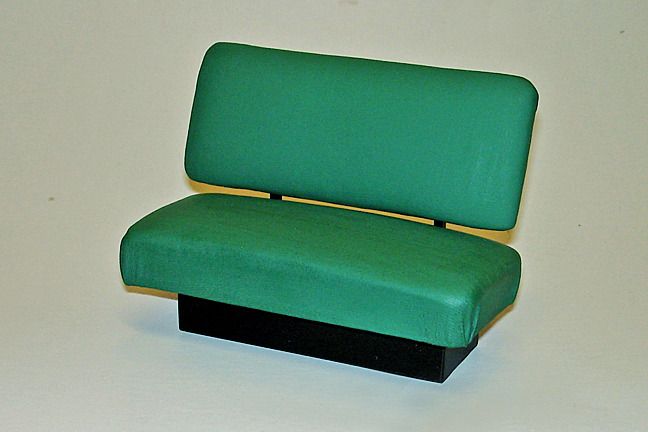

Harry P. Posted August 21, 2016 Posted August 21, 2016 Aftermarket resin seats that I used on my Pocher Mercedes, before upholstery... And after, using material from Hobby Lobby similar to what I was talking about, but this has a more pronounced texture. By the way, this is the way the material looks, this seat was not painted after upholstering.
Harry P. Posted August 21, 2016 Posted August 21, 2016 Pocher Rolls Royce seats, upholstered with the Hobby Lobby stuff, the "beading" detail is soft, black rubber that I found in the jewelry making aisle of Hobby Lobby. I used super glue to attach it, working in short lengths at a time. The upholstery material is brown, and the rubber is obviously black, but no matter, as these seats were painted after upholstering them with gray acrylic craft paint. The wood trim is real wood, stained and "varnished" with Future. On these seats the outer shells are kit parts, but all the cushions were scratchbuilt using balsa wood and some very thin foam rubber (also found at Hobby Lobby)! You can see that on the rear seat the armrests are not yet in place. Rear seat... And the fronts... The red "carpet" trim is yet another piece of material I found in the same section of HL as the upholstery material. In this case I also used that red material for the car's carpeting. The handles on the seat storage compartments and the horizontal trim across the seat backs is soft silver jewelry beading wire, found at... you guessed it, Hobby Lobby!

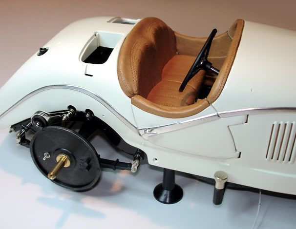

Harry P. Posted August 21, 2016 Posted August 21, 2016 Here is a rare case (the only time, actually) that I used the kit supplied upholstery, because I liked the color and the stitching detail. I used contact cement in this case.

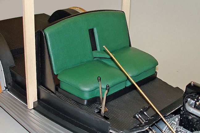

Harry P. Posted August 21, 2016 Posted August 21, 2016 Another Pocher Rolls Royce. This one will have a completely scratchbuilt woody body. Here is the front seat upholstered in that Hobby Lobby material in its natural color, which doesn't look bad if a brown interior is what you want... But this car will have green upholstery, so out came the acrylic craft paint... Rear seat is completely scratchbuilt.
Harry P. Posted August 21, 2016 Posted August 21, 2016 Pocher Bugatti seats, upholstered with the same stuff, then painted... Once again, the beading detail on the rear seat is that soft, flexible rubber bead stringing stuff found in the HL jewelry aisle.

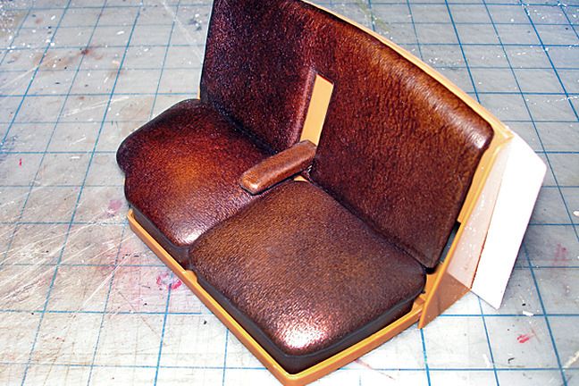

Cato Posted August 21, 2016 Posted August 21, 2016 Using the same techniques and similar materials but leather as Harry mentioned, here's the rear seat of my Rolls. The pleats are scratch built from craft sticks and foam and leather adhered with CA Gel. The Gel will not bleed through. The methods apply to a variety of Pocher upholstery options:
Harry P. Posted August 21, 2016 Posted August 21, 2016 ...pleats are scratch built from craft sticks and foam and leather adhered with CA Gel. The Gel will not bleed through.That probably depends on the specific material you're using.
Cato Posted August 21, 2016 Posted August 21, 2016 That probably depends on the specific material you're using. Can only speak for the leather I use. LocTite Gel and Bondini do not bleed. Marvin uses Bondini and Cox sometimes uses d/s tape.
