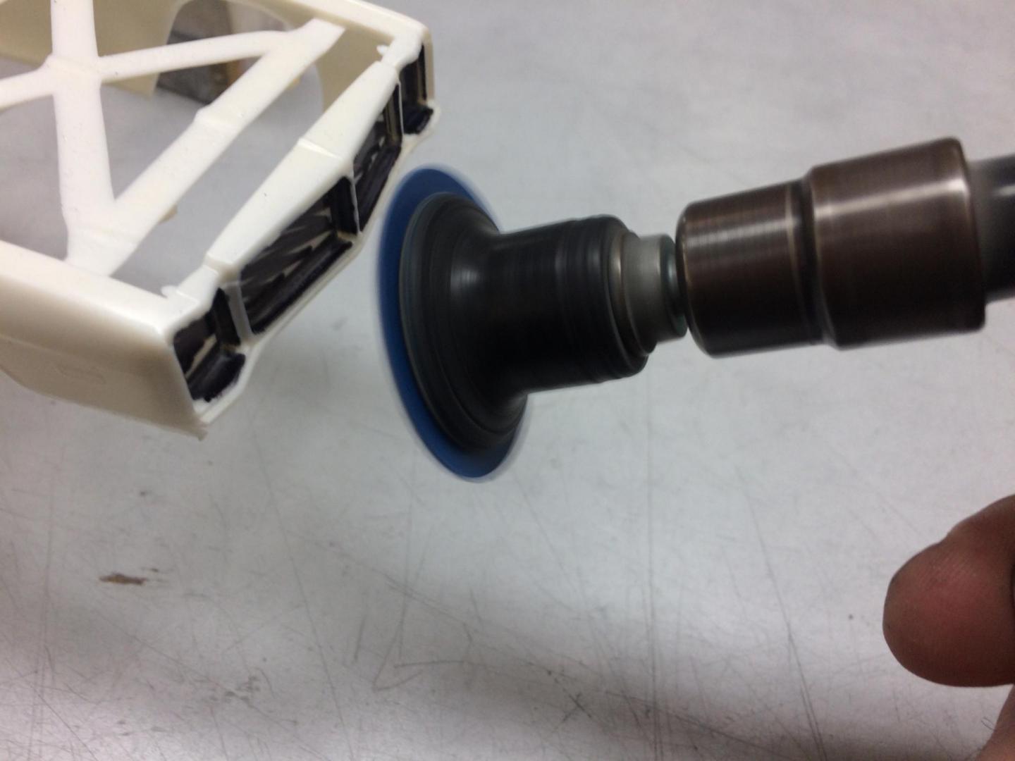

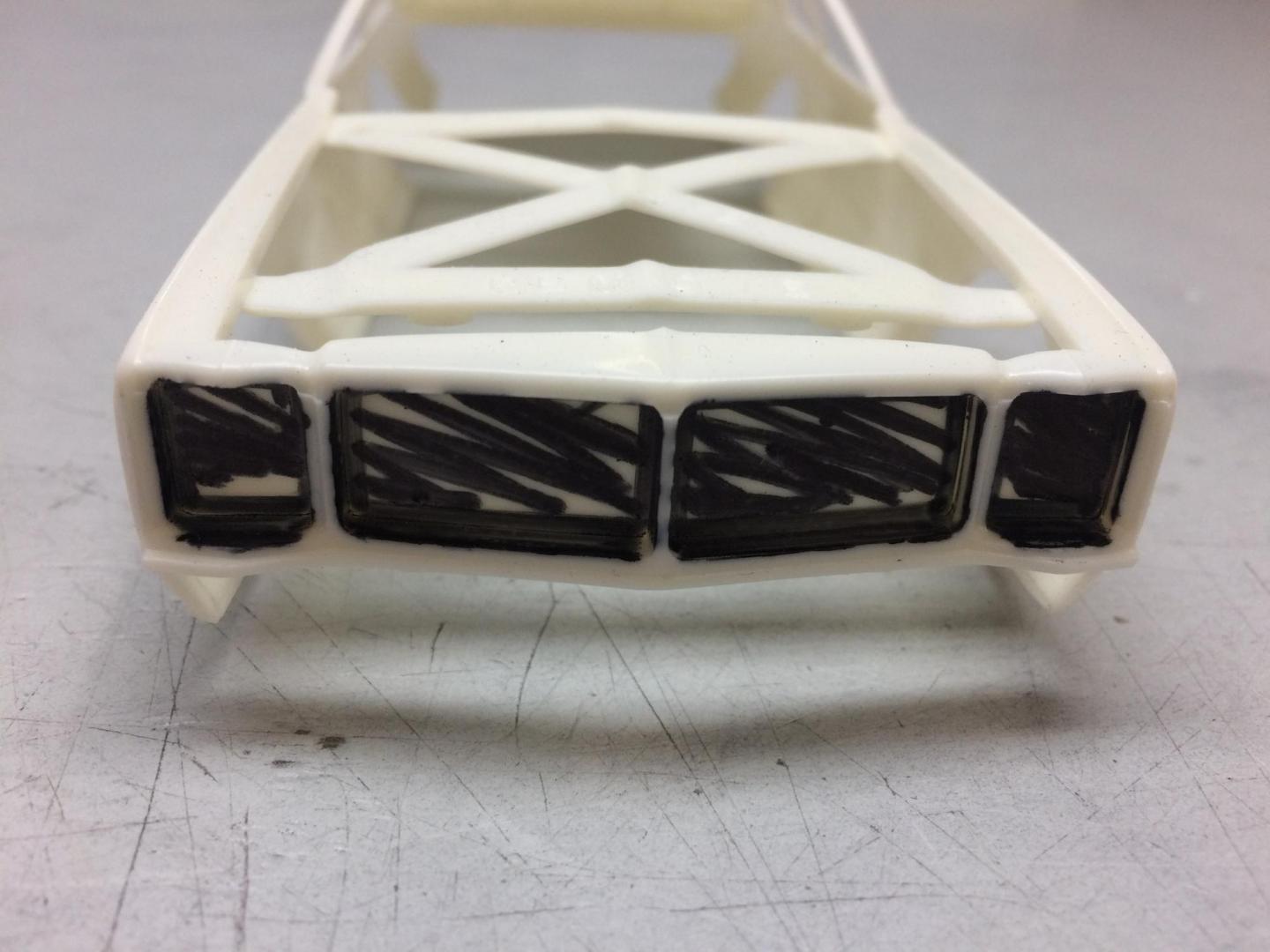

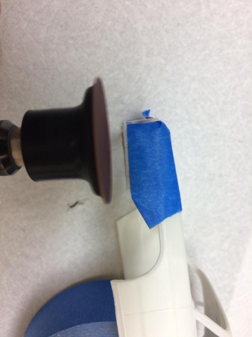

Starting my slow project that gets some time in between work projects. This is a 1972 Dodge Coronet, based on the MPC 1977 Dodge Monaco.

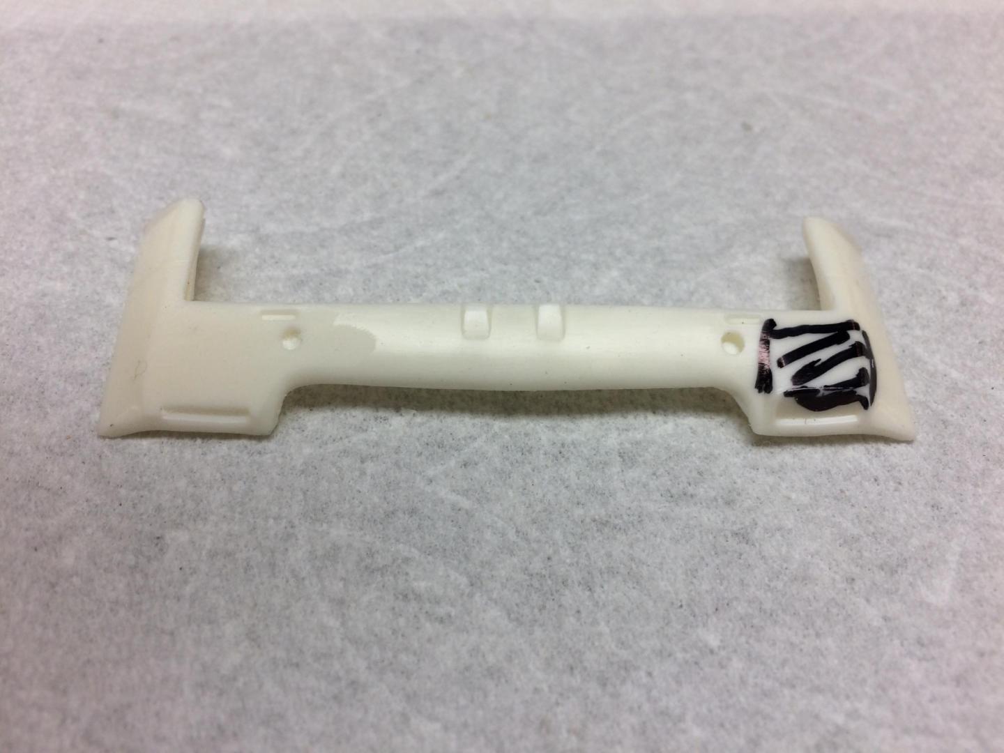

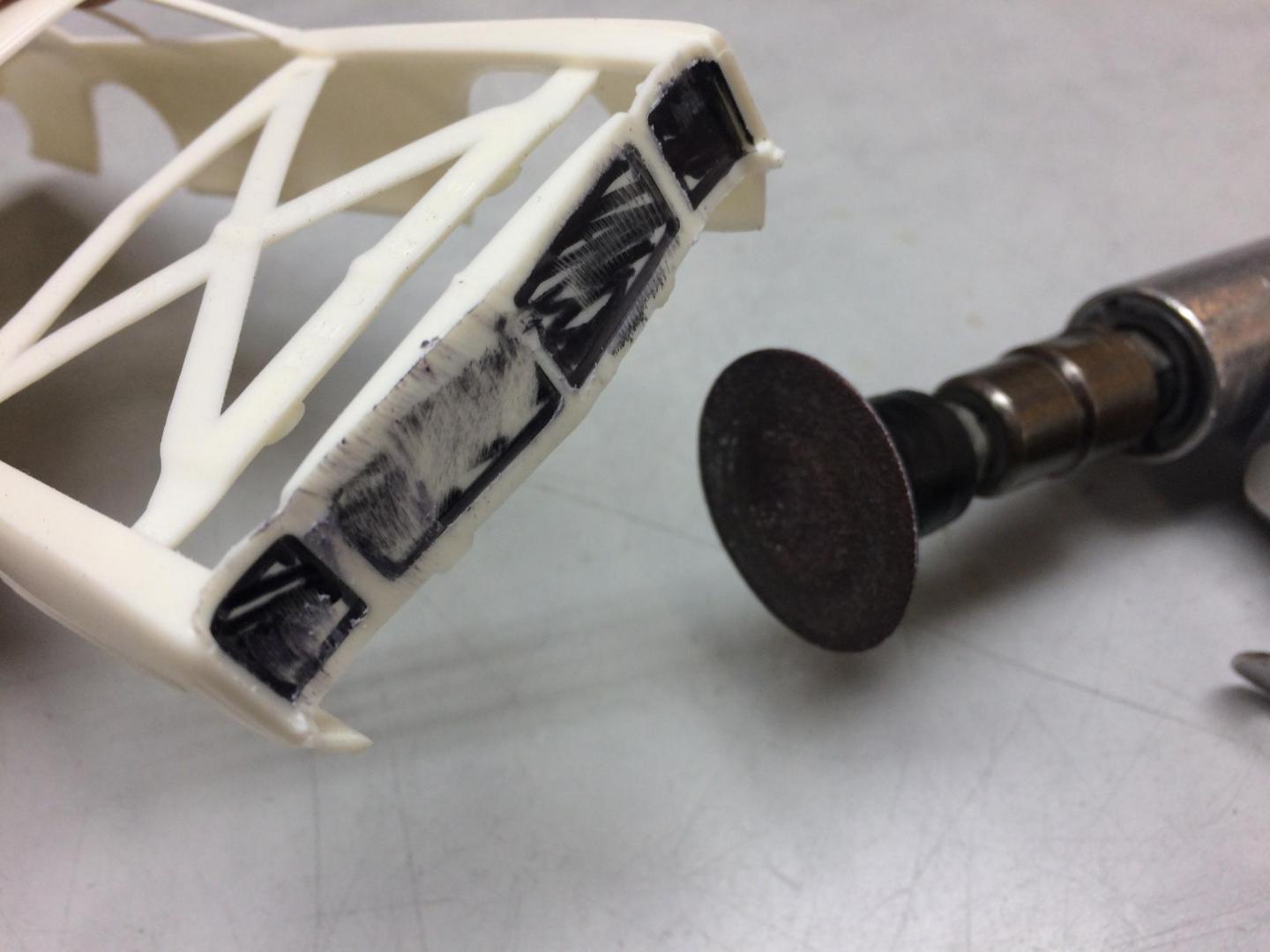

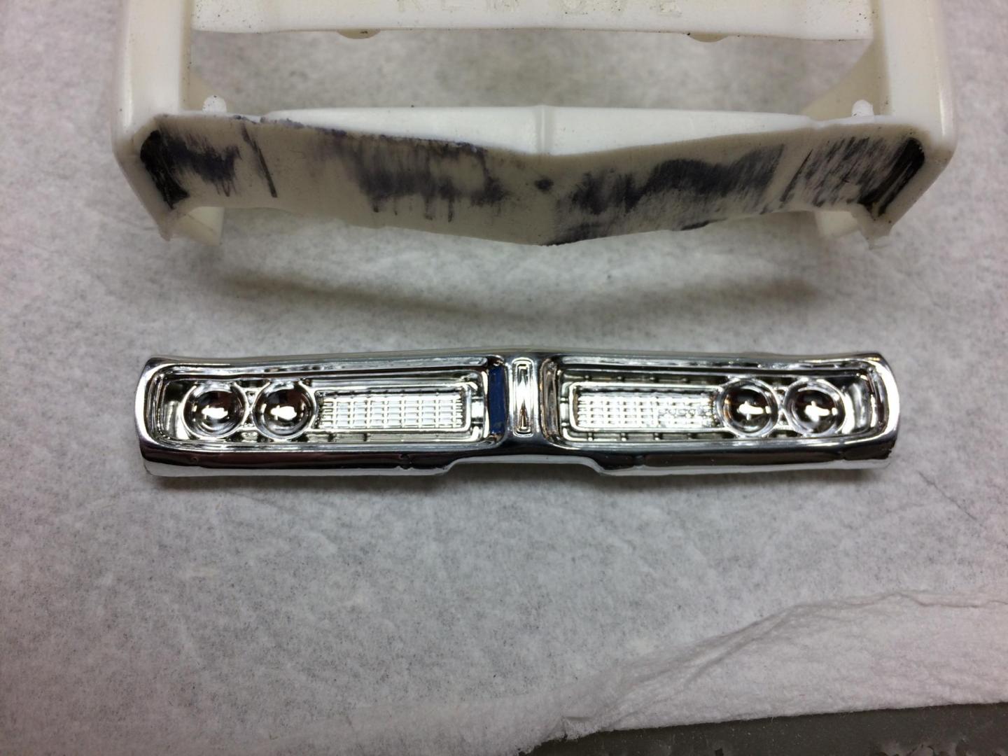

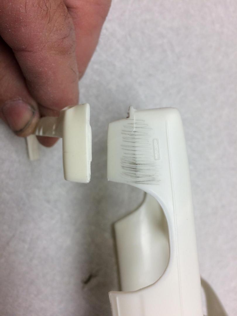

1. Front end is grinded down. More material will be removed once I find out how much exactly to remove

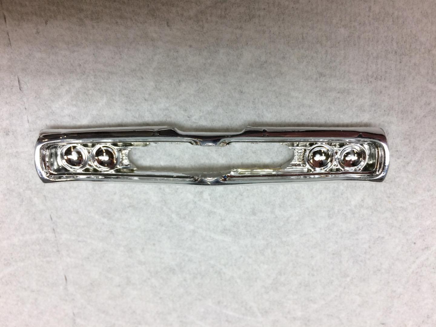

Rear bumper:
reshape using Monaco bumper and Charger tail lights. Add rear valance from Charger
Front bumper:
remove grille from bumper. Fill in lower dip in bumper. Reshape lower valance. Add grille/headlights from second bumper. Reshape center grille.

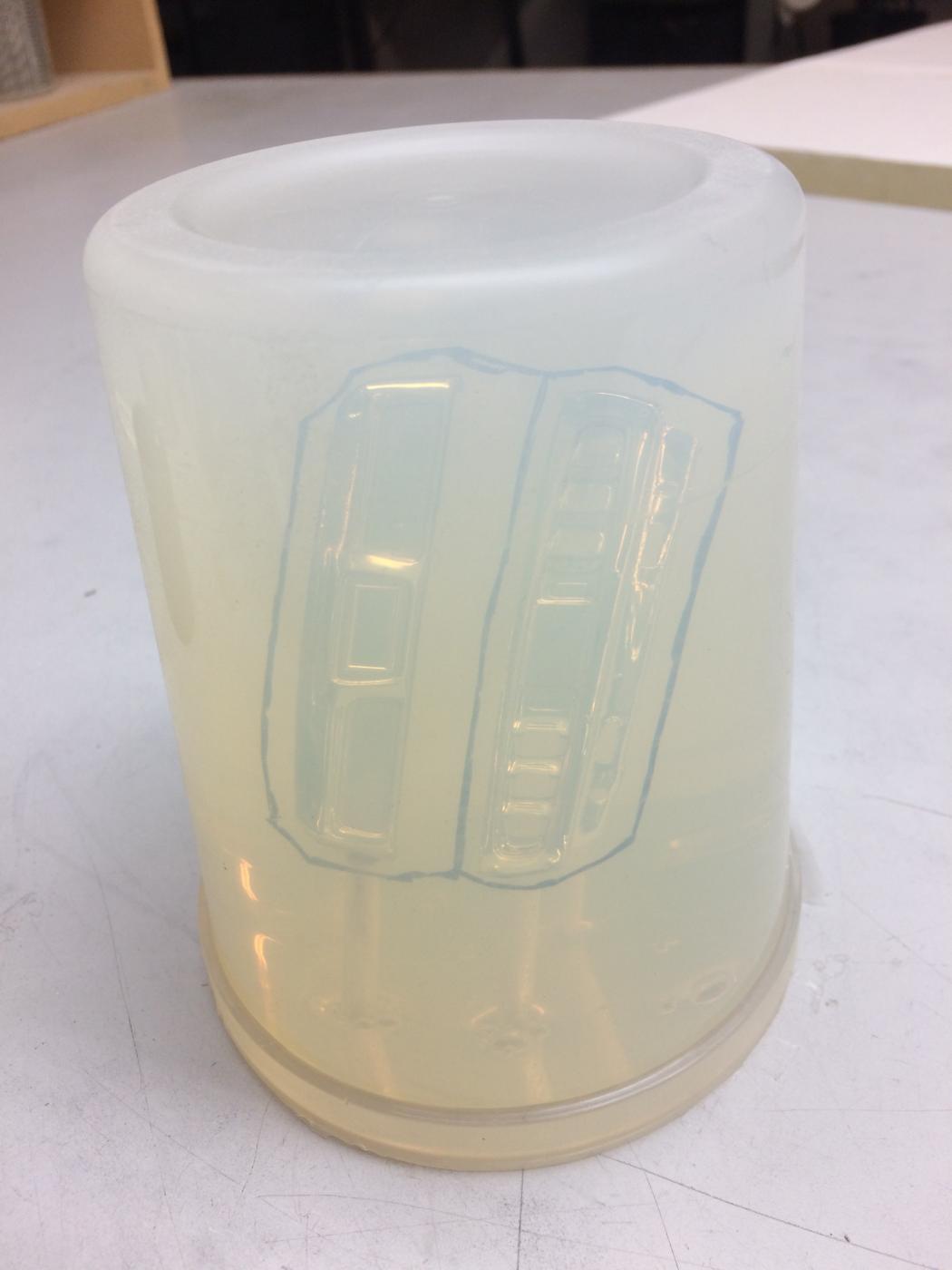

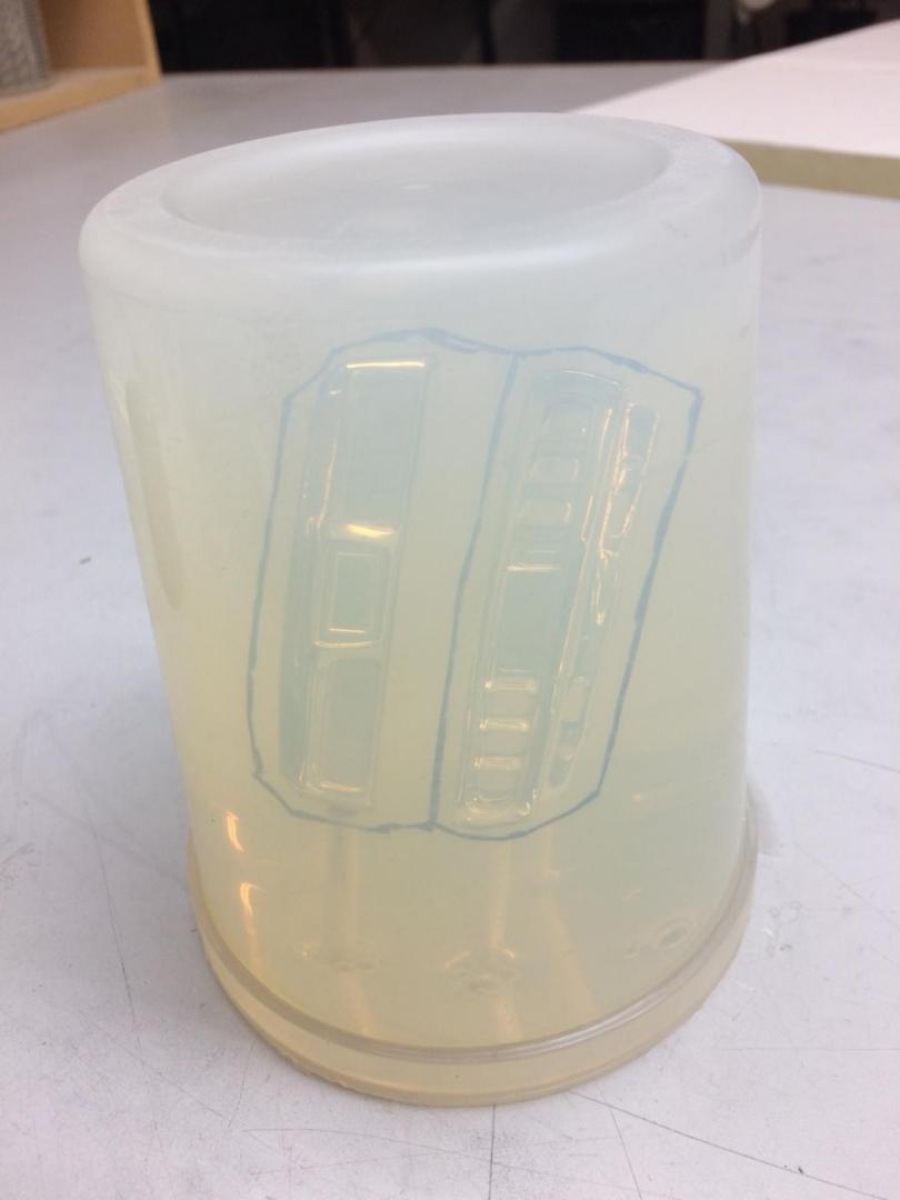

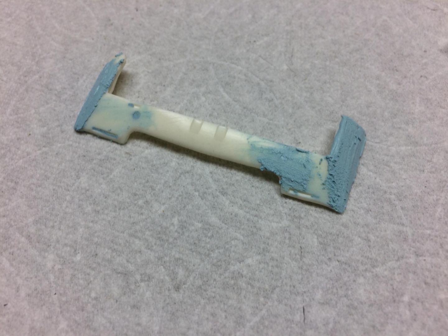

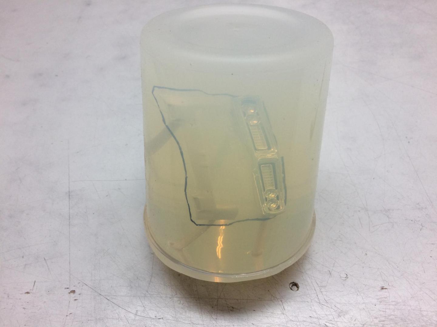

more progress today, filled in the hood valleys. Also measured the fender tops on the Monaco and found, they are perfect without modification. Also, molded the rear bumpers for extras
Edited by robertburns
Link to post

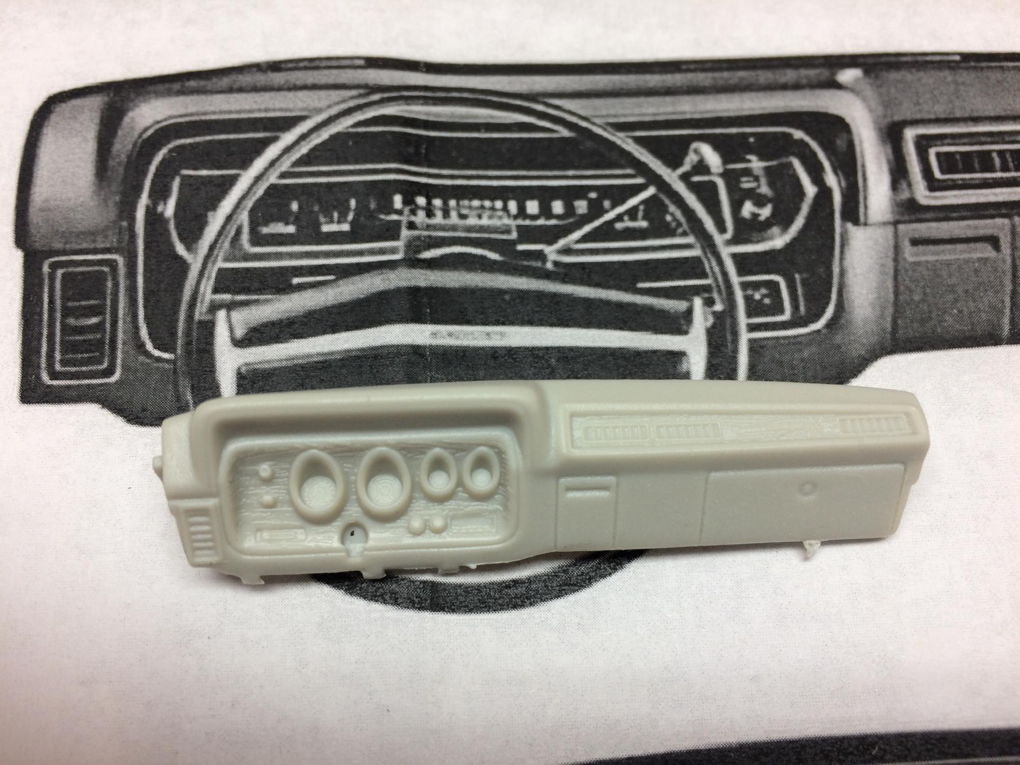

The Charger dash and its gauges will be fine , as the round instruments were an option --- although not the Rallye clustre. Instead of a tachometre,  an analogue clock was employed ; however,  for this intent,  no one would notice .
The steering column and steering wheel are perfect ,too ( and, yes , the Tuff Grip wheel was an option with power steering ) .

You'll want to "deck" the nose lots more , as the 1971-1973 models had the wraparound bumper . Good call on reworking the Charger piece .

I believe the 70 coronet kit also has a second dash not for that kit in it, it is the correct looking gauge cluster, you might try to cut to cut gauge cluster out and swap them. Just a thought.

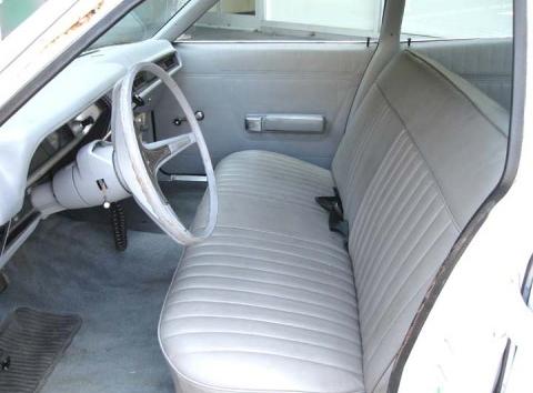

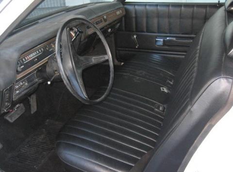

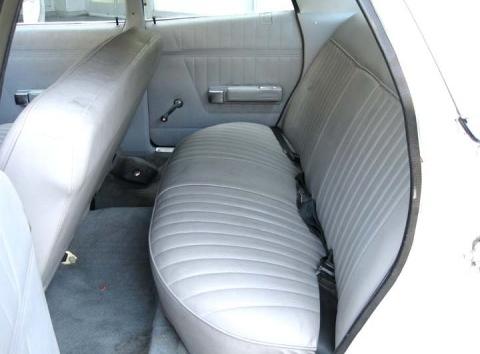

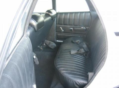

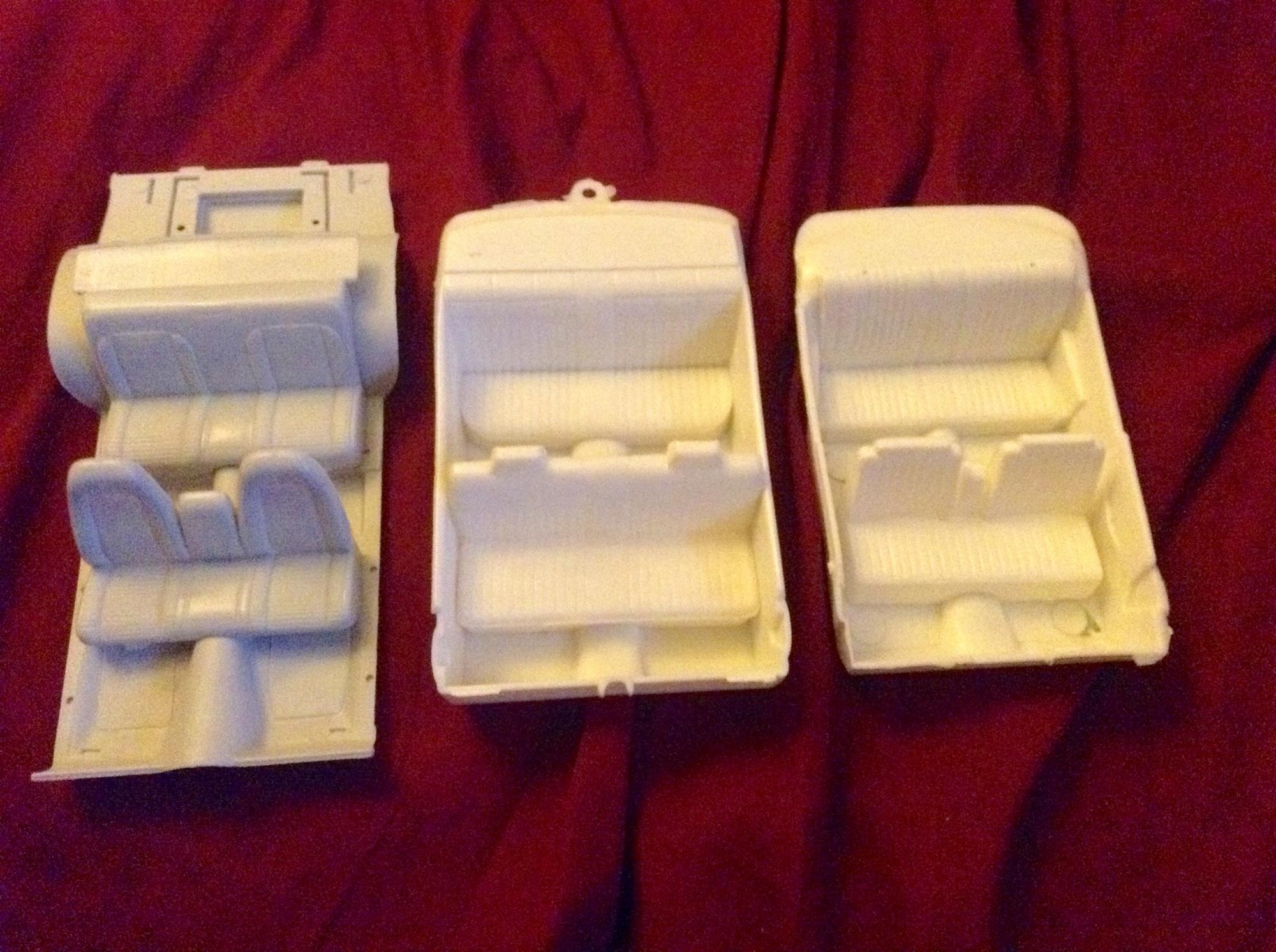

Left to right, Charger, Ford LTD, Monaco
Rear seat options. The 1970 Ford LTD rear lower seat looks the best due to the curved edges. It would have to be narrowed to fit. Monaco upper seat will work with minor pattern changes
Front seat options. Bottom half of Charger (rescribed pattern) plus narrowed upper half from the LTD

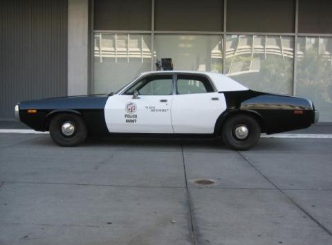

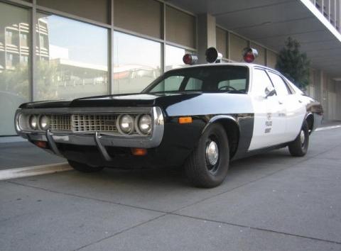

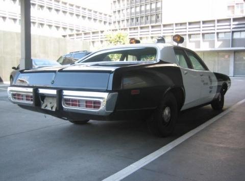

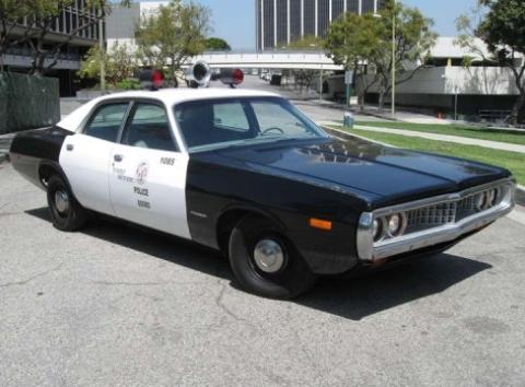

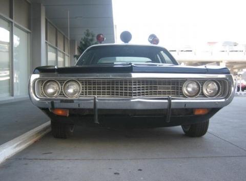

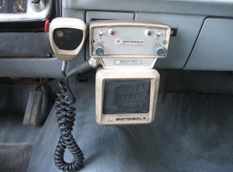

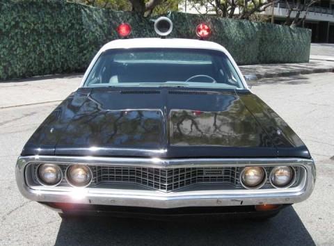

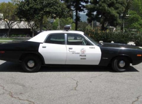

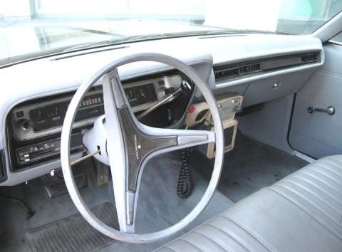

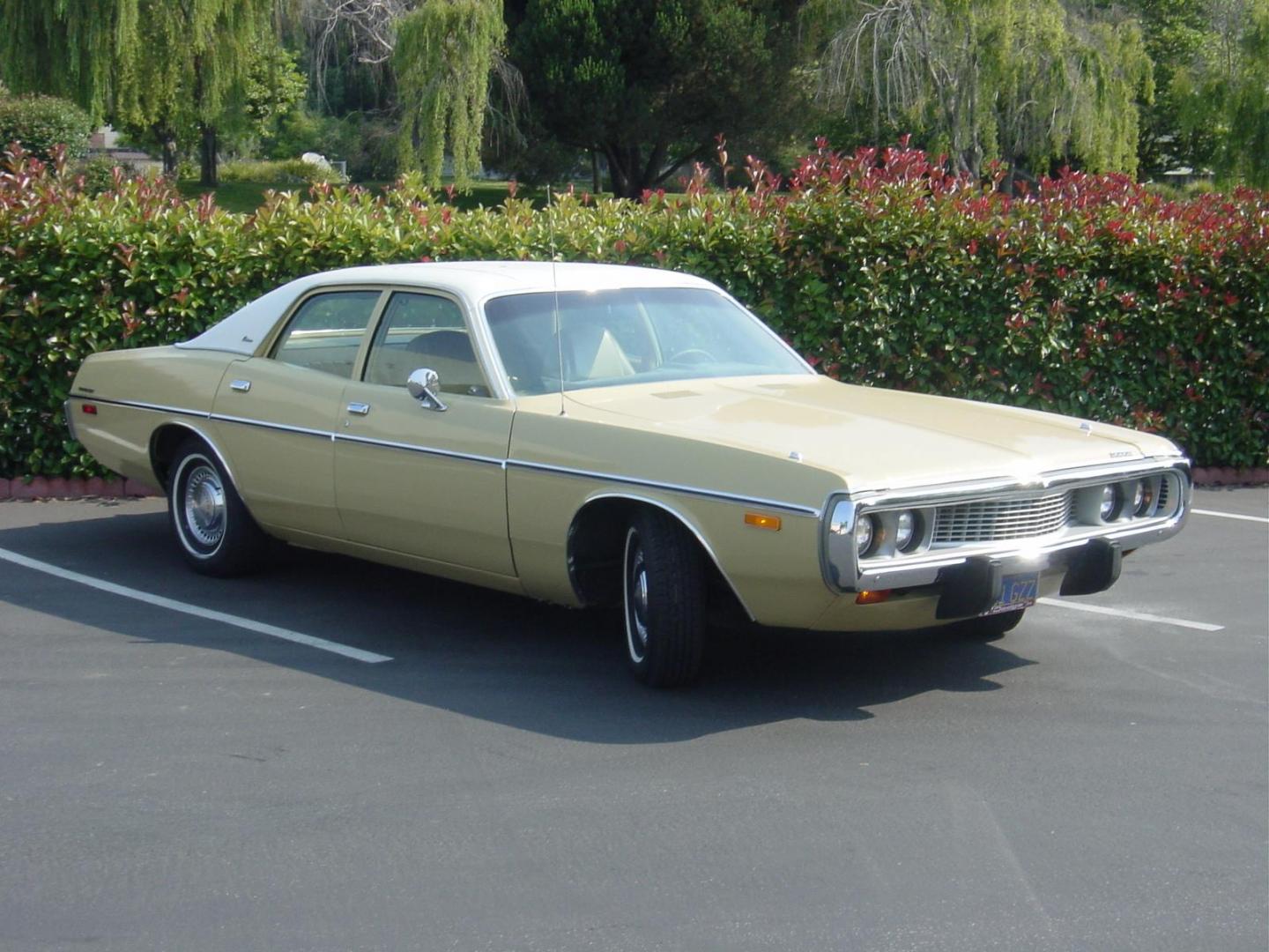

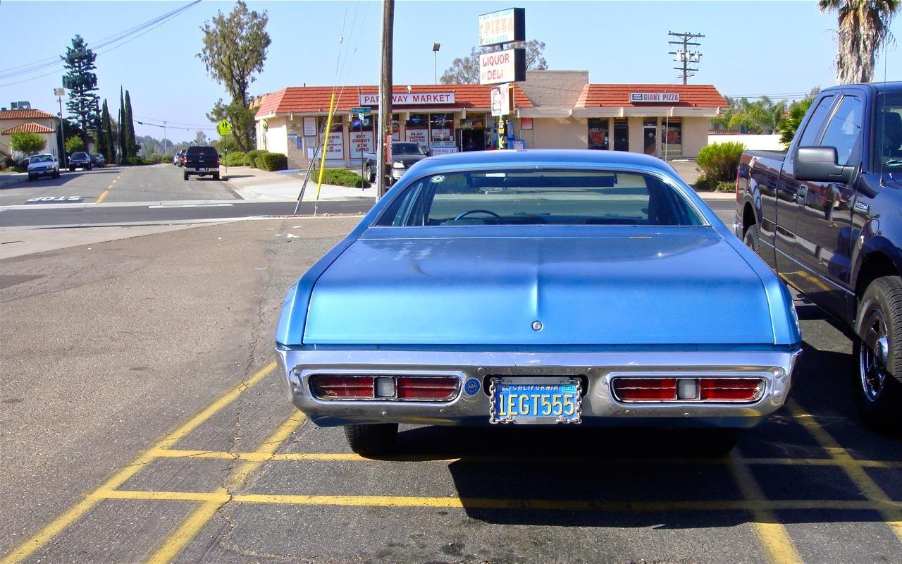

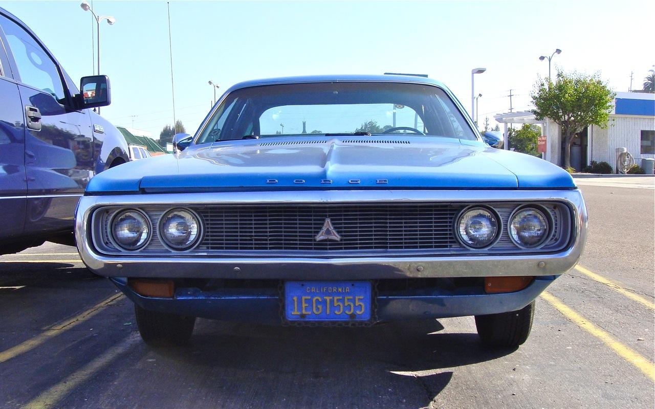

Some more reference photos of a 1972 Coronet , from 28.12.2014 . That's real powder on that rascal ... all in always warm and sunny California ?
thought that was a model at first. Would make a great real or not shot
hope to see some shots of it in the sun

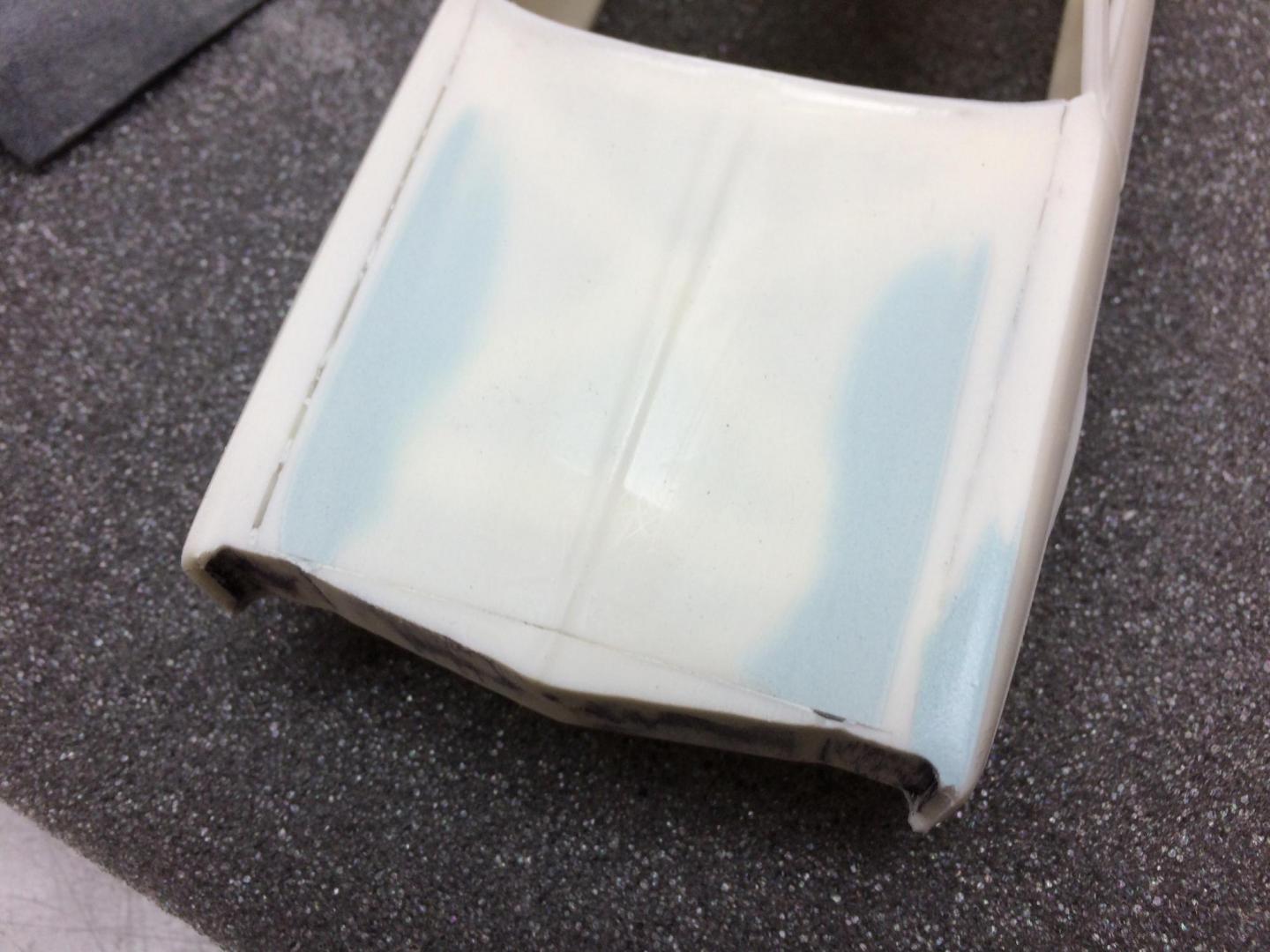

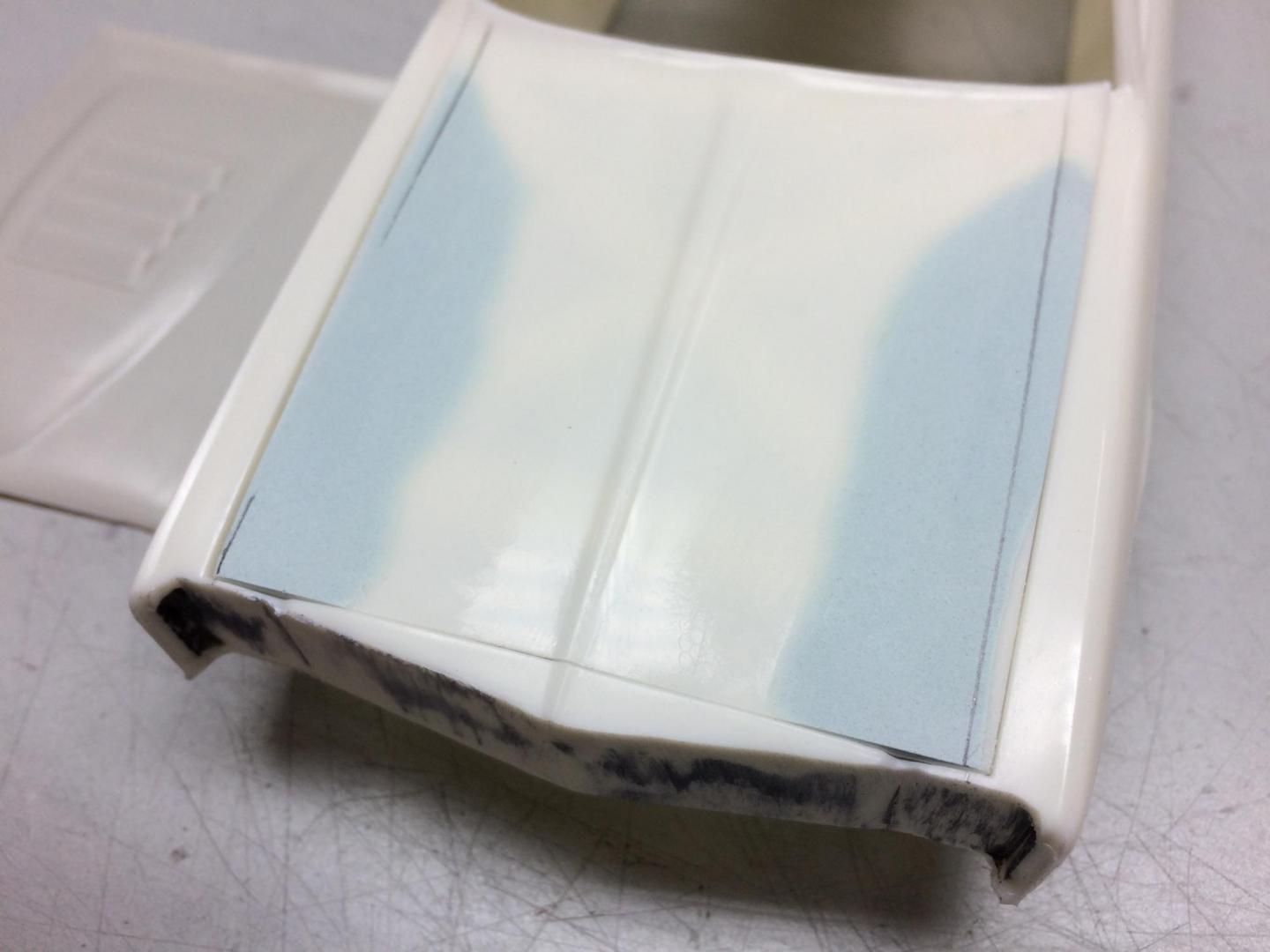

Glued the hood to the body to blend it in. I think I have the shape nearly done but will know more after the primer. This was the tough part. Hard to see in the photo, but the sides (inner of the fender crowns) were sanded hard to deepen and therefore visually lessen the '77 dip. Next, will be to cut out the narrower hood and add the Charger engine bay and wiper panel

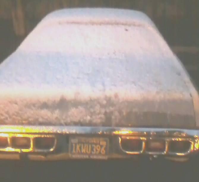

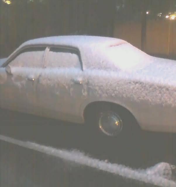

"Strange is truer than fiction..." ! That is my one-time , long-time daily driver ( 2005-2013 ) , covered in actual snow . I recognize that you reside in San Diego ; don't you remember that snow from a couple of years ago ? Never-the-less ... that car was , shall we say , uncomfortable as a daily driver ; to wit :
- No Heater.
- No Defogger / Defroster
- No Radio
- No A/C
- No floor covering
- Completely un-upholstered front seat ( e.g. , worn out cushion , and zero seat cover )
Its good points ?
- No Emissions Tests
- No Smog Devices
- No "Bells & Whistles" alerting you of your every move
- Would run on any gasoline grade ( which , as a side note , I dumped 5 gallons of 110 Ethyl "Racing Gas" into its tank as a ["expletive deleted] you !" to the gas thieves whom were siphoning gas from vehicles in the complex . I wonder how that super-leaded gas treated the catalytic converter(s) of their new(er) car ? Ha ha ha ha !!! ).
- Got an honest 15 MPG average ( 318 / 904 with Trans-Go kit , 2.71 gear ).
But , I digress ...
Have you taken the opportunity to peruse that Hamtramck Historical Chrysler site yet ?
