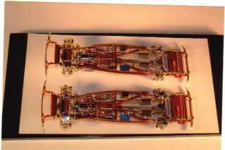

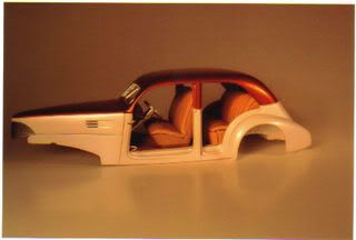

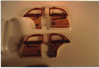

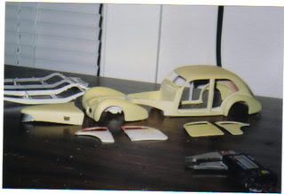

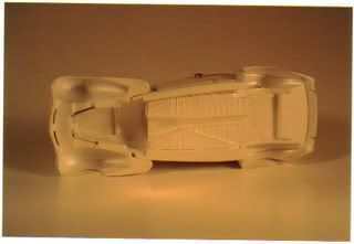

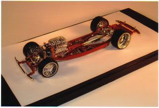

Here are some assembly photo's of the car after everything was finished and ready to go together. The body was finished inside and out. There are no seam lines or visible body work anywhere. The car was constructed as if it were a kit. The body was built as one piece and then the doors and trunk were cut out and then the jams were built and then hinges added. The hood, front fenders and floor pan were constructed separately. Each piece was constructed as a kit individually.
1700 pieces in the two chassis

:o Wow Dave you built it from peices?Like a real car?Did you start with an available kit and modify it or did you actually form the roof and quarter panels and fenders,like stampings?I'mean this rascal just freaks me out, I'm tryin to see just how you were able to do this by lookin at the pictures closer, but they can't get close enough! this build is just incredible to me.Thanks for posting it! :D:D:D

Yeah george, lotsa pieces :lol: . The main body structure has 133 pieces to form the body and rear fenders. There were 45 kits I used for various parts I needed, to cut up and form the body and fenders. I cut up whatever I needed to form a fender, glued the pieces together, added body filler and carved it into a shape. Same for the body. No beginning kit. Just 133 pieces cut up glued together - add body filler and file and sand to shape - WALLA - a 1941 Hollywood.
Add trim pices to the body and hinges and your up to 200 pieces. Add interior and that's another 140 pieces of leather, wood, metal, and plastic.
