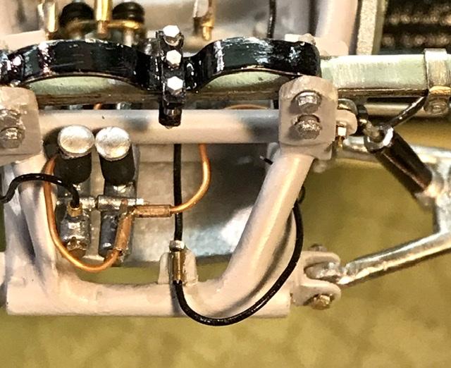

So the hub and spindle are finished and the bolt is screwed into the end of the steering arm - which was made months ago from brass - this was threaded by a corresponding thread tool - which is one of those tools that you don’t use very often but you’re glad that you have ...
Link to post
The steering arm is set with my top secret / xtra special alignment tooth picks....  now about that spare wire that loops thru the front of the frame without a destination.  That is the end of the park brake cable.  The picture of the real car frame is from the Canepa site. They have a terrific walk-a-round of a Cooper Mark 9 with some suspension updates that is for sale - got a spare 100,000 ??  That picture solved my “where does the park brake cable go” mystery - which of course has kept me up many recent nights - thank you Bruce Canepa ...
Link to post
Ok. Made the chassis tab that holds the handbrake and threaded it thru and led it to the slave cylinders - now to the steering wheel and shift linkage ...
