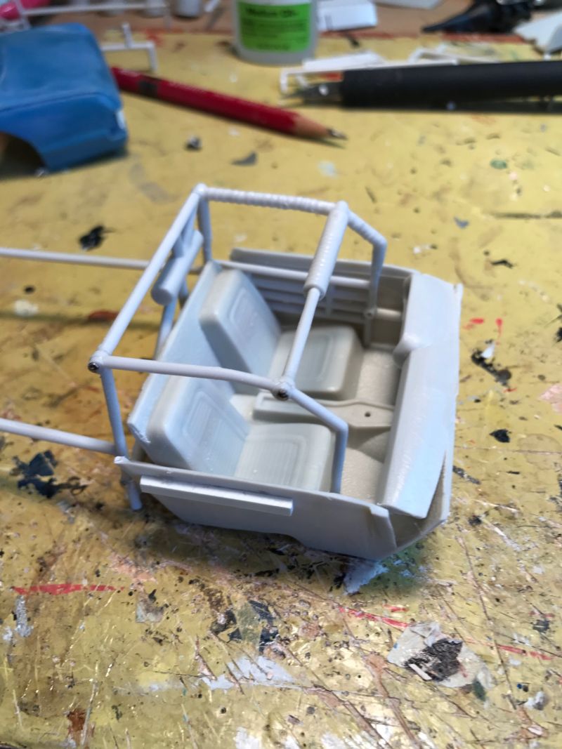

I thinned the sidewalls of the interior to fit snugly into the Valiant body.  Then I added the Evergreen to the exteriors as my glue point inside the body.  Note that this interior was the last hurrah for the '66 Barracuda interior.  It was cut in half and the seats were molded in.  That left me with two seats, so be it.  This will be a modern era exhibition racing car, so you can take a passenger out for a lap.

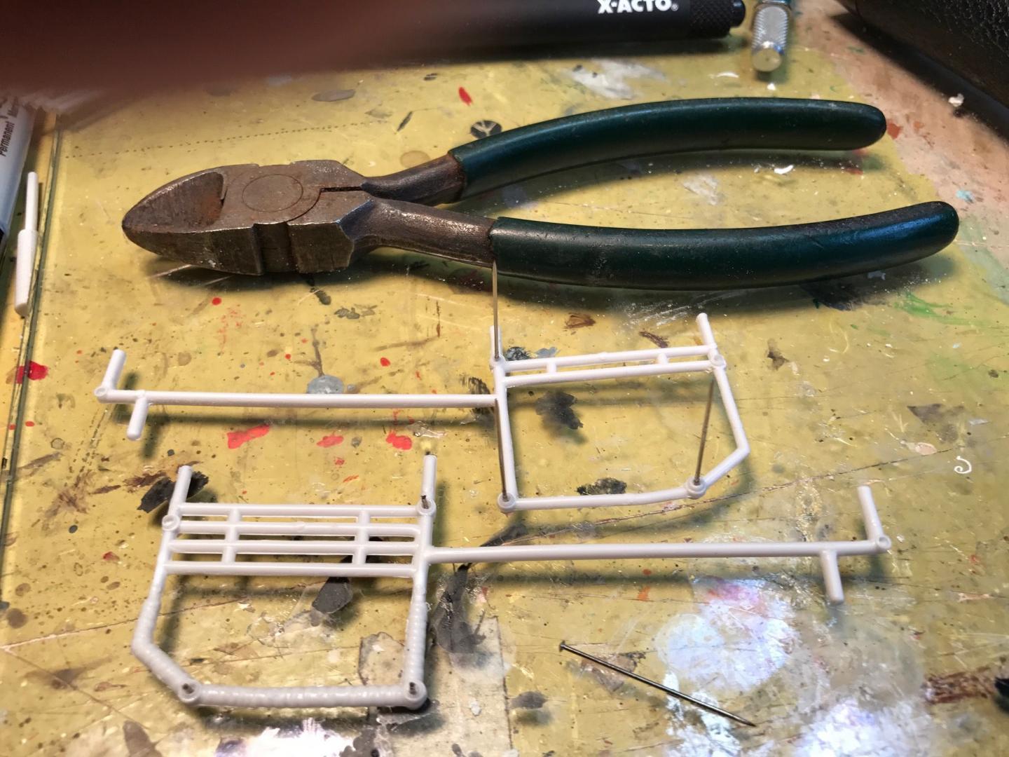

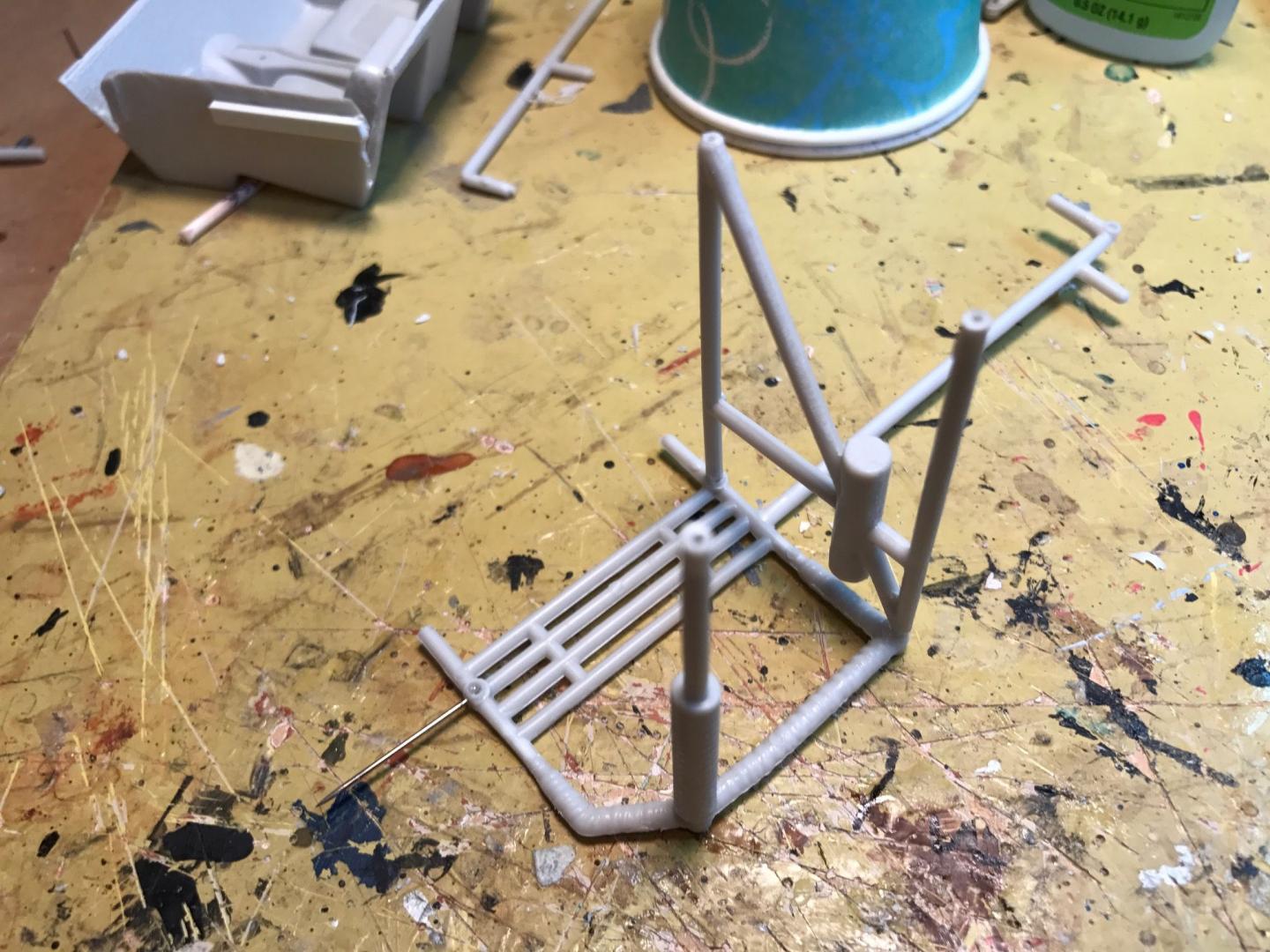

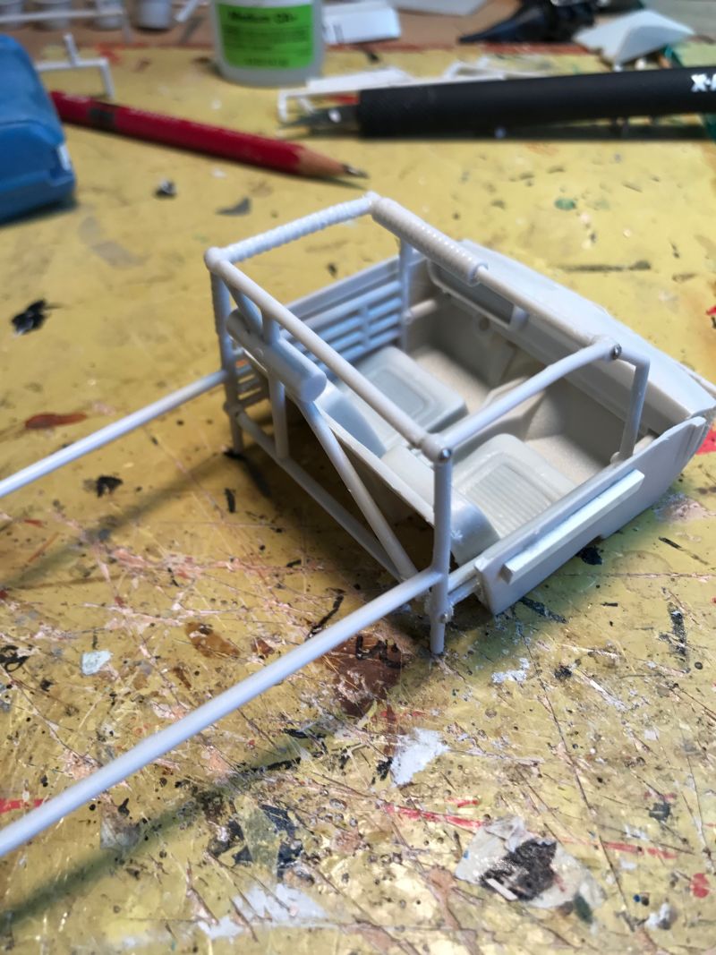

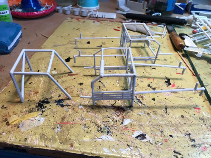

So after I did all those interior concepts and blew through two of the Fireball interiors, I went to the roll cage.  Yea, I built three of them before I got one to sorta work.  The small one to the left was out of the '53 Studebaker kit and was way too low, no doubt because it was meant for the chopped top. The other two are out of the '68 Falcon Stocker.   Somehow I have three of these and I built them all.  The one in the back of the photo is completely stock and was too wide. Then I butchered one to pieces.  The last attempt works.  I narrowed it and made the top half angle inward.
And since I was gonna be tuggin' and pullin' on this cage to get it to the shape I needed, I didn't just glue it together.  Any time I do that I regret it. So I took the tougher trail and pinned it all together.  All friggin THREE cages!  And the one I ruined.  That was a lot of drilling and a lot of pins!
The beauty of doing this is that I can pin it all together without glue, then adjust, shorten, sand as needed. Nothing is glued in this photo.
And here's a final shot of my interior.  I used the stock dashboard from the Falcon stock car. Since this photo, I added plastic sheet to the back of the interior and it's drying now.   Note that the pedals are molded in and are for an automatic.  I am using the stock V8 from the Duster and that's got an automatic on it too.   So we're moving on...

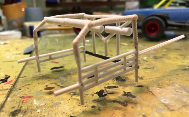

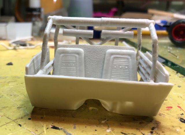

It turned out the biggest hurdle I had was to make a roll cage. This is attempt three, fashioned from the one in the Falcon Modified Stocker kit. It was sliced and diced in a dozen pieces and then reassembled a few times by drilling out and pinning the joints together. I finally got it to fit snugly into the Valiant. Last thing I did tonight was to prime the cage to see where I needed to work on it.

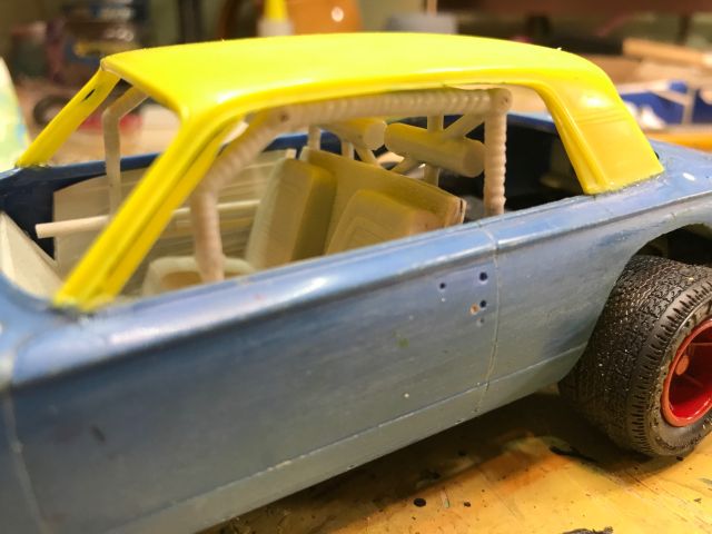

Sharp eyes may have noticed two headrests in the last photo of the cage. Yup, we have two seats. I used the interior from the Fireball 500, since it originally was the Valiant interior. It fit right in. I thought I'd build it as an exhibition type modern car that may exist today. Why not take a buddy for a lap? The back of the cage is actually the back from two cages spliced together. Yea, there are a lot of pins in that roll cage.

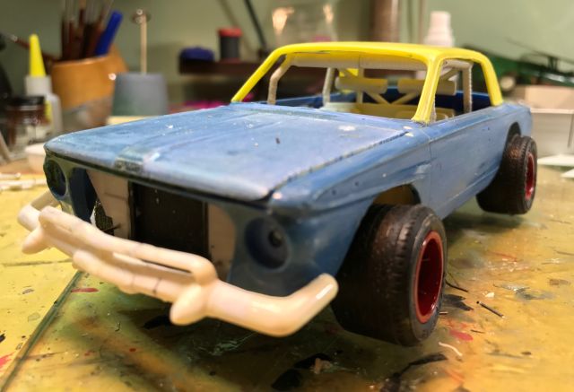

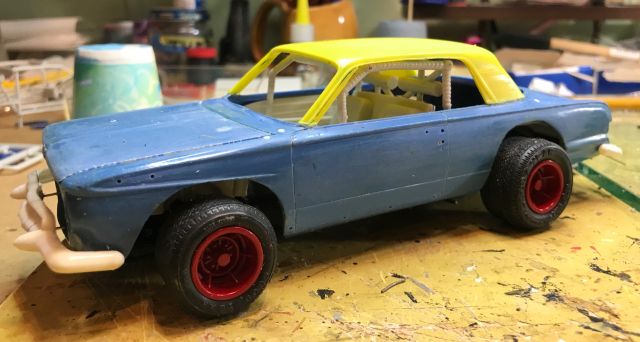

Here we are up on wheels. I shortened the 1971 Duster chassis 5 scale inches and modified it to fit into the Valiant body with hogged out wheel wells. I also created the exhaust system to fit the mount holes in the chassis from multiple parts each.

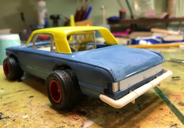

I started out with a stray and abused Valiant body, and with the current parts situation losing ModelHaus, I wasn't going to sacrifice '63 Valiant bumpers from a clean kit! So I made some. These started life as '59 Chevy units. I spliced them a few times, to get what you see here.
Side view. I did paint those wheels today too.
Interior fit- I finally got the roll cage to sit where it needs to be. The Falcon cage was too wide and pretty much square, where the Valiant greenhouse tapers in on the sides. Dash board is not shown in this mock up, I'm using the one from the Hemi Under Glass.
Rear View- Another 59 Chevy bumper set out from the body.  So this is where I'm at today. Still a lot of work to go!

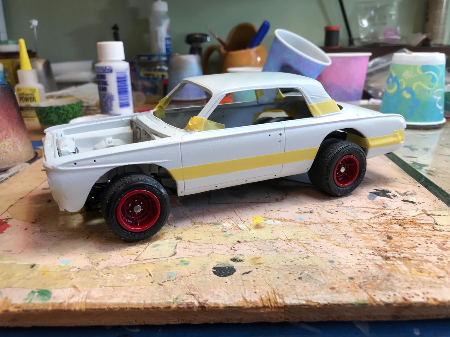

The car has it's first color of white over gray primer, all Duplicolor.
Here I'm using Tamiya Tape prior to adding a second color. The side coves, as taped off and the roof will be white. The rest of the car will be red to match the interior. I'm hoping to spray tonight.

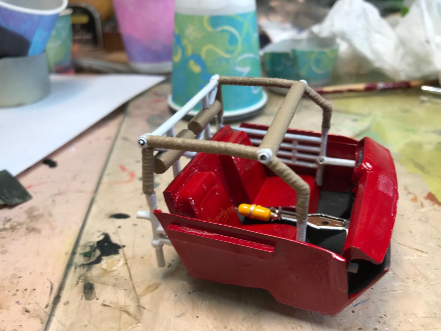

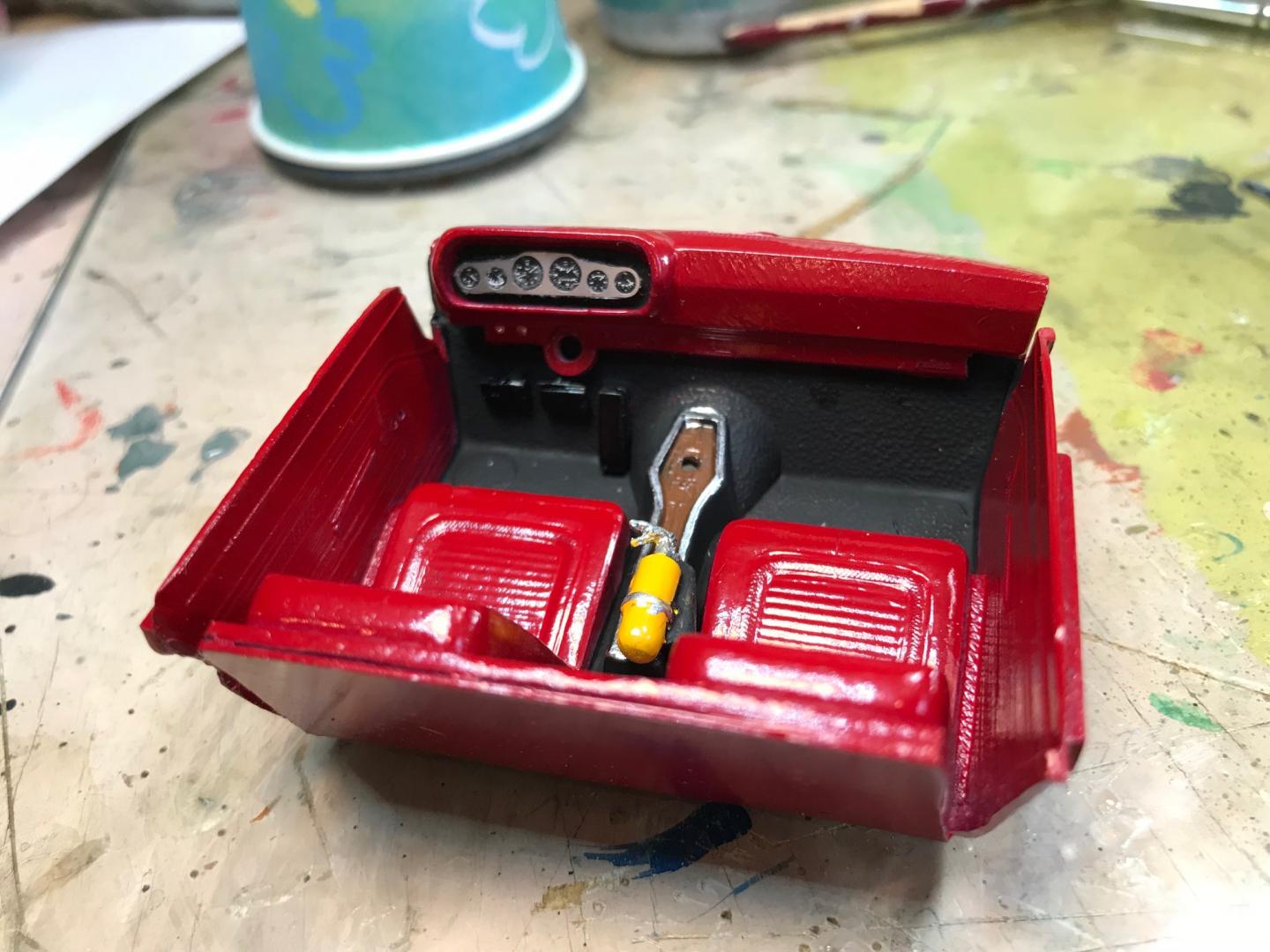

The interior is nearly done. I just have to add details and fashion up some seat belts. The roll cage is heavily modified from the Falcon Modified stocker... it was only too tall, too wide and too long.  I ruined two of them fabricating this. There are something like 20 parts, all fused together with lengths of straight pin  or bendable wire where I needed to make adjustments.
Dash was also swiped from the Modified Stocker, with a Detail Master gauge set.  You really cannot see the pedals here, they came from the '71 Duster.

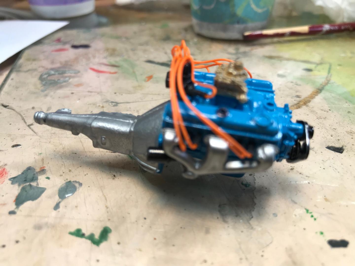

Engine is ready to mount in the chassis. It's the 340 from the Duster kit, so it matches the chassis. The only modifications in the installation are that I had to take 5 scale inches out of the drive shaft to match the shortning of the chassis.  And I made an exhaust system.
