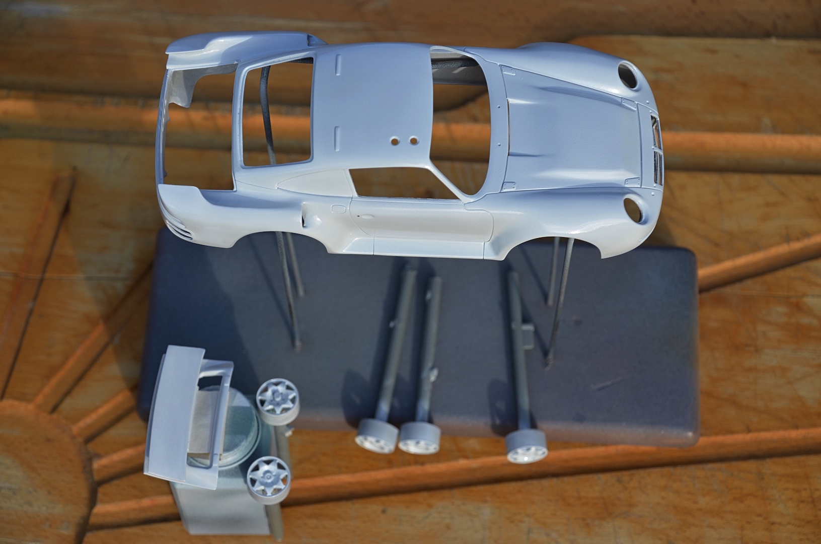

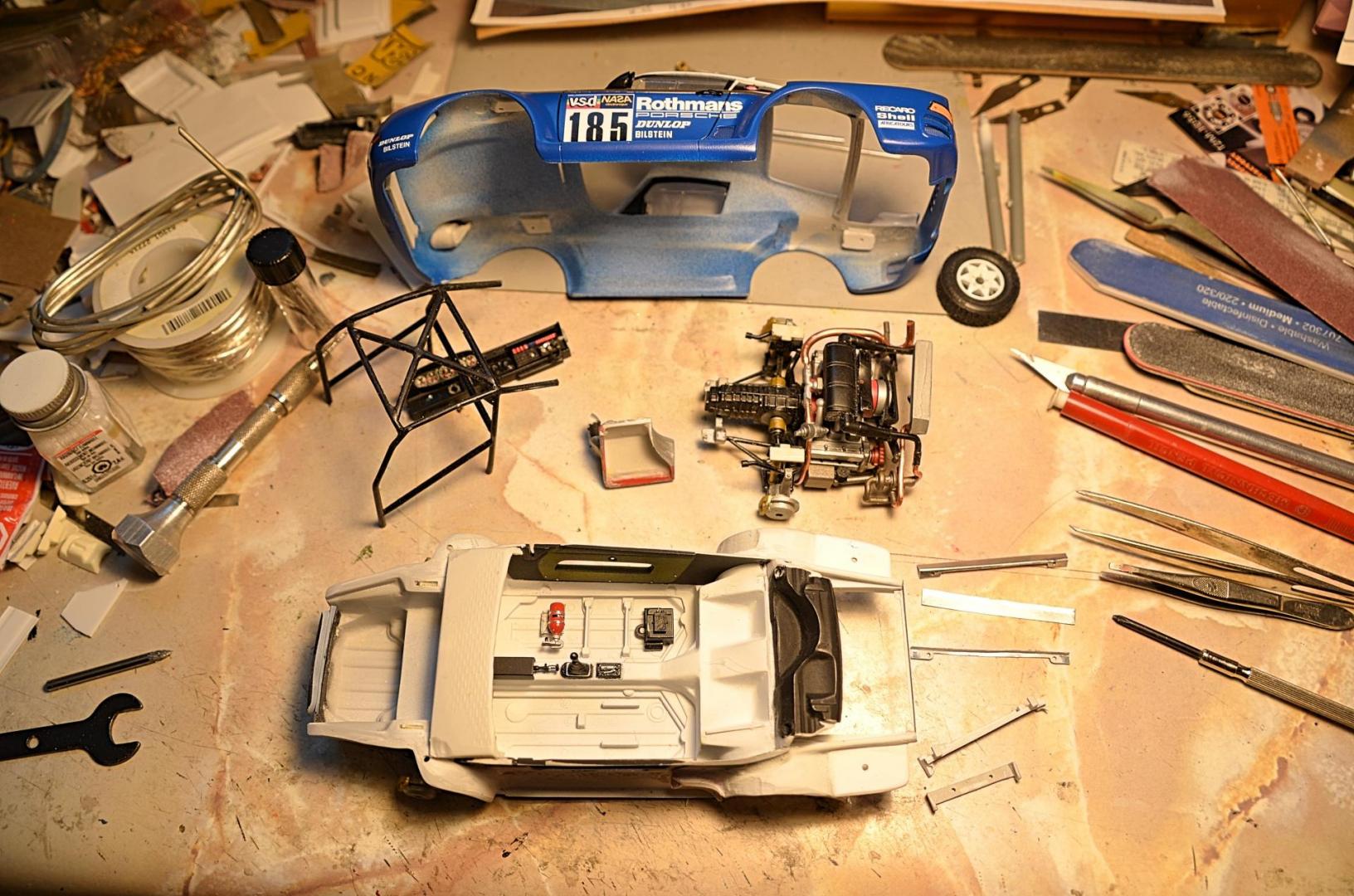

89AKurt Posted May 8, 2018 Share Posted May 8, 2018 Seeing if I can stay sane building two models at the same time. The Paris Dakar 959 is a really nice resin transkit, and I could not let the donor kit just sit in the box, so I am also building something different. The fun thing about a project like this, I need to be accurate with the race car, but can design as I go with the Speedster. A disappointment is how Tamiya left out the intercoolers and piping, and the transkit ignores that feature too! The Paris Dakar 959 pushed the envelope in it's day, and I have seen 1:18 die cast models. But it really needs to be done like it was rode hard and hung up wet, perhaps scraping it along the ground will add appropriate texture. I have found some fitment issues, otherwise so far so good. The Speedster, I know it would be sacrilegious to hack up a real 911 Speedster and 959, but that's what's fun about models! I built a 930 slant nose Turbo Speedster with some of the parts, other parts are in another project (stalled for some time). I'm thinking of hinging the door on the bottom, so it could be used as a camera car. It's also just a Curbside. Good & Evil Twins. Quote Link to comment Share on other sites More sharing options...

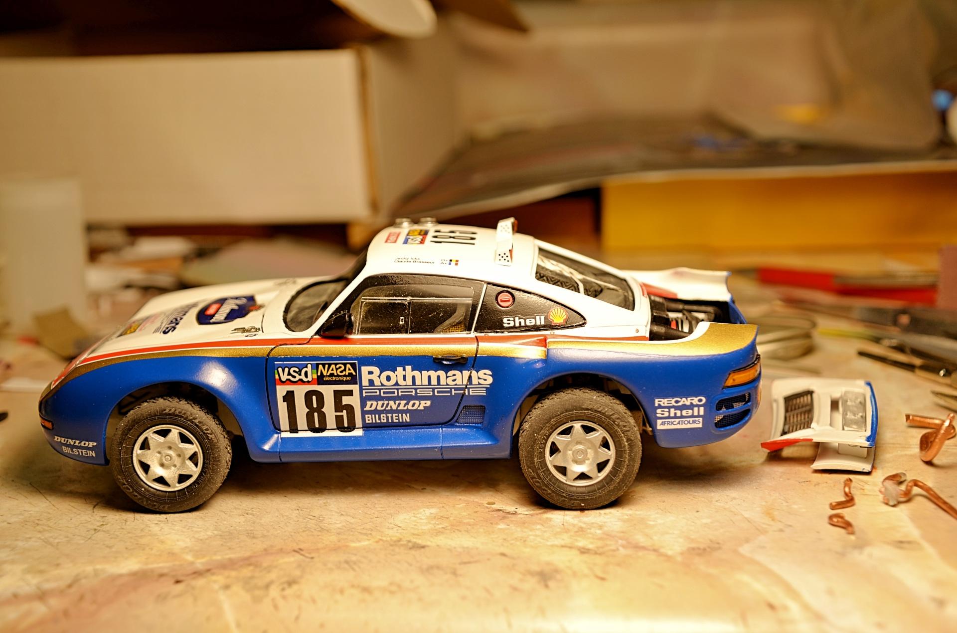

89AKurt Posted July 11, 2019 Author Share Posted July 11, 2019 On 7/9/2019 at 3:35 PM, Dann Tier said: Absolutely STUNNING, bud!!!! Hold yer' horses pardner, I ain't done yet! Got the last decals on the body today! I cut apart the piece on the engine lid at the grill, cut the long stripe at the headlights, and cut out the grill openings at the front, with 45° cuts so the edges would get covered. Really had to nurse these to get them to conform, Solvaset barely helped! The door windows are really high quality resin, hard to cut off, used the Dremel, then sanded the lower edge until it fit snug. I had wet-sanded slightly to get rid of dust bumps. Then I realized that I needed to get red paint, good thing Hobby Lobby is 10 minutes away. Touched up red, blue and gold spots. I airbrushed a quick coat of clear gloss, did not want shiny. Used a micro pen to do the jamb lines. Bare Metal Foil used on the latch plates, and light reflectors. Glued on everything but the windshield, headlight covers (want Elmers to completely dry). Photo-etch parts are next! So this is at museum condition, if I wanted to. But the next steps are going to be really fun! Going to grind the lower front valance, and especially the skid plates, into the street! Then going to stab a worn out paintbrush into acrylic paint mixed with tile grout, and go nuts on the bottom, then several layers of dust and dirt sprayed on. I can hardly wait! But really need to finish the engine next. Funny note: they did not have the KKK Turbolader Schmitthelm sponsor logos on during the race, only after Porsche kicked butt did they want it, and car 186 has Michelin tires mounted. Quote Link to comment Share on other sites More sharing options...

89AKurt Posted July 11, 2019 Author Share Posted July 11, 2019 5 hours ago, porschercr said: Looks Great! Thanks! 3 hours ago, Ensis Ferrae said: I personally Use Microset/Microsol, and one thing I've found on super bendy/rounded shapes with multiple angles/curves is that it can take 3-4 applications of micro sol with lots of drying time in between. Love the car, love Porsche in general, and I can't wait to see what weathering pictures are to come. I think that is less harsh on decals, when I've encountered delicate decals that melt with Solvaset, I use Microset. Neither can I, but I really REALLY need to face the challenge of the intercooler, before "weathering" it. But, I did glue on the photo-etch hood pins! The instructions show the two parts incorrectly, I studied the museum pictures to figure out how these work, and I still don't know, but I rotated the top part, and they look closer to the real thing. Pet peeve of mine, not realistic mirrors. I salvaged the mirror from a dead digital camera LCD. The Waldron punch had the perfect size. The Nikon 300MM lens has a very short depth of field, so can't tell it's really reflecting. Quote Link to comment Share on other sites More sharing options...

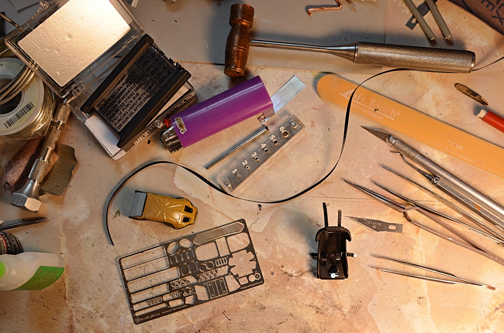

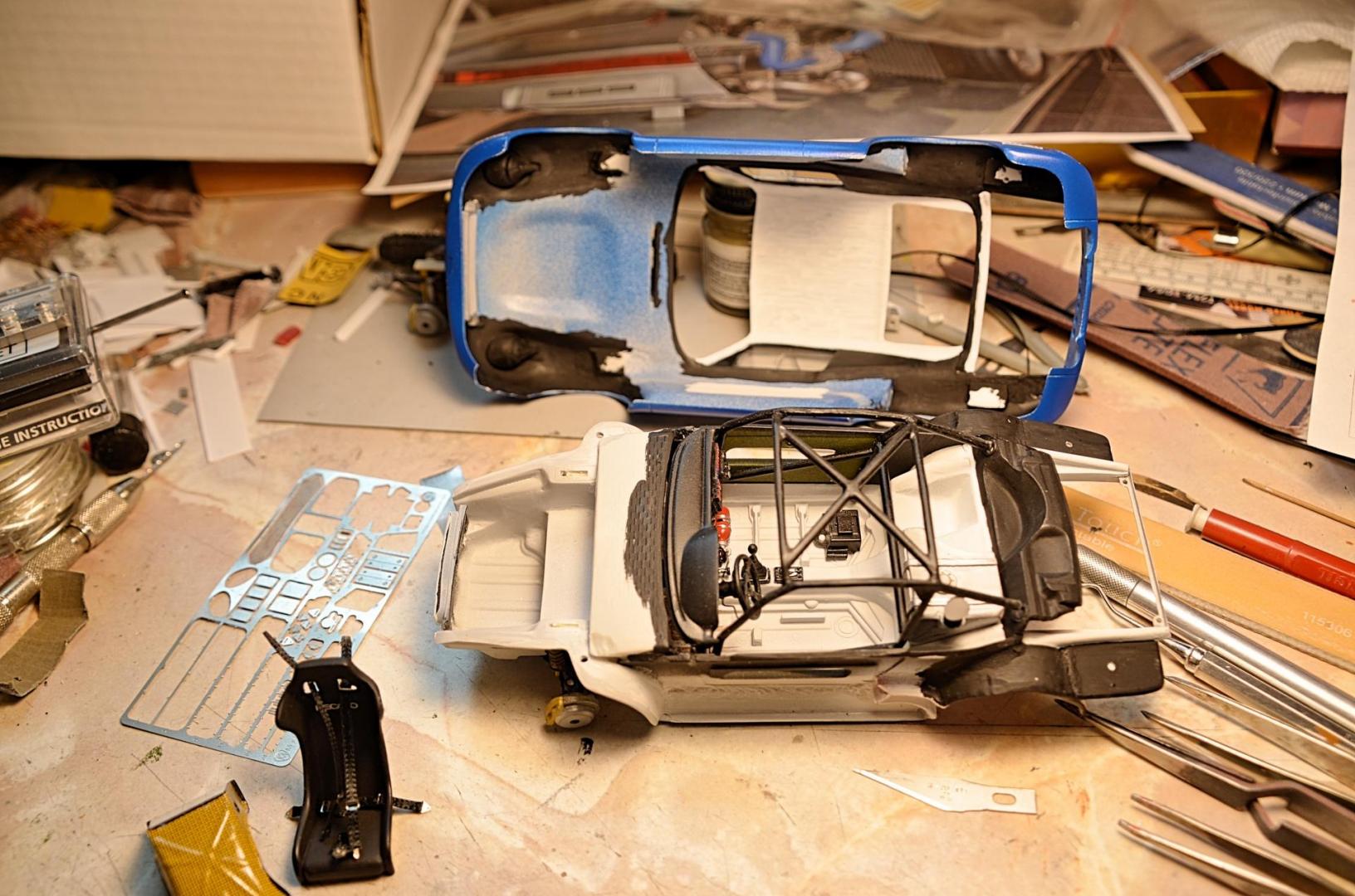

89AKurt Posted August 19, 2019 Author Share Posted August 19, 2019 Vacation took the wind out of my progress, finally resumed this weekend. I had to review what was done, and decide what should be made accurate, what should be super-detailed, what needs correction, and what would be good enough to look realistic. First thing to correct was the aluminum engine support at the tail end, the first one looked like it was salvaged out of a wreck. I had acquired a photo-etch bender since then, so it took only three tries to get a better looking part. Added more plastic plate where my screw body/chassis mounts are. The black interior panel that is under what was the back window was bugging me too. I have added some flat panels to eliminate the see-through hollow look. Next task is seat belts. Is there anyone who really LIKES doing this?? Thought the kit had belt material, but I may have misplaced or forgot it didn't, so used fabric ribbon. I might figure out how to thread it through the p-e parts, super-gluing the ends a little, cutting one side with a taper, expecting to cut the end off before putting on the last piece seems to work. I punched out an aluminum disk to add depth to the buckle part. I don't like brush painting at all, but in this case it's better than masking like crazy and/or having overspray. Inside the body got painted, in the case of the interior I assume the body was painted white. There have been part conflict fitment issues, and the roll cage is the next thing to be screwed with. Next thing to "fix" is making a spare tire mount, the lousy instructions just show it dropped in, but the photo of the model on the last page shows straps to hold it in, but still level, race pictures shows it was mounted against the "window" panel. Also need to make some cargo items to fill up the back. Once the interior is done, I can assemble the body to pan. Then the dreaded turbo plumbing. Quote Link to comment Share on other sites More sharing options...

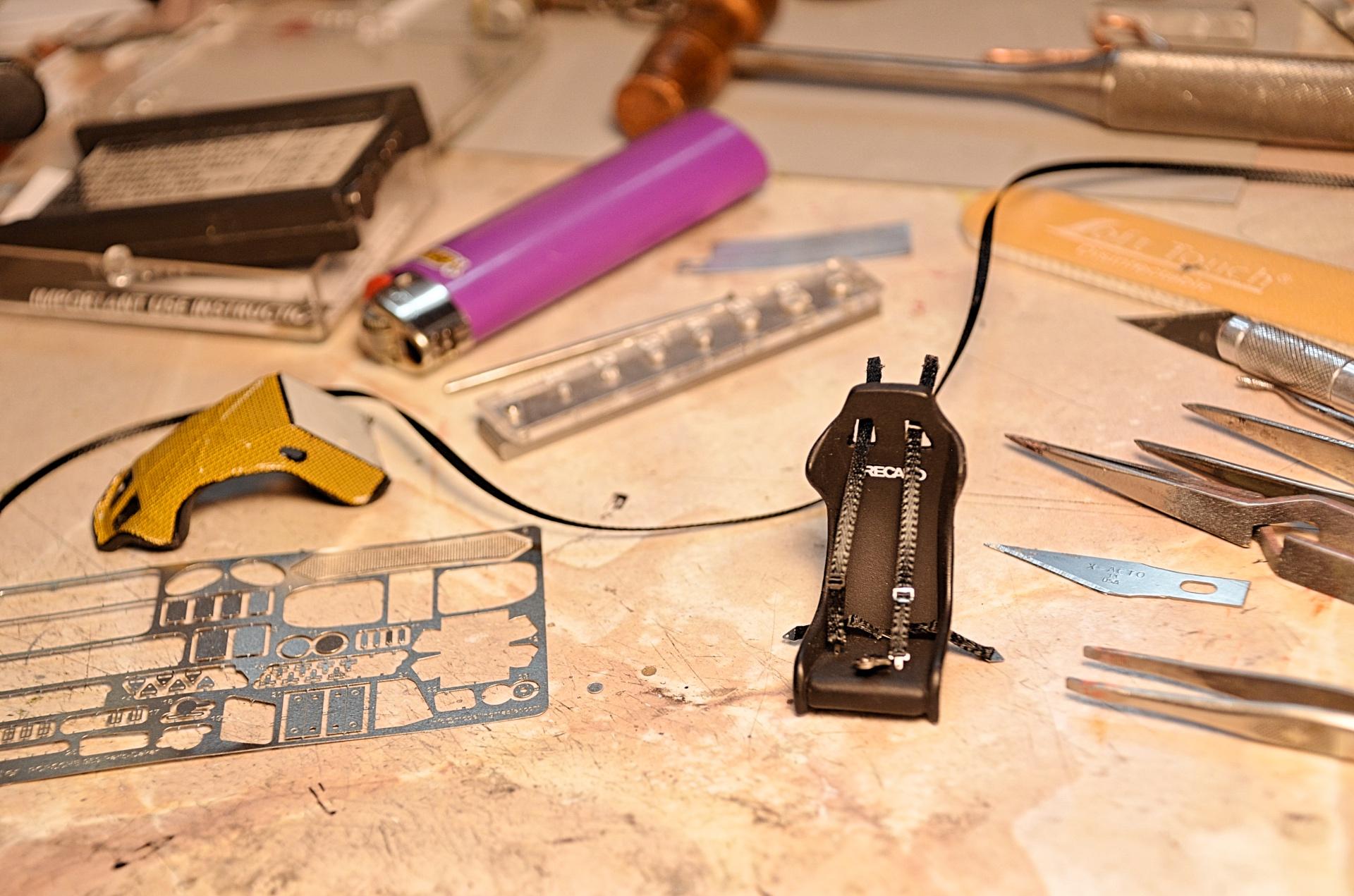

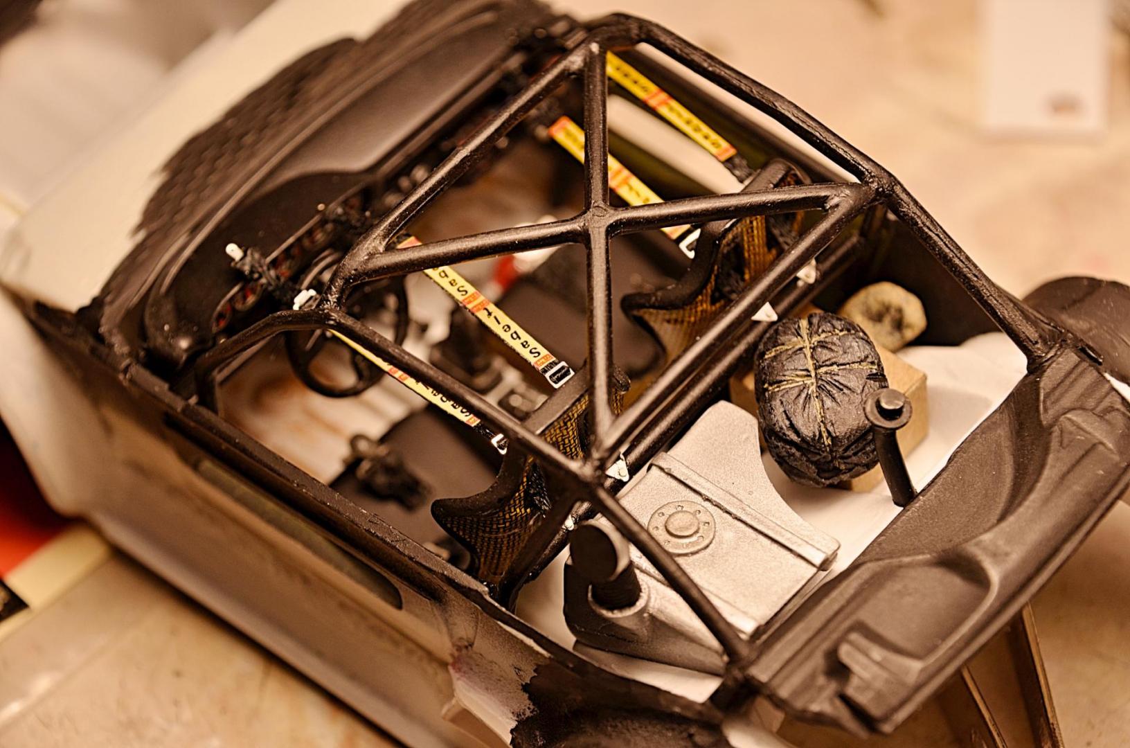

89AKurt Posted August 20, 2019 Author Share Posted August 20, 2019 Almost done with the interior. Made the spare tire mount from solder and punched a plastic disk, drilled a hole in the pan, glued it in. My theory is they kept it to a minimum, and nobody is going to see it anyway. Made a cardboard box, cut a wood block, wrapped with grocery sack that is cut like a box. The second bag is one I made for my VW Beetle project, it filled a corner good enough. The black bag came with the transkit. The shoulder belts have the decal for the label, I taped down the belts, applied some Tacky glue into the belts where that goes, then applied figuring the combination of the glue and decal adhesive would really work and it seems to (fingers crossed). There was no indication how the belts attached to the cage, so I just glued on behind the seats, then added photo-etch nut heads to the tiny holes on the kit parts. I will spray flat clear with a drop of tan in the interior, then glue down the belts, and then dust with tile grout. Last things to make will be water bottles, they had to have carried water in the freaking desert, saw a video of a race in Egypt and caught this pit stop. Quote Link to comment Share on other sites More sharing options...

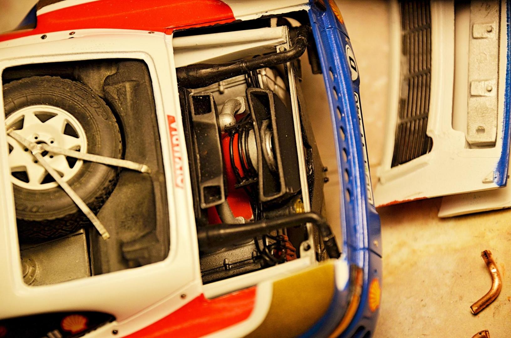

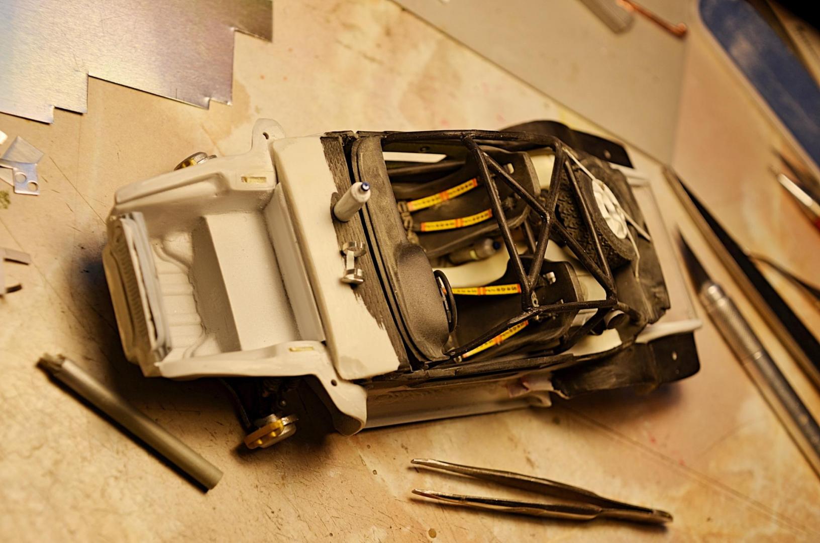

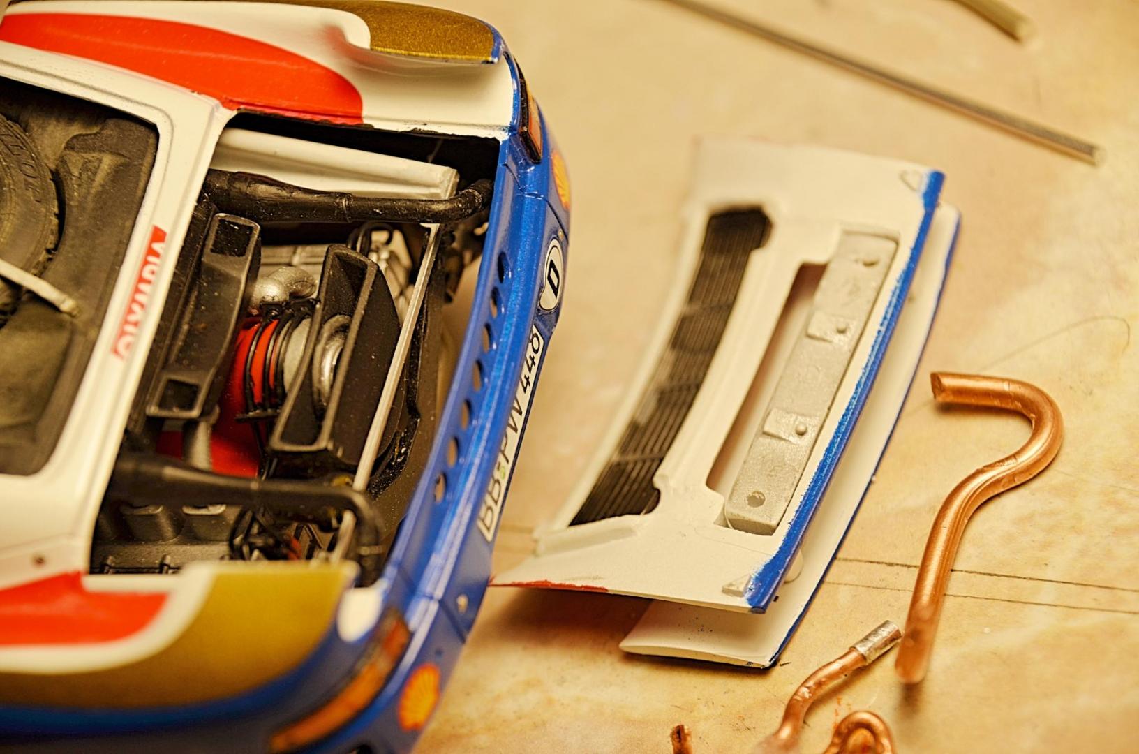

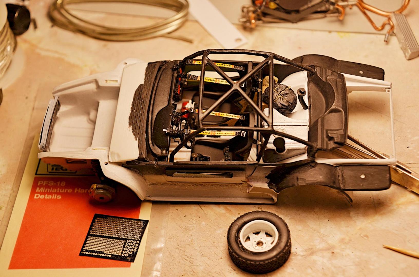

89AKurt Posted August 22, 2019 Author Share Posted August 22, 2019 I'm determined to finish this! Have a model club meeting this Saturday. ? Made water bottles from sprue, and cages from aluminum plate. Added plug wires to the engine, before gluing it into the chassis. The wheel shafts need to be trimmed down, that's why they are sticking way out. Hope this is the last time screwing the body and chassis together. Fabricated the spare tire strap from paper and photo-etch fret. The intercooler is to be glued to the hood, zero turbo plumbing in the original Tamiya kit and transkit. This drives me nuts! Need to fabricate a convincing mount for the intercooler, and redo the piping. I cut the turbos apart, rotated the compressors so the outlet points to the center, not outward. Gonna be fun cramming all that into the remaining space. Quote Link to comment Share on other sites More sharing options...
