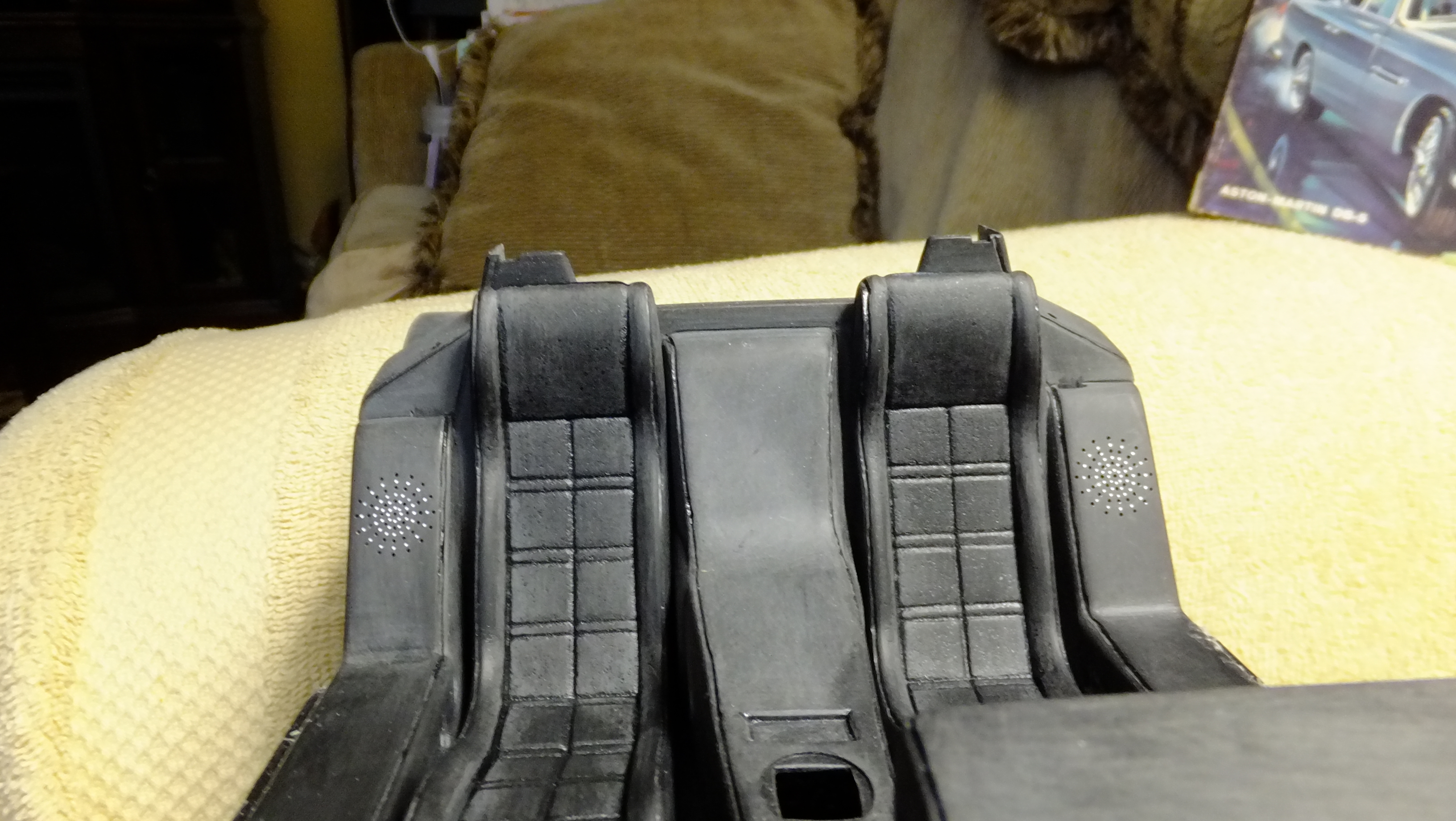

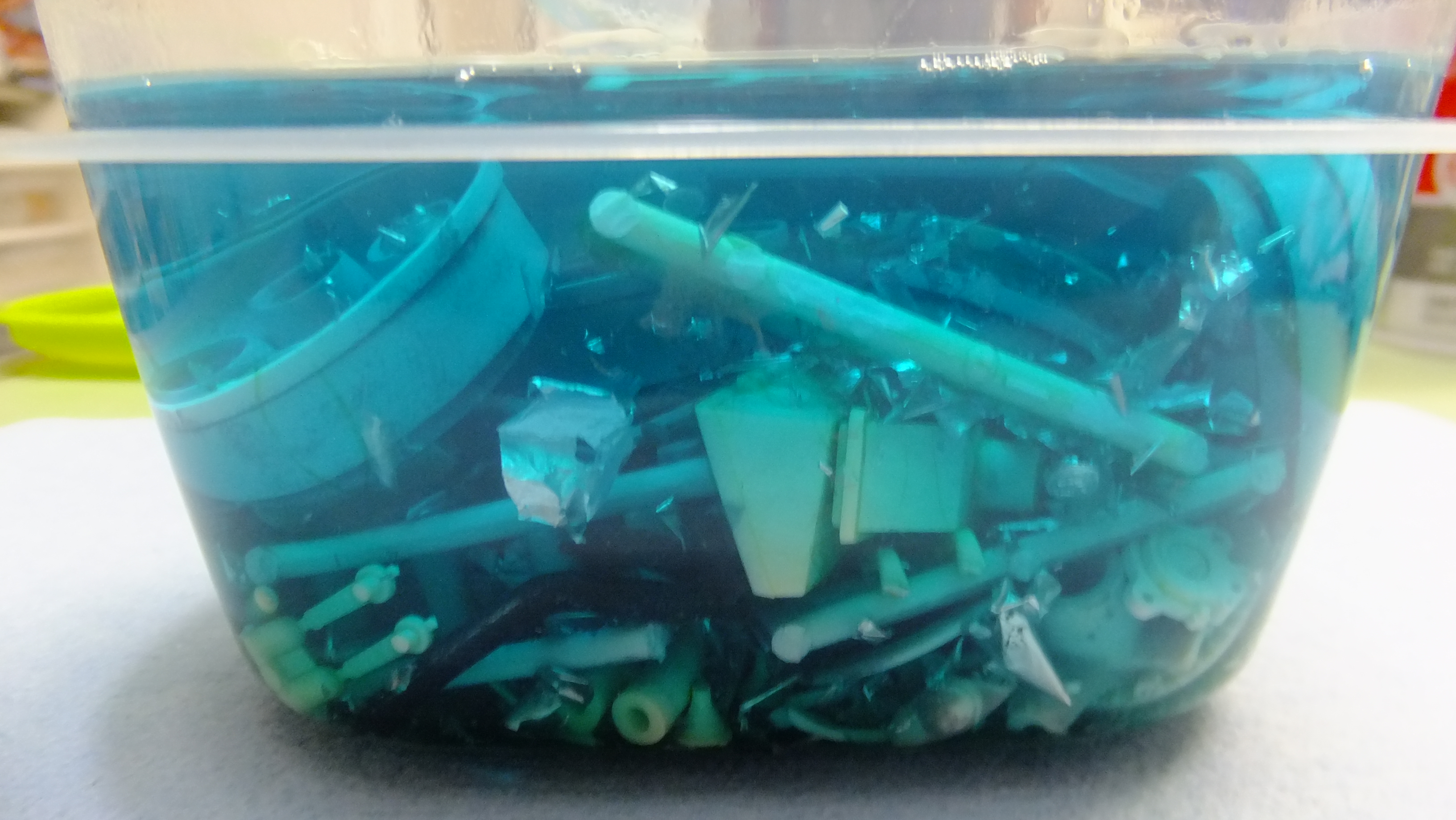

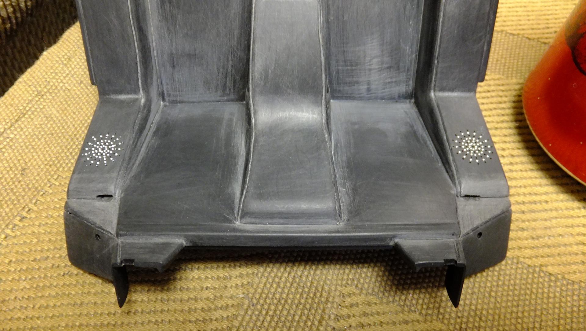

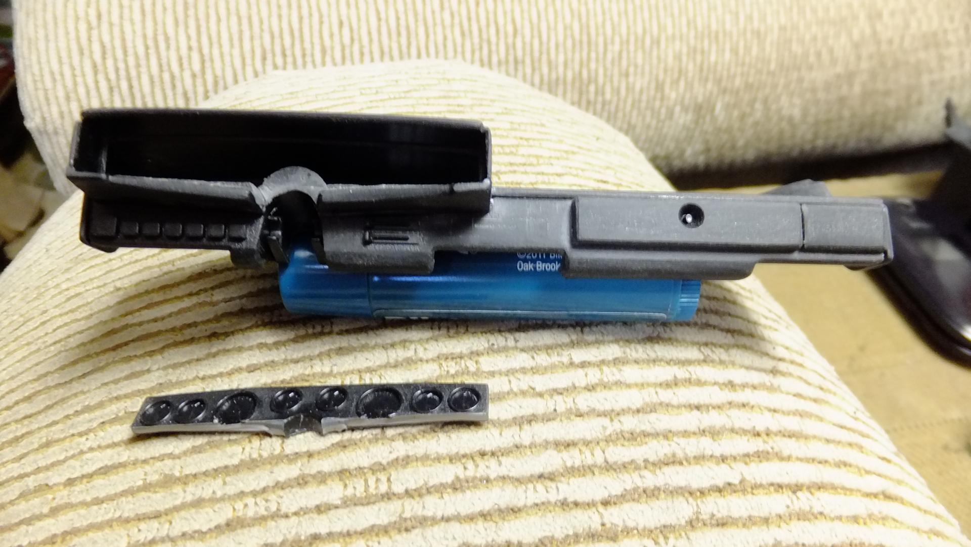

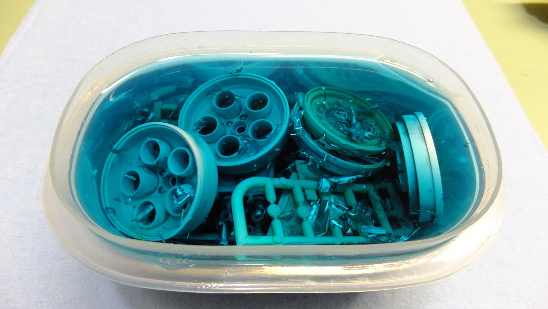

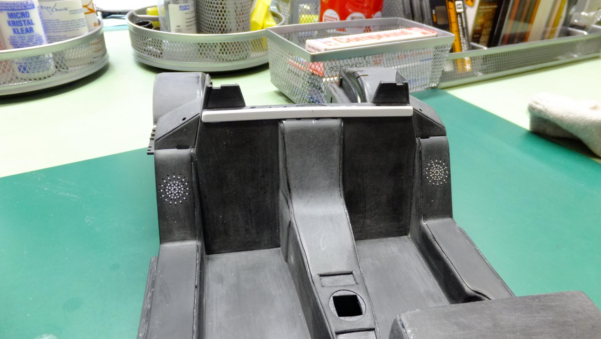

 After rounding-off all the edges that were too sharp, I used a white colored pencil to mark where I needed to scribe the stitching seam-lines. Lamborghinis back then were hand made, so I didn't scribe perfectly straight lines, and some plastic "sagging" was left to help create realism. I opened up the shifter hole, so that it could move through the gate better. I will be scratchbuilding new seatbelt tie-downs, interior light, newer e-brake, better center counsel knobs, firewall trim that goes behind the headrests, and whatever else pops into my head as I go along. After painting over the speaker grilles with flat white, I drilled-out the holes. There were too many holes compared to my reference photo, so I drilled-out every other hole, and it looks great! To make it easier to fill, and sand the joint-seam on both sides of the guage enclosure, I first cut out the gauges, then glued, and sanded the two dash halves. I sanded off the stereo since i'm going to scratchbuild a newer one, and I cut the seatbelt slots where they retract to. Lastly, I stripped ALL the chrome parts.....especially that CRAPPY gold stuff!!!

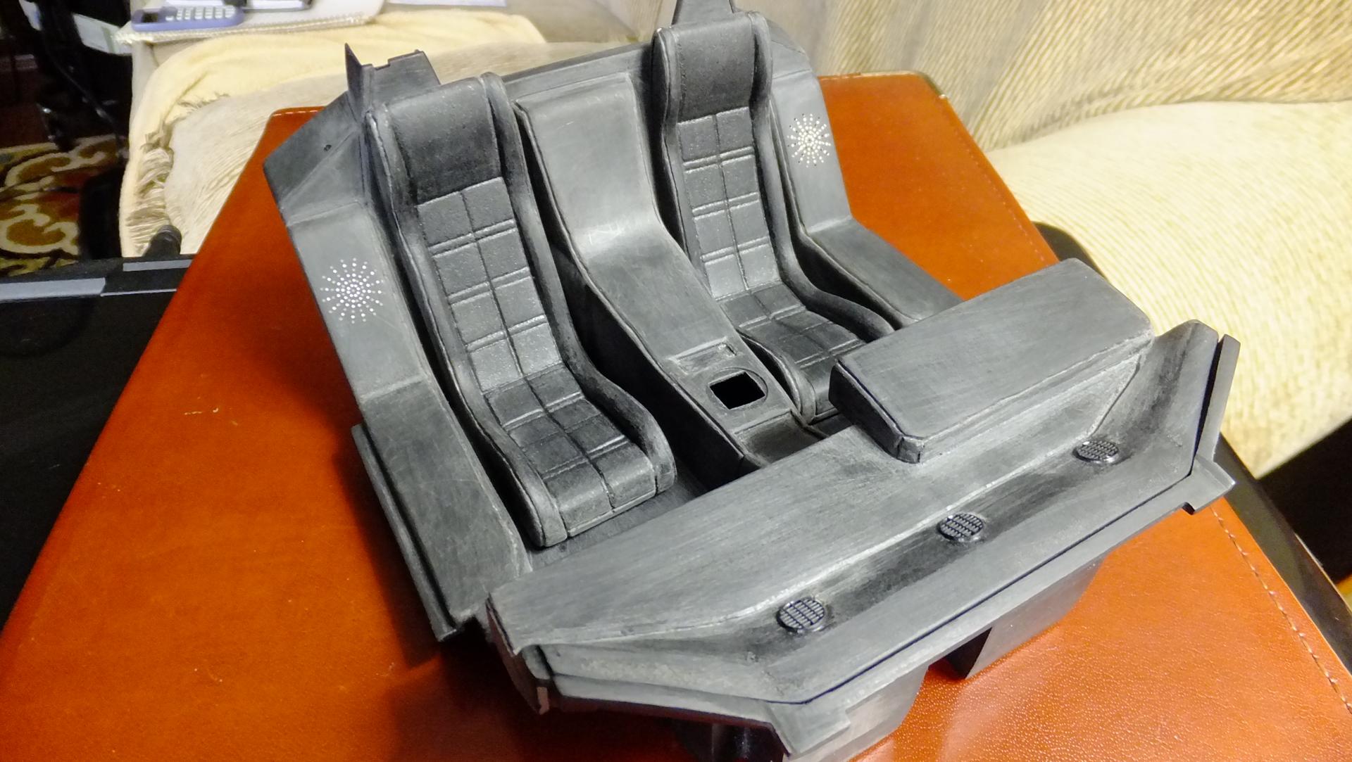

Actually got some more done on this!

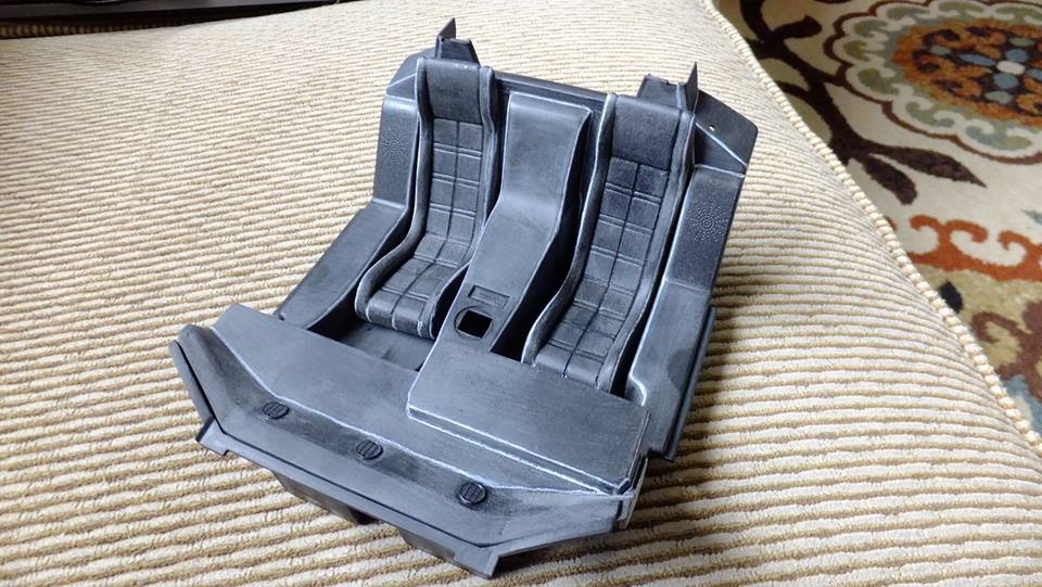

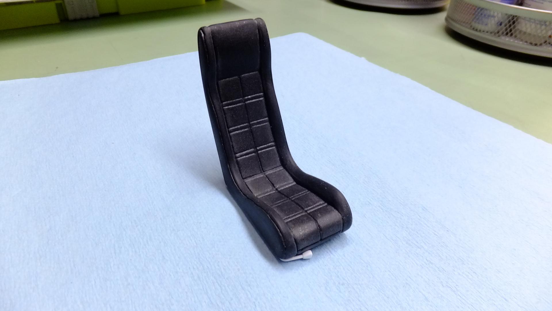

-Photo 1; To level the seats, I had to make brackets, which in turn, also helped provide a better glue point. Next step, will be making the slides, and adjustment levers.
-Photo 2; Notice the now level seats.

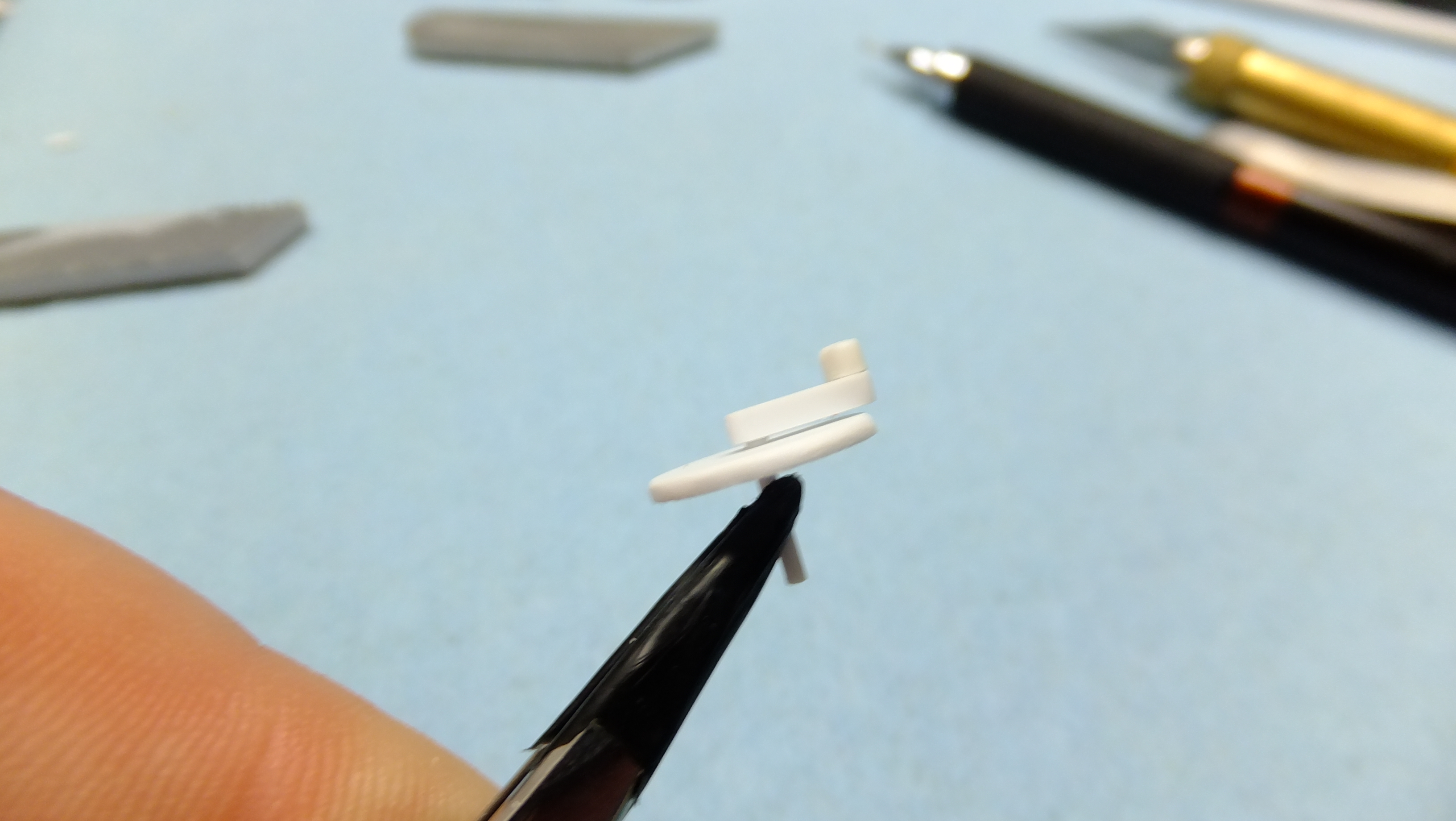

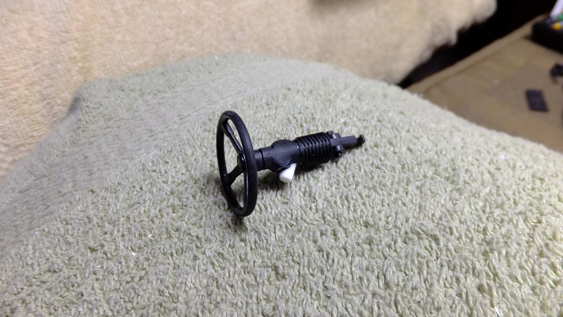

-Photo 3; I scratchbuilt the ignition switch, but like everything i'm posting today, it too needs to be kleaned up...….also shortened.

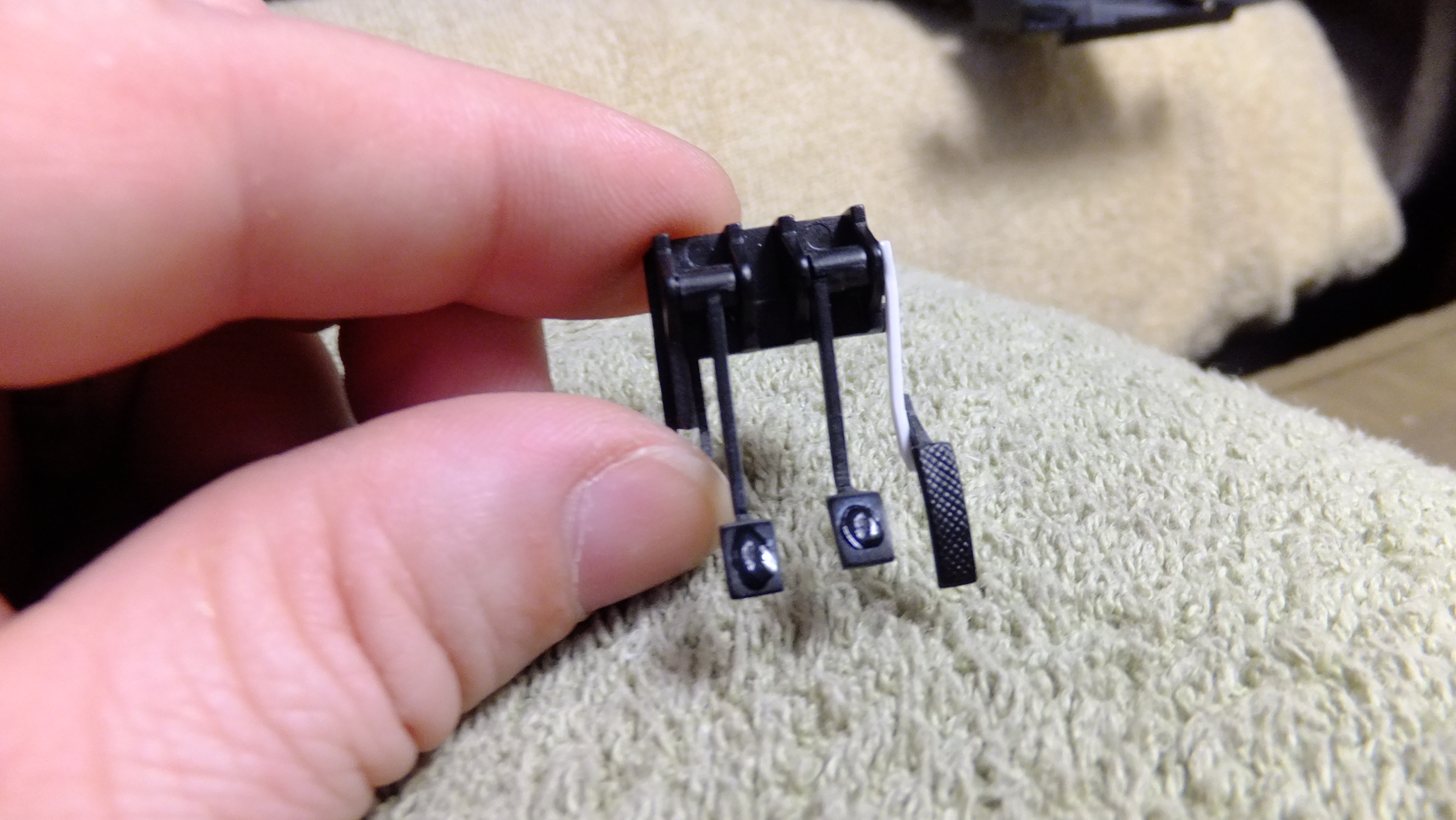

-Photo 4; I fixed the peddles by moving the brake one slightly to the left, and then attaching the gas peddle the way it shoulda been done in the first place. I used Super glue to fill-in the sink holes.

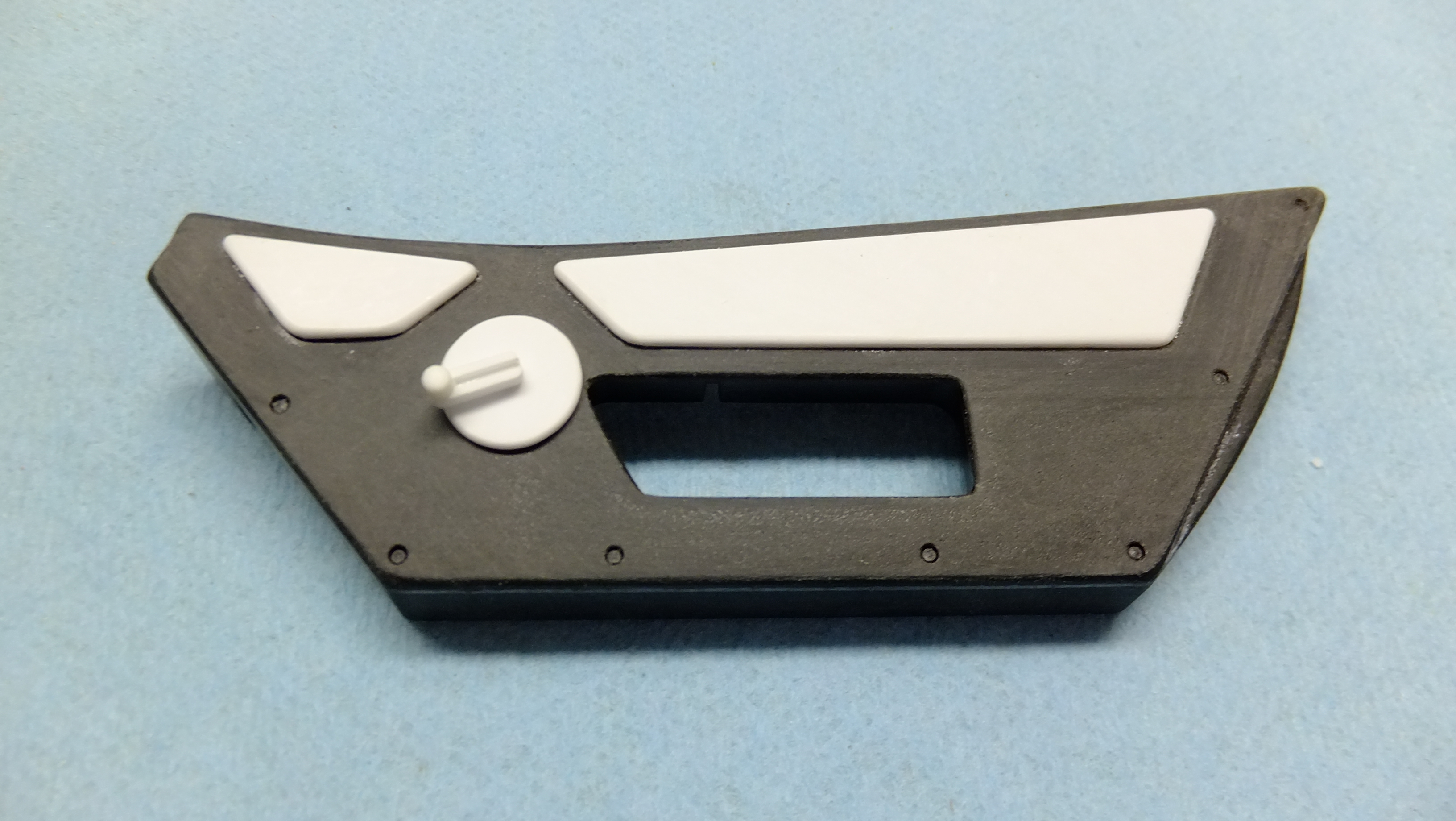

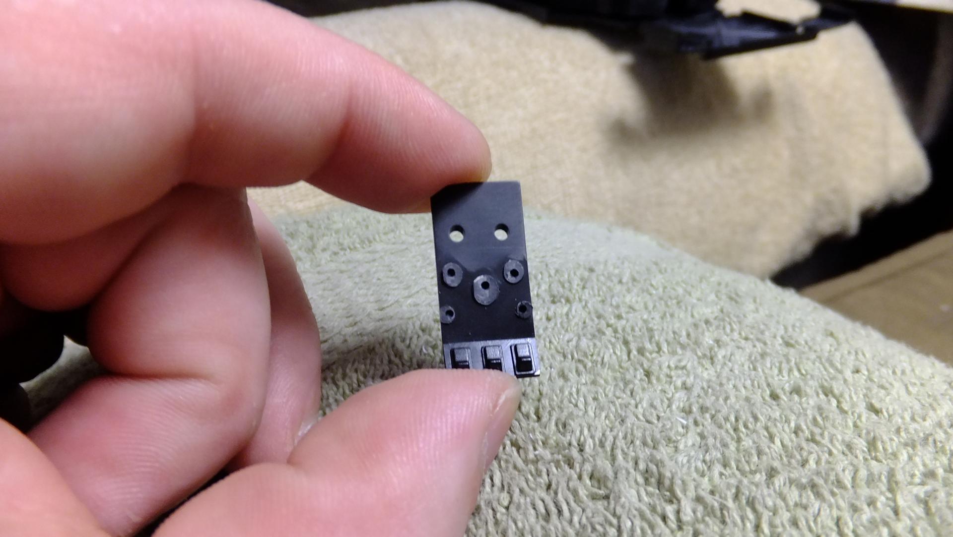

-Photo 5; I cut off those fake-looking knobs, and drilled locating dimples for when I make better knobs.

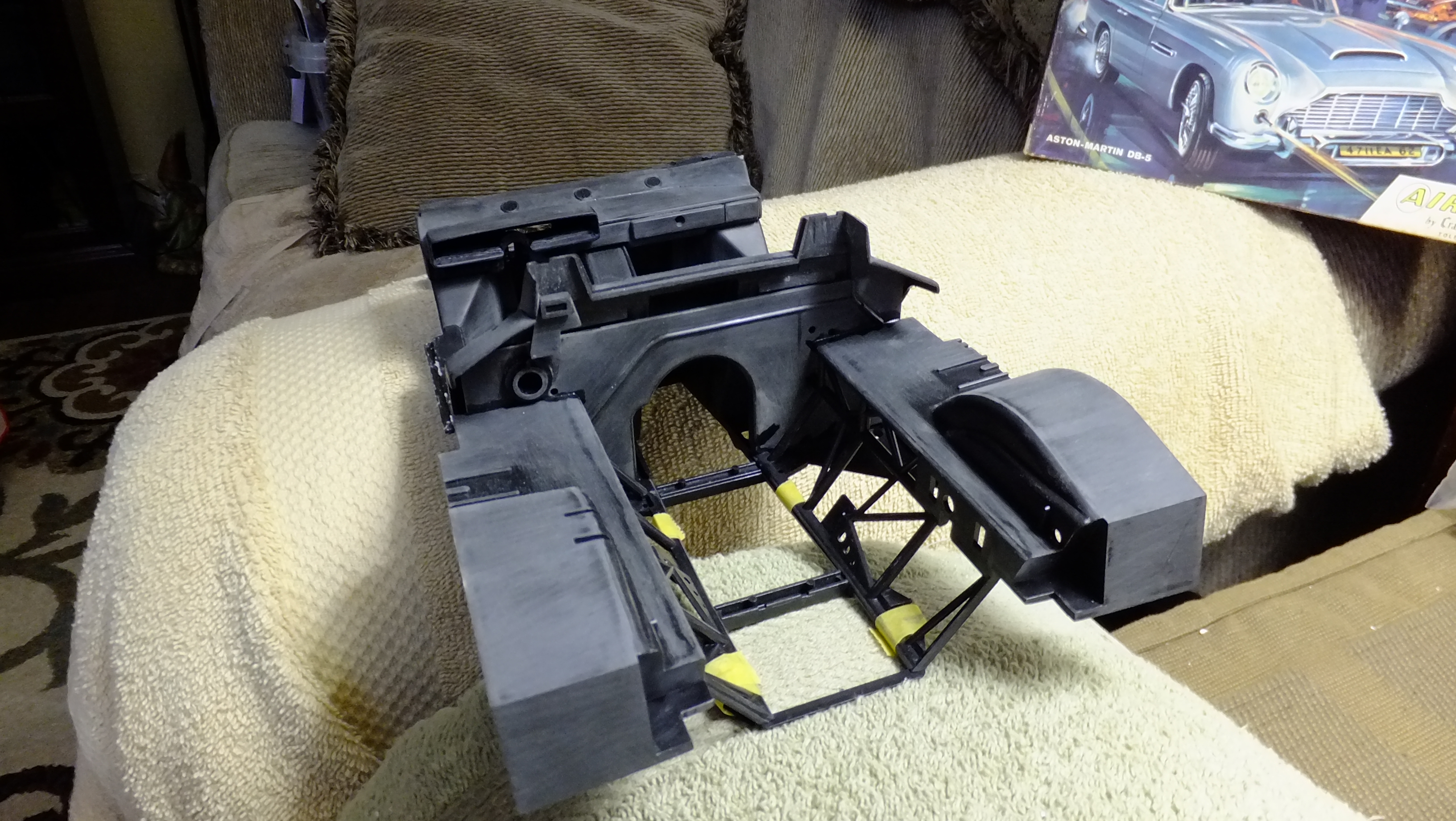

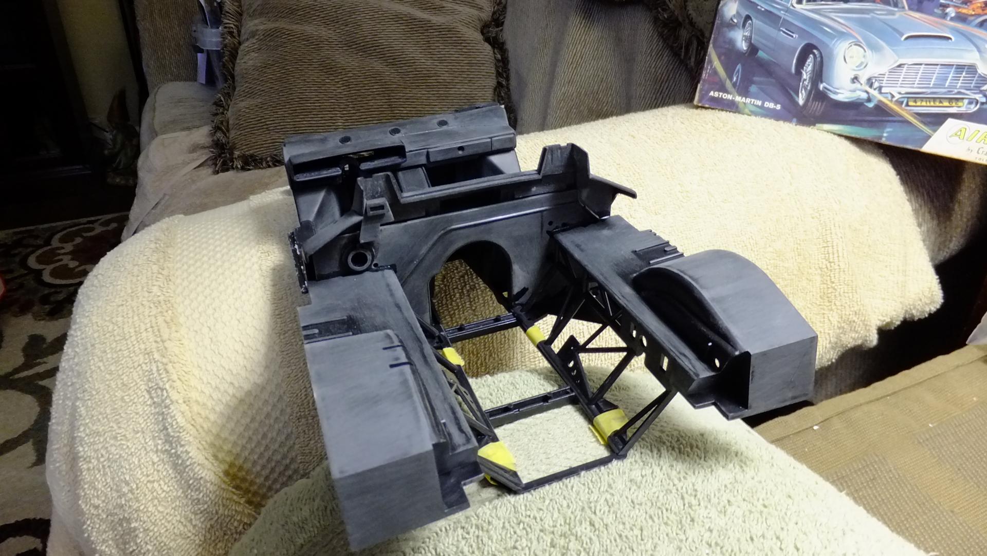

-Photo 6; I thought it was a good idea to assemble the firewall and rear frame work, since even at this scale, the lower frame IS very fragile. However, I couldn't glue the vey end yet, due to the fact that the control arms still need to be sandwiched between those frame halves first......so I taped them,

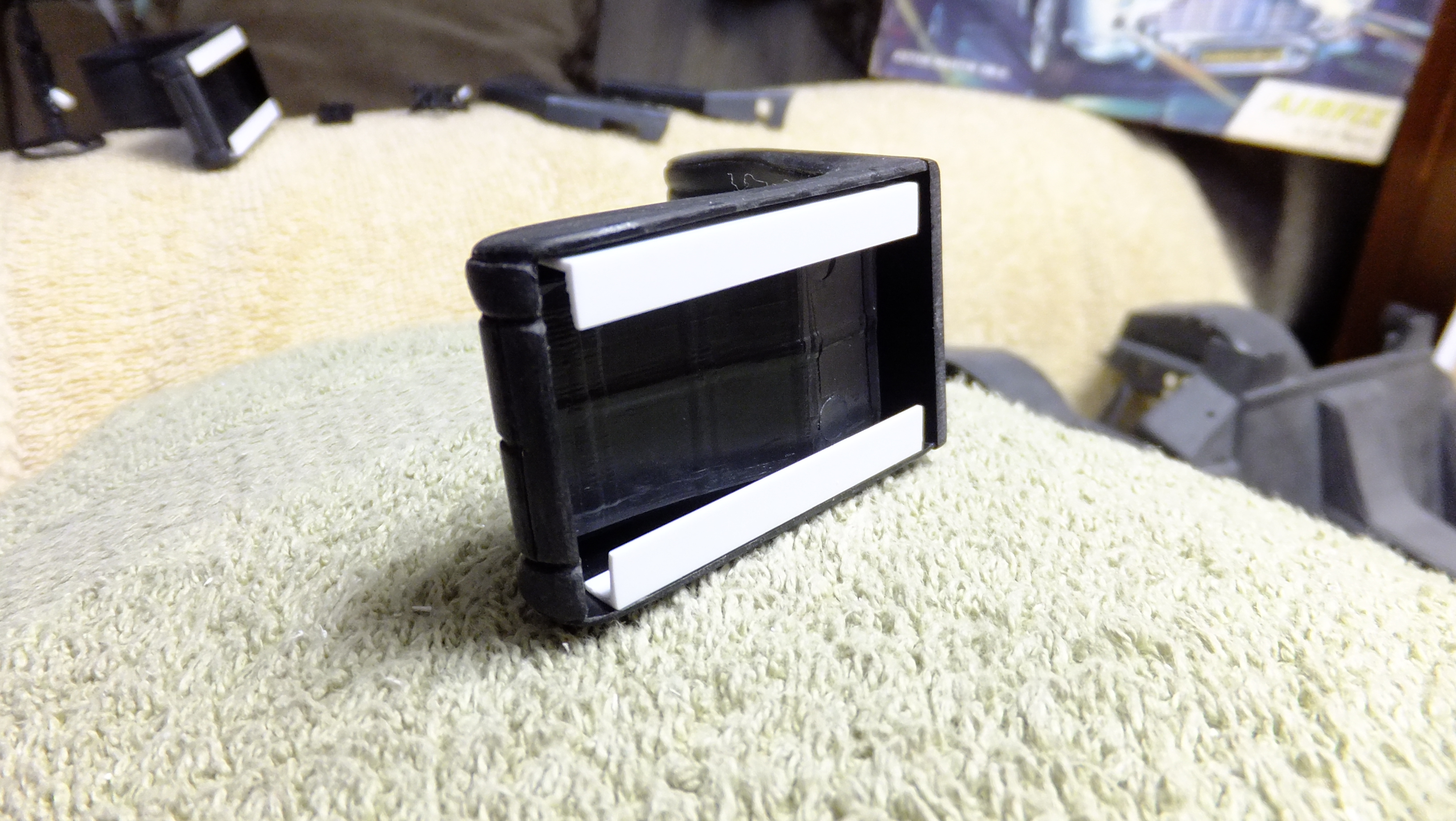

-Photo 7; I had almost forgot to etch-in the seam that separates the inner door panel from the door frame itself.

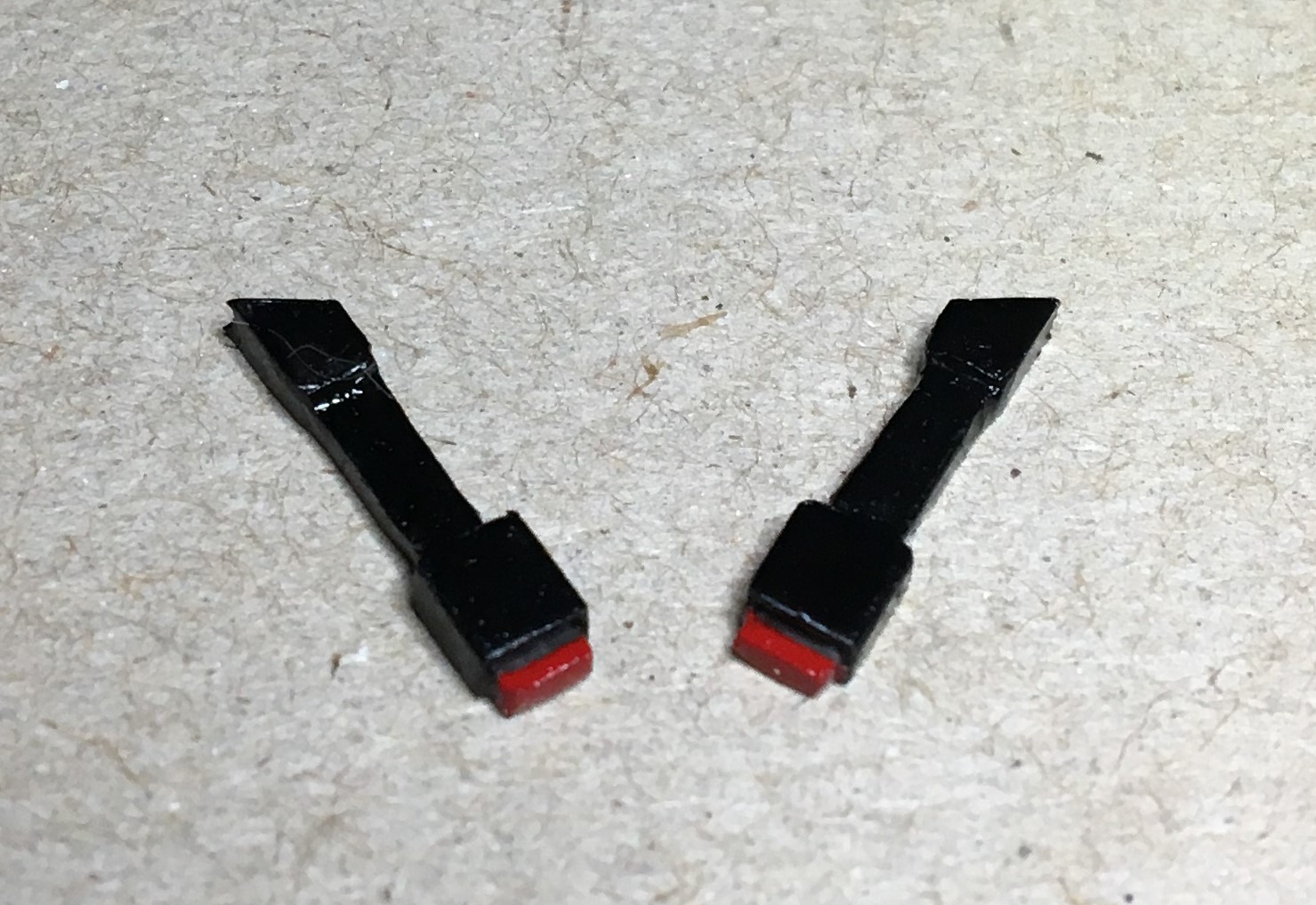

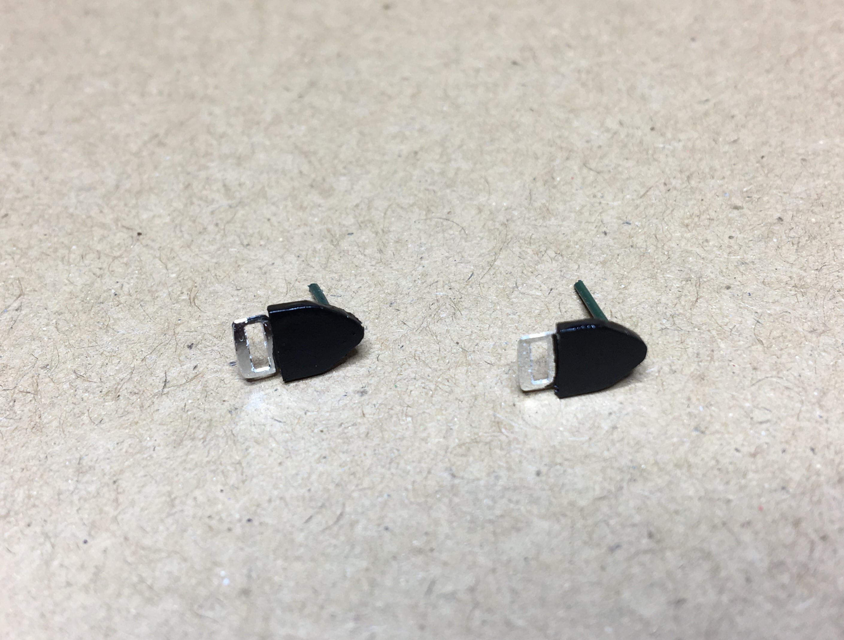

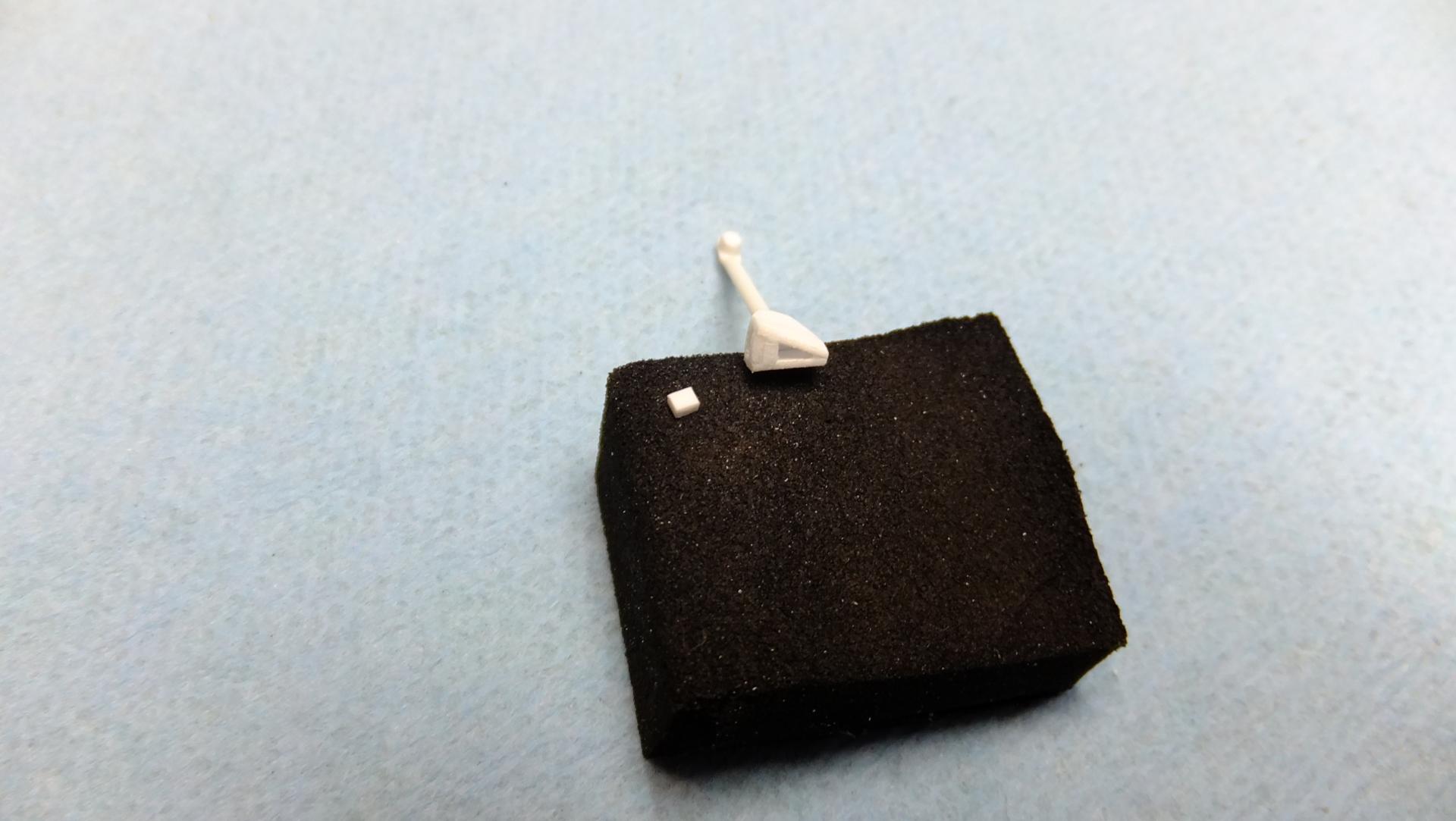

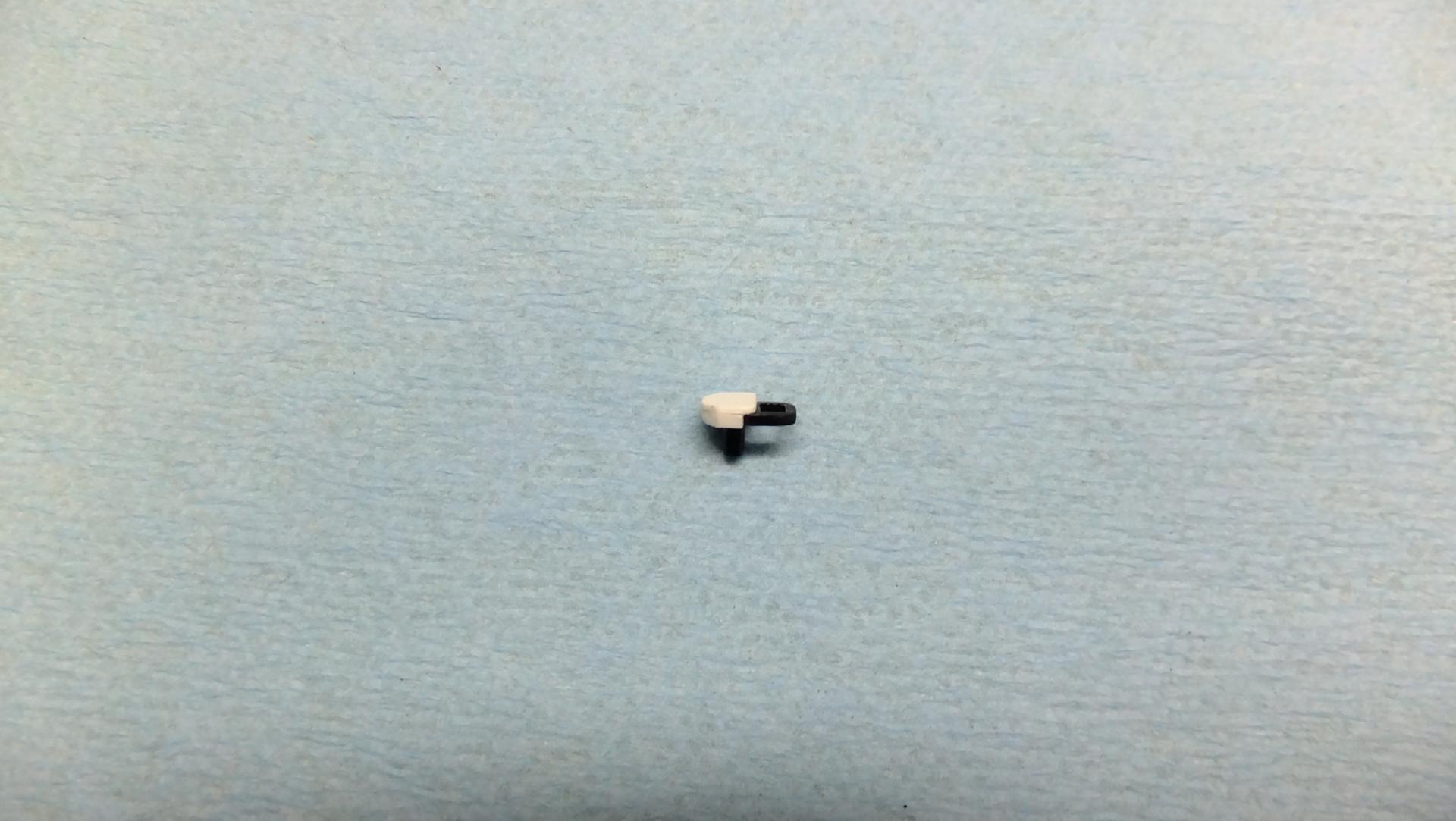

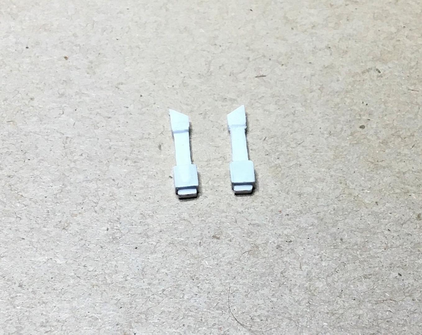

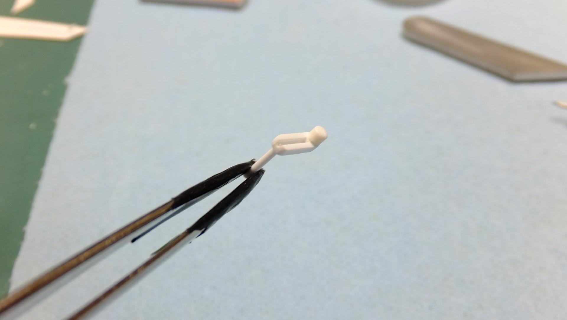

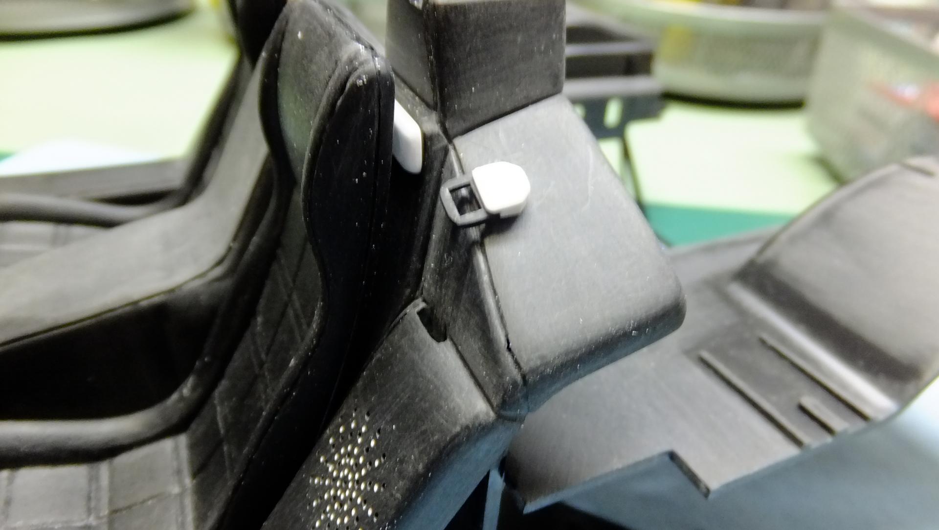

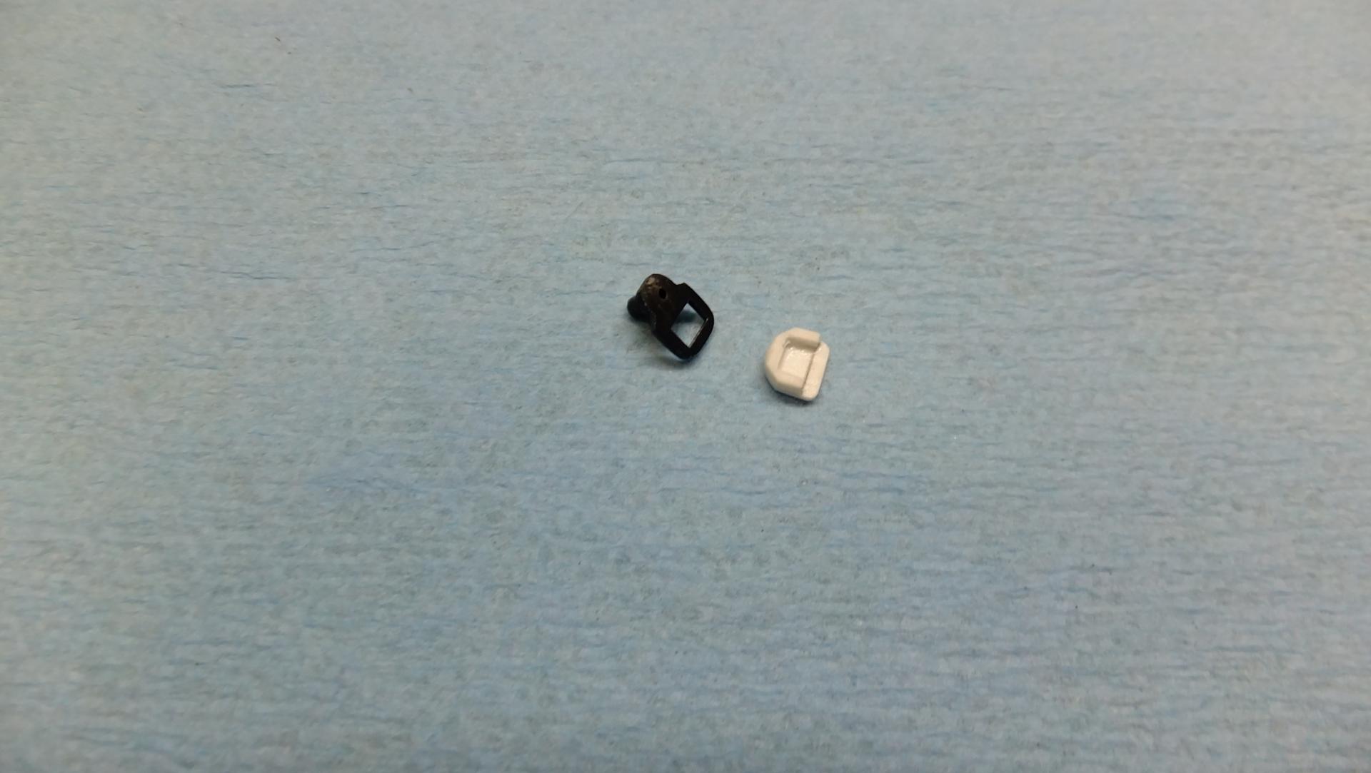

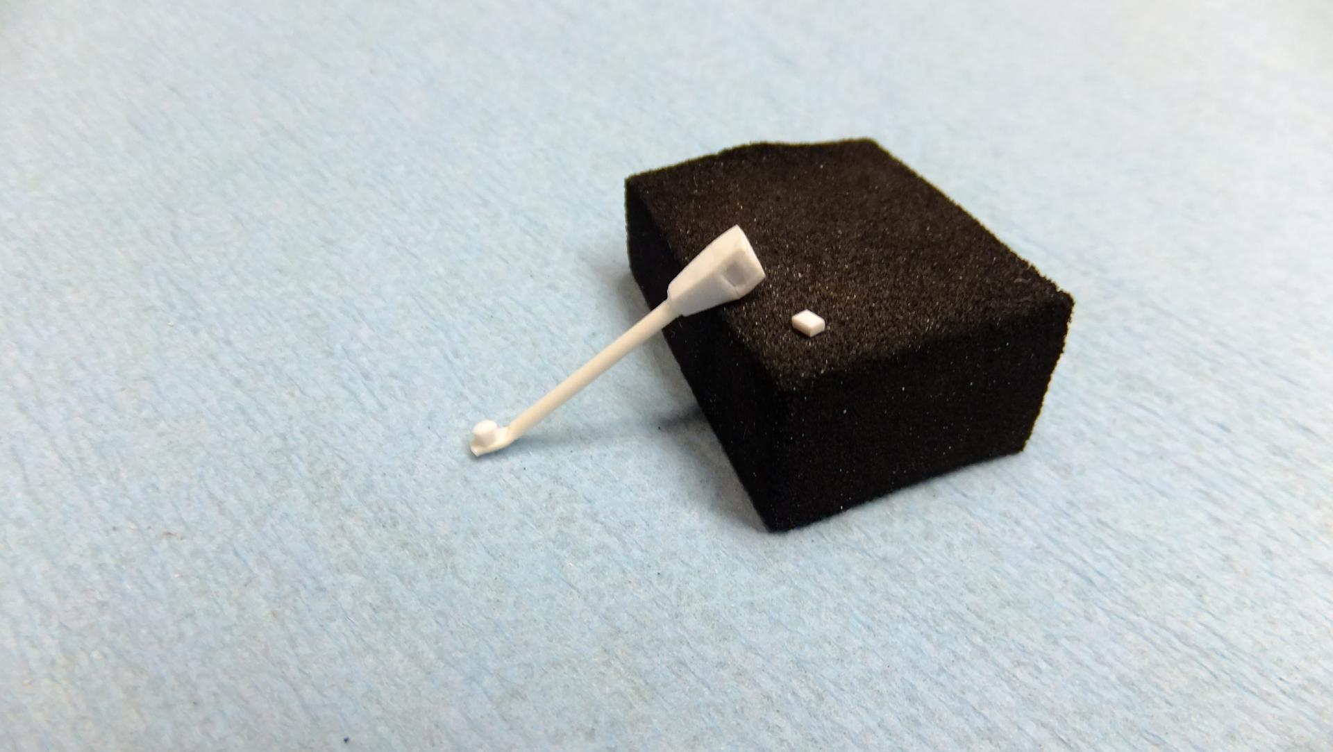

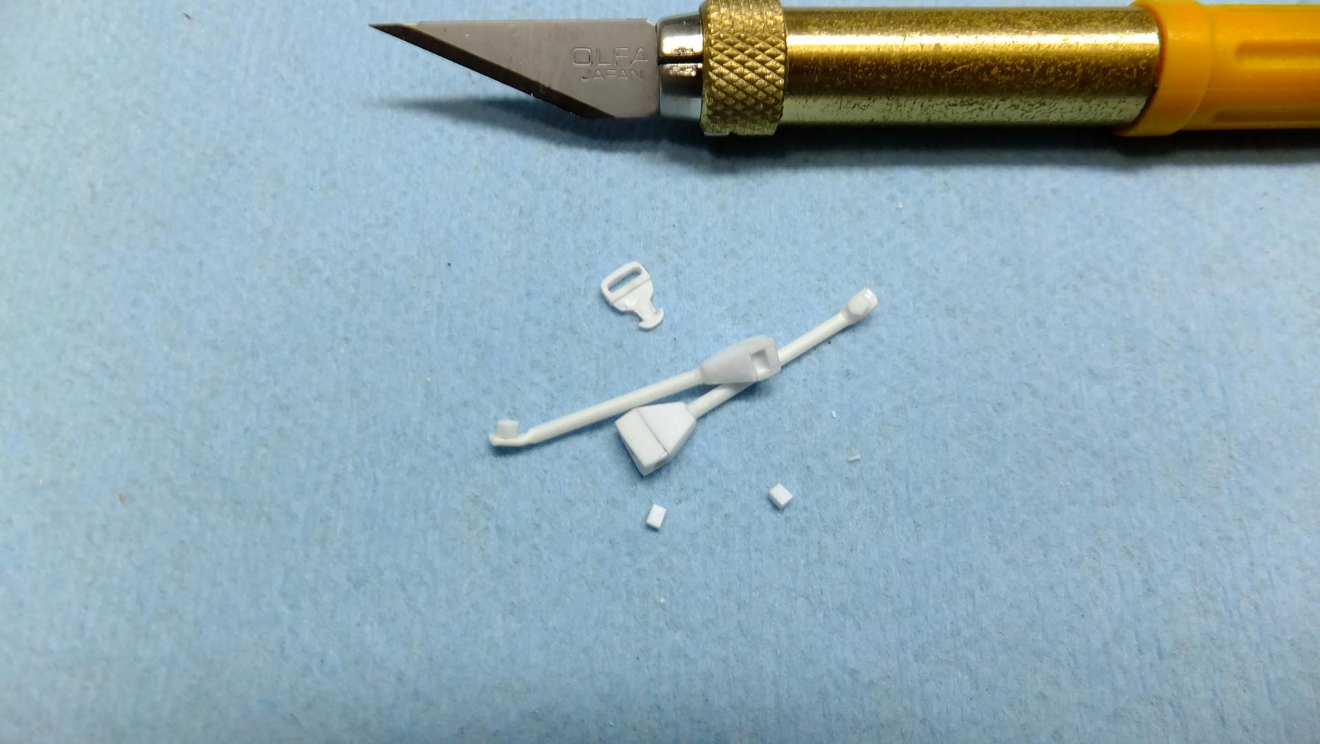

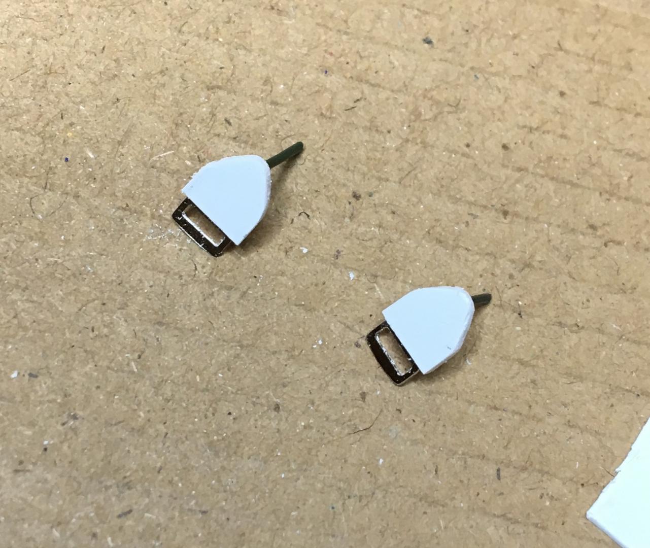

Hi!, another update here; it took me longer, and more parts than I thought to make my seat buckles....two hours to be exact, but here they are in the rough....the little piece laying next to it is the release button.

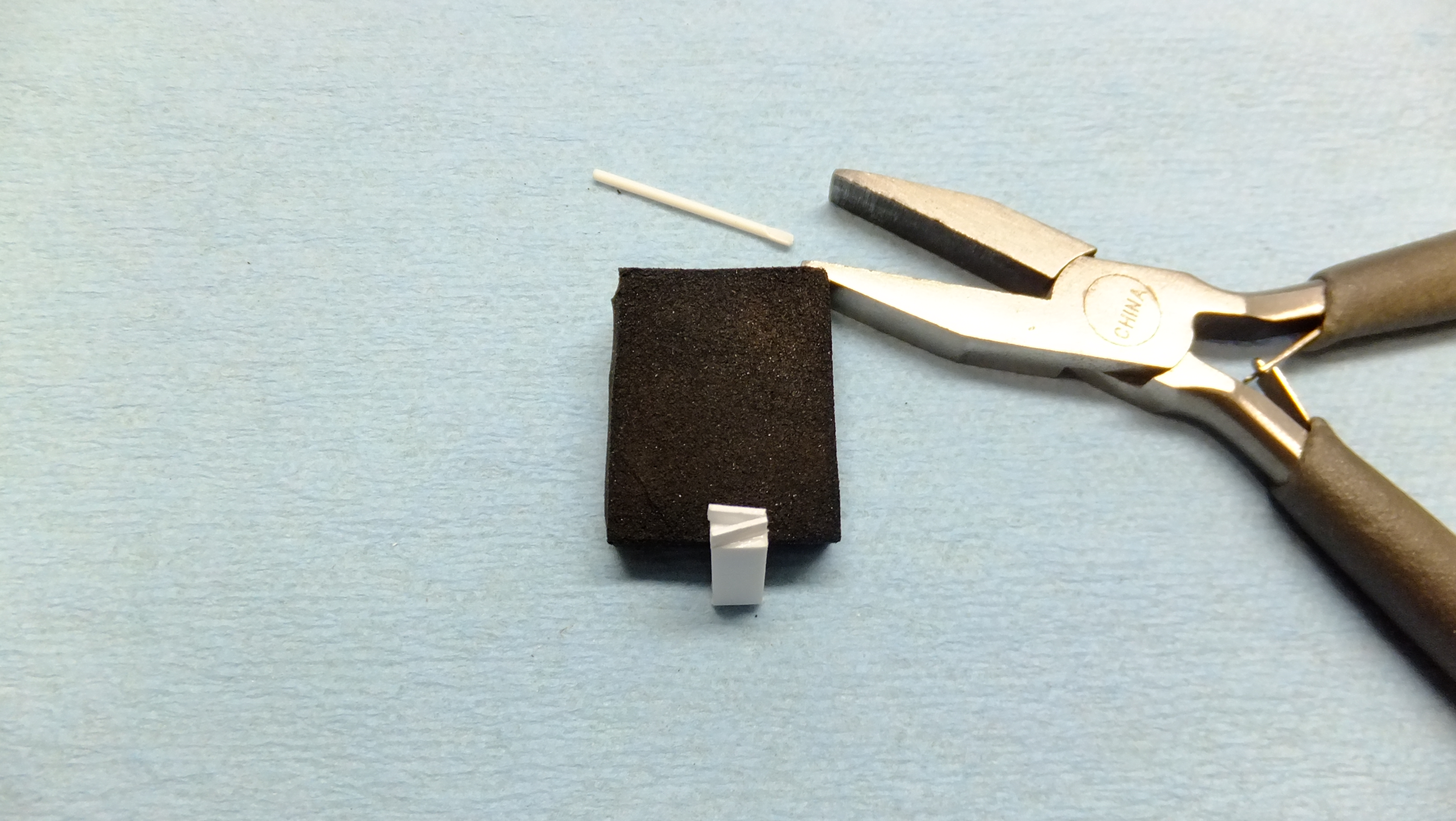

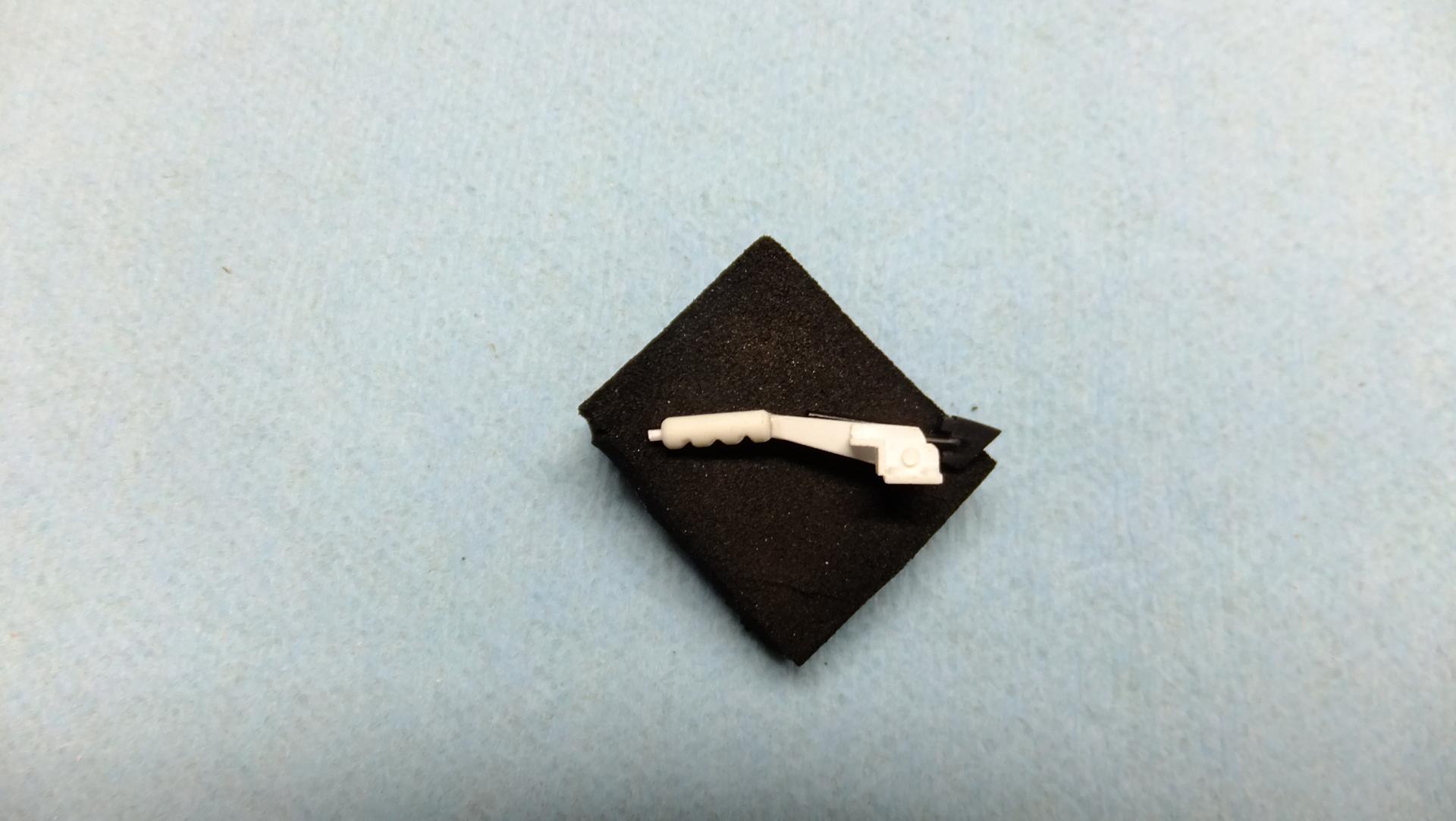

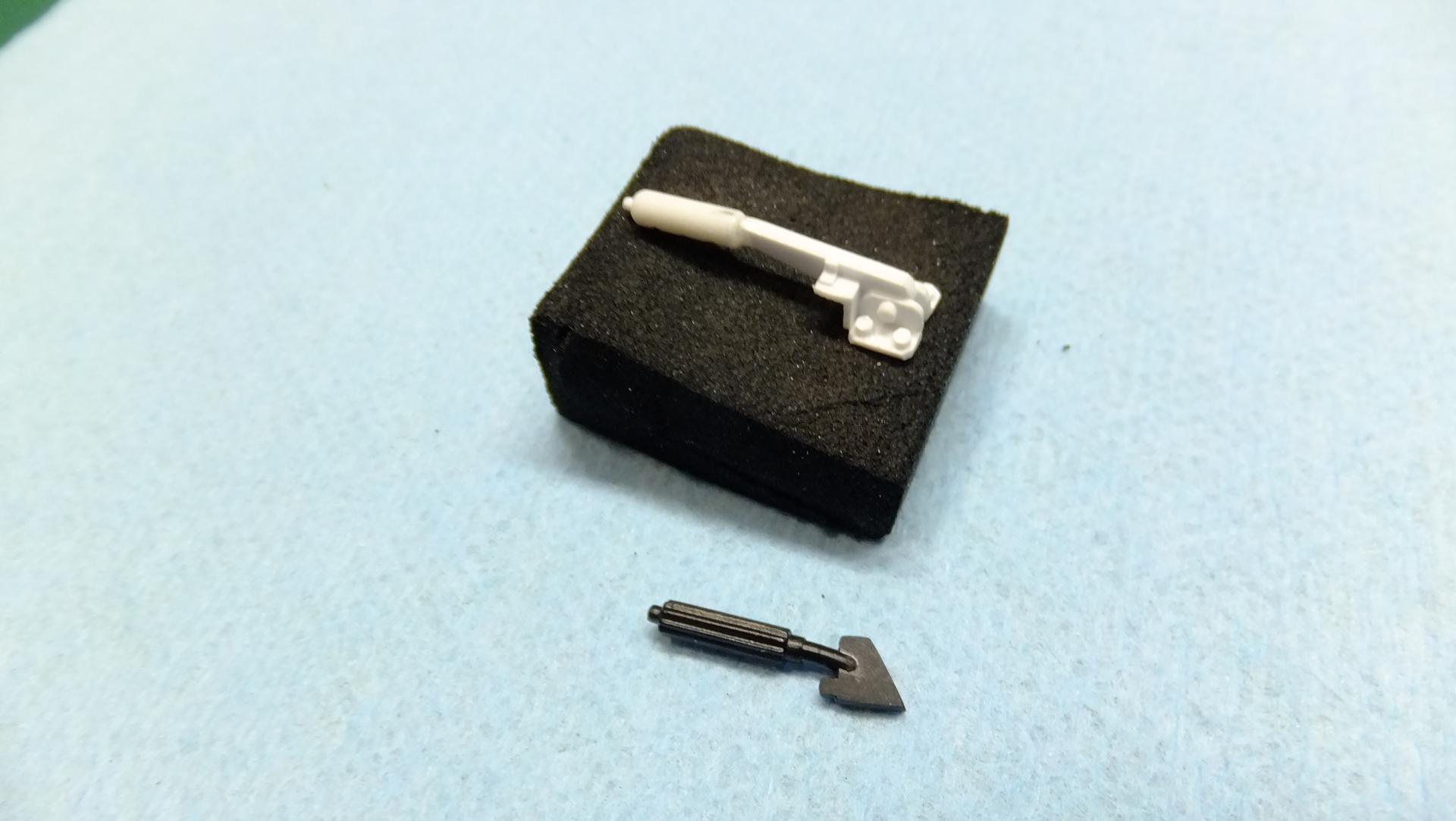

I finished the seatbelt hardware, and moved on to a factory E-brake, instead of using that weird looking black one that came in the kit...

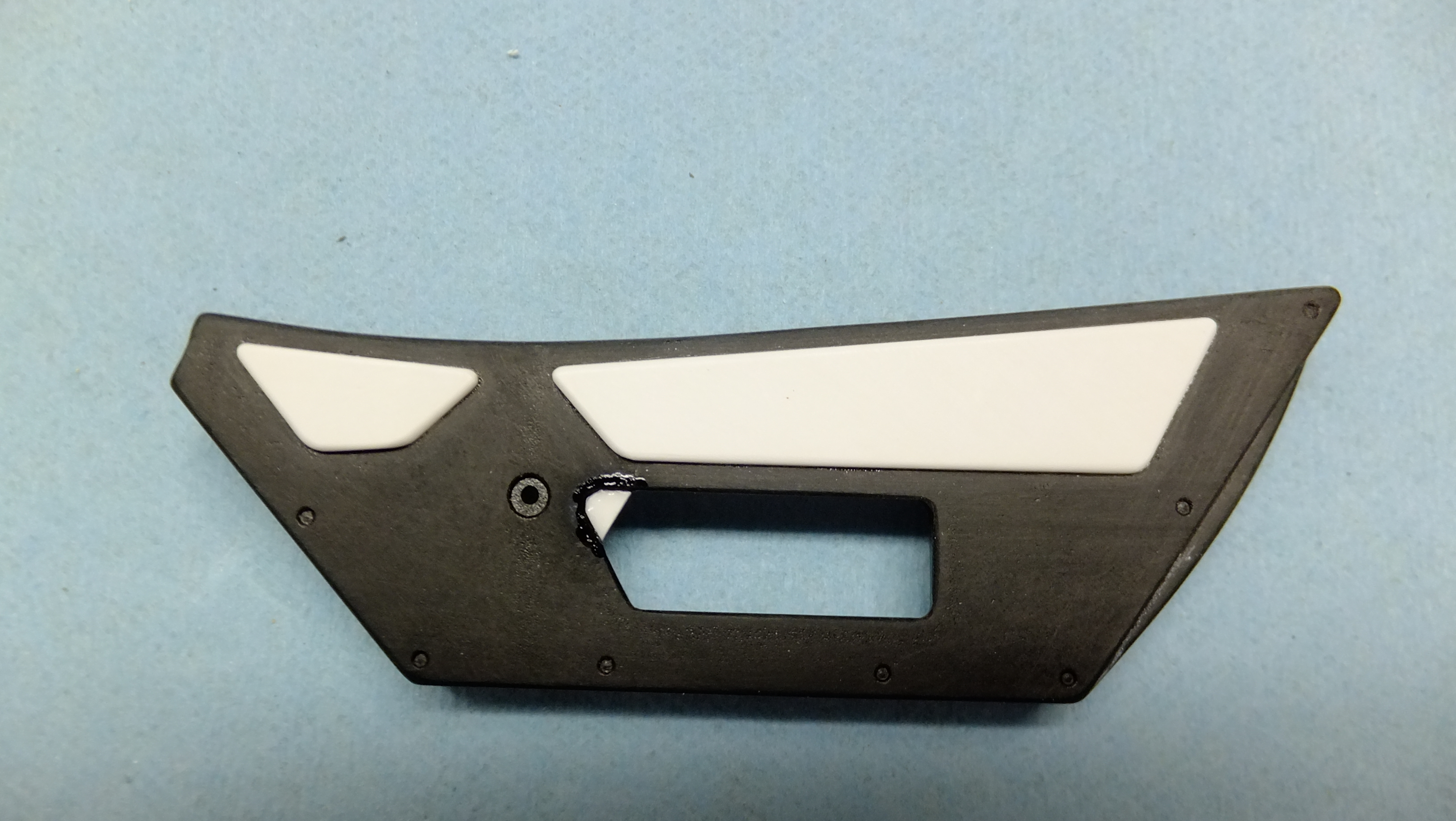

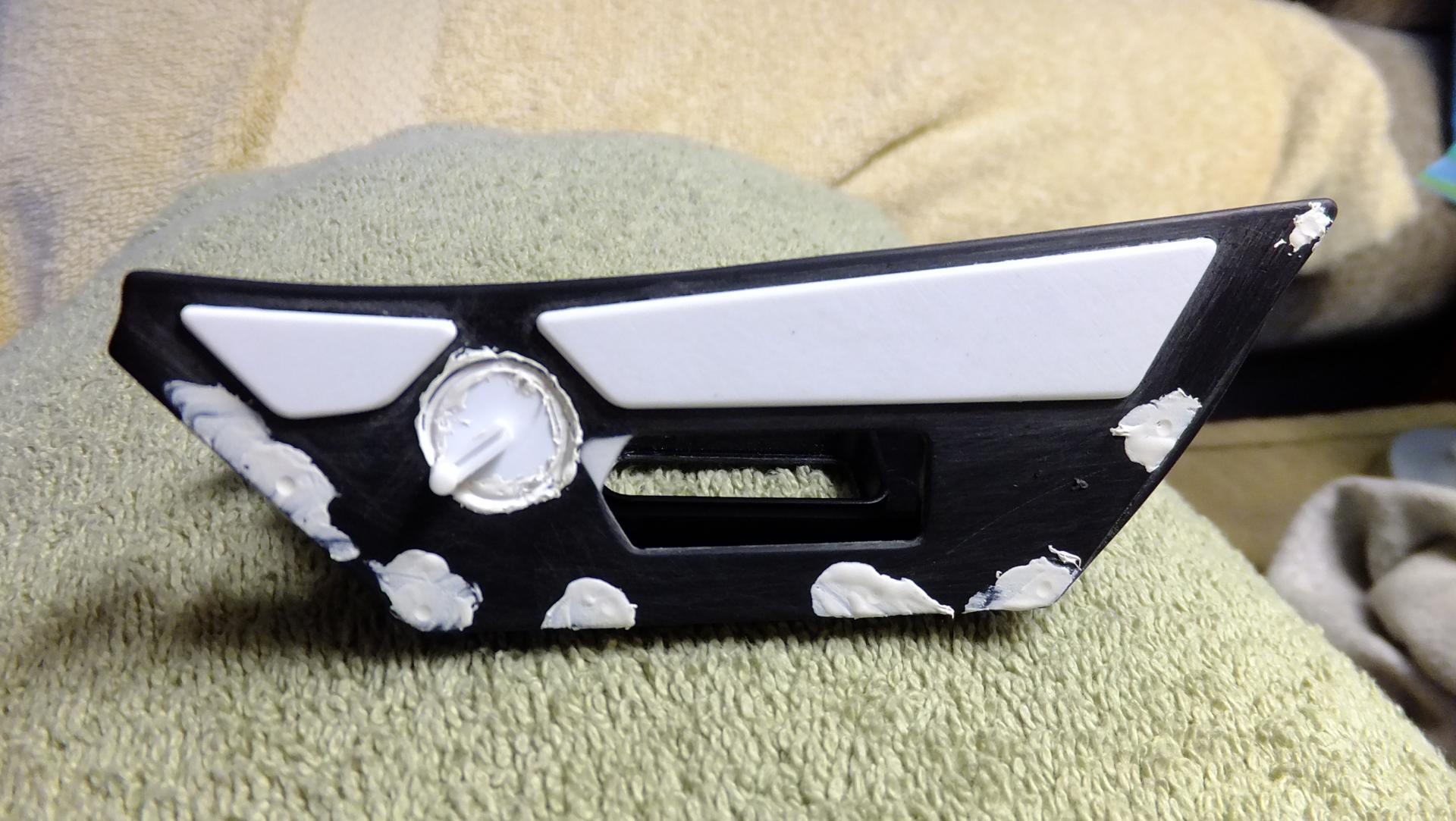

Almost done with the inner door panels!.....only needs a couple of details, and a klean-up!.....here you can see I filled in a few things, and finally etched the padding seams.
