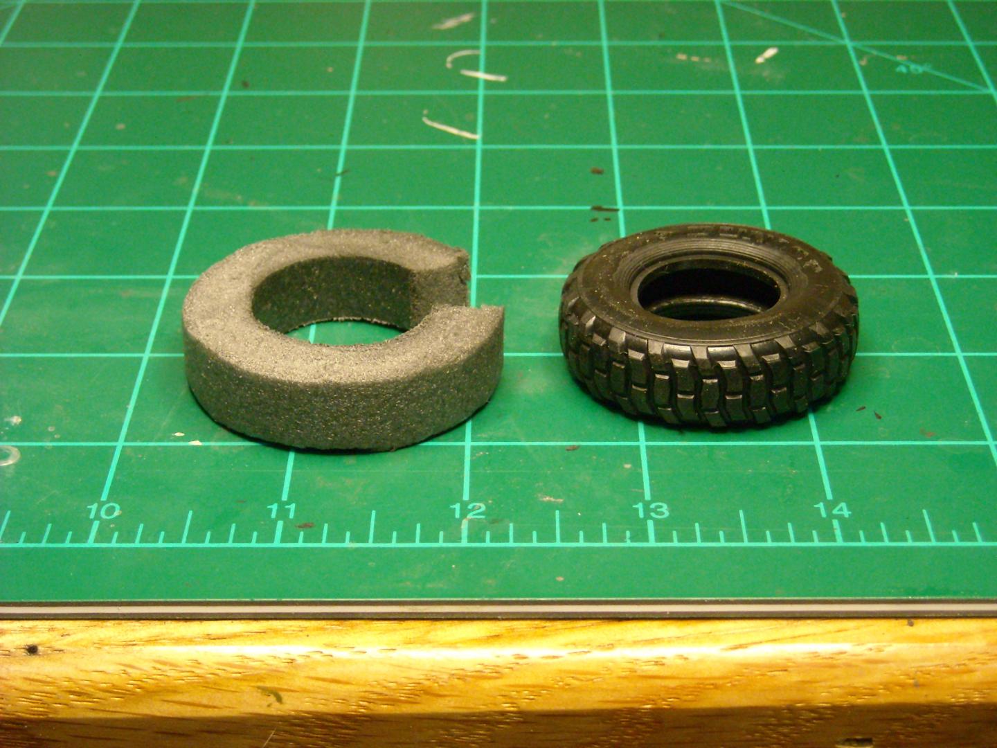

Kit Basher Posted July 27, 2018 Posted July 27, 2018 I've only done this once, but it seems to have worked OK. I cut little "donuts" from foam pipe insulation, and put them inside the tires.

Ace-Garageguy Posted August 1, 2018 Posted August 1, 2018 (edited) Silicone will cause fisheyes during any painting process...if you're not sufficiently careful. Handle siliconed parts with gloves that you throw away afterwards, and never EVER touch a model before ANY painting process after handling something with silicone on it. Soap and water will NOT remove silicone, but a careful wipe with isopropyl alcohol will usually do it...from your hands as well as from your model. It's good practice to get into the alcohol-wash habit anyway. You'll save yourself a world of grief. Far as supporting larger tires that tend to go flat, the RC shops have foam inserts made just for it. If cost is an issue, if you ask nice, you can probably get miles of this stuff free (after it's been used) from any local body shop. It's used to mask panel openings on real cars, to get a "soft edge". Edited August 1, 2018 by Ace-Garageguy
BigTallDad Posted August 2, 2018 Posted August 2, 2018 Fuel line, such as that found on small gasoline engines (mowers, trimmers) or R/C aircraft (found in hobby shops) comes in a variety of sizes and might work well when stuffed inside the deformed tire.
