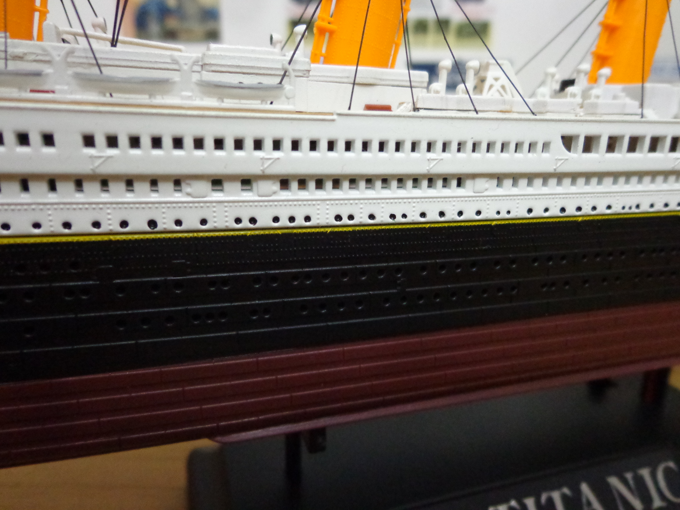

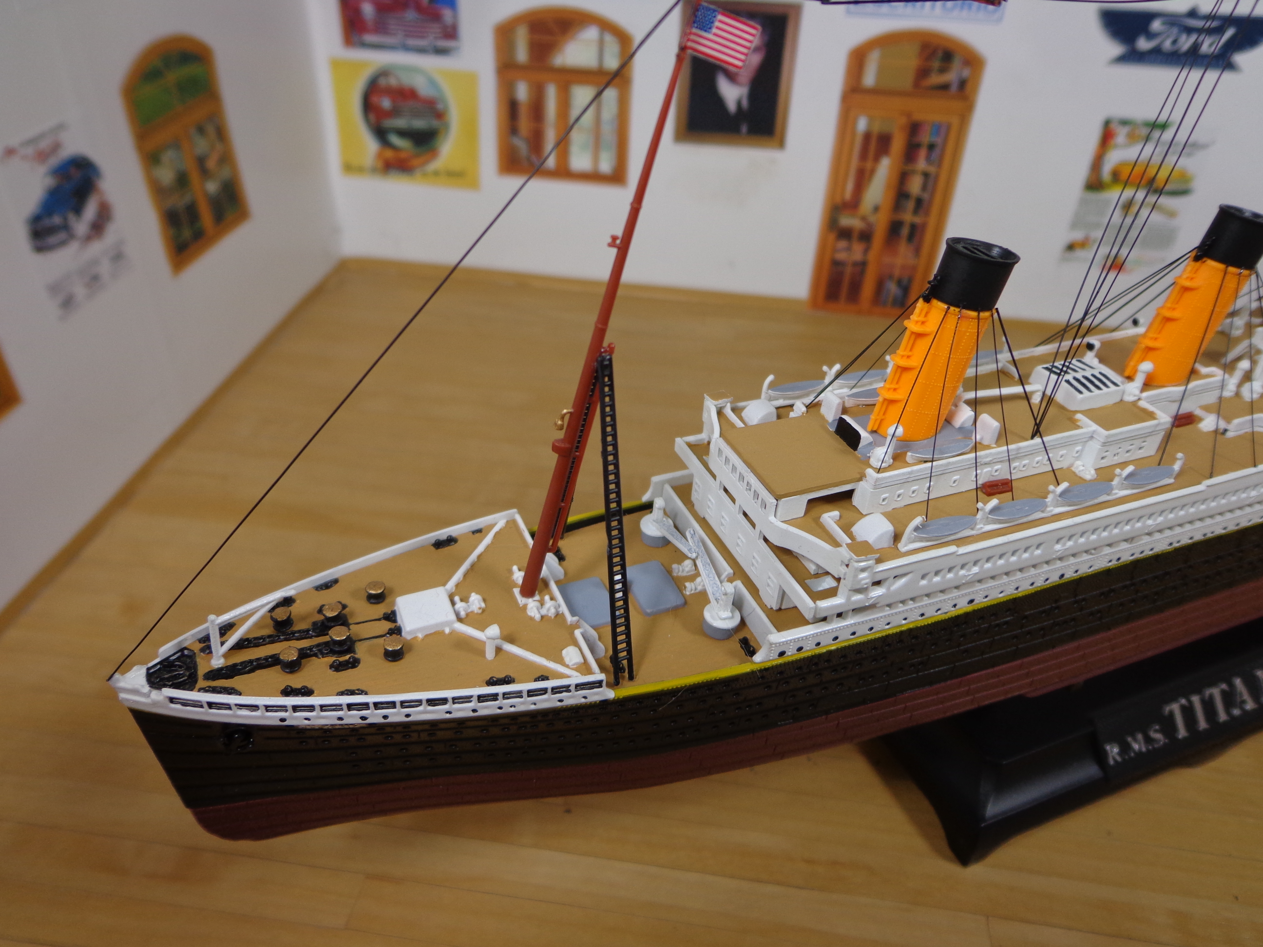

Lovefordgalaxie Posted September 15, 2018 Share Posted September 15, 2018 This was supposed to be a quick easy build, painting nothing. Ended painting almost all parts, and spent two days on it. Quote Link to comment Share on other sites More sharing options...
Jim B Posted September 15, 2018 Share Posted September 15, 2018 She looks great. Well done. Quote Link to comment Share on other sites More sharing options...

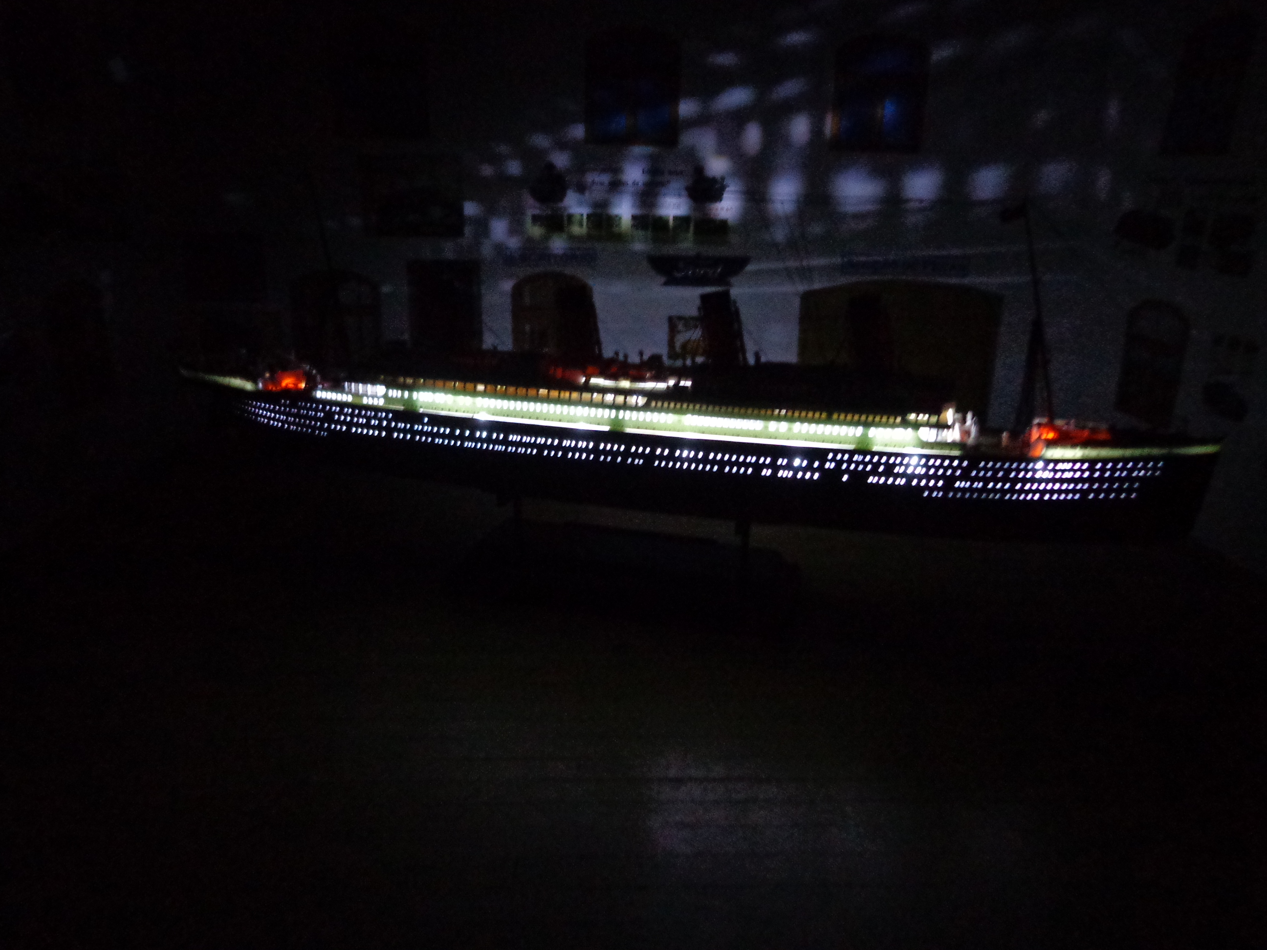

Nacho Z Posted September 15, 2018 Share Posted September 15, 2018 That is great! Love the night shot! Very nice looking Titanic. Quote Link to comment Share on other sites More sharing options...
Nacho Z Posted September 15, 2018 Share Posted September 15, 2018 Did you add the lighting kit or was it supplied with the kit? Thanks. Quote Link to comment Share on other sites More sharing options...

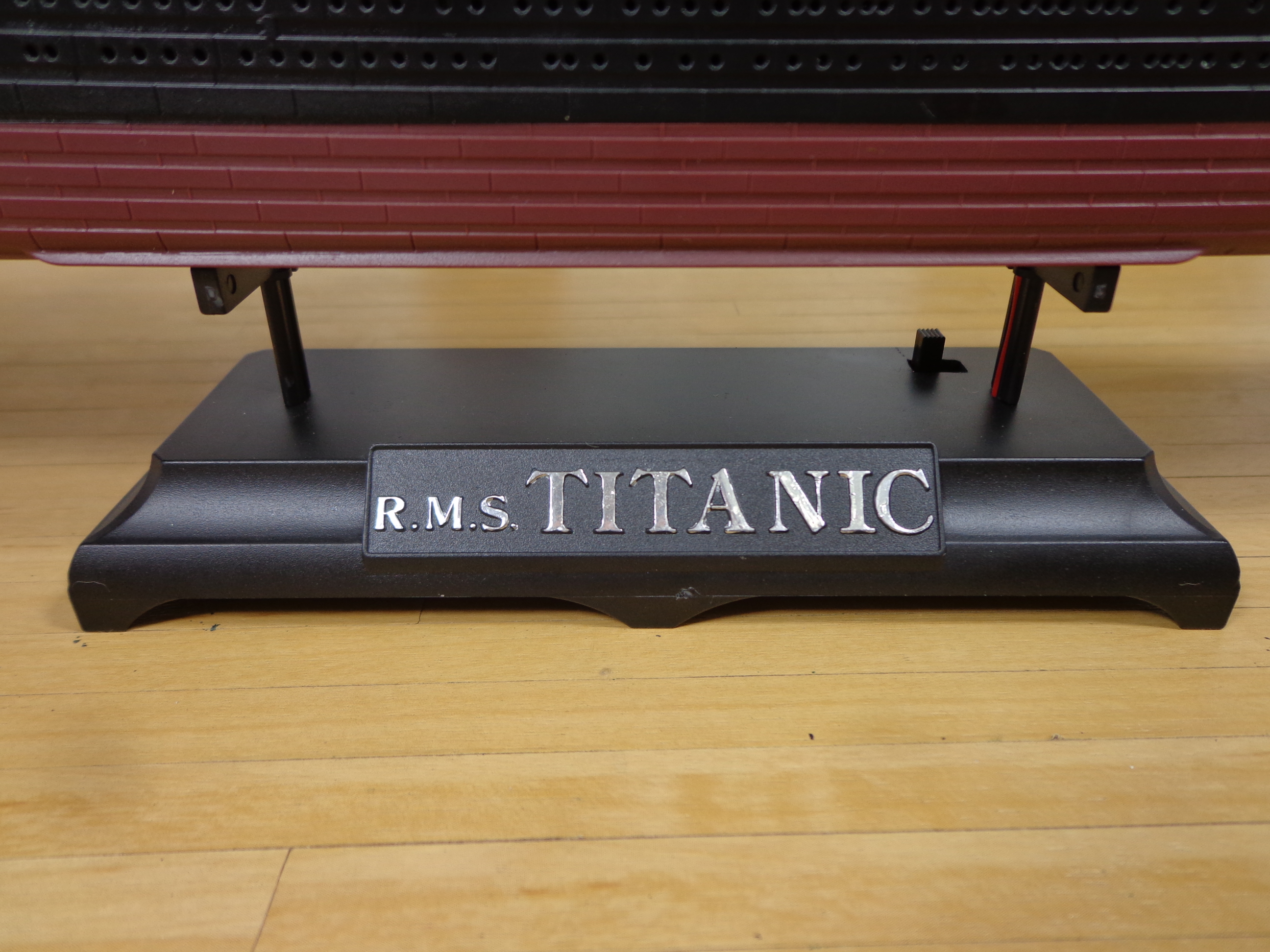

Lovefordgalaxie Posted September 15, 2018 Author Share Posted September 15, 2018 Thanks guys!! 4 minutes ago, Nacho Z said: Did you add the lighting kit or was it supplied with the kit? Thanks. The lighting comes with the kit. The Leds are quite strong in my opinion, if I were to build another I would paint the inside of the ship flat black to minimize light bleeding trough. This is the box: Quote Link to comment Share on other sites More sharing options...

Lovefordgalaxie Posted September 15, 2018 Author Share Posted September 15, 2018 26 minutes ago, cobraman said: Well done ! Two days ? Yep. Painted the parts in one afternoon, put it together in another. It's a very simple kit, almost a snap. 9 minutes ago, vamach1 said: Must have been 48 hours straight. . It's impressive for sure. I built a diorama of it sinking but that picture is somewhere on the hard drive from about ten years ago. LOL!!! This kit is very simple. It comes with pre colored parts trees, so, in theory it can be built with no paint. I just gave the parts a coat of the basic colors, and the most time consuming stuff was painting the white and black details in the tan deck pieces. Black on the hull is bare plastic, the red on the hull is also bare plastic. If one is not painting anything, it can be built in a hour or two. Quote Link to comment Share on other sites More sharing options...

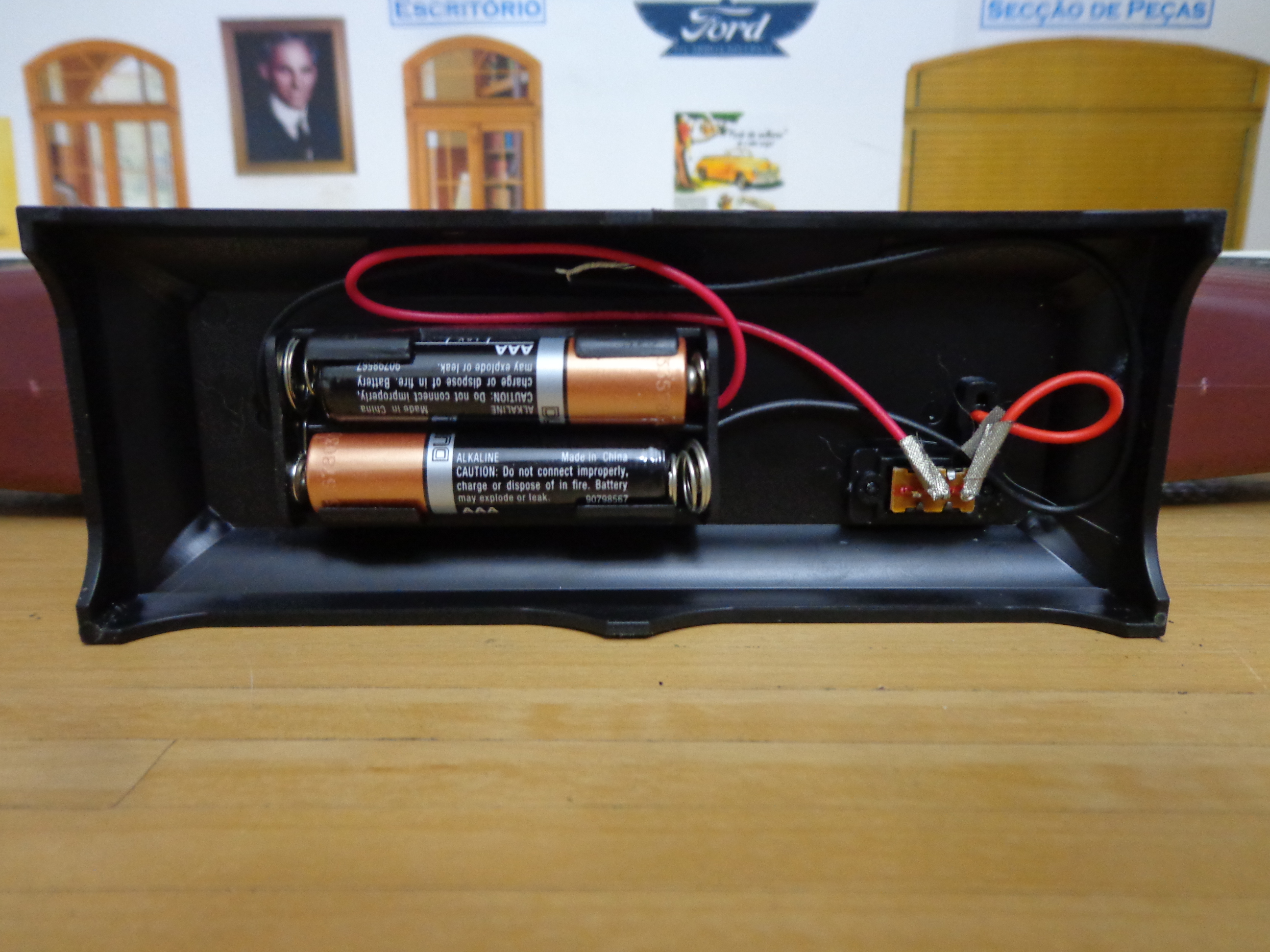

peteski Posted September 17, 2018 Share Posted September 17, 2018 (edited) Nice model! You can likely reduce brightness of those LEDs by installing additional resistor or resistors into the circuits. But I would have to see the entire circuit to offer any specific suggestions as to the resistor value. I guess that that splicing a 1000 ohm (1k ohm) resistor into one of the wires coming out of the battery would reduce the brightness by quite a bit. It will not cause any damage. Edited September 17, 2018 by peteski Quote Link to comment Share on other sites More sharing options...
Lovefordgalaxie Posted September 17, 2018 Author Share Posted September 17, 2018 20 minutes ago, peteski said: Nice model! You can likely reduce brightness of those LEDs by installing additional resistor or resistors into the circuits. But I would have to see the entire circuit to offer any specific suggestions as to the resistor value. I guess that that splicing a 1000 ohm (1k ohm) resistor into one of the wires coming out of the battery would reduce the brightness by quite a bit. It will not cause any damage. Thanks!! Yes, I was thinking about a resistor in series with the circuit. All the LEDs are in parallel with each other, what puts 3 Volts on every single one of them (two AAA batteries), and other than a on/off switch between them and the batteries, there is nothing more to it. I said I was thinking, as I found a very compact dimmer, that I plan on testing. Let's see what results I'll get from that. Quote Link to comment Share on other sites More sharing options...
peteski Posted September 17, 2018 Share Posted September 17, 2018 21 minutes ago, Lovefordgalaxie said: Thanks!! Yes, I was thinking about a resistor in series with the circuit. All the LEDs are in parallel with each other, what puts 3 Volts on every single one of them (two AAA batteries), and other than a on/off switch between them and the batteries, there is nothing more to it. I said I was thinking, as I found a very compact dimmer, that I plan on testing. Let's see what results I'll get from that. If it is one of those electronic PWM dimmers then it is way overkill. No need - simple resistor will do the trick. If you want to have control of the brightness get a small trimmer potentiometer. I would get a 5000 ohm (5 k ohm) 1/2W rated and then use it instead of a fixed resistor. That will give you a good range of brightness adjustment. Something like this one: https://www.digikey.com/product-detail/en/cts-electrocomponents/201XR502B/201XR502B-ND/98337 But do whatever works for you. Quote Link to comment Share on other sites More sharing options...

olsbooks Posted November 21, 2018 Share Posted November 21, 2018 Nice job! A cheap and quick mod I've found for LED's to soften and warm them (and reduce light leaks) is simply to wrap them with masking tape. Outstanding work. Peace. Quote Link to comment Share on other sites More sharing options...
