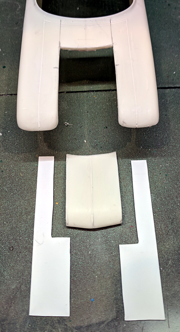

Harpo Posted November 30, 2018 Author Share Posted November 30, 2018 (edited) Though the front bumper won't actually be visible, it provides a good base for the new front end. Here it is narrowed to fit: The wheel openings are filled with two thicknesses of .020 styrene; one as backer, the other fits inside wheel opening to reduce amount of filler needed: Installing the sheets: Installed and trimmed: Here's a rough idea of where this is heading: This is getting much more complex than I anticipated, but it's great fun! Edited November 30, 2018 by Harpo Quote Link to comment Share on other sites More sharing options...
