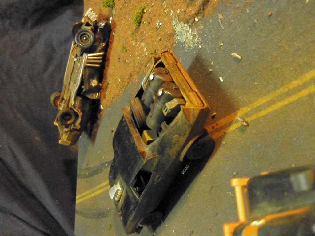

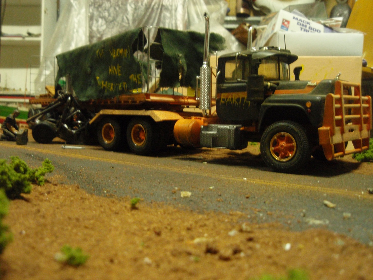

eldiablo78 Posted January 14, 2019 Posted January 14, 2019 i fond those pics with time for the Mack . set 1
eldiablo78 Posted January 14, 2019 Posted January 14, 2019 set 2 was made by Mahenoguy from Australia from the web site https://www.madmaxmovies.com/forum/viewforum.php?f=7 , and search for this thread ( Lost diorama opening chase ).
eldiablo78 Posted January 14, 2019 Posted January 14, 2019 but this diorama is gone ferever burn house burn total.
DPNM Posted January 14, 2019 Author Posted January 14, 2019 (edited) 3 hours ago, eldiablo78 said: set 2 was made by Mahenoguy from Australia from the web site https://www.madmaxmovies.com/forum/viewforum.php?f=7 , and search for this thread ( Lost diorama opening chase ). I found the post on this eldiablo78. I can't think of enough good words to say how well this was built. Golly!!! It's breathtaking. From his post it sounded like his models were stored in his shed which is what burned. What a loss. Tragic. I tried to post a direct link here but it didn't work. I believe I found the Mahenoguy post on page 2. I have a diorama scene that I've been gathering pieces for, it's still a project I haven't decided to start yet. Edited January 14, 2019 by DPNM
