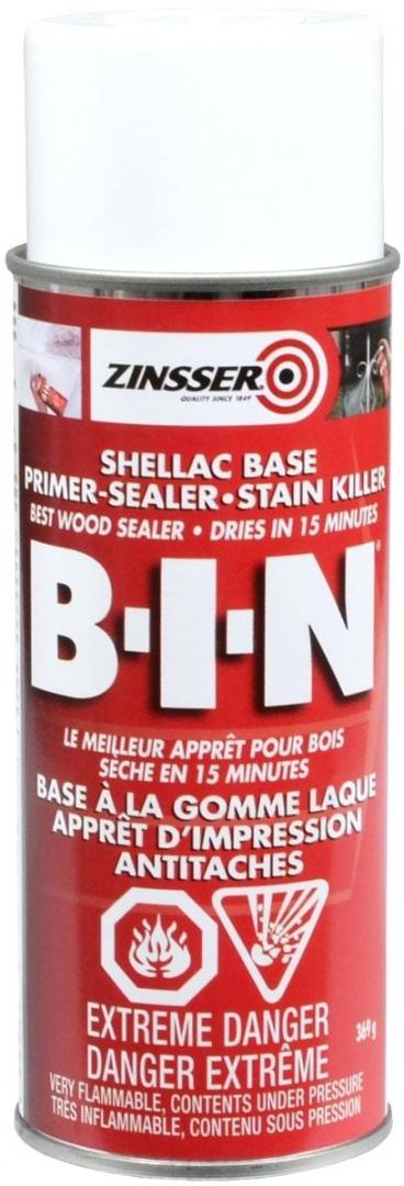

Another option that works well Is BIN sealer. Their cans do not spray well though. I decant and airbrush it. Use regular primer first then seal it with BIN.
stain-killer-primer-bin-primer-sealer-stain-killer-spray-a-zinsser-bin-odor-blocker-primer-sealer-stain-killer-zinsser-bin-primer-sealer-and-stain-killer-500ml.jpg
I second what Dale said. I've been using BIN for years and have never had an issue with crazed plastic or bleed through. And yes, decanted in your airbrush is 100% better than straight from the can.

How does the BIN primer sand?  Being shellac based, I would expect it to be a bit gummy.  Do you thin it with denatured alcohol?
With the BIN sealer run through my airbrush, I don't really need to do any sanding. No, it's not gummy-----at least not that I've ever experienced.
Yes, 91% alcohol is good to thin it with. I use my old Badger Crescendo for putting it on.
