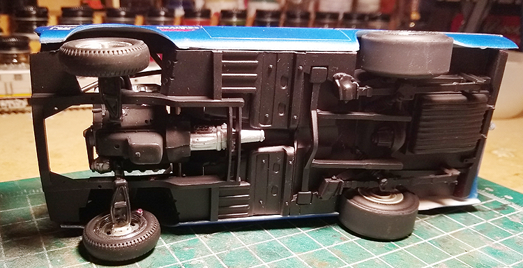

afx Posted January 13, 2019 Posted January 13, 2019 (edited) Kit bashing the AMT Wild Child Falcon with the new Moebuis Comet A/FX. Removed 16" scale inches for the chassis Still some work to do particularly at the rear but a good start. Edited January 13, 2019 by afx

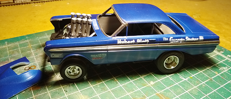

mredjr Posted January 13, 2019 Posted January 13, 2019 I am working on the same thing but I used the 427 Fairlane chassis and motor. I am building Hubert Platt's car and it had 427 wedge. 1
mk11 Posted January 14, 2019 Posted January 14, 2019 Looking forward to riding along on another one of your fantastic builds, JC Here's what she looked like twenty-five years ago; original body work, new paint... One thing that appealed to me about this car was that it didn't have the extreme rear axle forward move (only 8") that some other AFXs had. I was actually at a friend's bodyshop in London the day a sikkens (I think) rep gave her a fresh coat of pearl white. 10 hours ago, iBorg said: I've often wondered if a Revell T-Bolt would be a good donor for the Falcon A F/X. The T-Bolt chassis is a great fit and easy swap in scale but the comet chassis is closer prototypically with floorpan engraving, etc. The scale '65 comet chassis is actually a modified 'borrow' from the '66 Fairlane/comet kit, so availability is plentiful for the basic design. mike
afx Posted January 14, 2019 Author Posted January 14, 2019 (edited) The AMT kit is wrong to build the Wild Child as it provides the altered wheel base body. I'm using it in lieu of one of the other AMT issues becuase I had it in the stash. I have a stock AMT '65 Falcon body that has the wheel wells cut, I may use it to build the Wild Child down the road. The plan is to build something in the Daddy Warbucks direction but with a more detailed and accurate chassis and engine than what you get in the kit. I like the Wild Child in white Mike, thanks for sharing the picture. Edited January 17, 2019 by afx 1

afx Posted January 20, 2019 Author Posted January 20, 2019 Thank you for the comments and interest gentlemen. Happy with the rear axle position. I'll be using a different wheel/tire combination. 1
afx Posted January 20, 2019 Author Posted January 20, 2019 (edited) Modified the traction bars and brace from the T-bolt to fit. Edited January 20, 2019 by afx 1
