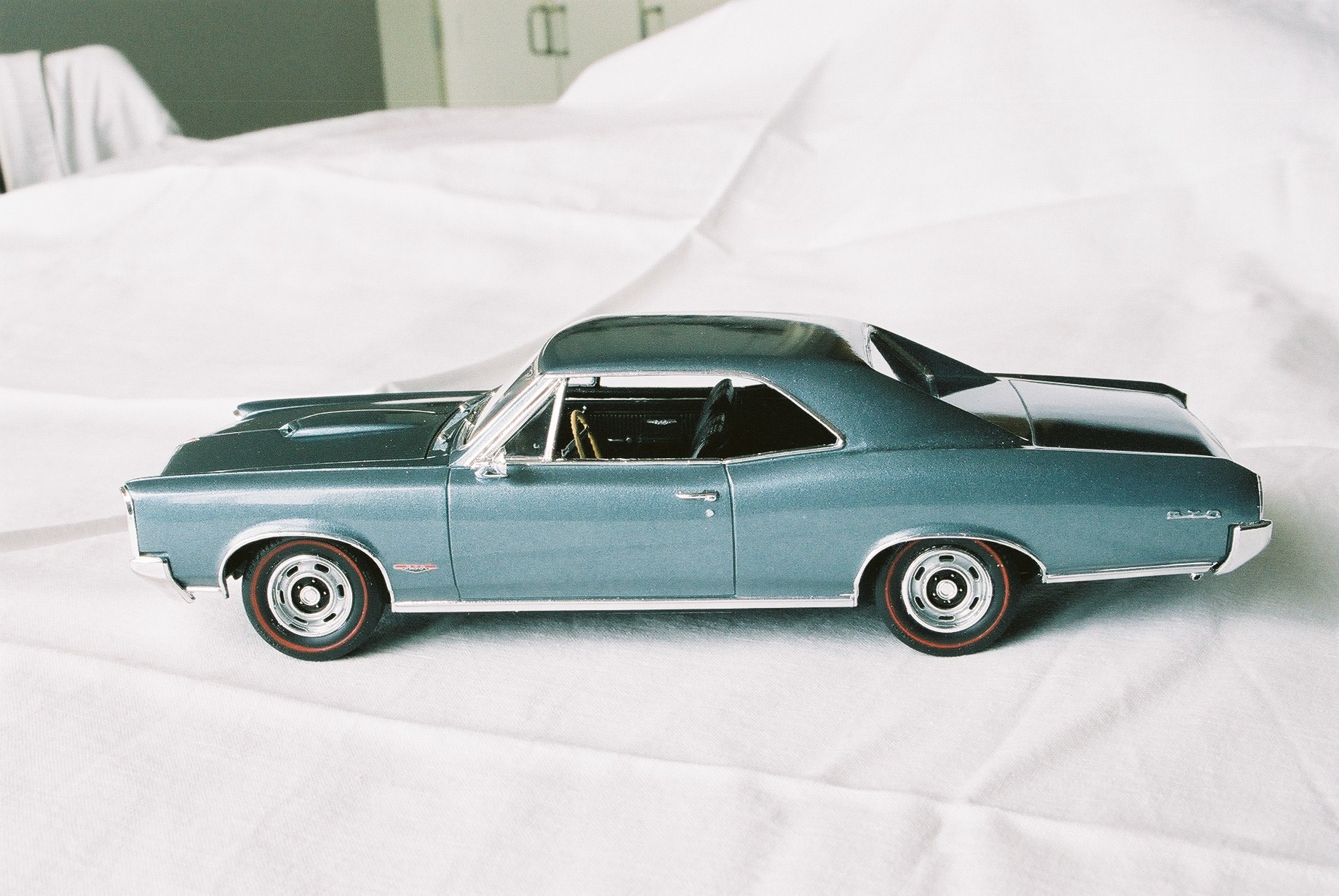

Force Posted January 20, 2019 Share Posted January 20, 2019 (edited) It's not hard, I saw a tip very similar to this one in a car modeling book several years ago and I have done it on several models after that. Here is a model built in 2001-2002 for our now closed local hobby shop where I used that technique, I delivered the finished model to the shop exactly one week after I got the kit...so it was built in seven days. Edited January 20, 2019 by Force Quote Link to comment Share on other sites More sharing options...

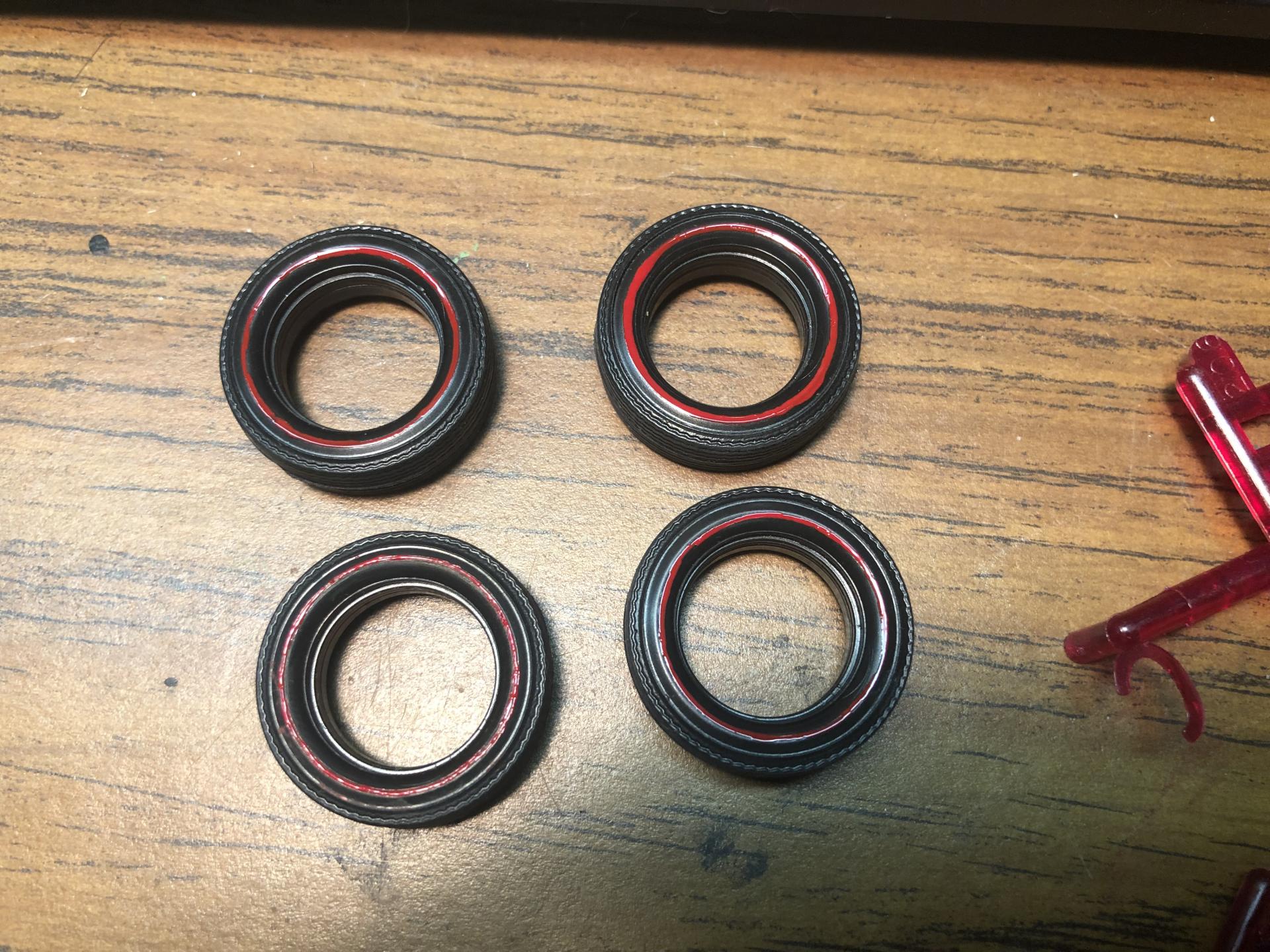

SCRWDRVR Posted January 21, 2019 Share Posted January 21, 2019 Just made my first attempt at doing this, I definitely need a little more practice but I think it went well Quote Link to comment Share on other sites More sharing options...
George Bojaciuk Posted January 22, 2019 Share Posted January 22, 2019 Looking good! Tighten the screw a bit to make the stripe tighter. Clean the compass point after each tire. I prefer using flats. Looks more realistic and doesn’t tend to run! Keep practicing! You are just about there. However, looking great!!! Quote Link to comment Share on other sites More sharing options...
