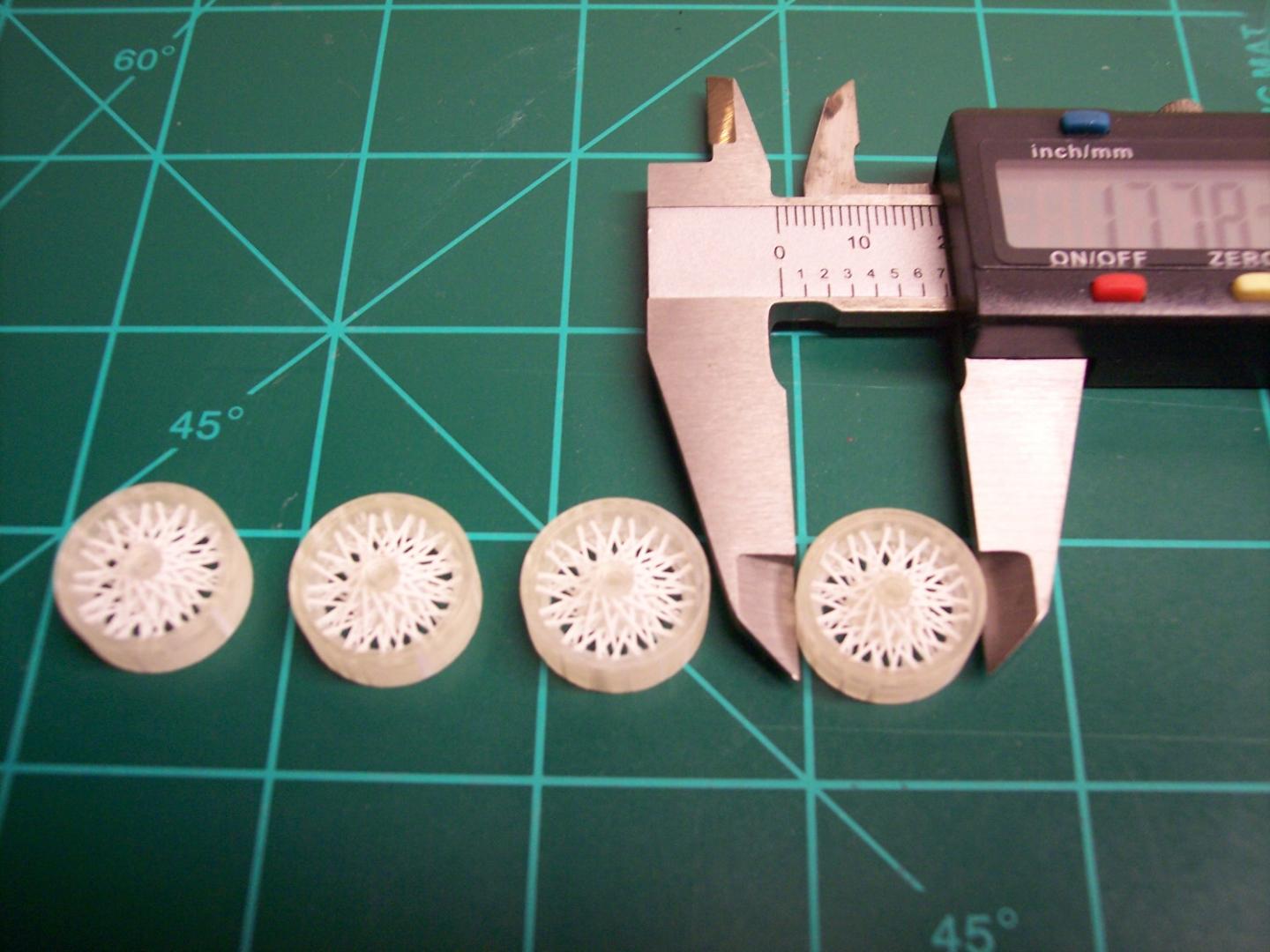

Pico Posted February 26, 2019 Posted February 26, 2019 46 minutes ago, PeeBee said: Pico, who printed the Duesenberg wires? I searched on Shapeways and couldn't find anything. Thanks. PB. I had the rims and hubs printed, then hand strung them. They are not in my shop because it's necessary to have a jig to hold them and require a lot of patience to string. However with the advent of relatively low cost printers that will make high resolution parts, I am refining my design skills to design spoked wheels (it's not easy) that can be printed. I use Sketchup , Bilingham uses Fusion360, which is a better Cad program. But I'm pretty good at SU.

PeeBee Posted February 27, 2019 Posted February 27, 2019 On 2/26/2019 at 10:57 AM, Pico said: I had the rims and hubs printed, then hand strung them. They are not in my shop because it's necessary to have a jig to hold them and require a lot of patience to string. However with the advent of relatively low cost printers that will make high resolution parts, I am refining my design skills to design spoked wheels (it's not easy) that can be printed. I use Sketchup , Bilingham uses Fusion360, which is a better Cad program. But I'm pretty good at SU. OK. Thanks. Yeah, I've been stringing my own wires for years, which I really don't have the time and patience for anymore. I am currently drafting wires for the Southeast Finecast Vauxhall kit in SketchUp. I was initially just drafting the rims (and hubs) with "pre-drilled" holes to have printed (as I assume you did for your Duesenberg), but after seeing what Mr. Billingham has accomplished with his printed wires I've decided to take a shot at drafting and printing whole wire wheels as well. My next project is for a set of wheels for two Monogram Duesenbergs waiting in the wings, then a set of solid disc wheels for the Monogram Packard and accurate wheels for the Heller Type 50 Bugatti. And, yep, I'm fine using SketchUp. It's the only 3D program I use these days after years of 3D Studio Max, VIZ, Maya, etc. SketchUp has all of the basic architecture I need to model up parts, and with all of the extensions that are availble you can really take things pretty far. Thanks for getting back to me. PB.
Pico Posted February 27, 2019 Posted February 27, 2019 54 minutes ago, PeeBee said: OK. Thanks. Yeah, I've been stringing my own wires for years, which I really don't have the time and patience for anymore. I am currently drafting wires for the Southeast Finecast Vauxhall kit in SketchUp. I was initially just drafting the rims (and hubs) with "pre-drilled" holes to have printed (as I assume you did for your Duesenberg), but after seeing what Mr. Billingham has accomplished with his printed wires I've decided to take a shot at drafting and printing whole wire wheels as well. My next project is for a set of wheels for two Monogram Duesenbergs waiting in the wings, then a set of solid disc wheels for the Monogram Packard and accurate wheels for the Heller Type 50 Bugatti. And, yep, I'm fine using SketchUp. It's the only 3D program I use these days after years of 3D Studio Max, VIZ, Maya, etc. SketchUp has all of the basic architecture I need to model up parts, and with all of the extensions that are availble you can really take things pretty far. Thanks for getting back to me. PB. I couldn't do what I do without SU's plugins, especially Solid Inspector 2, the stl importers and exporters and Bezier Curve. I've been doing printed rims with predrilled holes for several years but it will be printed with spokes from now on. Modelmartin will be producing a Bug T50 Profile (fastback) body with correct wheels.

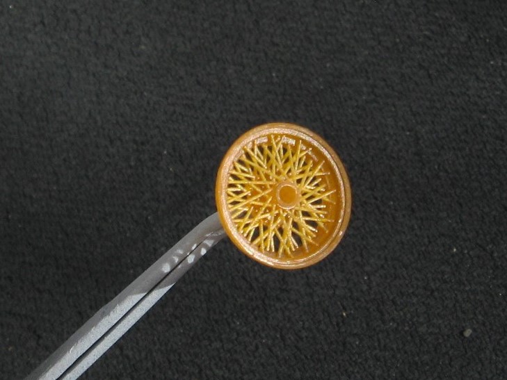

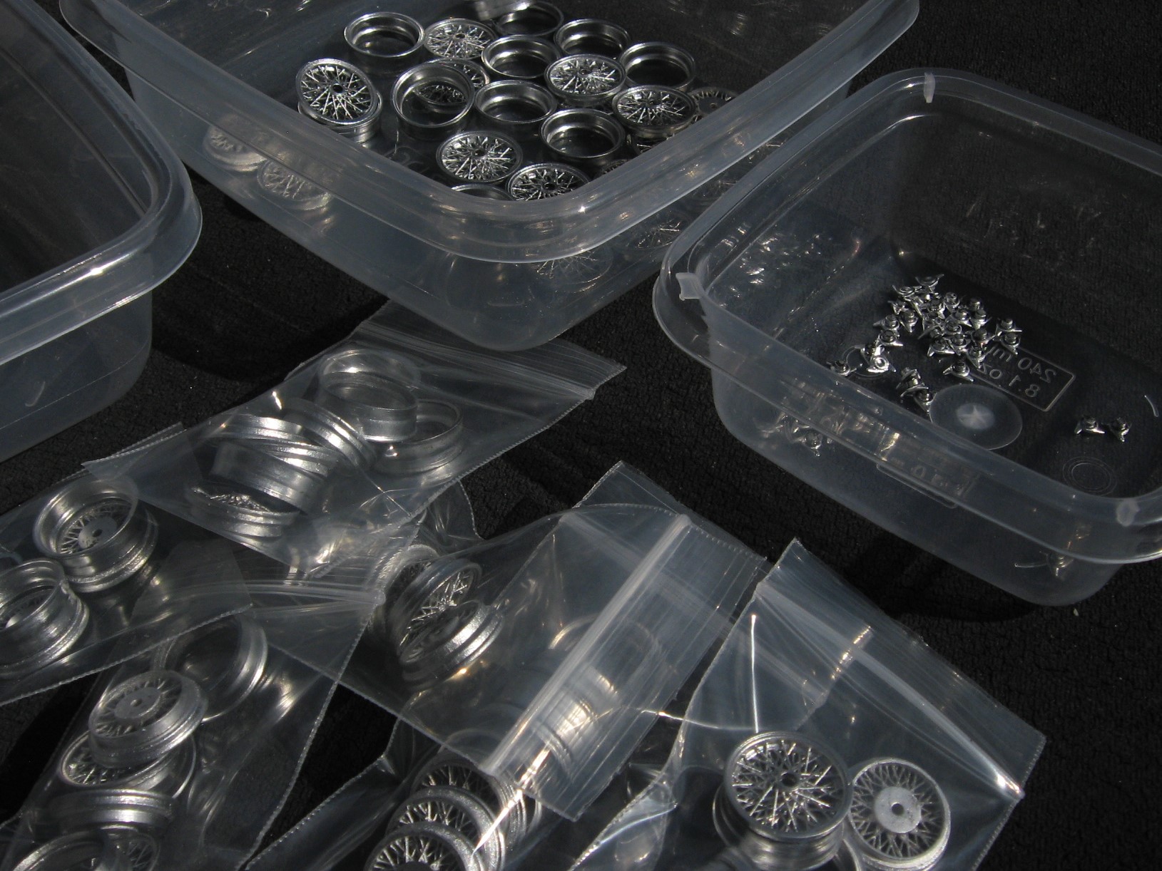

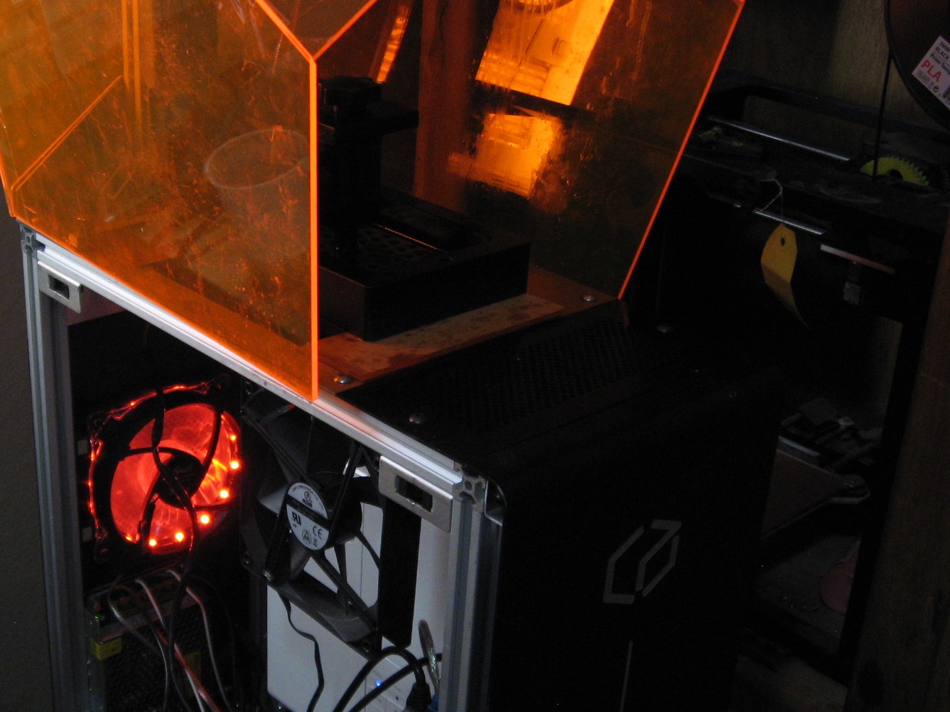

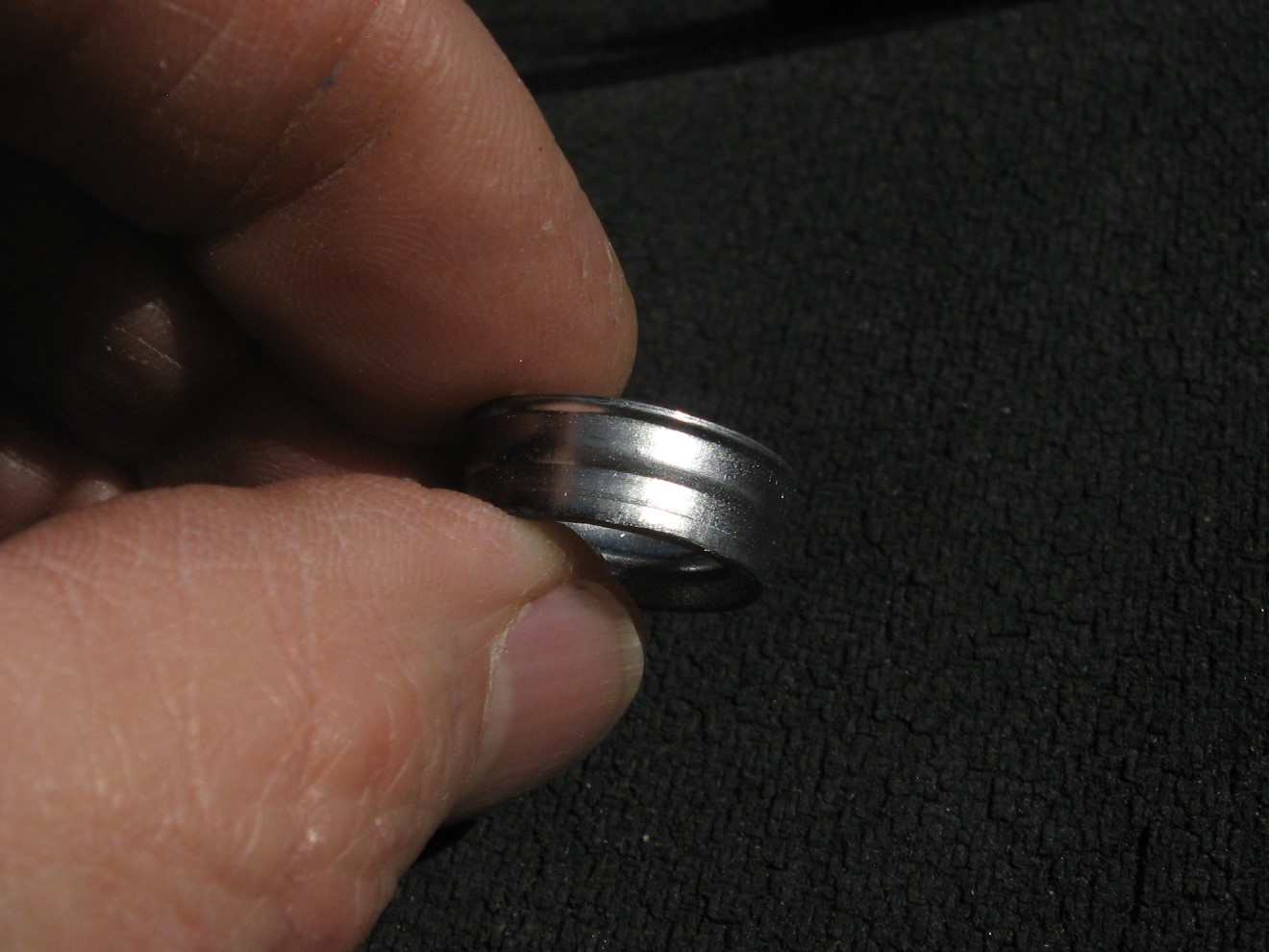

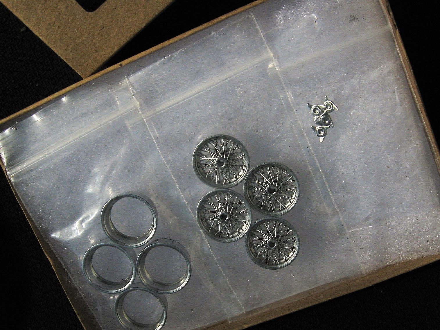

Randy D Posted February 28, 2019 Posted February 28, 2019 Casey, Apologies for not seeing your questions earlier. Those smooth grey rims were printed with a Wanhao Duplicator 7. 20 micron layers using 3DSR's ' ENG Tough ' resin. The D7 is actually the lowest cost machine of all our printers but works great for some parts. The following is an attempt to show what the 'finish' looks like on the Borrani wire wheels. I will start with the two machines used. The Wanhao D7 printed the larger backs and the knockoffs. For the fine detail needed on the front portion of the rims we used the Titan DLP printer using the orange resin.

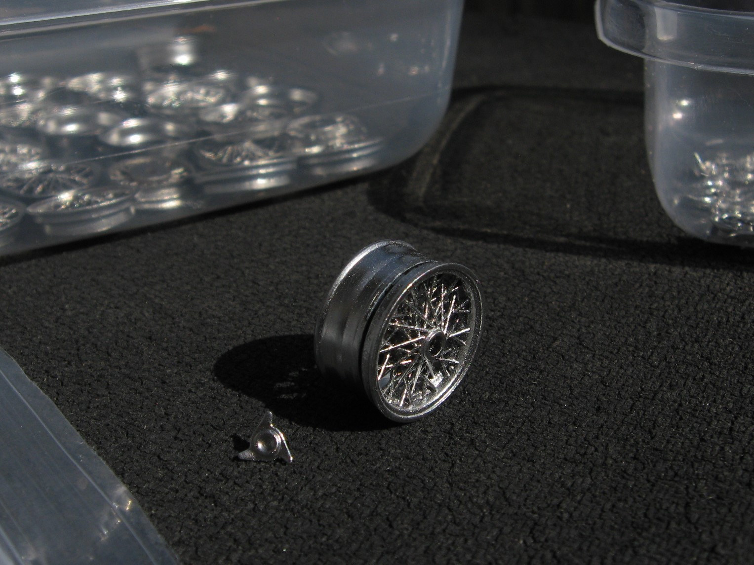

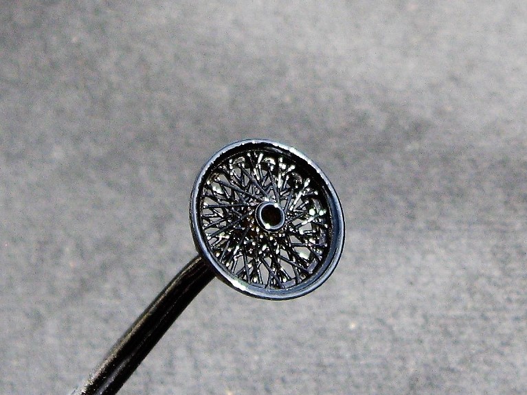

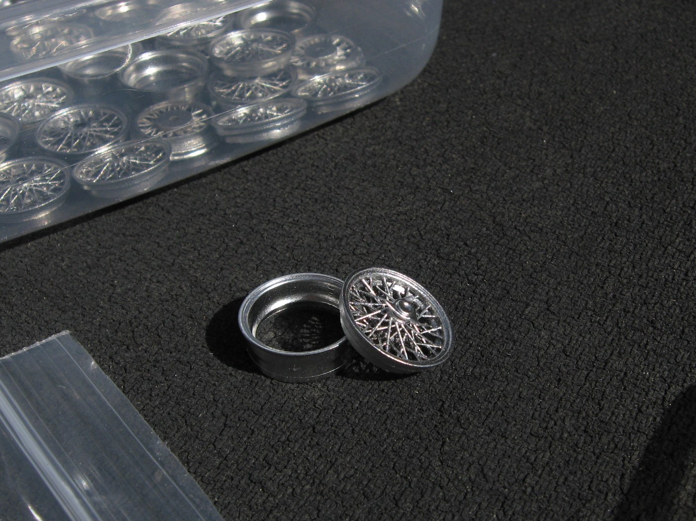

Randy D Posted February 28, 2019 Posted February 28, 2019 The parts do not get any sanding. These pics show them as they are printed and finished.... I use Mr. Surfacer 1000 as the primer. The last two pics show after gloss black..
SfanGoch Posted February 28, 2019 Posted February 28, 2019 Wow, Randy, those Borranis are gorgeous! When are they going to be available?
Gramps46 Posted February 28, 2019 Posted February 28, 2019 Very impressive Randy. Please let us know when you will be taking orders.
