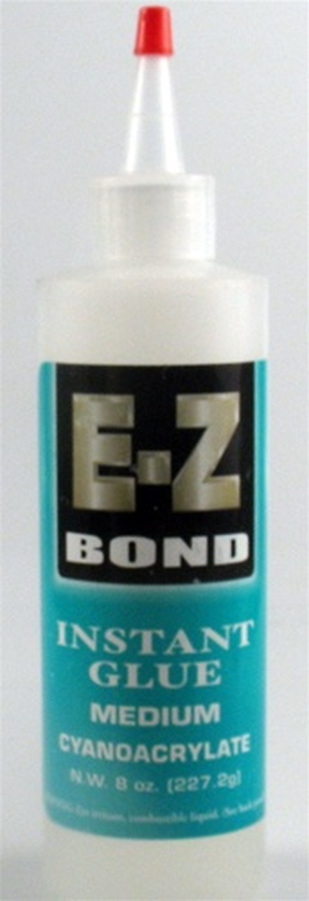

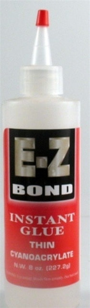

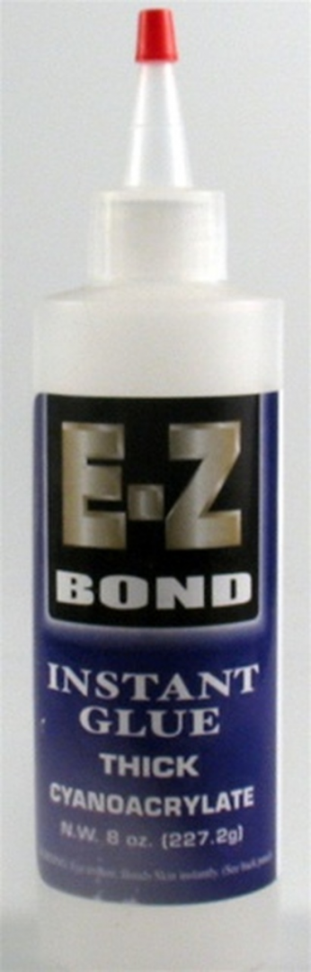

SfanGoch Posted June 21, 2019 Posted June 21, 2019 Get yourself one of the 8 oz. bottles of CA from Model Train Stuff. They're $16.99 each.
slusher Posted June 21, 2019 Author Posted June 21, 2019 On 6/21/2019 at 1:40 PM, SfanGoch said: Get yourself one of the 8 oz. bottles of CA from Model Train Stuff. They're $16.99 each. Expand Not a bad price..
