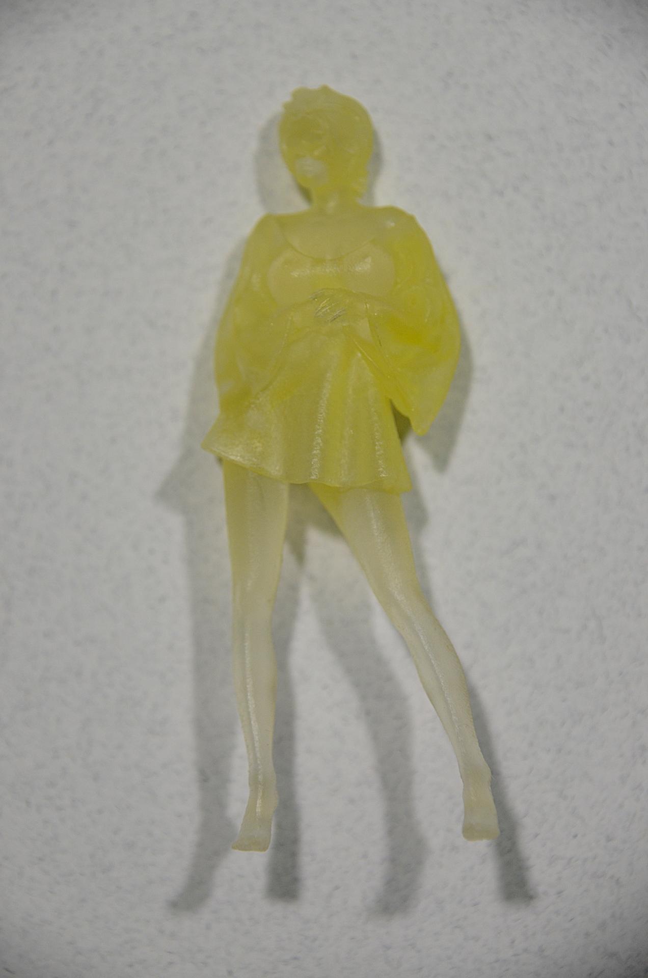

89AKurt Posted October 6, 2019 Posted October 6, 2019 (edited) I ordered several different products at the same time from Shapeways within the past year. Today I took out this figure, and discovered it's been having some sort of chemical reaction, it was pure clear when I received it, now it has yellowed, and seems sticky to the touch. Then I looked at this body, I had sanded it when I got it, now it seems to be growing fuzzy crystals on some of the surface. I brushed my finger behind the front wheel opening. I live in low humidity Arizona, still in same bags. Sun did not get near these. Edited October 6, 2019 by 89AKurt
Bugatti Fan Posted October 6, 2019 Posted October 6, 2019 (edited) Maybe complaining directly to Shapeways will be the way to go about resolving this problem by sending the product back for analysis. Don't know if they are a cottage industry or not, but they should replace faulty goods regardless. If you are not planning on returning the parts perhaps spraying a coat of rattle can automotive primer might help seal the surface. MB I believe make a nice range of styrene figure kits in 1/24th scale, worth a look at as an alternative. Edited October 6, 2019 by Bugatti Fan
Foxer Posted October 6, 2019 Posted October 6, 2019 Definitely contact Shapeways, they are too big now to ignore any problems with their materials. I've used them to make impossible the craft parts for a few car model builds and have been pleased with their service.
Spex84 Posted October 6, 2019 Posted October 6, 2019 Hmm, I've never seen this before. I'd definitely complain...seems like a bad batch of resin or something of the sort.
iamsuperdan Posted October 7, 2019 Posted October 7, 2019 Interesting. I've ordered a lot of items off of Shapeways and have never had an issue.
peteski Posted October 9, 2019 Posted October 9, 2019 Crystals forming in FUD resin (or whatever they are calling it now) is not uncommon. Was discussed at length on Shapeways forum. https://www.shapeways.com/forum/t/fine-detail-plastic-crystallization-formation.68722/ Yellowing is new to me.
89AKurt Posted October 9, 2019 Author Posted October 9, 2019 1 hour ago, Lownslow said: Wash in alcohol, set it out in the sun I'll give that a shot, AZ has more sun than Chicago. 38 minutes ago, peteski said: Crystals forming in FUD resin (or whatever they are calling it now) is not uncommon. Was discussed at length on Shapeways forum. https://www.shapeways.com/forum/t/fine-detail-plastic-crystallization-formation.68722/ Yellowing is new to me. Thanks for the link, read the first and last pages.
peteski Posted October 9, 2019 Posted October 9, 2019 You bet! As for the yellowed resin, was it stored near some other item which could have affected the resin that way?

Draggon Posted October 10, 2019 Posted October 10, 2019 On 10/8/2019 at 10:32 PM, peteski said: Crystals forming in FUD resin (or whatever they are calling it now) is not uncommon. Was discussed at length on Shapeways forum. https://www.shapeways.com/forum/t/fine-detail-plastic-crystallization-formation.68722/ Yellowing is new to me. I read the first and last pages. All I can say is wow. I also read this: "Water-based acrylic paints meant for plastics is strongly recommended. Other paints, especially enamels, may not cure on Frosted Detail 3D-printed plastics."

89AKurt Posted October 25, 2019 Author Posted October 25, 2019 On 10/8/2019 at 9:18 PM, Lownslow said: Wash in alcohol, set it out in the sun I gave it a shot! Exposed the back first soon after washing. Got rid of the yellowing, but introduced what looks like wood grain. I have ordered other figures, in the white material, no sign of change, yet.
Spex84 Posted October 26, 2019 Posted October 26, 2019 Oh, ok...looks like the waxy supporting material (normally removed by Shapeways) wasn't entirely gone yet. Once its fully removed, you get that white-ish grainy surfacing where the support material was attached. This model appears to have been printed horizontally, face-up. I tend to buff those grainy areas with a toothpick to knock the grain down. Then I primer and figure out how much sanding or filler I'll need to remove the texture/deposition layer lines (the "woodgrain" effect)
peteski Posted October 29, 2019 Posted October 29, 2019 Yes, the white fuzz is in the areas that were supported by wax. When the model comes from Shapeways, the wax is not fully removed, so those areas look smoother. Alcohol removes the wax, exposing the rough surface. This i normal. Only way to get rid of that is by mechanical means (rubbing/sanding, then a coat of primer should smooth things out further.
89AKurt Posted November 15, 2020 Author Posted November 15, 2020 (edited) Yes, I'm dredging up my own thread, because I've seen the repurcusions of ignoring the little voice in my head. Over a year later, it looks like she is wearing a raincoat. This is the translucent plastic, not the white opaque such as some other figures I got from Shapeways that aren't showing this issue. The skin is Testors acrylic, the dress is Liquitex acrylic artist paint. I had sprayed Testors flat clear over. The edge of the dress has melted too. So is this the different paints reacting, or the figure's plastic? Edited November 15, 2020 by 89AKurt
