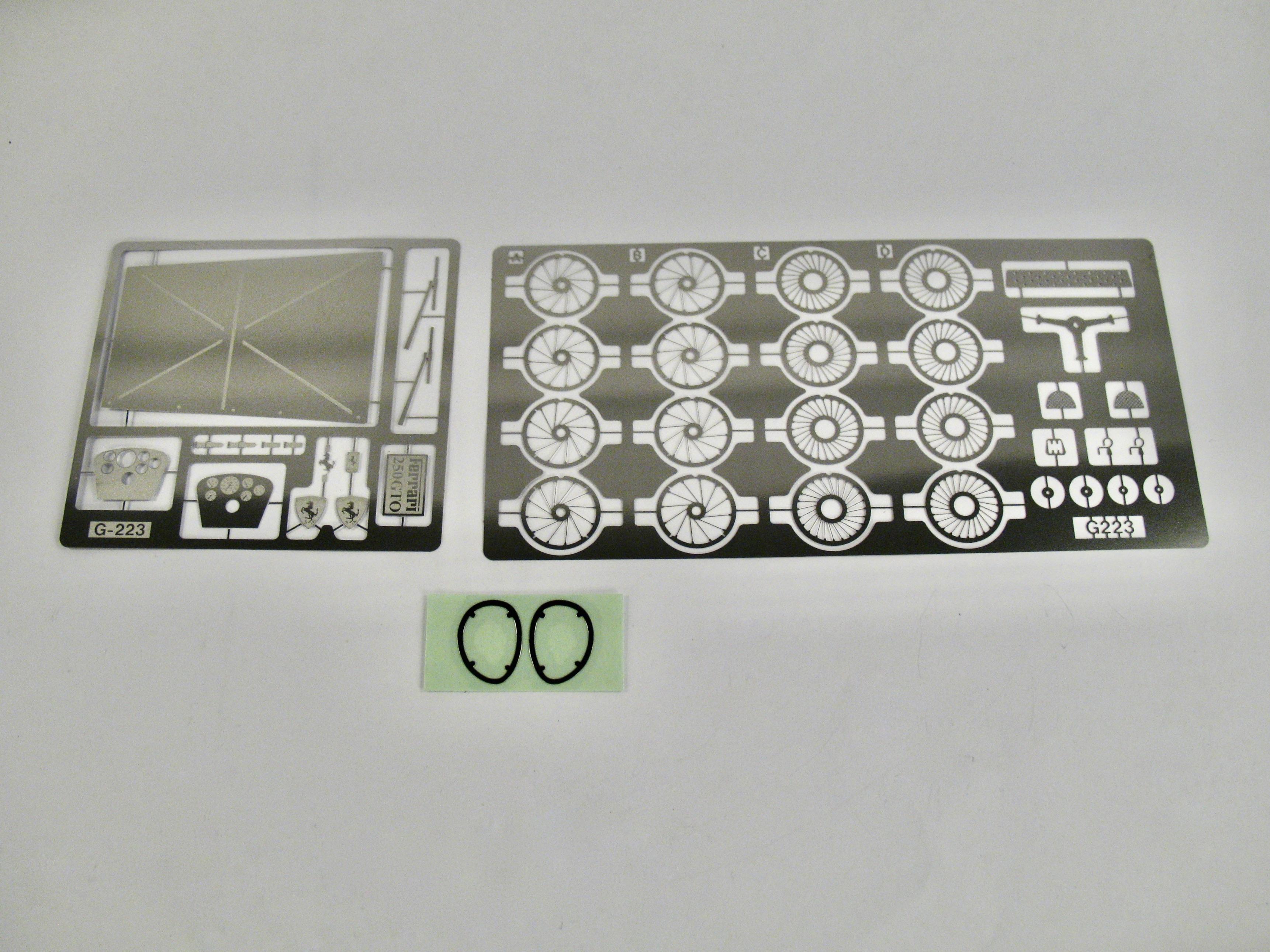

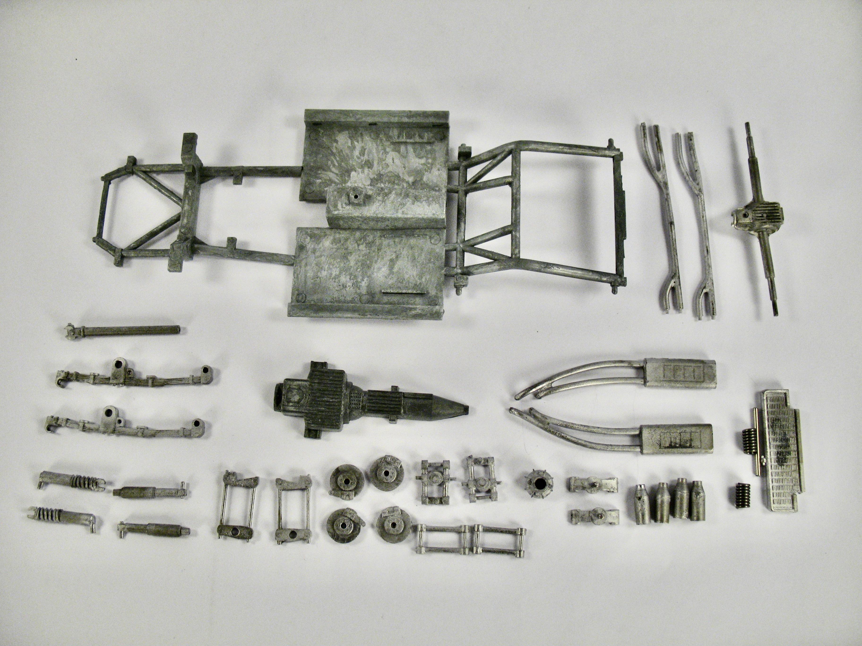

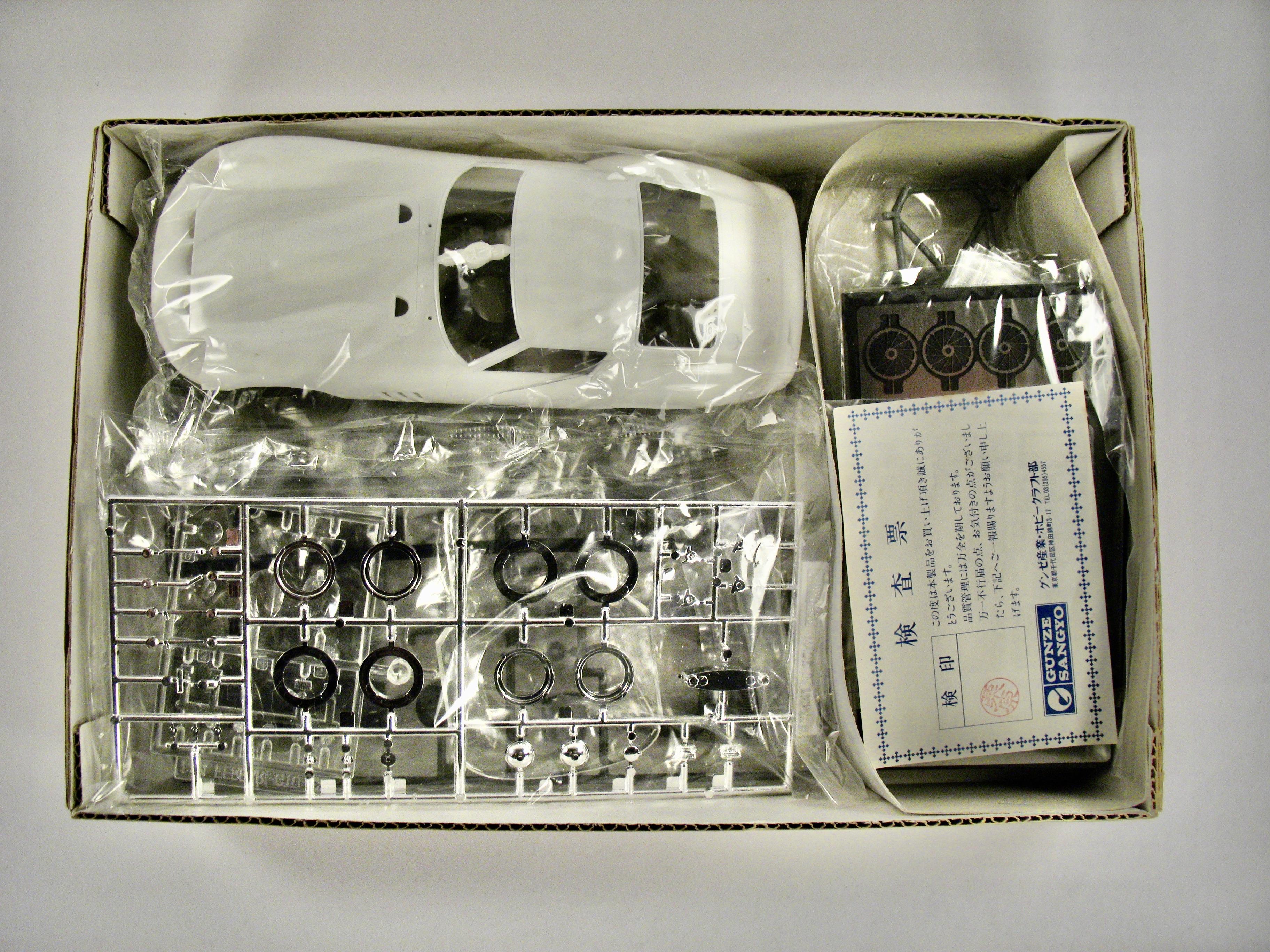

The kit has two sheets of photo-etched parts.

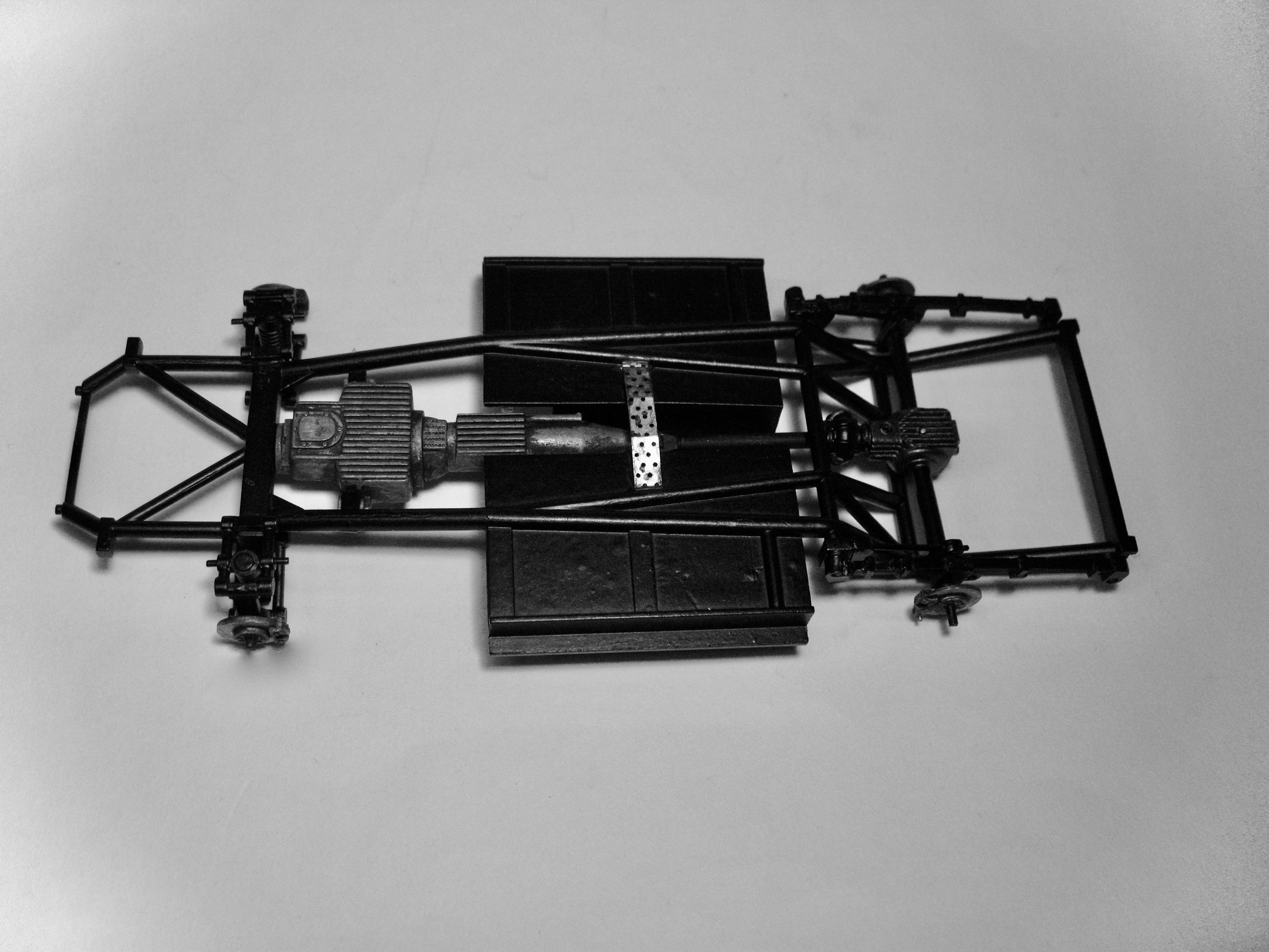

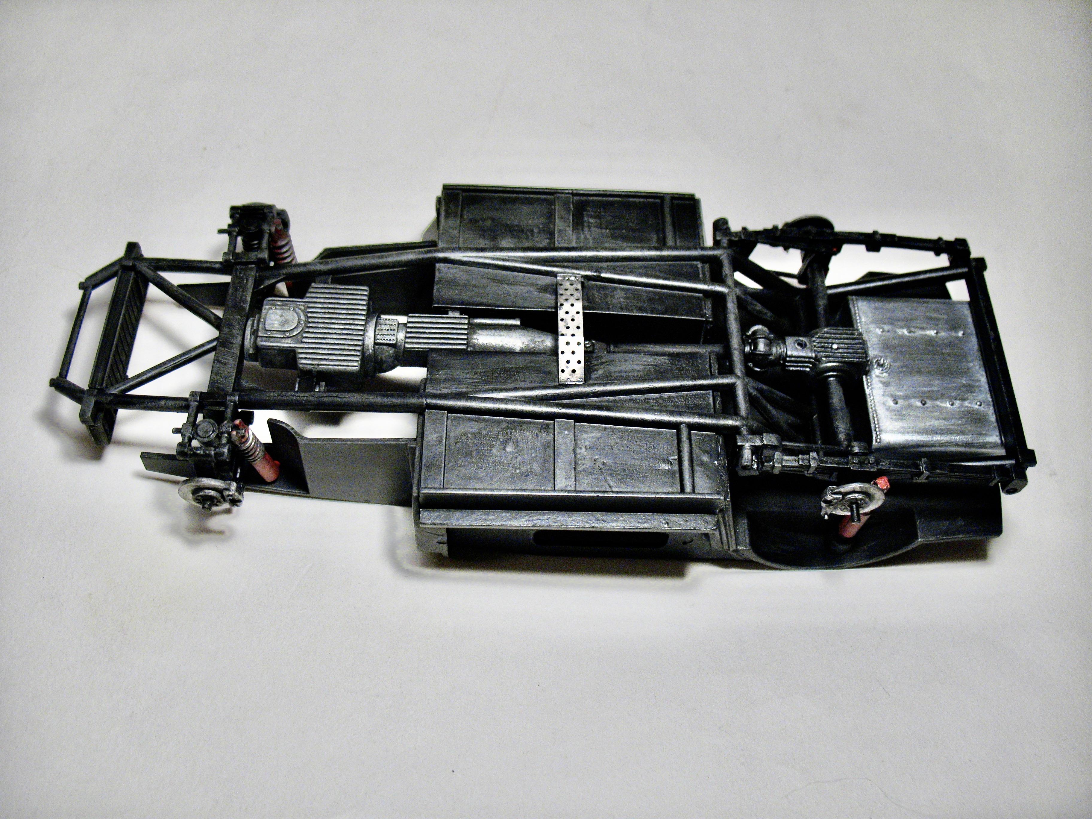

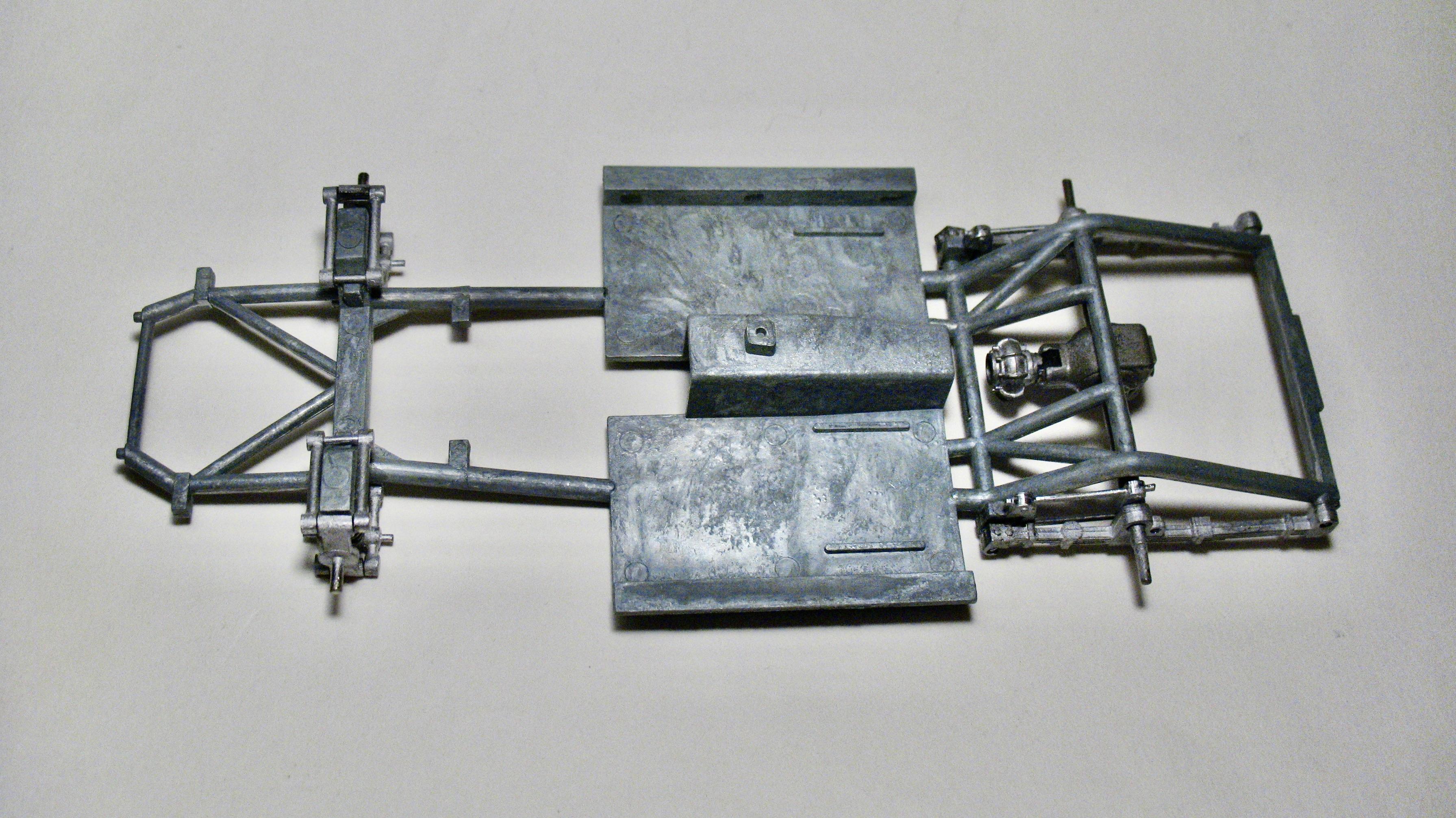

First thing to build is the chassis. It could be little difficult because the metla part some time are not straigh. Before paint the chassis and the body, I moke them up to check that the fenders are centered with the center of the axles.
Chassis painter and light weathered. Also added the "motor".

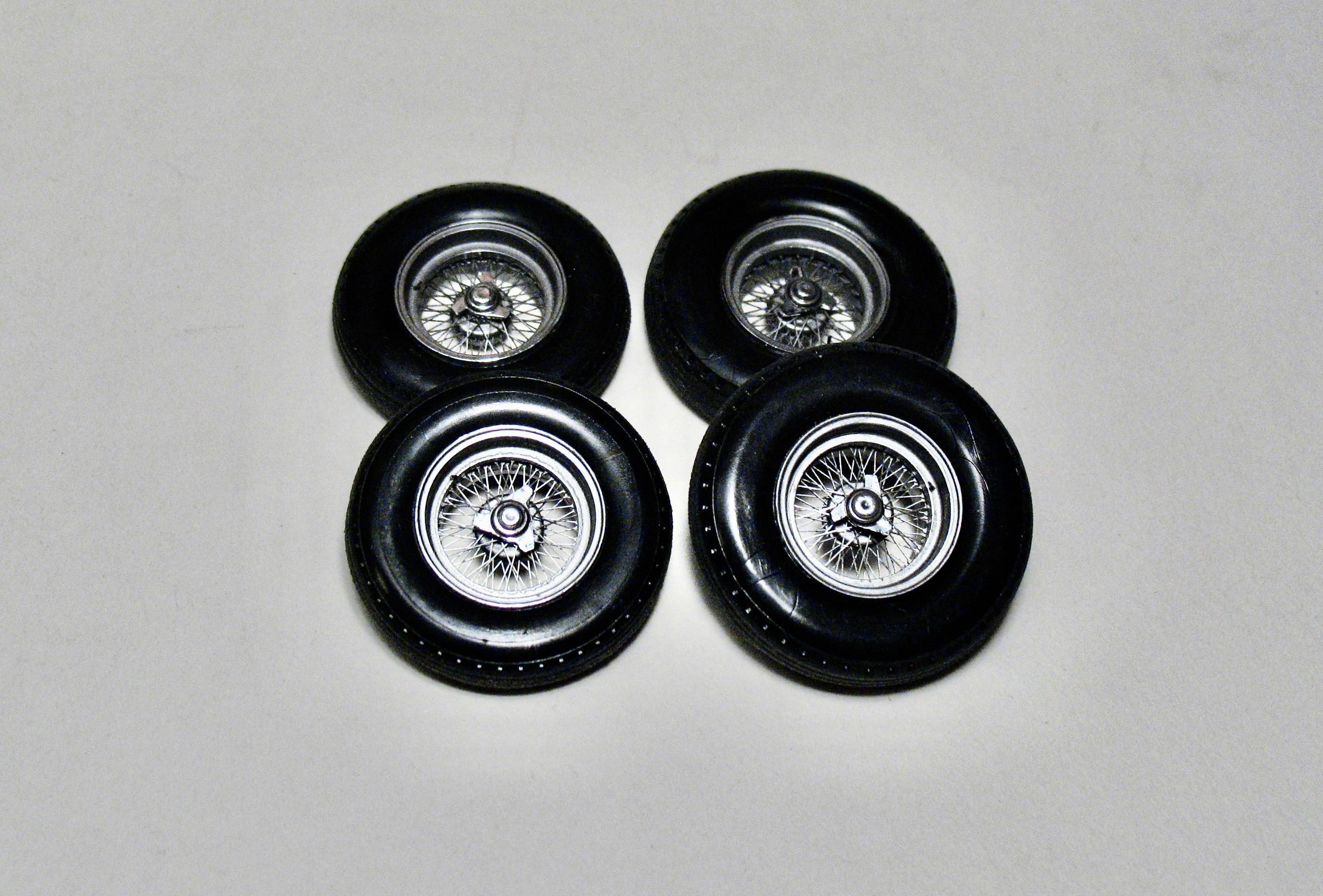

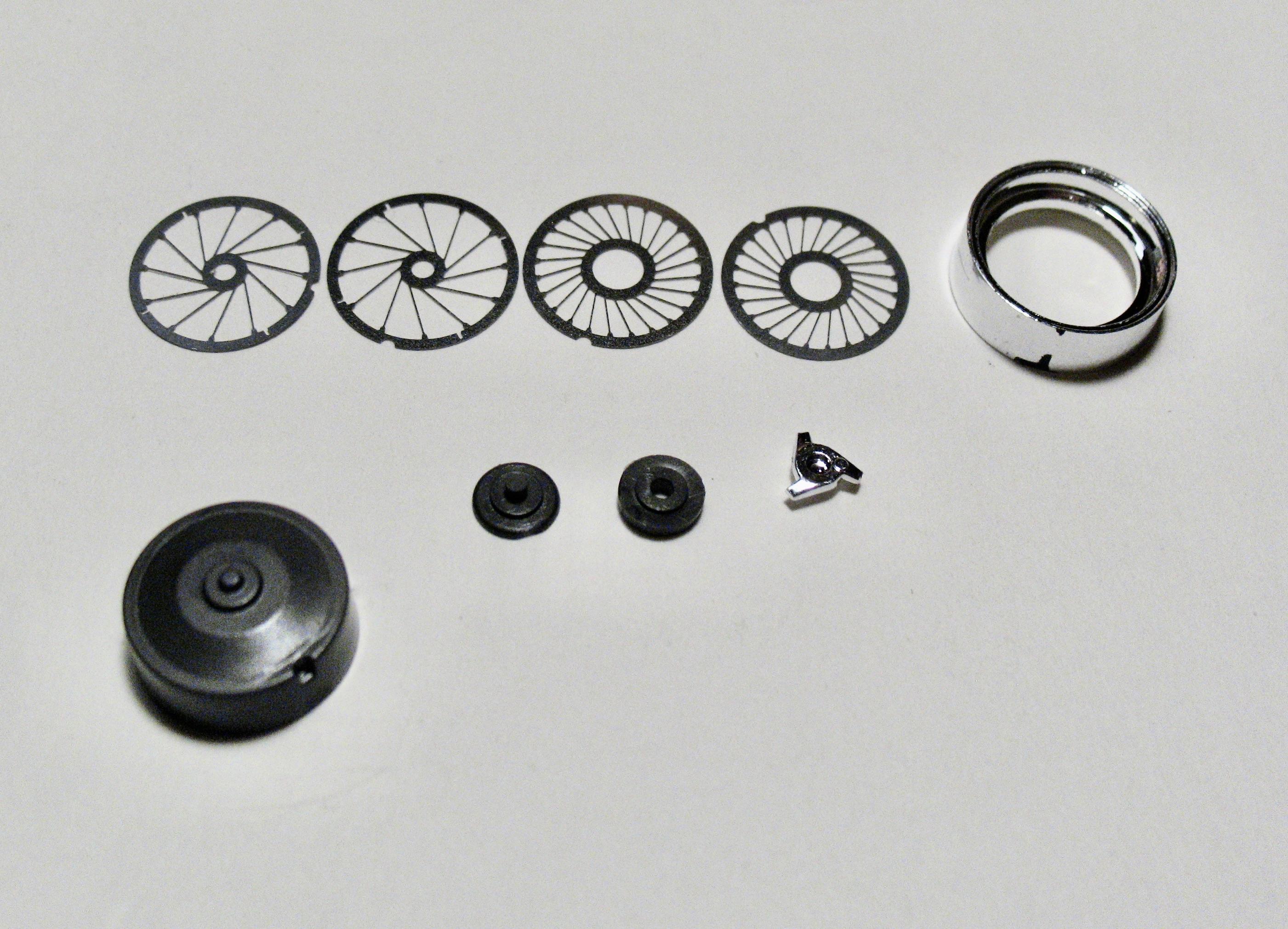

More progress... Speaking of rims... Here all the part for make one rims. The dome shape part on the bottom left, will help to bend the spokes.
Here the wheels done. I wish the tires had more details and a corrected shape. But over all they looks great!

2 hours ago, wisdonm said:
I wish you could buy those wheels separately and at a reasonable price.
Anything that is low production and involved for manufacturing is going to cost.  Over the years have acquired Herb Deeks set, which is cast metal rims which I don't like, but nice tires; Hobby Design and KA Models have turned aluminum rims which are superior.

The chassis is pretty much completed. I did a light wash too.

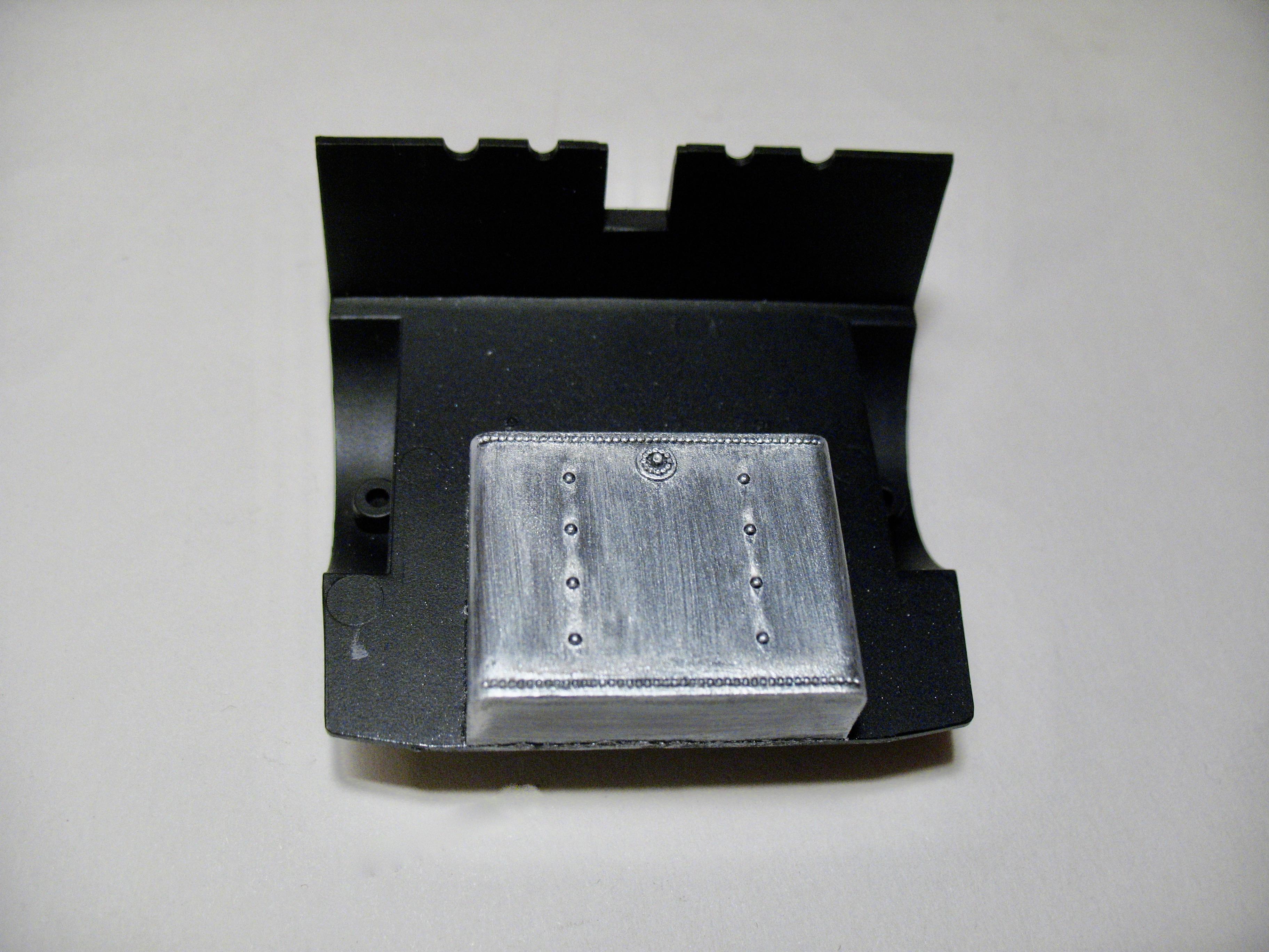

Gas tank painted and washed
Chassis all completed with part of the interior

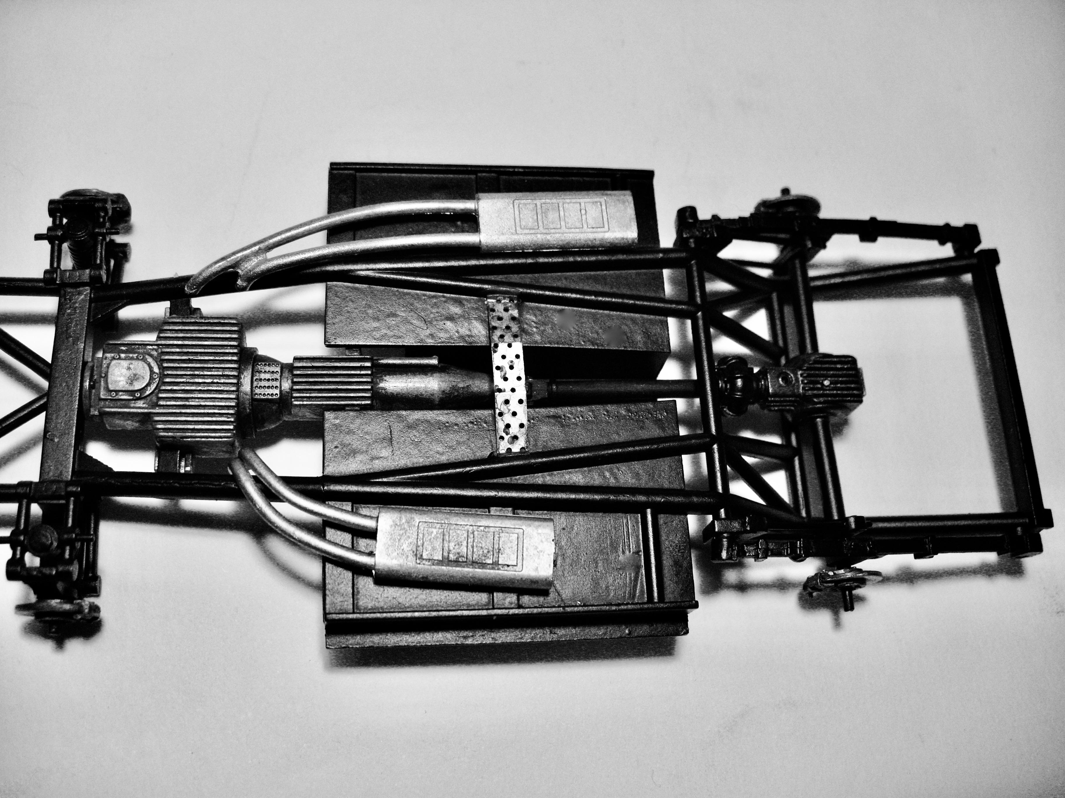

Testing the exhaust options. Stock on the top, shorted on the bottom

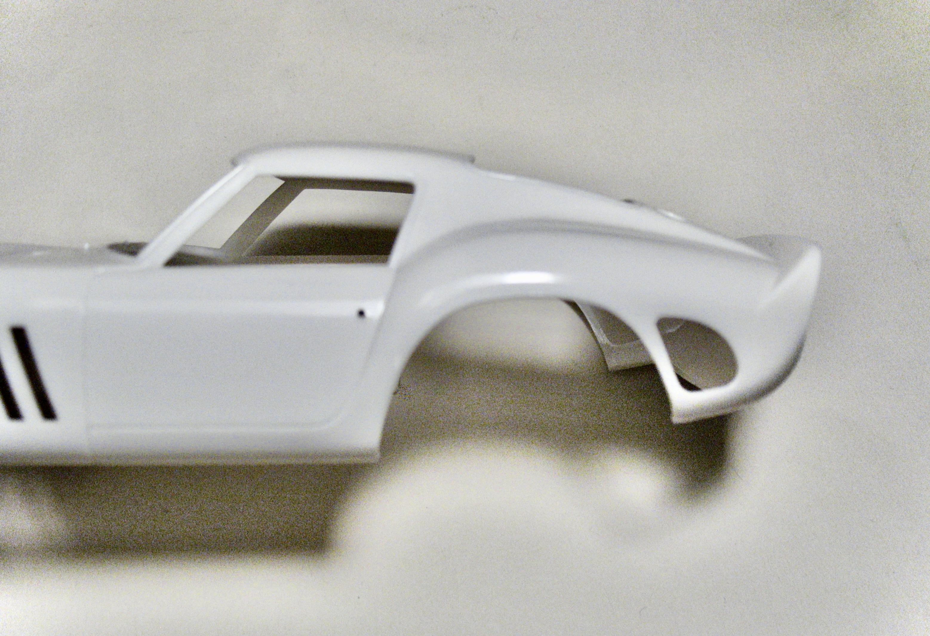

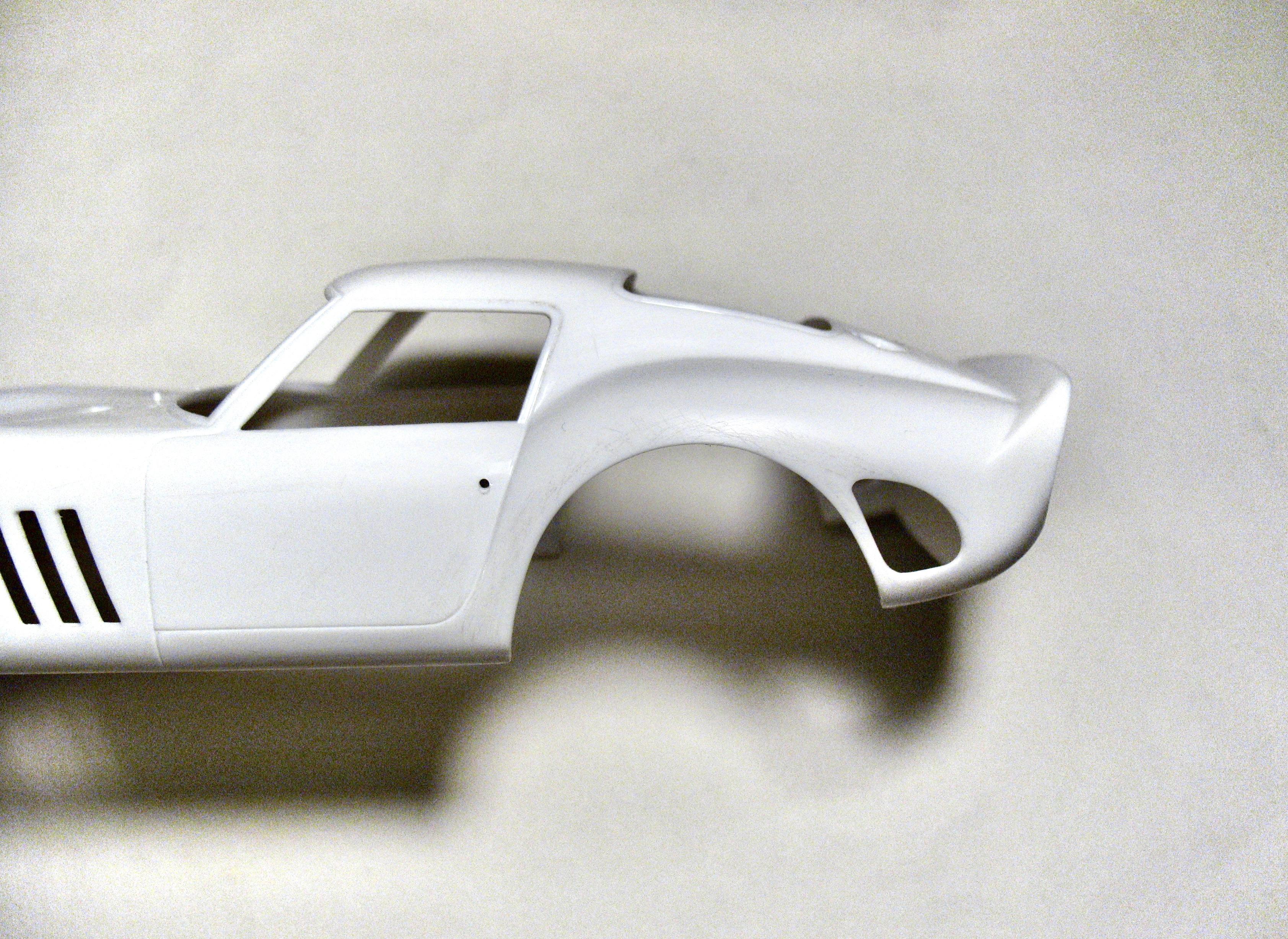

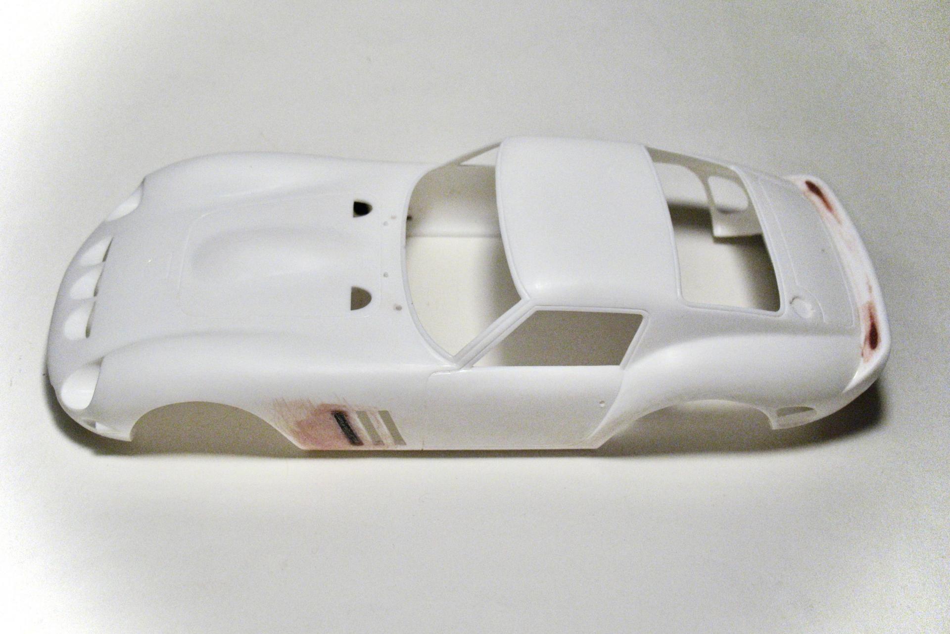

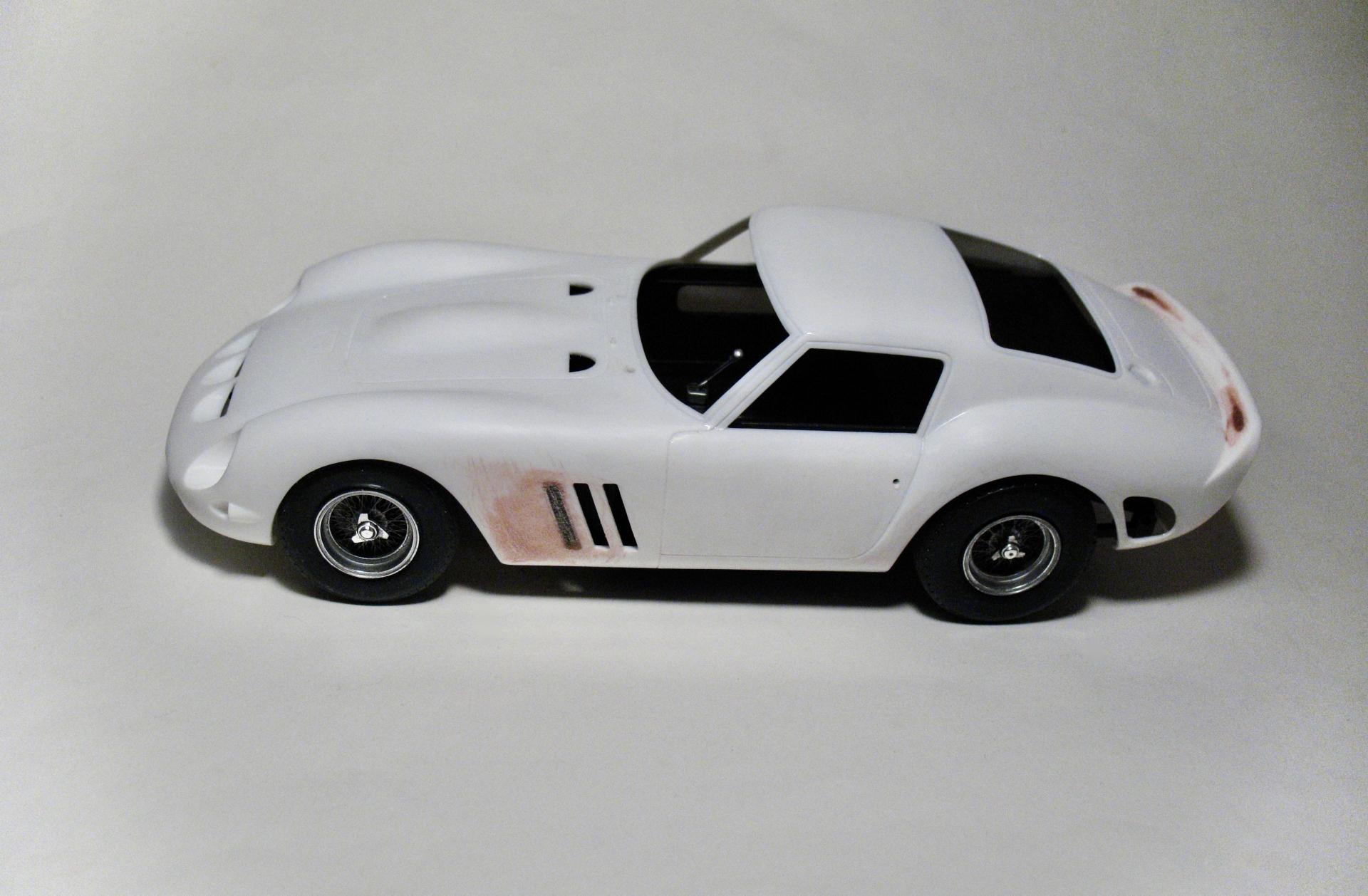

The body is ok, the big issue is the rear fender, the wheel opening on the top part is almost flat. When in the real car is round. Sorry for the blurry photo
Corrected the wheel opening on the fender
Link to comment
Ooooh! One of my favorite Ferraris! I'm DEFINITELY following along! And YAY!!..............you fixed those incorrect rear wheel wells! That's what kept me from buying this kit back when it was new. They always appeared "big" to my view and very good job in getting them correct! ?
Is one of my favorite Ferrari too! I was thinking to build with stock fender, but I couldn't stand it... I retouch the front one too, but little bit only.

6 minutes ago, mrm said:

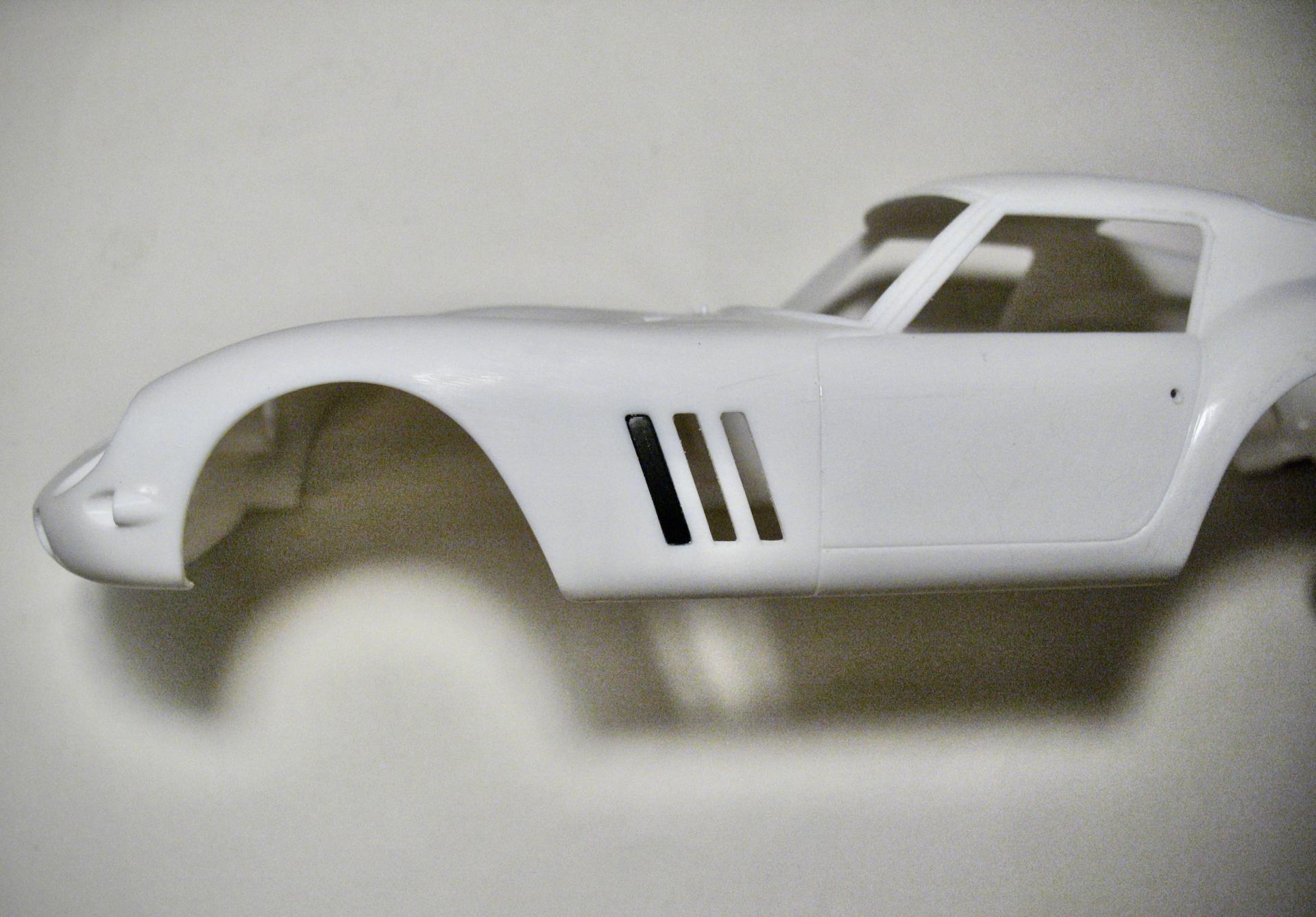

Very nice so far. Why did you close one of the vents?
Some originals have two, others have three. It depends which car your kit is meant to be a model of... They were all hand-built, so there's quite a lot of variation between individual cars, for example in the rear wheel arches...

3 minutes ago, Brizio said:
The one I'm building has only two
I guess I formulated my question wrong. That’s what I meant. Which car are you building? The most famous of them all (The red ones) - the 22 car, has three.
