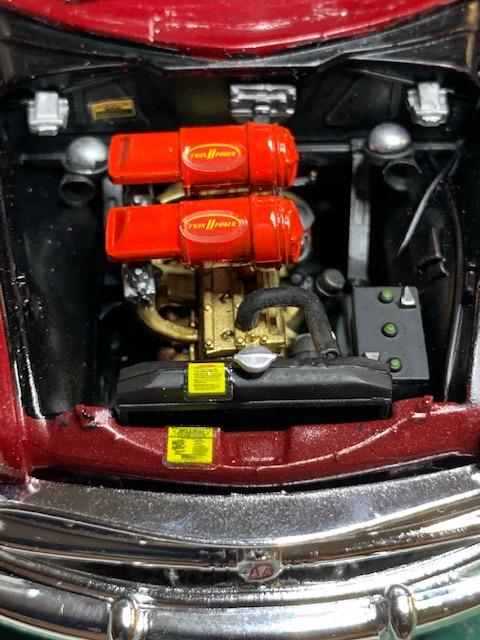

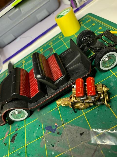

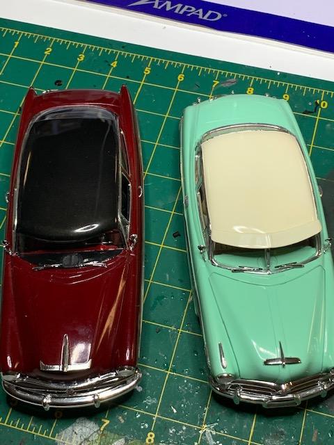

Hi. I started working on my second Hudson. I've been experimenting with colored, clear overcoats. For the new Hudson, I used Testor's one-stage lacquer and then sprayed Tamiya Clear Red. The result came out pretty good. Then for the hood, Tamiya Gunmetal with a coat of Tamiya Smoke on top. Again, I liked the results.
My biggest challenge with this is the bare metal foil. I thought I had sanded the trim smooth but after applying the foil, I could still see some particles poking out of the trim. Aaargh!! Kind of defeats the purpose of having a nice paint job. I think my next step will be to re-apply the foil after I clean up the surface a little better. Always something to learn.
I included a couple of photos of the first Hudson too.
