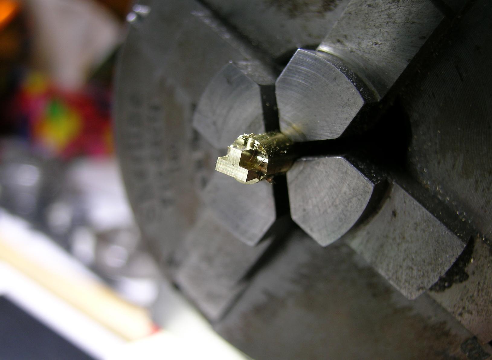

Hello again everyone,

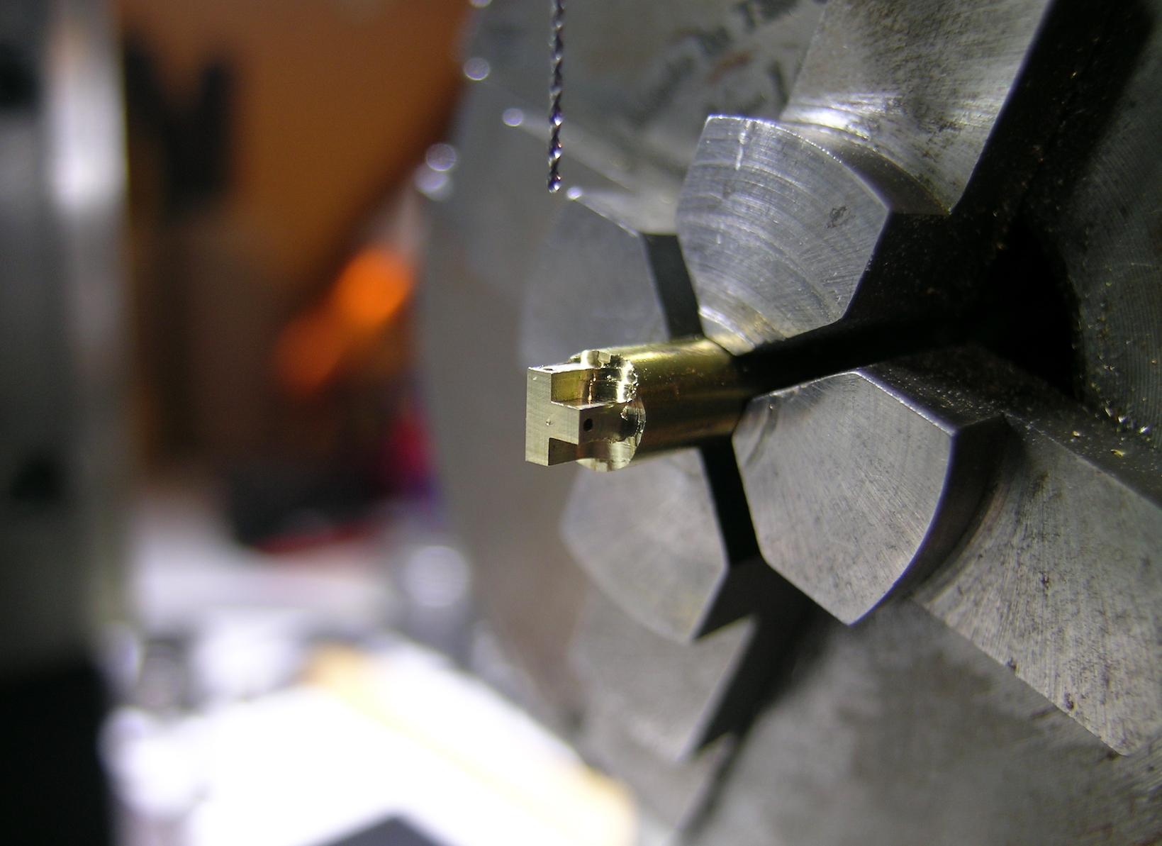

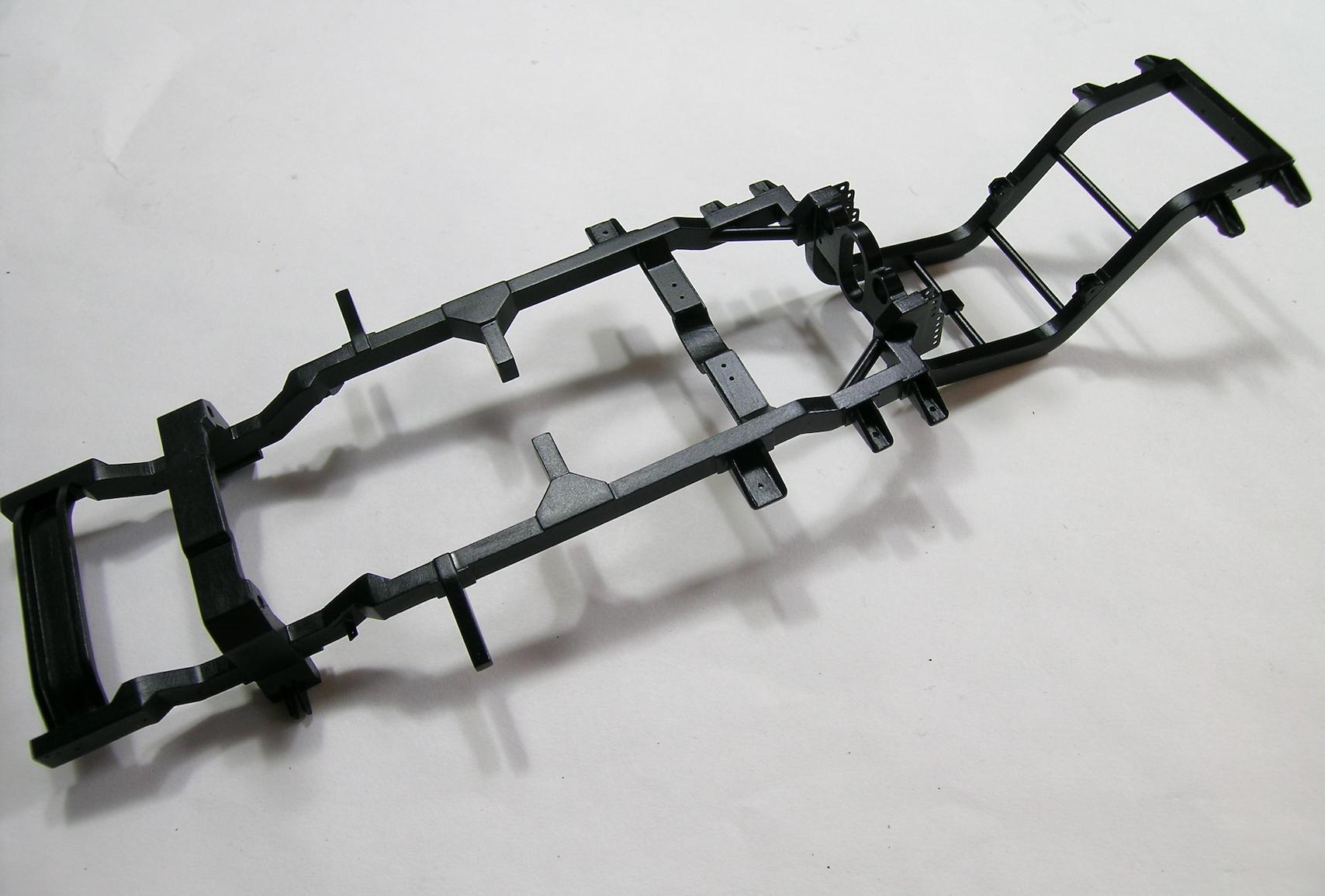

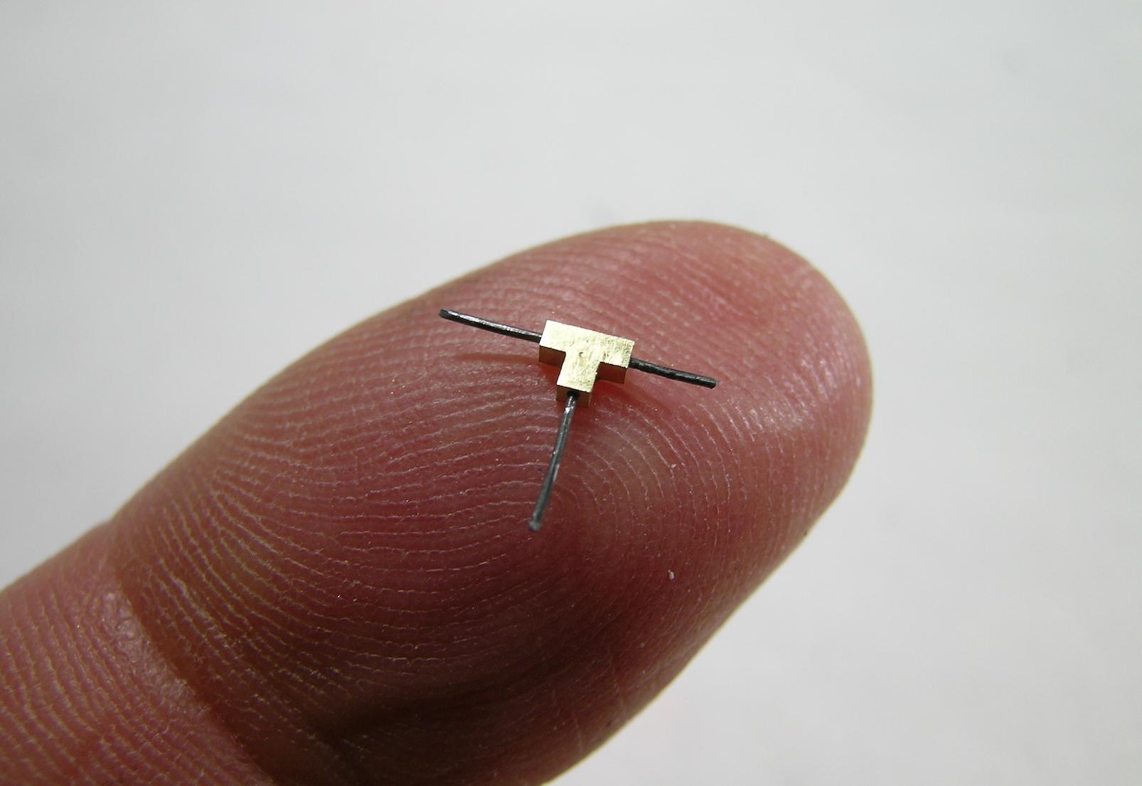

This is my second update this week, but despite the fact that little progress has been made, I'm happy to show you the painted frame with another small component for the brake system.  I made the t-valve and a small bracket to mount it on the frame above the differential, I'll run the flexible brake lines from there and connect them to the rear brake calipers.  I'm going to start assembly next week (my parts box is full...) and I need to see some different progress on this thing (probably you do too...).  I'll continue to build the remaining parts as I need them and hope to paint the many body parts in the next few weeks.  Comments and suggestions are welcome.
Francis
T-valve at early stage in the milling chuck.509_Tee_Valve_Prog_1.JPG.d3fba14a508b81c27ed217b5375b2b1e.JPG
Drilling in progress using a 0.016" drill bit.510_Tee_Valve_Prog_2.JPG.366df499a3c844cced5bdbcda7f15986.JPG
Final t-valve before the mounting bracket added.511_Tee_Valve_Prog_3.JPG.76b41c2ddfd9f817264632ca63426afb.JPG

Back in black... freshly painted in semi-gloss black (Tamiya).514_Frame_Painted_1.JPG.54aacd6124e515161006d9fa7c2a858e.JPG
Other side view.  It will dry until next week for the beginning of some assembly. 😊515_Frame_Painted_2.JPG.7a0276262d4ed2f3fe84cd808e8bf98c.JPG
