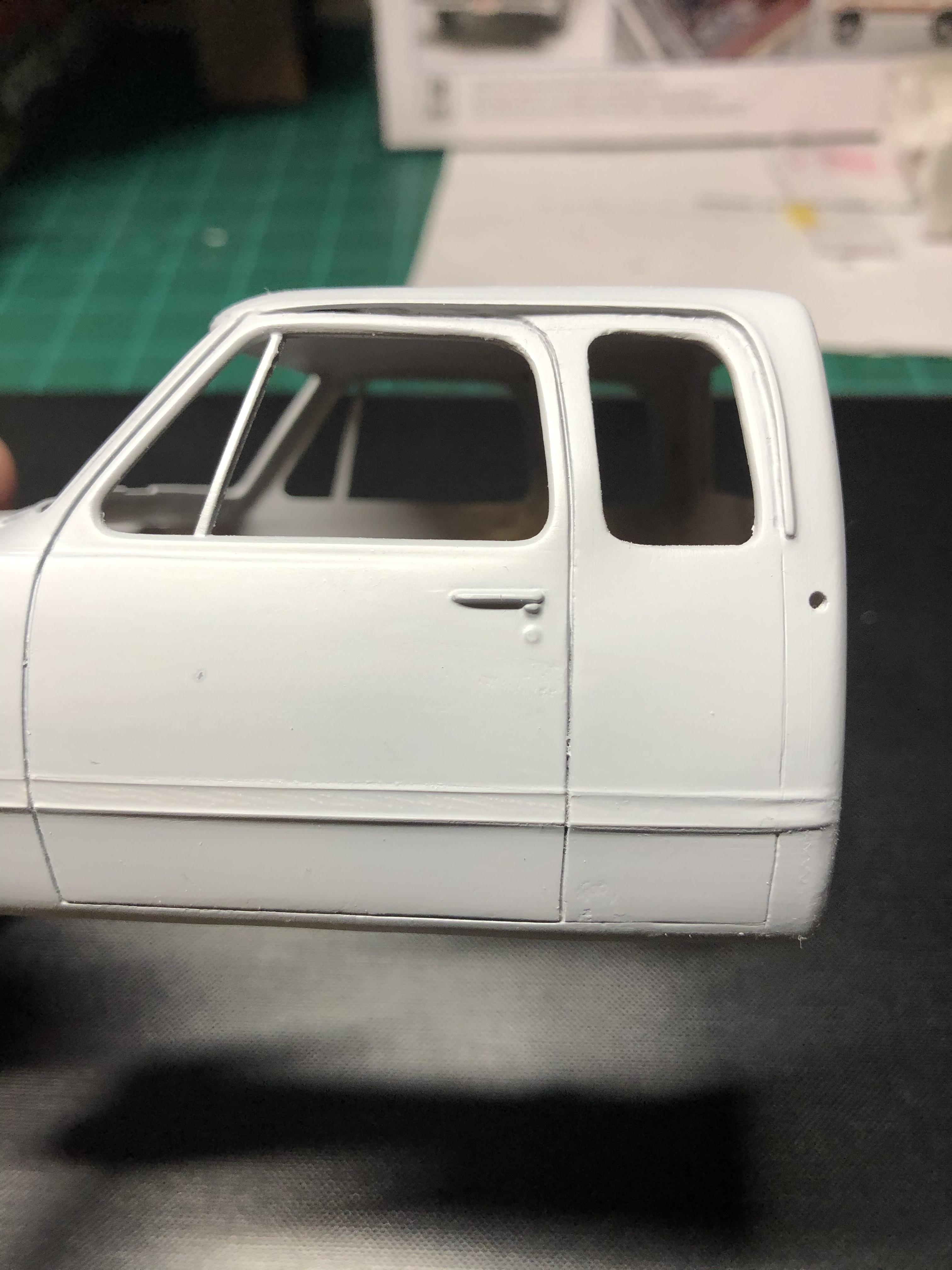

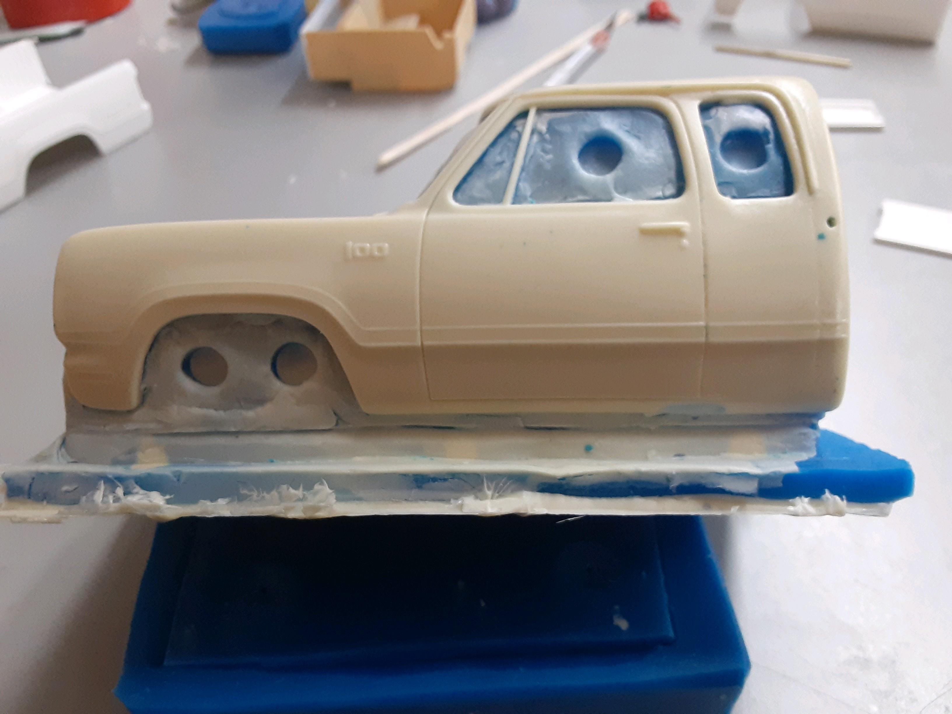

tuffone20 Posted March 20, 2020 Posted March 20, 2020 Here is a resin copy of the cab, it’s being tweet just a little in a few area’s.
mikemodeler Posted March 20, 2020 Posted March 20, 2020 That is looking fantastic Marty! I sure hope you consider replicating the 4wd components, you would make a lot of people happy.
mopardes Posted April 24, 2020 Posted April 24, 2020 On 3/20/2020 at 5:33 PM, tuffone20 said: Here is a resin copy of the cab, it’s being tweet just a little in a few area’s. Im gonna have to figure out how to sand off the 100 for a 200...photo etch maybe ? 3d print?
mopardes Posted April 24, 2020 Posted April 24, 2020 Report post Posted just now On 3/20/2020 at 5:33 PM, tuffone20 said: Here is a resin copy of the cab, it’s being tweet just a little in a few area’s. Im gonna have to figure out how to sand off the 100 for a 200...photo etch maybe ? 3d print?
