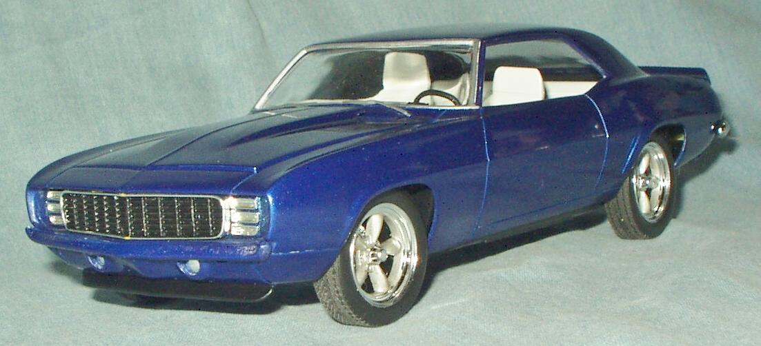

Speaking of accuracy, you're obviously into it if you're going to the trouble of altering the chassis. Are you planning to do anything about Revell's horrendous representation of the '69 RS front end?
Revell would have you believe the hidden headlight doors sit 4-6" deep into the grille. They do no such thing. I have an actual '69 RS grille hanging in my garage and those doors are no more than 2" deep. The actual grille portion is darn near flush with the front-end sheetmetal, or not more than 1" recessed.
Here's a pic of a real one to give you some idea what I'm talking about. Compare this with what the kit gives you to work with.
I tried to address this with my own latest Revell Camaro build. I made progress, but only got the doors about halfway out to where they need to be.  Rushed to finish the thing for a BOYD build deadline, I never went back and had a second go at it--perhaps I should. I did take some in-progress pics of how I removed the doors from the grille that show what I was trying to do. Be happy to post them here if you wan't but I don't want to hijack your build thread. B)

Going to try.  I have the MCG PE set that should help some.  I was wondering if the setup was more for the non-RS which I think was deeper set?  Also going to be doing this to the engine
