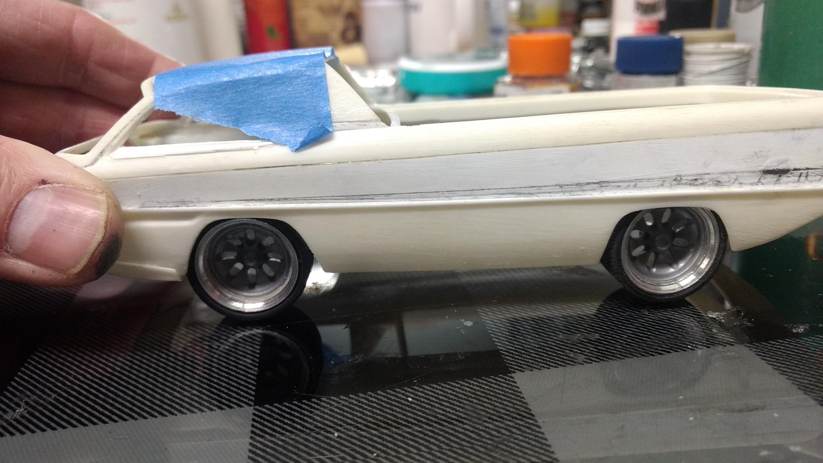

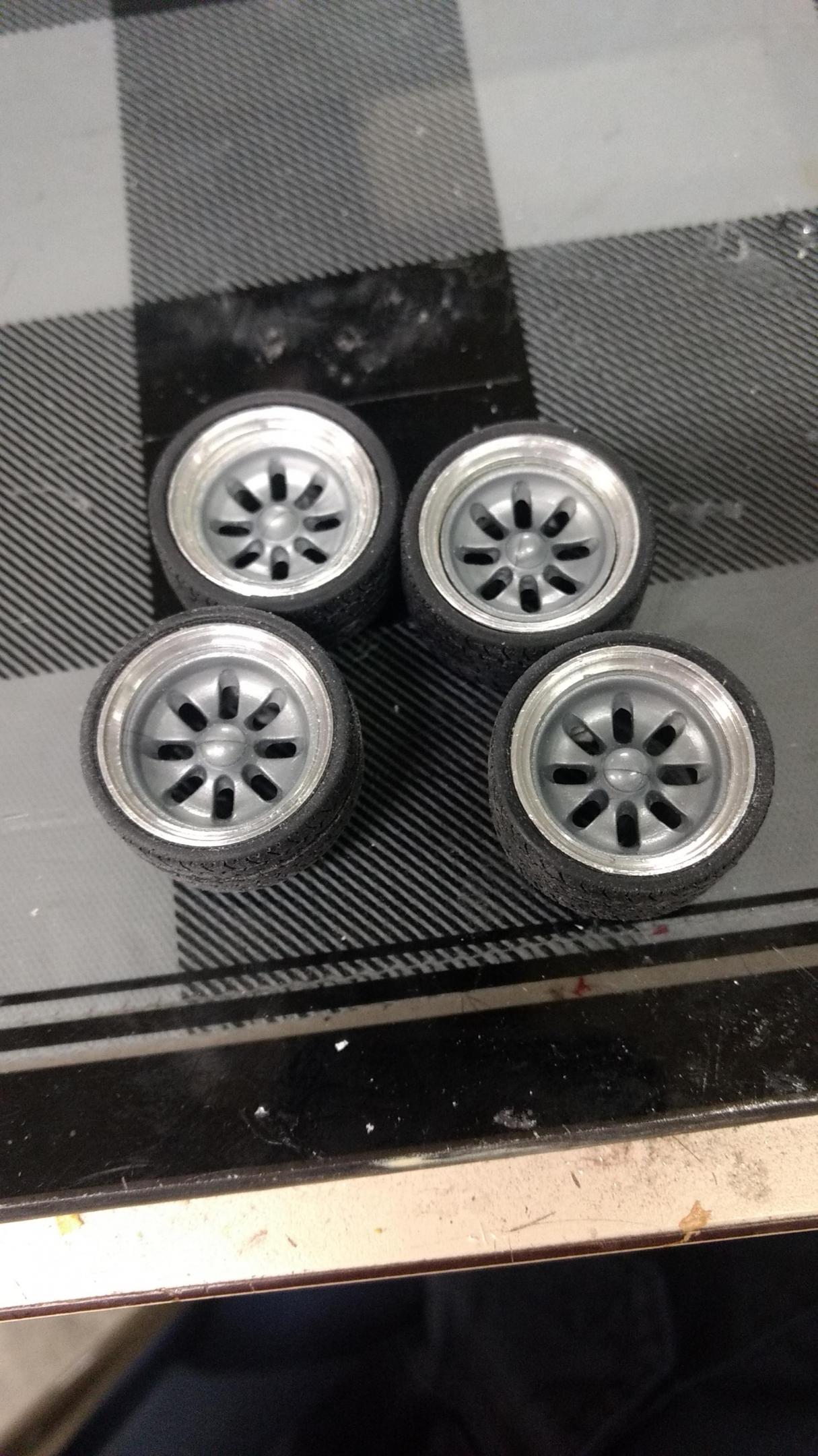

Modlbldr Posted March 22, 2020 Author Posted March 22, 2020 Here is the first step I took which was to cut the B pillars and lower the rear of the roof. Next is to reshape the side window openings by removing the darkened areas. I have had these wheels in my stash forever and I think they are a close representation to the drawing so I will be using them. That's it for now on my progress. I just started slicing on this an hour ago. Comments and criticisms welcomed. Later-

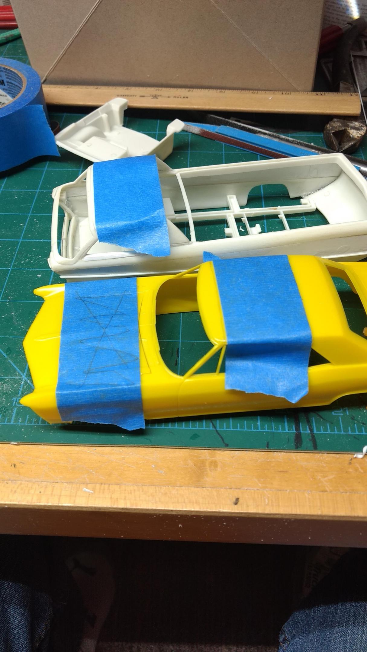

Modlbldr Posted March 22, 2020 Author Posted March 22, 2020 Well, thanks for the interest in this guys! I appreciate it very much. Snake- I'm not sure exactly how it's going to work out for the moment. Right now the only plausible answer I have is Physics, schmysics.... Lol. I got the side window openings roughly shaped in. I have to figure out where and how to shorten the nose of the Rivi and attach it, including the windshield since the shape of the windshield in the drawing is definitely Riviera and not Deora. My first thought is to cut the entire front clip of the Riviera, including the windshield frame, remove the front of the Deora, including windshield frame, swap the parts and then shorten the nose of the Riviera. Fortunately I don't have my saws at home with me so I won't get in a rush to cut. I have a day to think about it first. Later-

Modlbldr Posted March 23, 2020 Author Posted March 23, 2020 Thanks guys. 7 hours ago, djflyer said: Love this Gary Campesi design. I've been collecting parts to do this build for a while so I'll definitely be watching to see how you do this one. Are you staying with the Deora kit driveline or planning to change that also? I haven't given a lot of thought to it but so far the plan is to use the Deora chassis because I have it. I don't have the chassis and suspension for the Rivi. I made some down and dirty cuts tonight. No real measuring. Just eyeballing it. Hopefully I'm not off. Later-

Modlbldr Posted March 27, 2020 Author Posted March 27, 2020 Thanks for the idea Alan. I'll have to look at what that might do for the design. Got some work done on the wheels. Parts box wheels with aluminum Pegasus sleeves and tires. Later-
Modlbldr Posted March 27, 2020 Author Posted March 27, 2020 Began the pie cut on the body and whoops!
