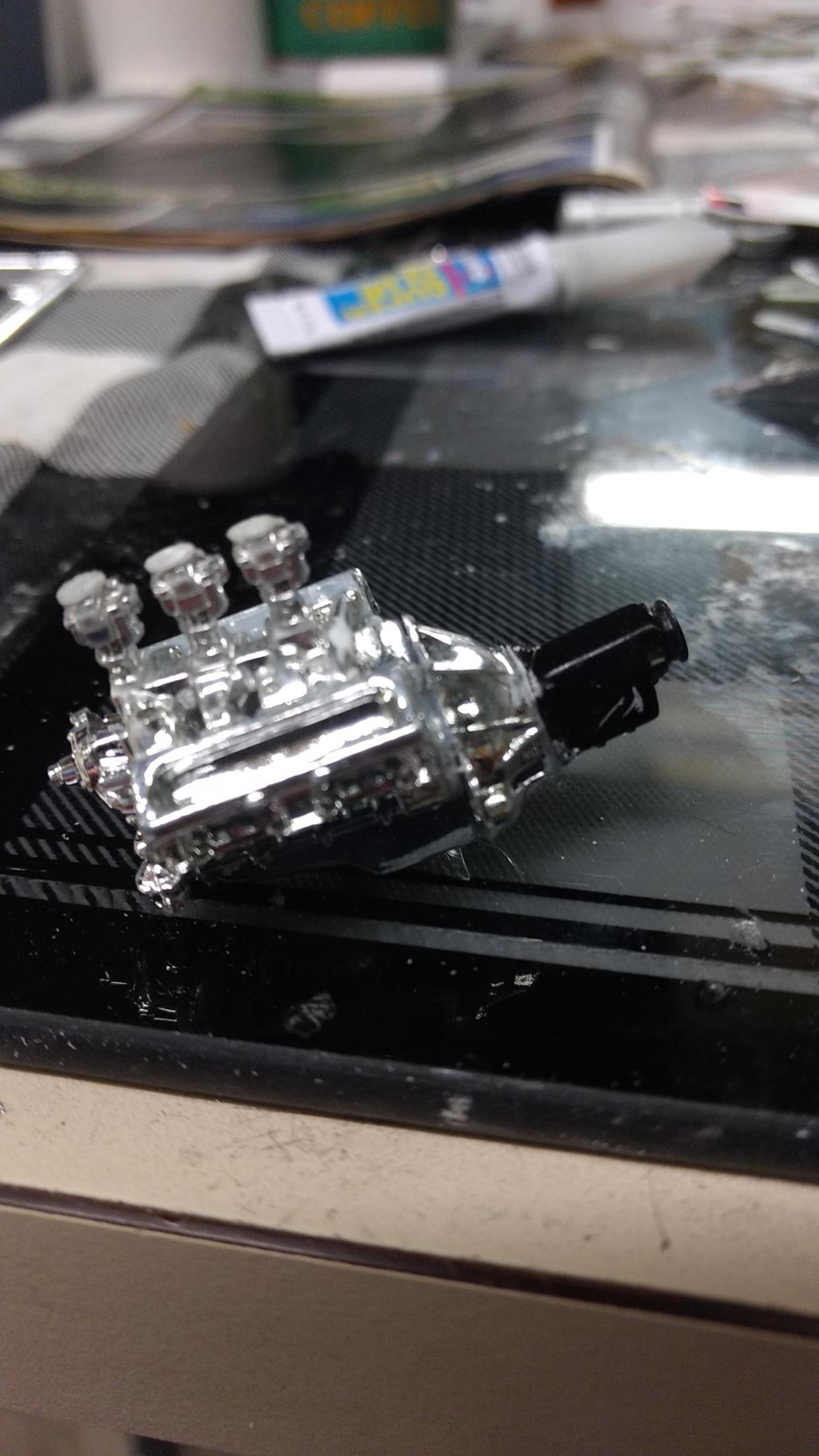

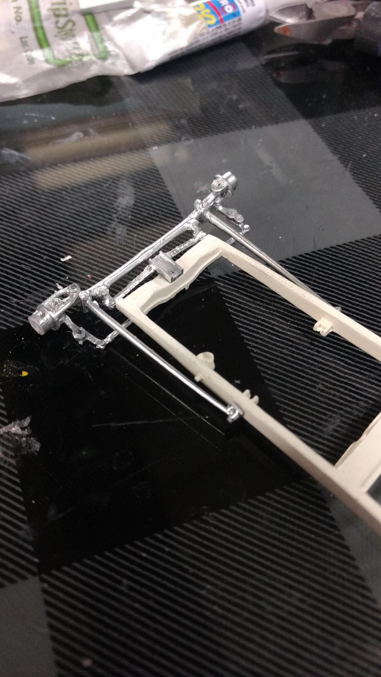

Modlbldr Posted April 24, 2020 Author Posted April 24, 2020 I'm having a bear of a time coming up with an engine for this thing that is short enough to fit between the front frame cross member and the driveshaft. I want something that, I feel, is not the norm. I found the Pontiac 421 from the Parts Pack and I am going to splice on a tranny tailpiece from the parts box. I have to admit that the engines are the area that I have no experience in. I usually focus on the bodywork on builds and not on the running gear. I am going to post some photos of what I have in mind and I am looking for any advice as to whether it would work in 1:1. Would it be reasonable and feasible to remove the crossmember and replace it with something thinner? If I could do that, I could go with a couple other engine options. Later-

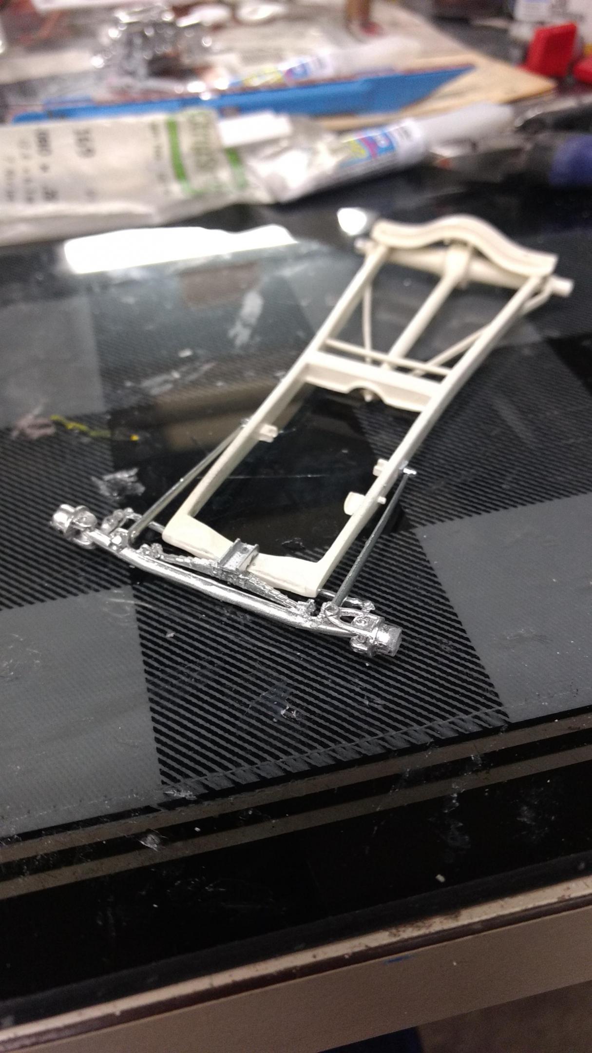

Modlbldr Posted April 24, 2020 Author Posted April 24, 2020 So, here is the engine I am planning on using- Parts Pack Pontiac. I need a tranny tailpiece though. I am going to make my cut at the Xacto blade and attach the tail. That should make it short enough to fit. Second pic is the cross member. I am looking to remove a portion of it or all of it. If I remove all of it, my plan is to make a new one farther back, say, under the tranny. I'm sure in 1:1 it would need one as the spreader bar at the front would not be enough. Any thoughts? Photos of similar set ups or the right way to do it? Later-
Modlbldr Posted April 24, 2020 Author Posted April 24, 2020 Like this... Again, any comments or suggestions? Later-
Sam I Am Posted April 24, 2020 Posted April 24, 2020 Engine and tranny look good. Instead of messing with the front crossmember, maybe recess the firewall.
Modlbldr Posted April 24, 2020 Author Posted April 24, 2020 Not a bad idea Sam but I may not have to if I remove just the step down portion of the cross member. Should give enough room for everything. Later-

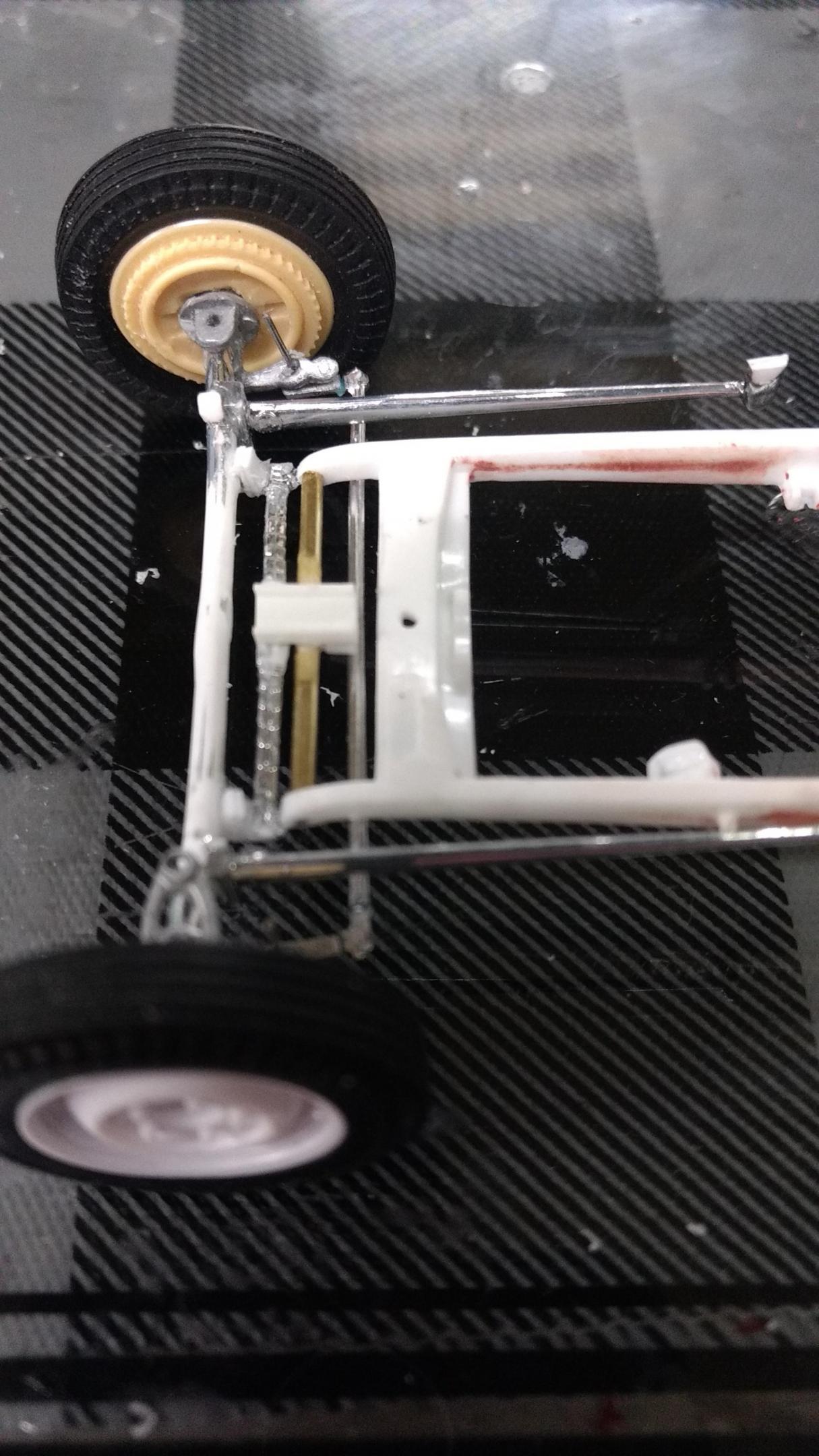

Plowboy Posted April 25, 2020 Posted April 25, 2020 Don't know how I missed this one! I would cut the cross member loose, get rid of the brass rod, slide the cross member forward and then glue the spring mount to the cross member. If possible, trim away the recessed area on the rear of the cross member for extra clearance. I would also bob the frame horns off so the spring could come back a little.
Modlbldr Posted April 25, 2020 Author Posted April 25, 2020 14 hours ago, Plowboy said: Don't know how I missed this one! I would cut the cross member loose, get rid of the brass rod, slide the cross member forward and then glue the spring mount to the cross member. If possible, trim away the recessed area on the rear of the cross member for extra clearance. I would also bob the frame horns off so the spring could come back a little. Funny that you mention this. That was actually my first thought when I started the front suspension. I thought having the spring mount attached to the brass spreader bar would be a little dicey in 1:1 but went with it. I think I might go back to that idea though. Makes more sense to me, structurally speaking. Later-
Plowboy Posted April 26, 2020 Posted April 26, 2020 Something I've done also Tom, is cut the cross member loose, turn it a quarter turn (bottom of the cross member will face forward instead of down) and glue it back to the frame. Then mount the spring inside the recess of the cross member. Hope this makes sense.
espo Posted April 26, 2020 Posted April 26, 2020 I think the suggestions you're getting in the front cross member and spreader bar are what I was looking at also. My thought would be to move the factory cross member forward just enough to mount your existing front spring mount to it. This would do way with the spreader bar and give the appearance of a well built suspension mount. This should also give you the clearance you need for the front dress of the engine. Should the front clearance still be an issue you could remove or notch the rear facing edge of the cross member. The Carbs seem strangely out of proportion on the engine. They appear more like an early Stromberg model that you would find on an early Ford Flathead engine. GM used the Carter 2 Jet style with larger throttle bodies. Might consider one of the later model Pontiac or Chevrolet kits that have the 3x2 setup to get a better idea on size and shapes. Other than all that your build is going great.

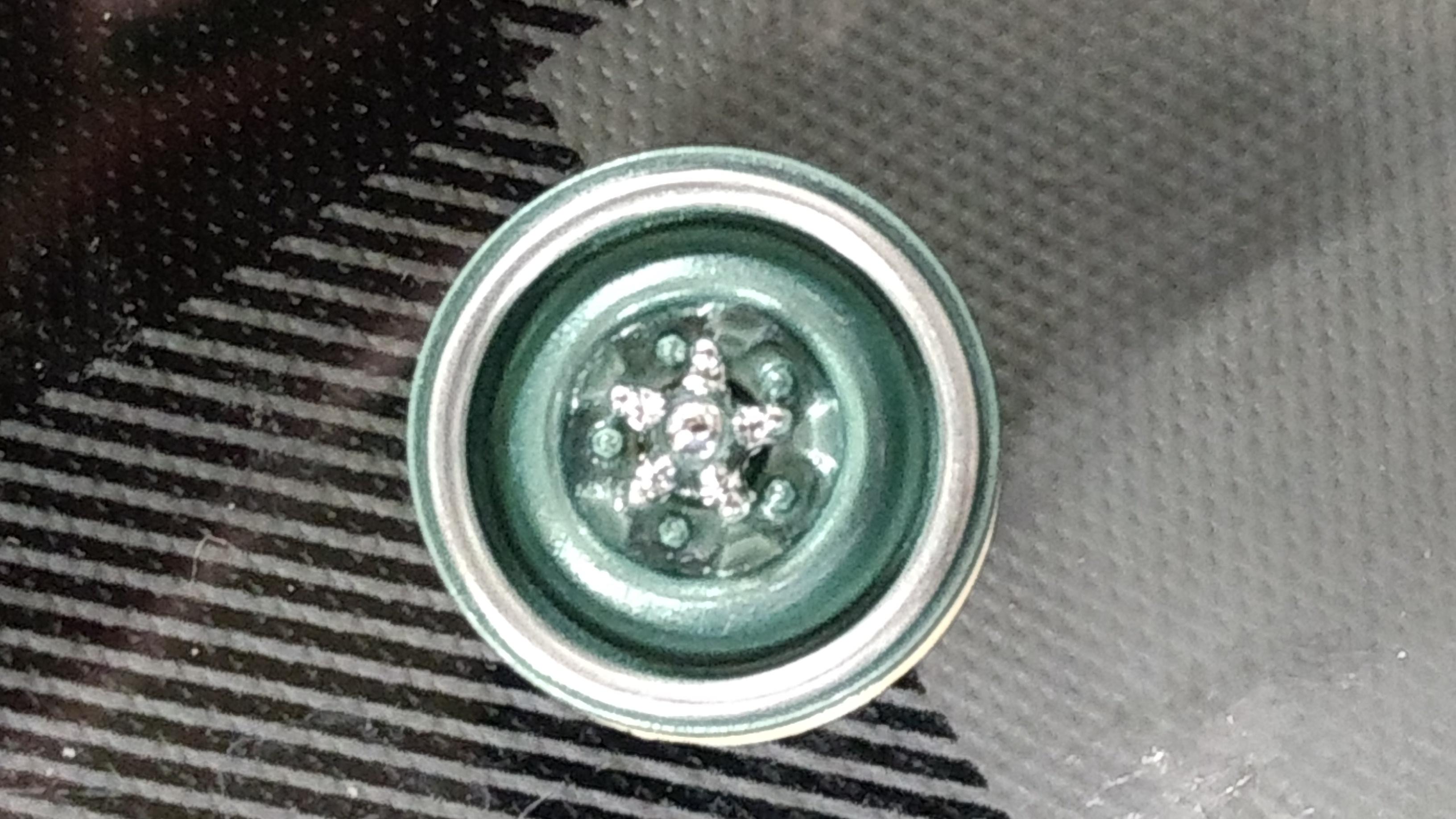

Modlbldr Posted April 27, 2020 Author Posted April 27, 2020 Been working on this today. Made some changes in the front suspension. Trying to figure out a color for the body. The chassis and such will be Wimbledon White but I am hung up on a color for the body and wheels. Here are my options. What do you think? I am leaning towards the second one from the left ( Testors Silver Blue Metallic) or the last one (Testors Lime Gold metal flake). Later-
espo Posted April 27, 2020 Posted April 27, 2020 Good looking color. What are the two end spoons color ?
Modlbldr Posted April 28, 2020 Author Posted April 28, 2020 17 hours ago, espo said: Good looking color. What are the two end spoons color ? These are the paints on the ends. Later-
Modlbldr Posted April 28, 2020 Author Posted April 28, 2020 (edited) I got the front suspension changed out and looking better. Wheels and body getting the first few coats of Silver blue metallic. Later- Edited April 28, 2020 by Modlbldr
