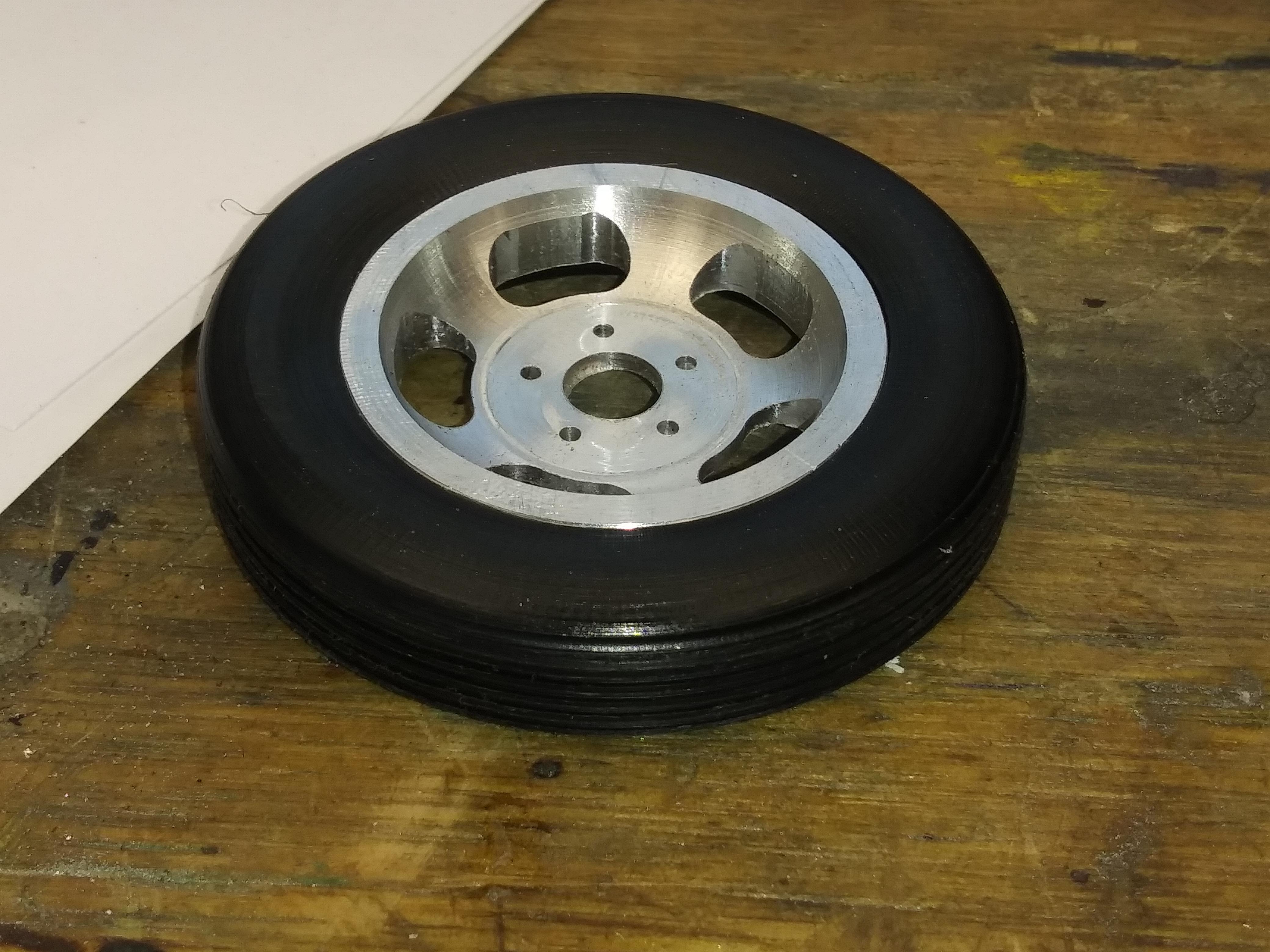

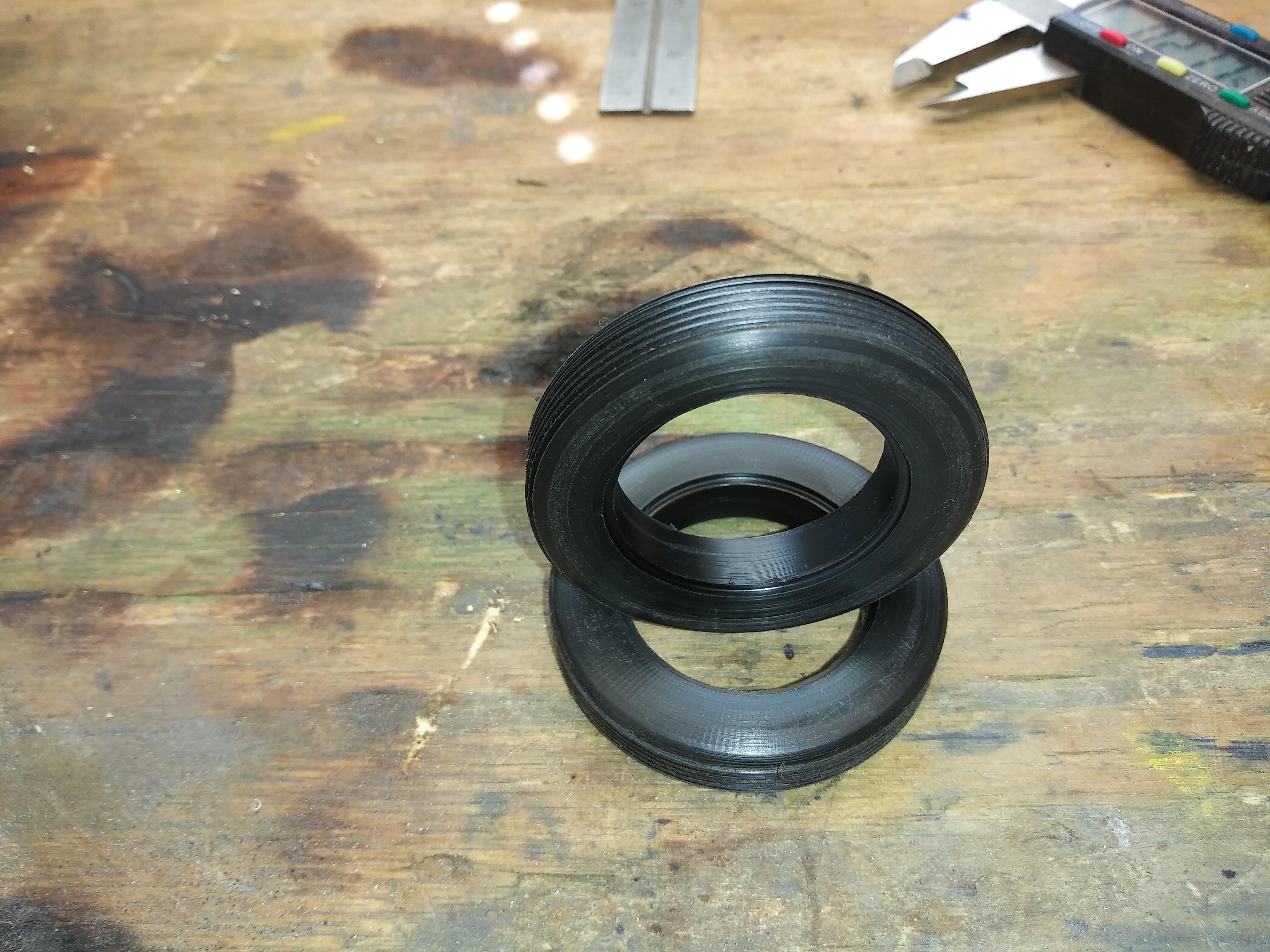

i find delrin is also a great product to test or experiment with. its also great for making your own tires. if you need a size that you cant find, they look pretty good.you can get it pretty resonable on ebay.
Those look great!  Beautiful work!
Link to post
Delrin does look good when used to model tires, but it is a non-stick type of plastic, so any paint or lettering will not stick to it.
While the general shape of the tires looks really good, I wonder if sanding them with some 400 or 600 grit wet/dry sandpaper would make them look more "ruber-like" (less shiny).  It woudl likely also get rid of the machining marks.
