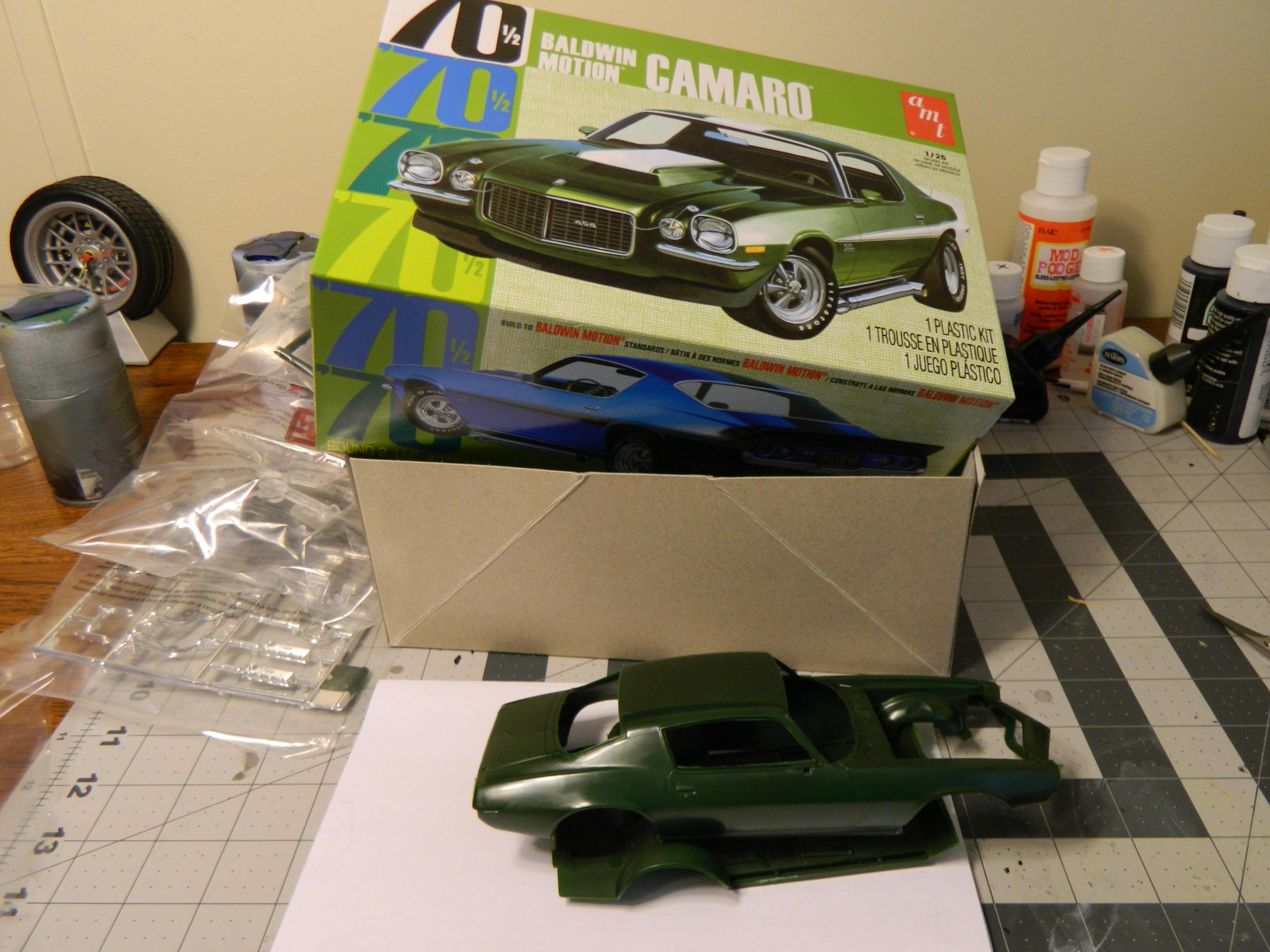

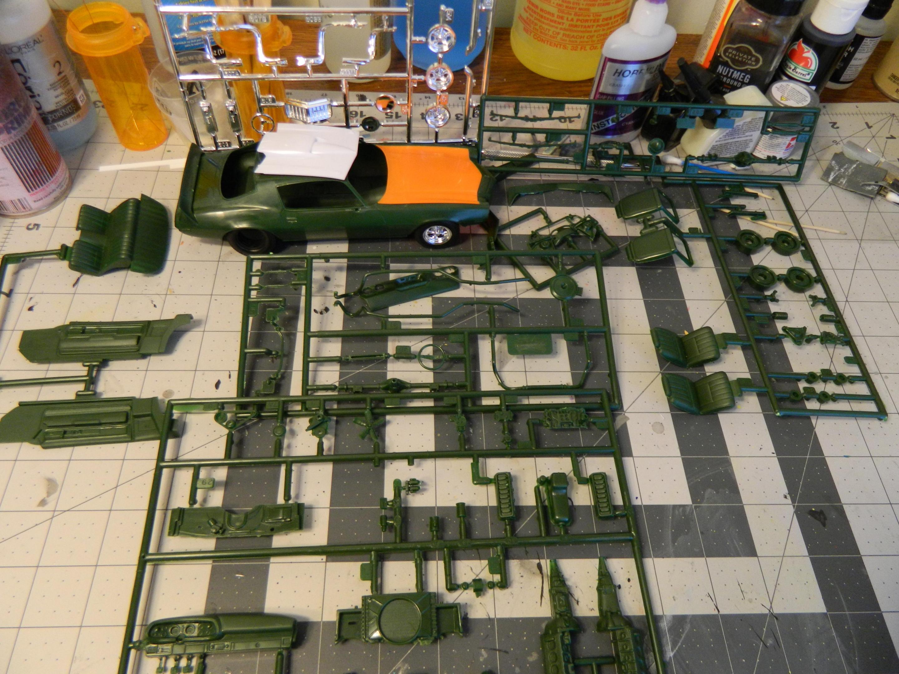

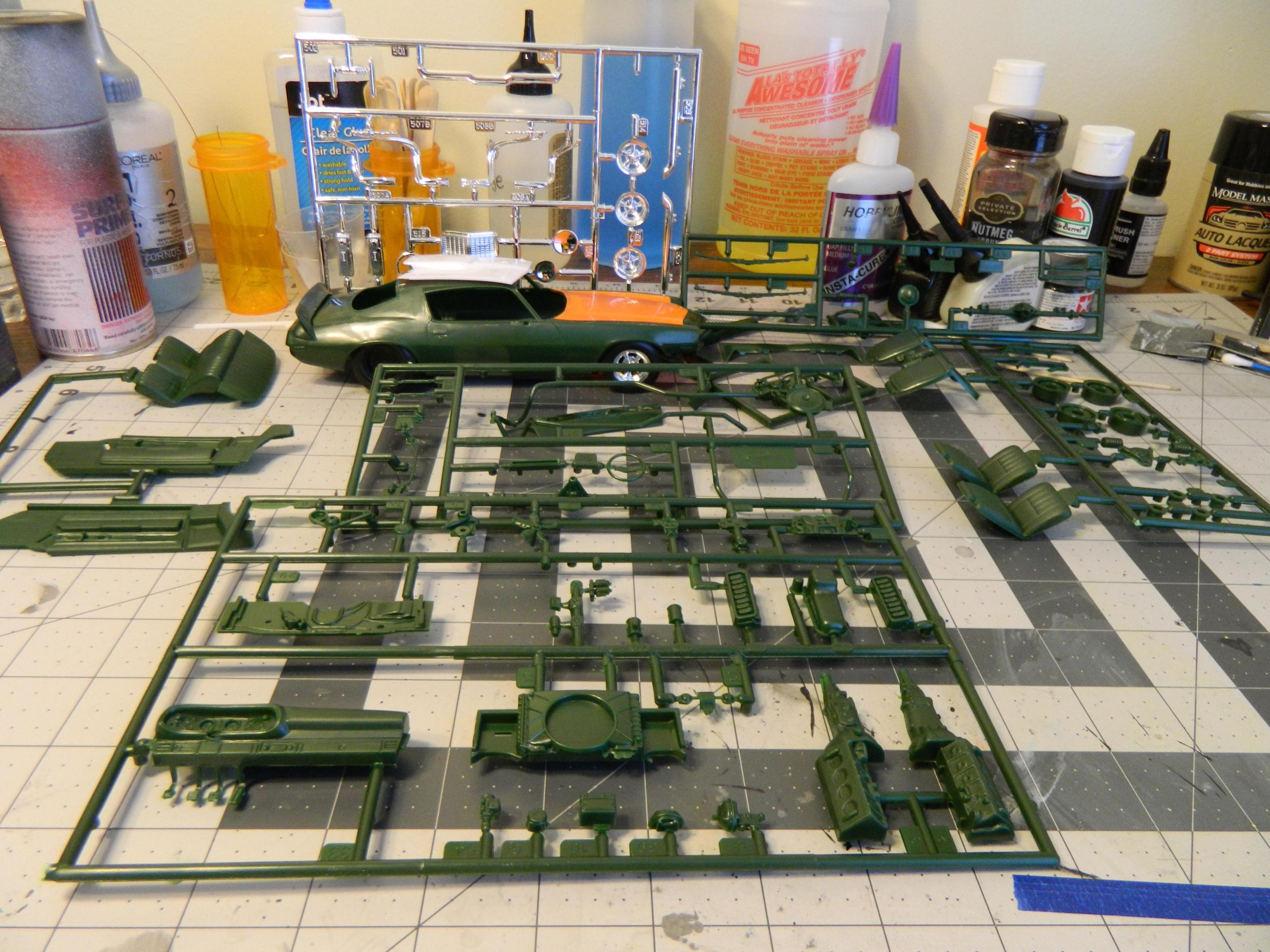

Dragonhawk1066 Posted May 15, 2020 Share Posted May 15, 2020 Getting started on my next project, the Yellow Camaro from Gumball Rally. I haven't really done a continuous in-progress topic yet, so hopefully I can remember to take pics and update my progress in a reasonable fashion. I also hope I can put up some decent work and not embarrass myself with shoddy work and results?. I thought about waiting a while on this build until the new full bumper Camaro kit from AMT came out for better turn signal accuracy, but I'm hearing it's going to be delayed until at least September and I really don't want to wait til then at minimum, so it'll be a test of my skills for sure. First thing I have to do is fix the shoddy mold on the passenger front fender. Thanks for looking! Quote Link to comment Share on other sites More sharing options...
beeRS Posted May 15, 2020 Share Posted May 15, 2020 I always liked this AMT kit for the accuracy of the body. Looking forward to seeing this come together. Hopefully the green plastic won't present any problems when painting yellow. Quote Link to comment Share on other sites More sharing options...

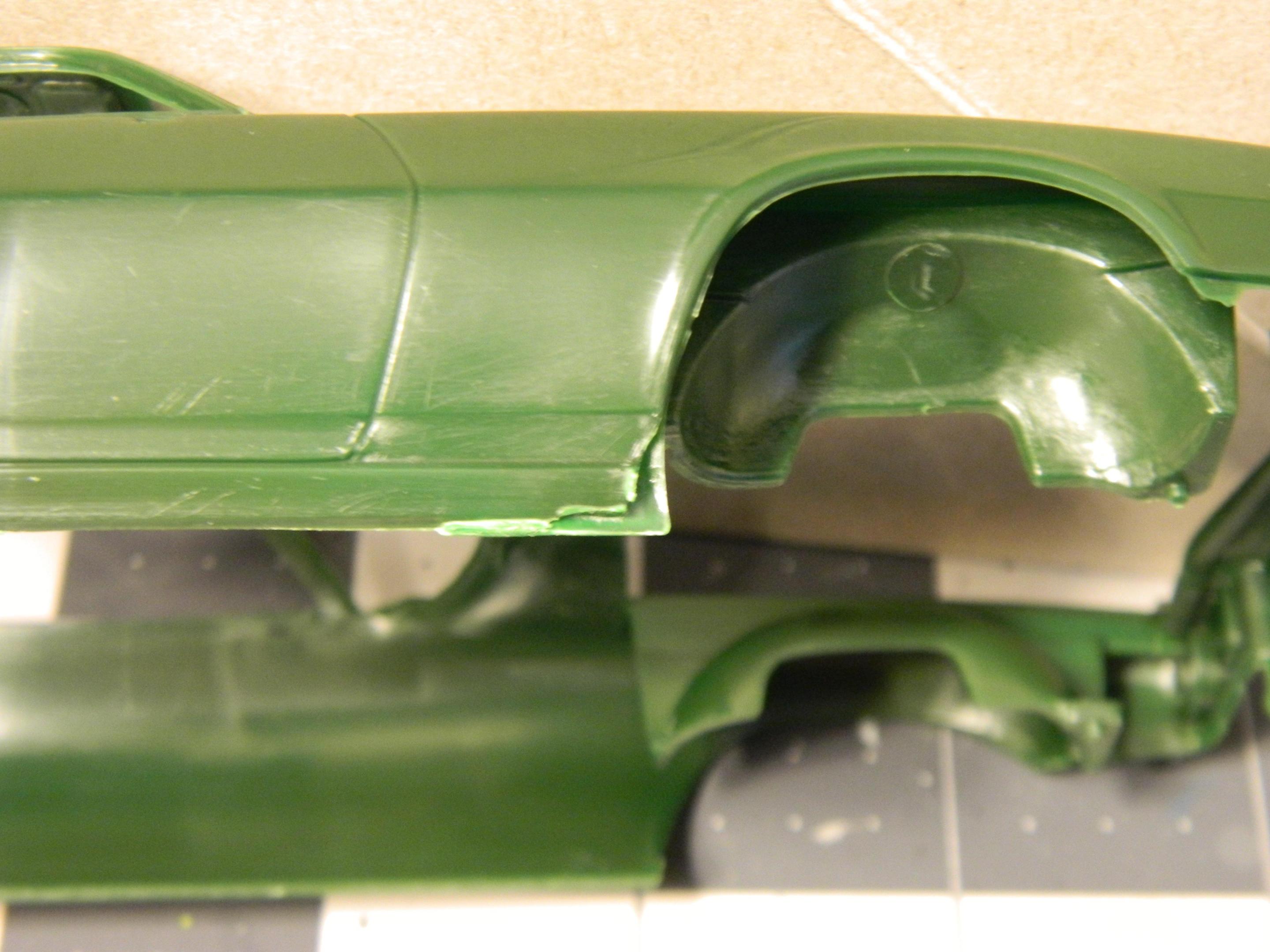

Dragonhawk1066 Posted May 16, 2020 Author Share Posted May 16, 2020 18 hours ago, beeRS said: I always liked this AMT kit for the accuracy of the body. Looking forward to seeing this come together. Hopefully the green plastic won't present any problems when painting yellow. This has always been my favorite Camaro body style, and despite the mold issue on the body and excessive flash on pretty much every part, the kit is very well detailed and should build up pretty well. I might look into picking up some sealer to spray on before priming. Quote Link to comment Share on other sites More sharing options...

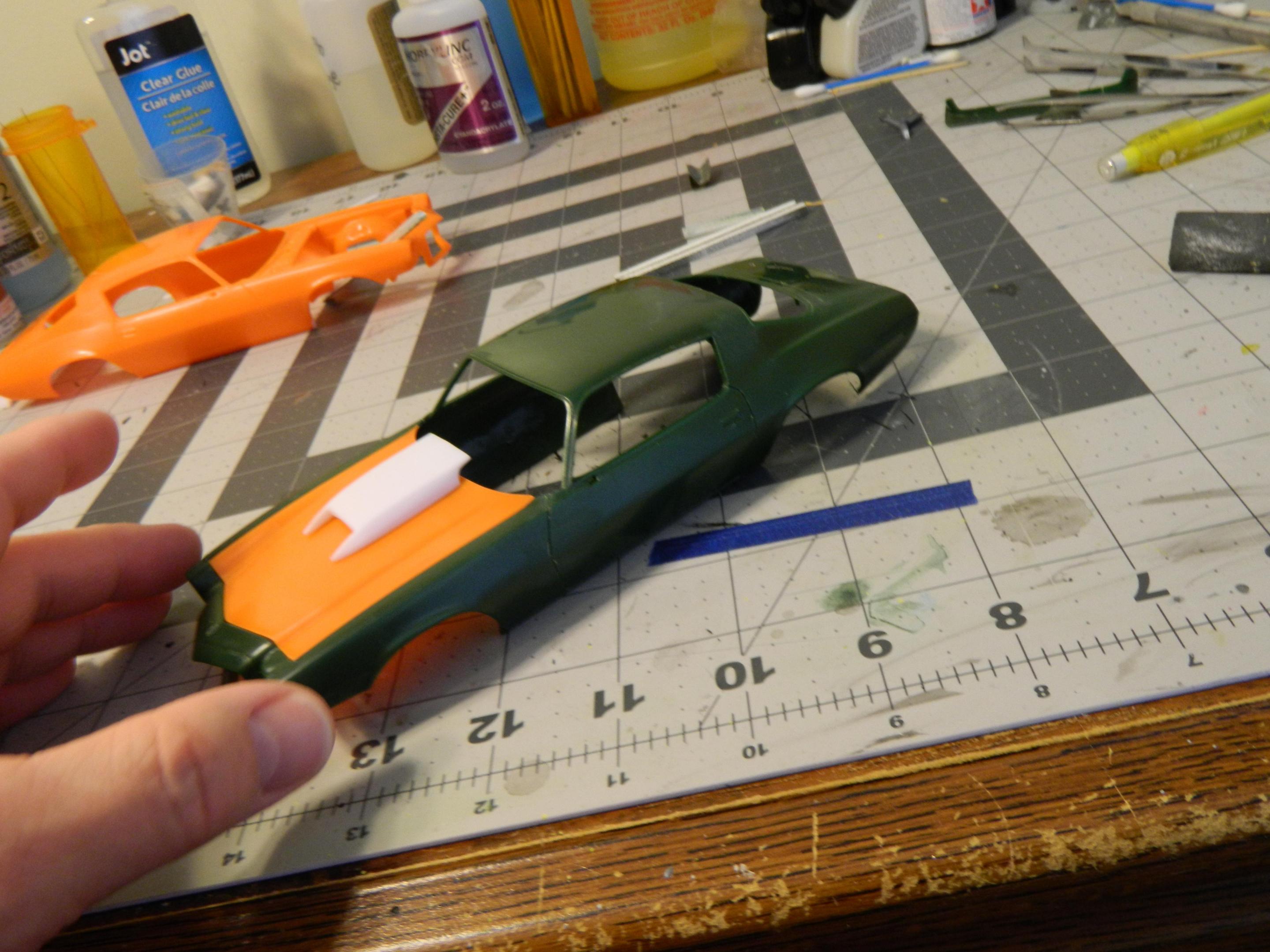

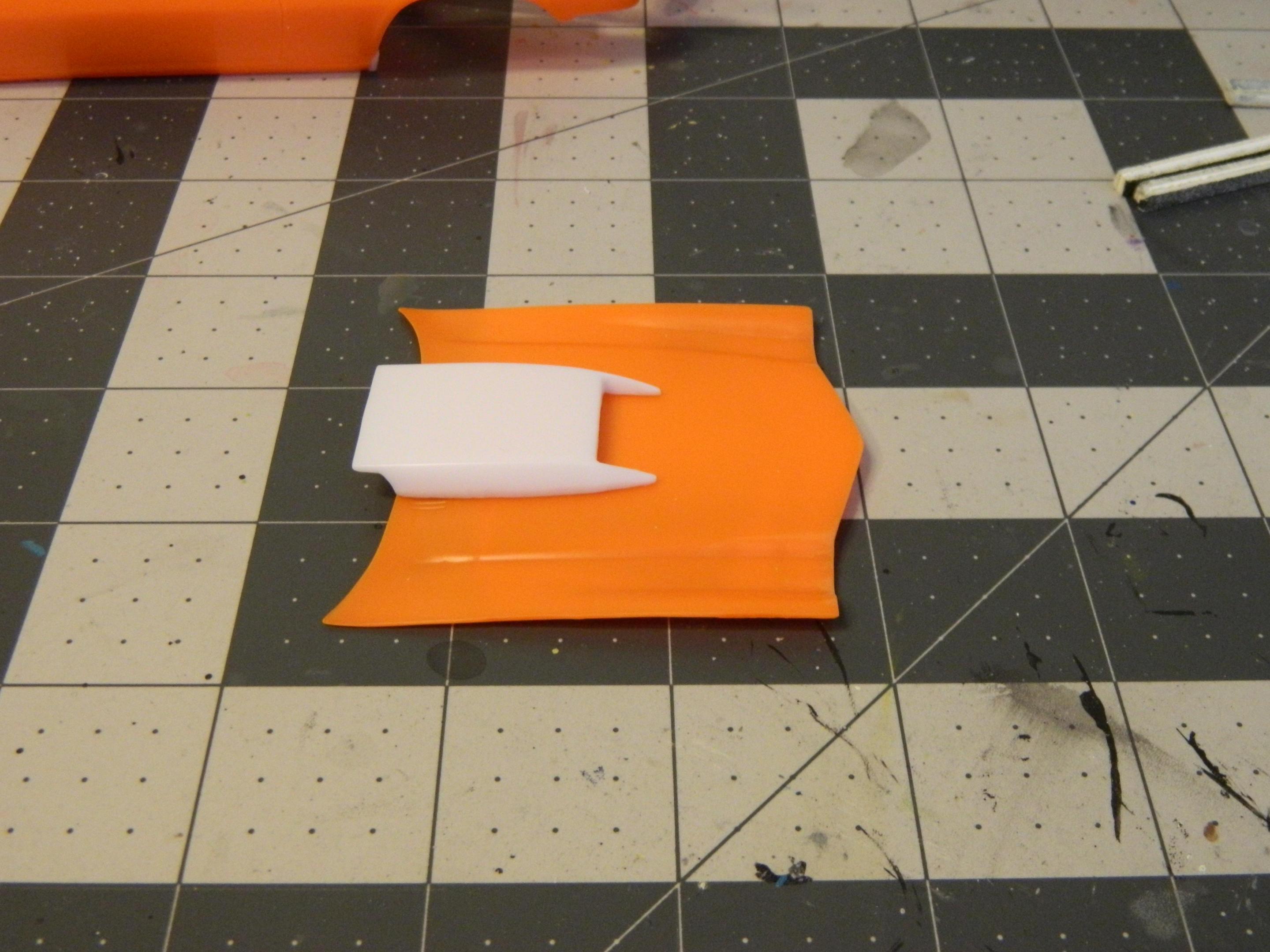

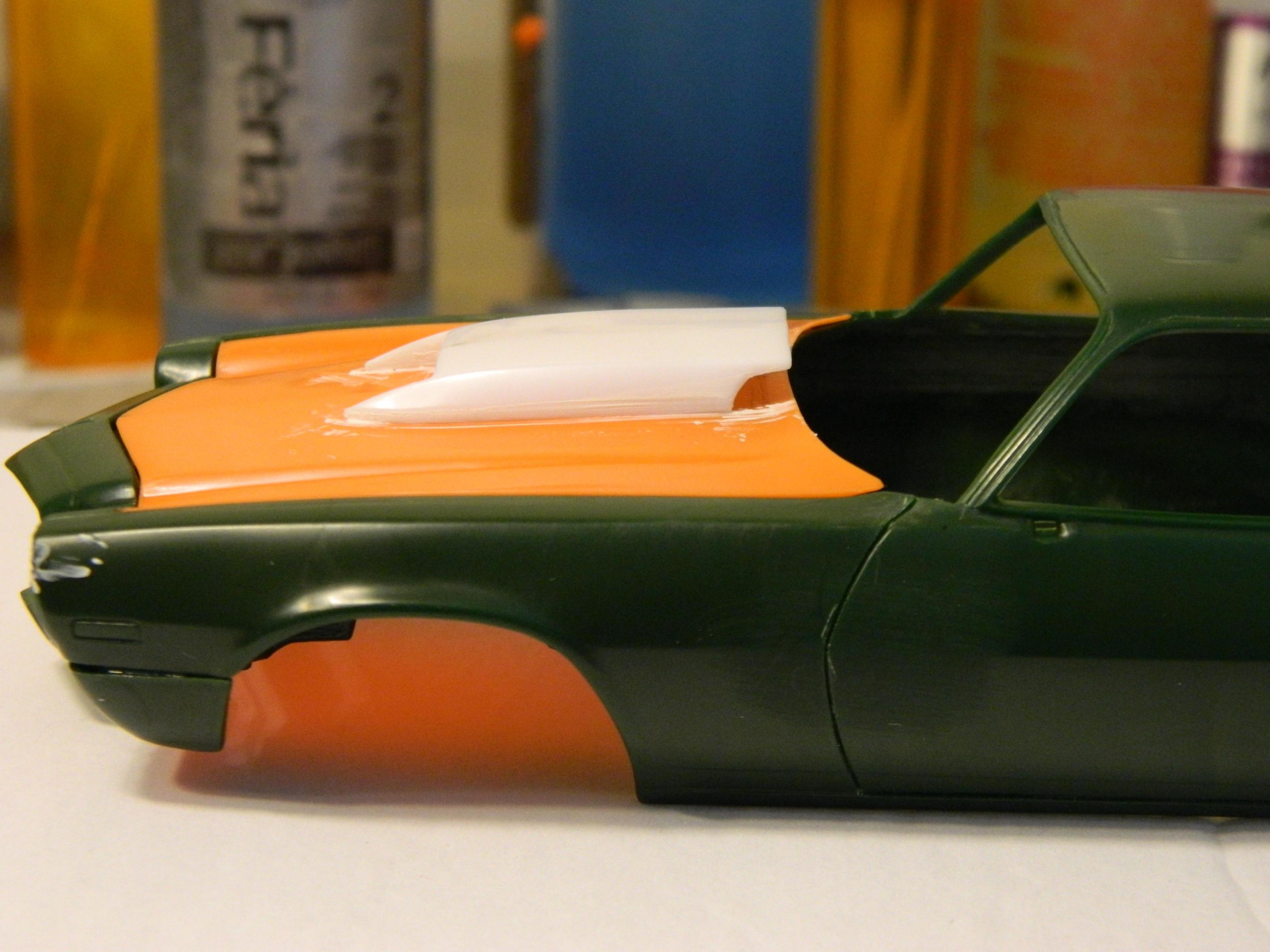

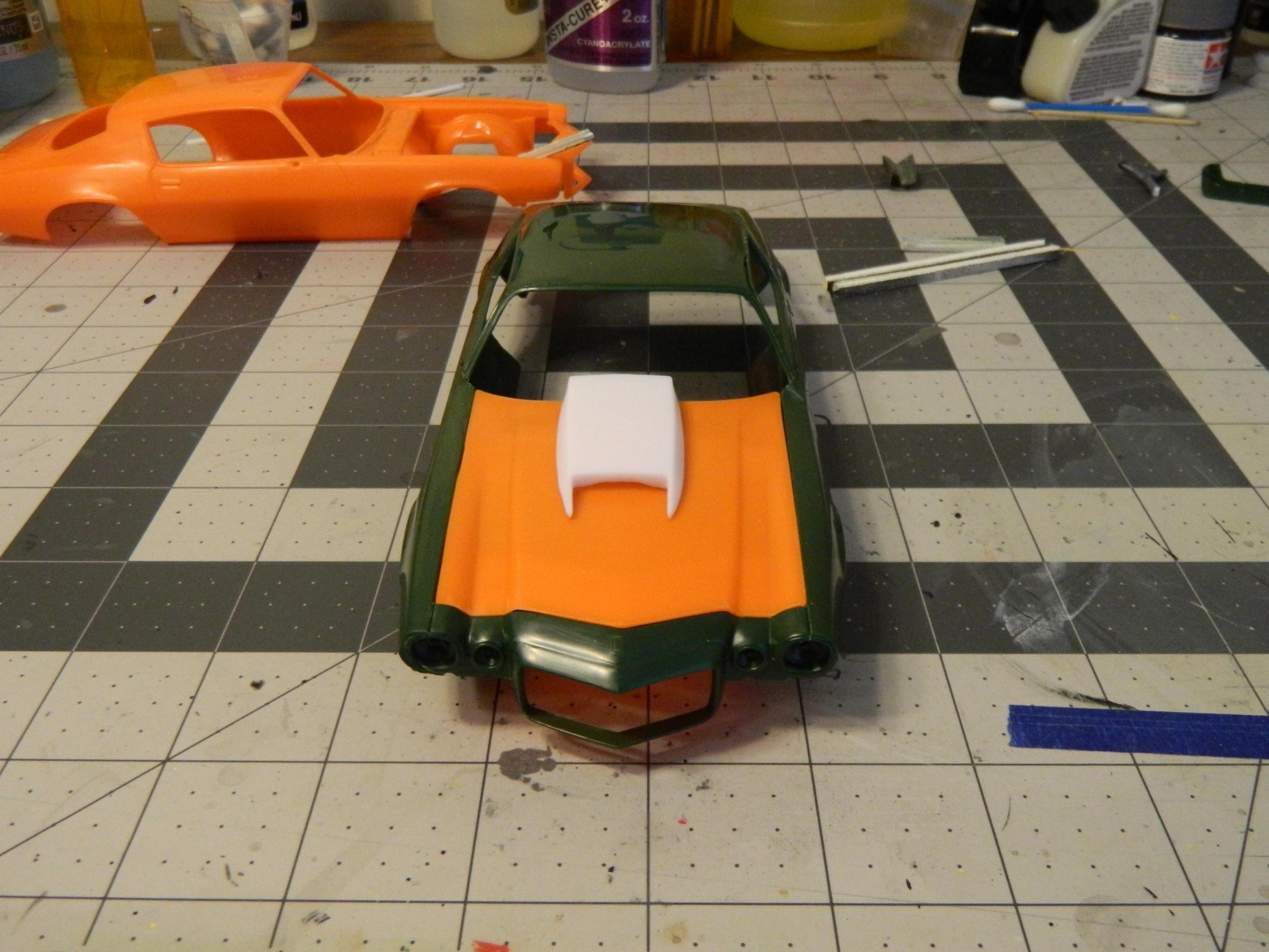

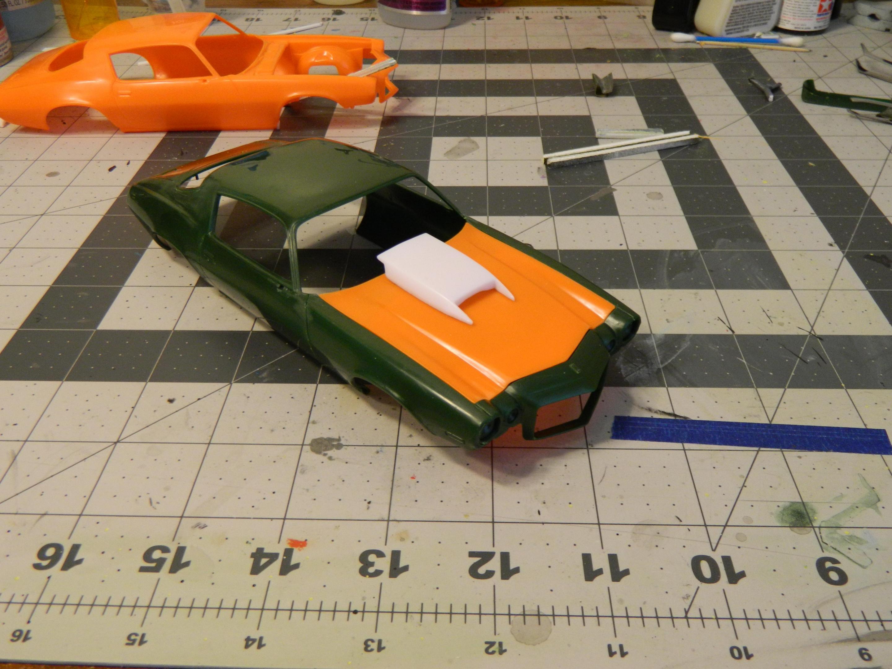

Dragonhawk1066 Posted May 16, 2020 Author Share Posted May 16, 2020 Got the scoop cut out of the Revell '67 Nickey Camaro hood. A little more filing and sanding and I'll be ready to attach it to the hood. Quote Link to comment Share on other sites More sharing options...

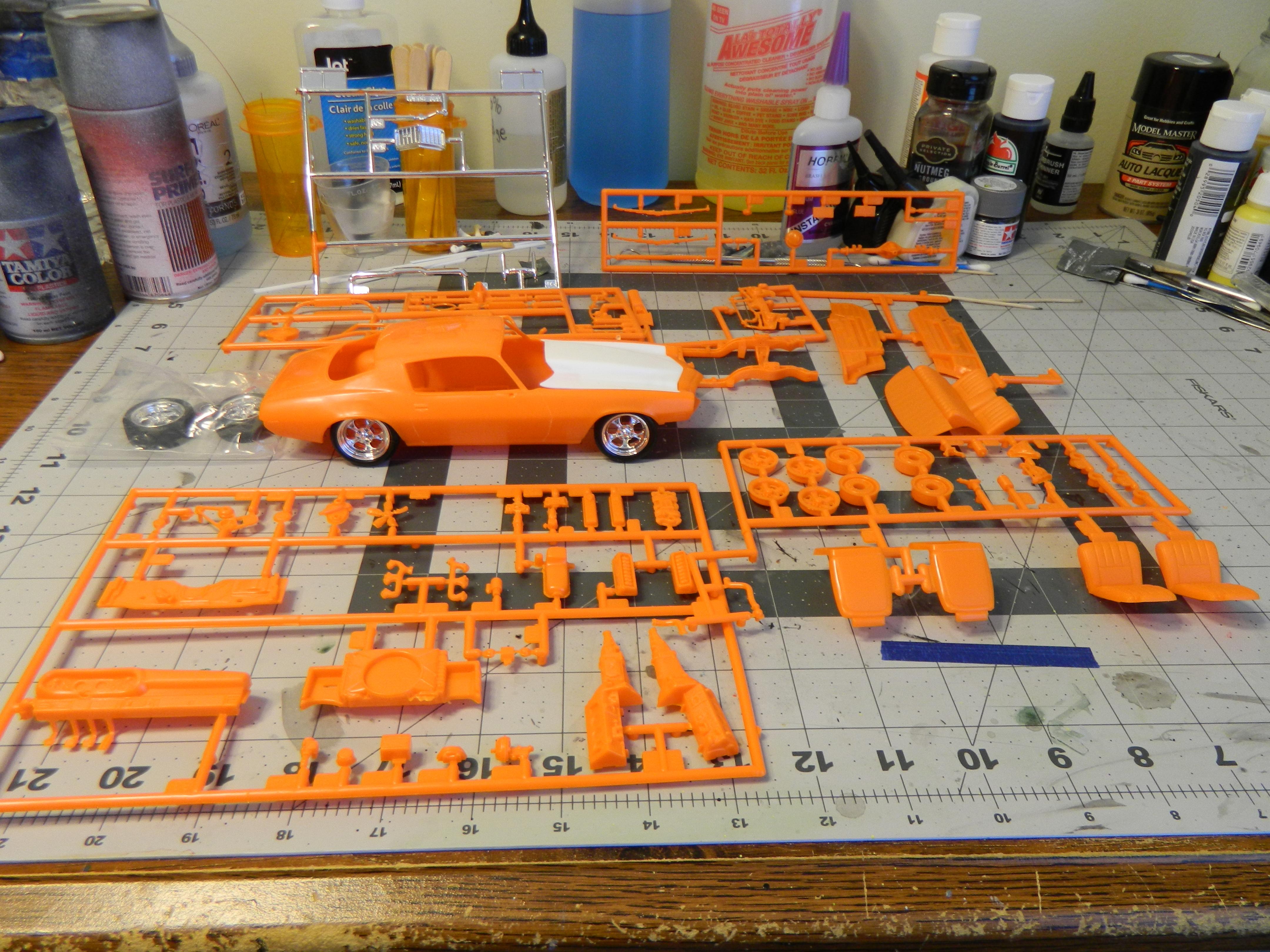

espo Posted May 17, 2020 Share Posted May 17, 2020 I like the scoop, looks very close to the windshield. What are your plans for the orange Camaro in the back ground ? Quote Link to comment Share on other sites More sharing options...
Dragonhawk1066 Posted May 17, 2020 Author Share Posted May 17, 2020 13 hours ago, espo said: I like the scoop, looks very close to the windshield. What are your plans for the orange Camaro in the back ground ? Thanks, I have to gauge how it sits on the movie car before I glue it on. The orange one is going to be a Pro-Touring car complete with the LS motor/trans from the Revell SSR kit, and a cowl induction hood from Lex's Scale Modeling. I have color/paint plans for it. but I'm not going to reveal them yet as it might take a while to get it done, lol. I was thinking of doing a thread for that one too, but I'll be lucky to remember to update the one thread alone?. Quote Link to comment Share on other sites More sharing options...
espo Posted May 17, 2020 Share Posted May 17, 2020 Well when you get to it please post your build. I personally like the bright Orange color, but not the whole kit in Orange plastic. I would think to change color or do something with the interior your going to need a lot of primer there. Quote Link to comment Share on other sites More sharing options...
Dragonhawk1066 Posted May 17, 2020 Author Share Posted May 17, 2020 3 hours ago, espo said: Well when you get to it please post your build. I personally like the bright Orange color, but not the whole kit in Orange plastic. I would think to change color or do something with the interior your going to need a lot of primer there. I'll probably post a few progress pics if I'm happy with how things are going. At the moment, the plan is for some shade of blue for the body and probably a black interior, but plans may change if I can't prevent the orange from bleeding through. I will probably end up buying a can of duplicolor primer/sealer for both of these kits as I understand that will prevent any bleed through. Quote Link to comment Share on other sites More sharing options...
espo Posted May 18, 2020 Share Posted May 18, 2020 13 hours ago, Dragonhawk1066 said: I'll probably post a few progress pics if I'm happy with how things are going. At the moment, the plan is for some shade of blue for the body and probably a black interior, but plans may change if I can't prevent the orange from bleeding through. I will probably end up buying a can of duplicolor primer/sealer for both of these kits as I understand that will prevent any bleed through. I have seen other builders here suggest that they had good luck starting with a Silver base as a sealer. I think you would have better luck with the automotive type primer on the colors you're working with, but that's just my opinion. Quote Link to comment Share on other sites More sharing options...
Dragonhawk1066 Posted May 18, 2020 Author Share Posted May 18, 2020 9 hours ago, espo said: I have seen other builders here suggest that they had good luck starting with a Silver base as a sealer. I think you would have better luck with the automotive type primer on the colors you're working with, but that's just my opinion. I have heard that also, and that is definitely an option. I have gotten quite fond of Stynylrez primers sprayed through my airbrush over the last few months so I'll see how that does initially and then go from there. Quote Link to comment Share on other sites More sharing options...

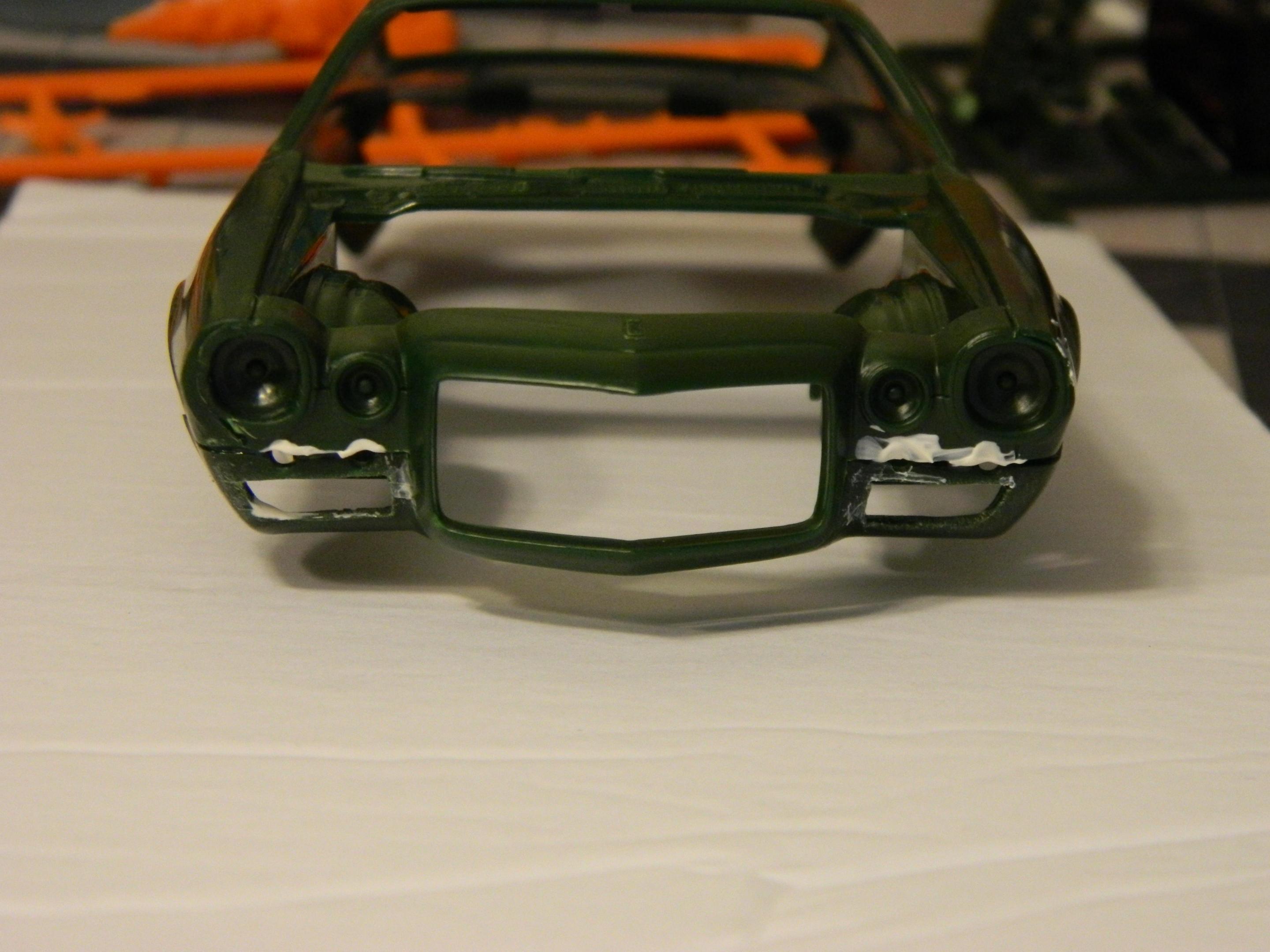

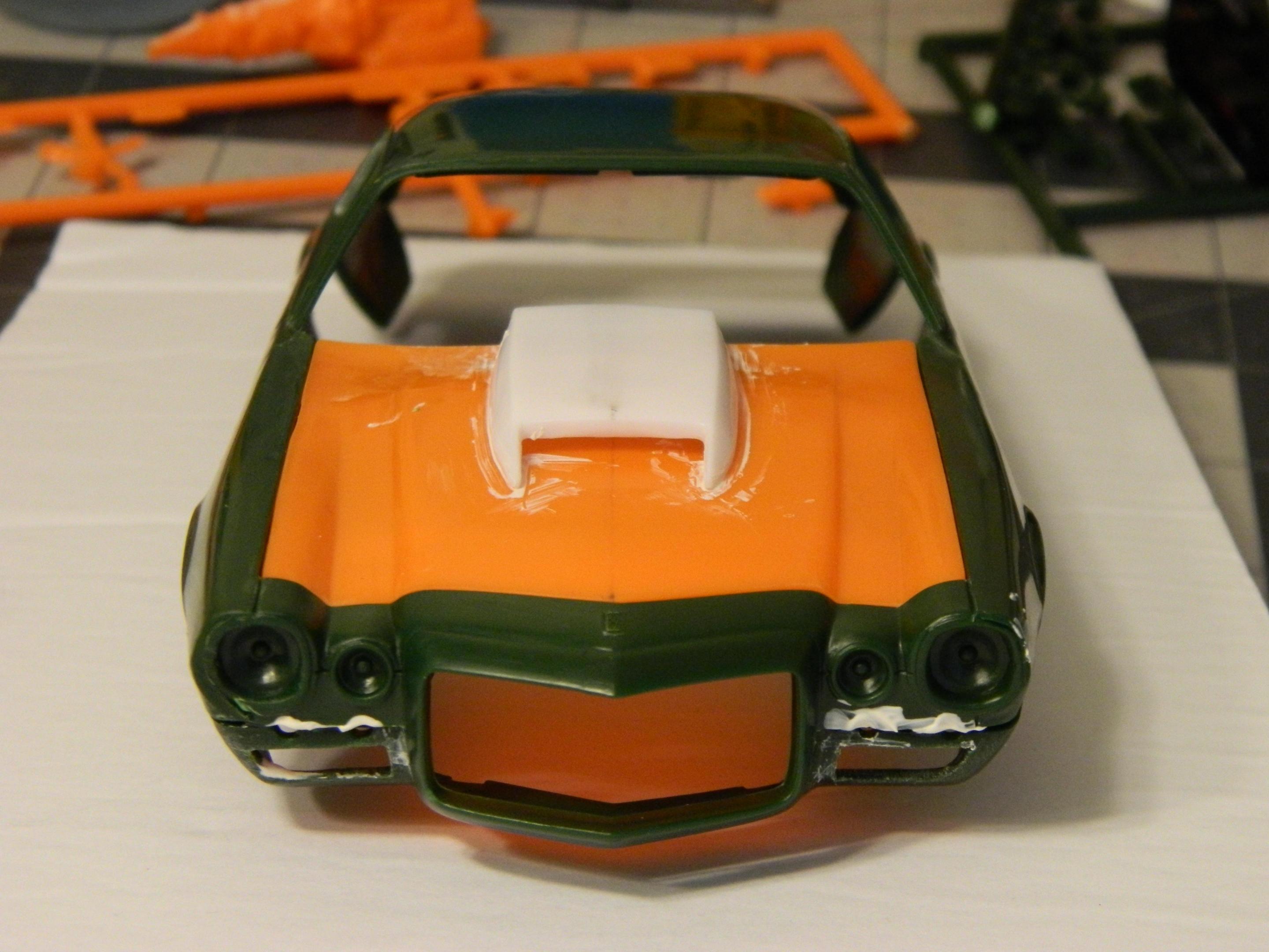

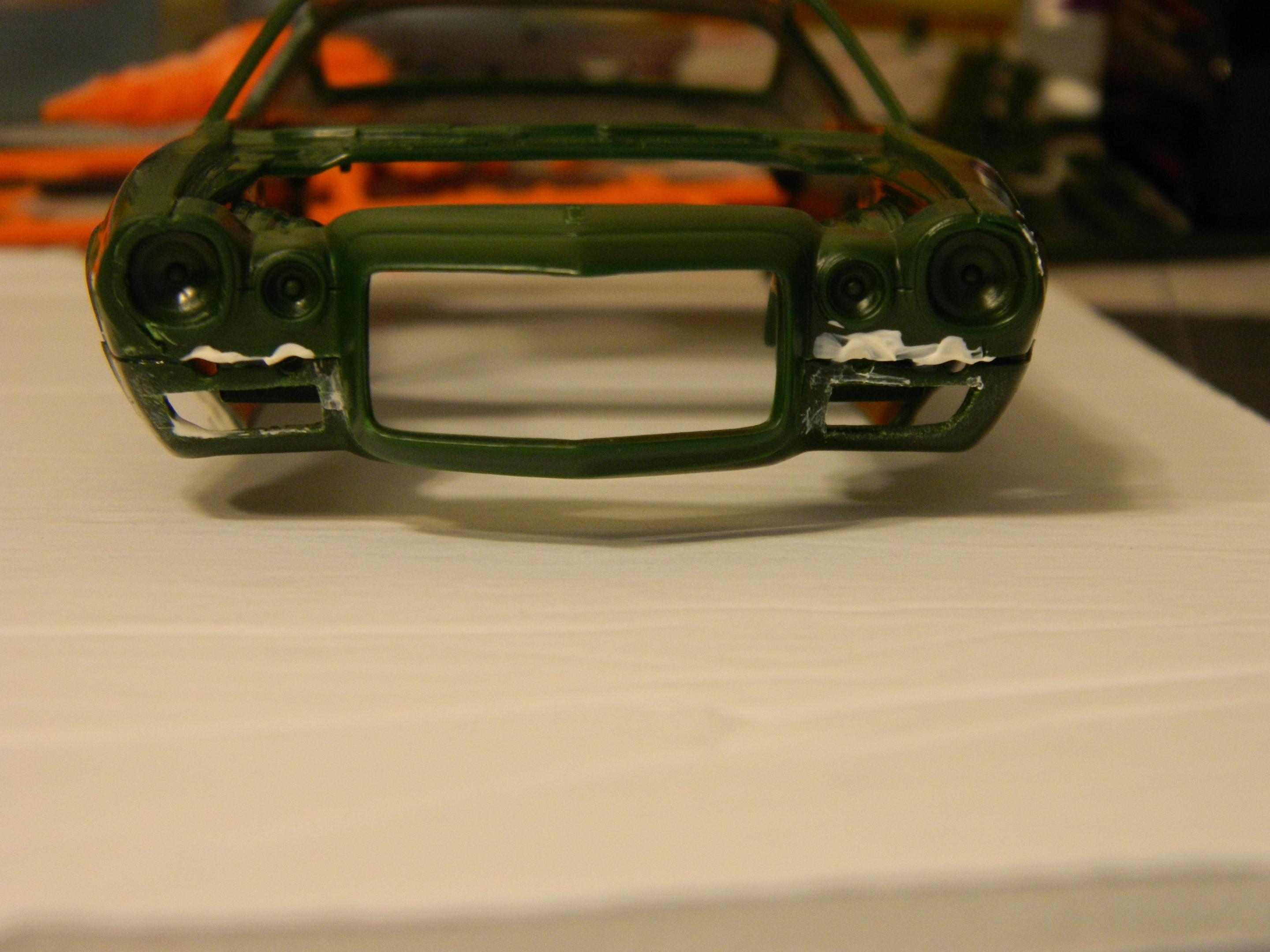

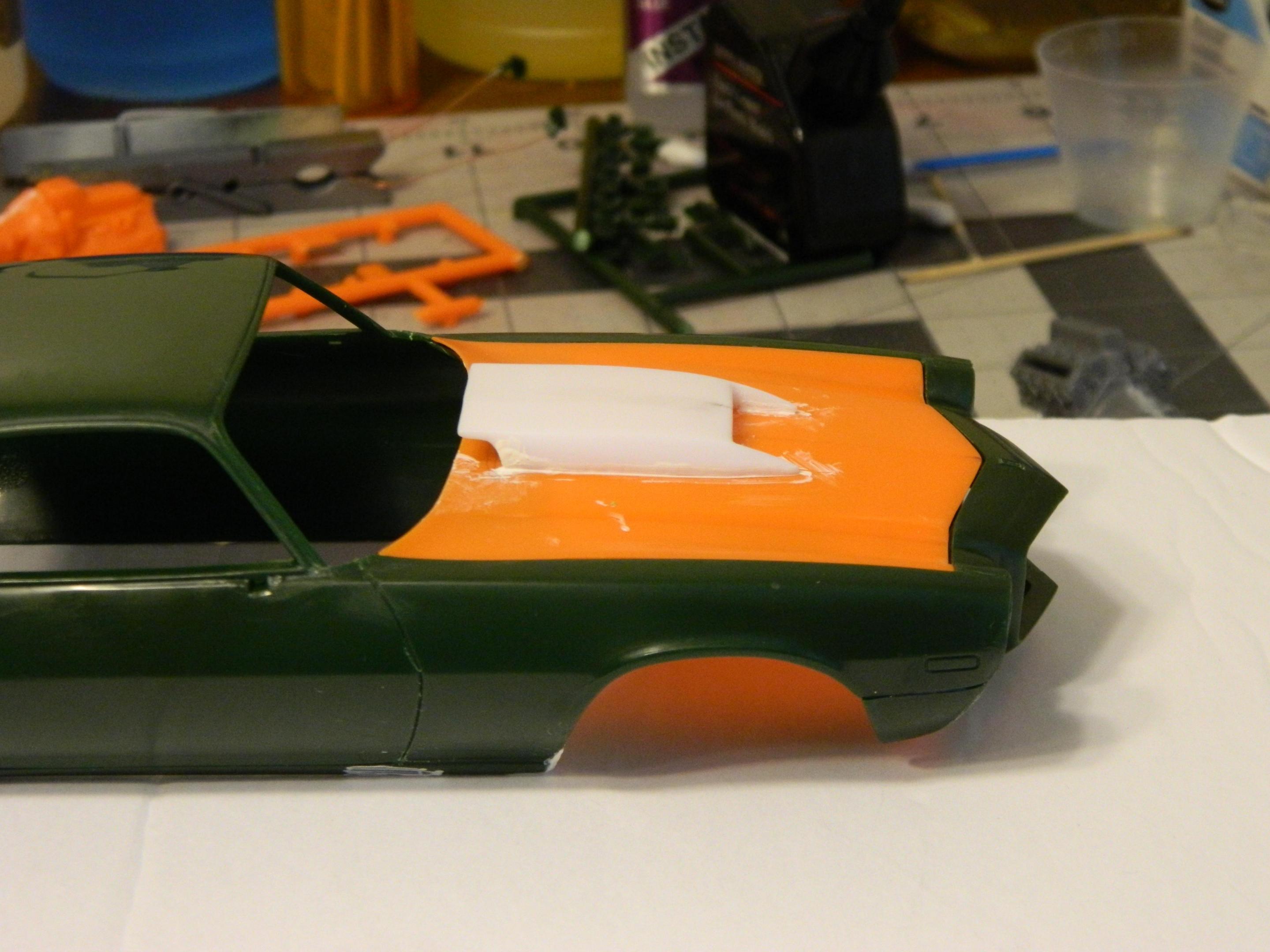

Dragonhawk1066 Posted May 18, 2020 Author Share Posted May 18, 2020 In for a penny, in for a pound. I decided to cut out the turn signal lights on the front valance. I was freaking out every step of the way, but I think they look o.k. Trimmed the scoop a little more and got it placed on the hood. Now I just need to sand the extra putty off and spray some primer on it and see how it looks. Quote Link to comment Share on other sites More sharing options...

espo Posted May 20, 2020 Share Posted May 20, 2020 I like the Hood Scoop. So you're adding the regular parking lamps under the Bumper ? The RS style lamps above the Bumper could become high intensity Driving Lights. Quote Link to comment Share on other sites More sharing options...
Dragonhawk1066 Posted May 20, 2020 Author Share Posted May 20, 2020 Thanks! I really wanted to be as accurate as possible, so not doing the correct parking lights seemed like it would be too obvious. The parking lights next to the headlights should be covered up by the fog/driving lights that every participant car in the movie seemed to have. Quote Link to comment Share on other sites More sharing options...
AmericanMuscleFan Posted May 20, 2020 Share Posted May 20, 2020 Nice project Craig! This is a very beautiful Camaro body style and the hood scoop you planned to make looks very good... very Chevy I would say! Good job on the front valance by the way! Quote Link to comment Share on other sites More sharing options...
afx Posted May 20, 2020 Share Posted May 20, 2020 (edited) 3 hours ago, Dragonhawk1066 said: Thanks! I really wanted to be as accurate as possible, so not doing the correct parking lights seemed like it would be too obvious. The parking lights next to the headlights should be covered up by the fog/driving lights that every participant car in the movie seemed to have. Looks like they the parking lights are not present next the headlights. Doesn't that make it a '72-'73 model? Edited May 20, 2020 by afx Quote Link to comment Share on other sites More sharing options...
Dragonhawk1066 Posted May 20, 2020 Author Share Posted May 20, 2020 5 hours ago, afx said: Looks like they the parking lights are not present next the headlights. Doesn't that make it a '72-'73 model? Not really sure on that one, I don't think anyone really knows exactly what year the movie car was. I did a google search to see which years had which parking lights, and from what I could tell both parking light locations were available for each of the '70-73 years of the Camaro. I'll probably file and fill the upper parking lights, as I don't think the fog lights will cover them without looking dumb, lol. Quote Link to comment Share on other sites More sharing options...
Dragonhawk1066 Posted May 20, 2020 Author Share Posted May 20, 2020 8 hours ago, AmericanMuscleFan said: Nice project Craig! This is a very beautiful Camaro body style and the hood scoop you planned to make looks very good... very Chevy I would say! Good job on the front valance by the way! Thank you Francis, I was sweating bullets the whole time ?, lol. This has always been my favorite Camaro body style. Quote Link to comment Share on other sites More sharing options...

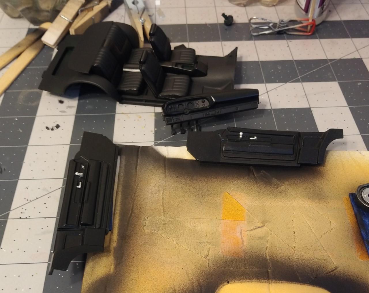

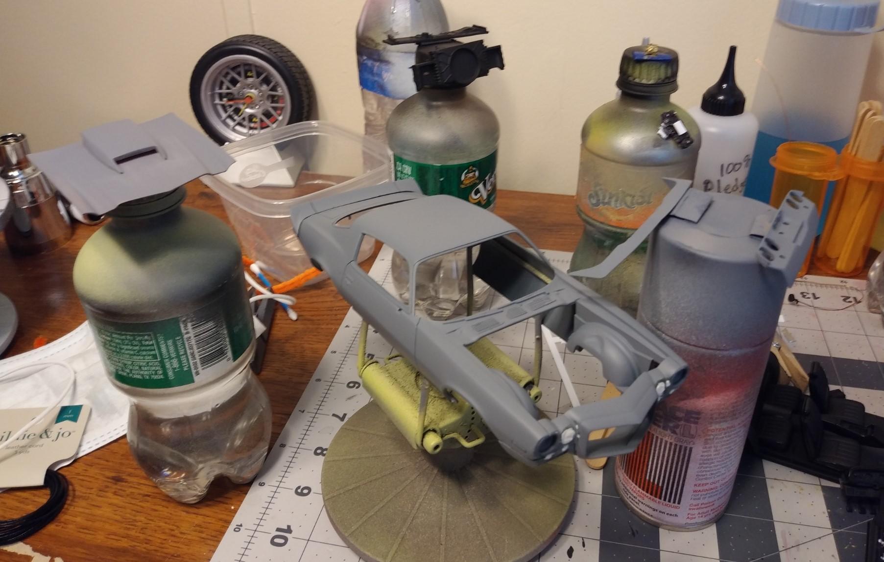

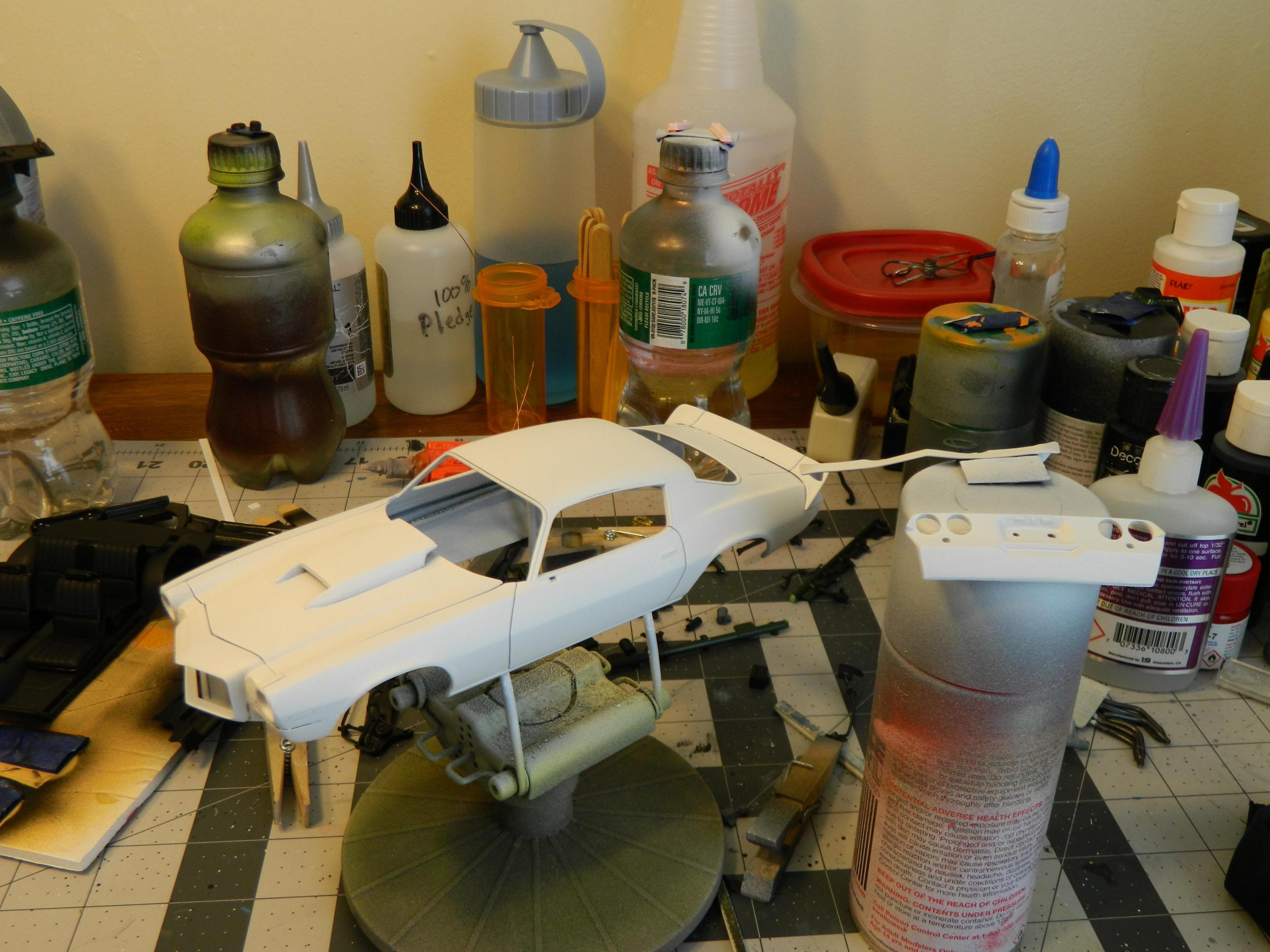

Dragonhawk1066 Posted May 22, 2020 Author Share Posted May 22, 2020 A little more progress. Got some gray primer on it to see any imperfections that need attention before a wet sand. Then a coat or two of white primer followed by the color coats. The interior is coming along nicely. just some dash detail and that should wrap that up. I'll start on the engine and suspension next after some detail and small parts painting. This is the part that usually slows me down, as no matter how organized I think I am, I always forget to paint some parts or miss a detail or two and have to go back to fix it. Quote Link to comment Share on other sites More sharing options...

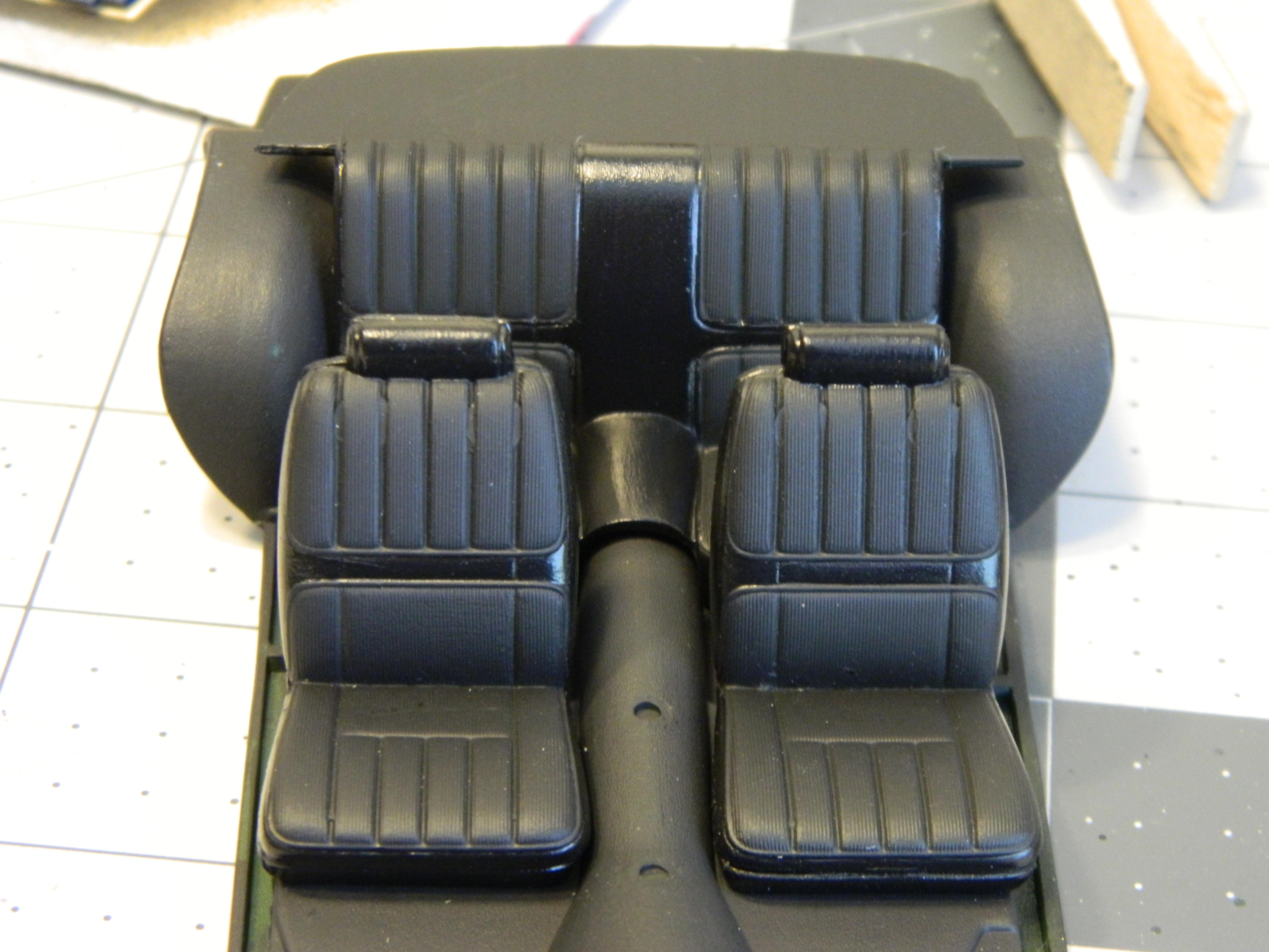

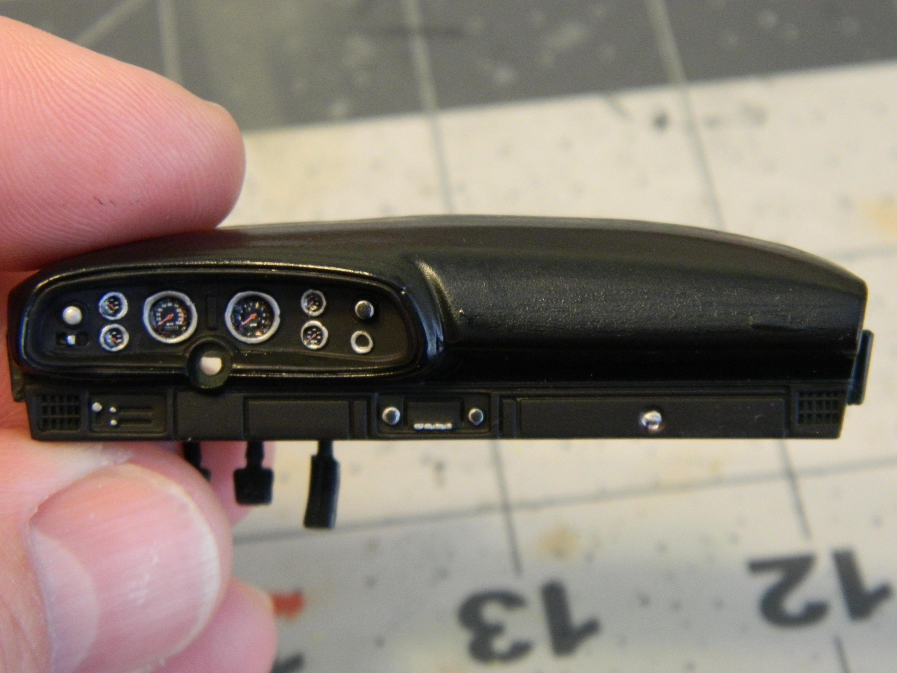

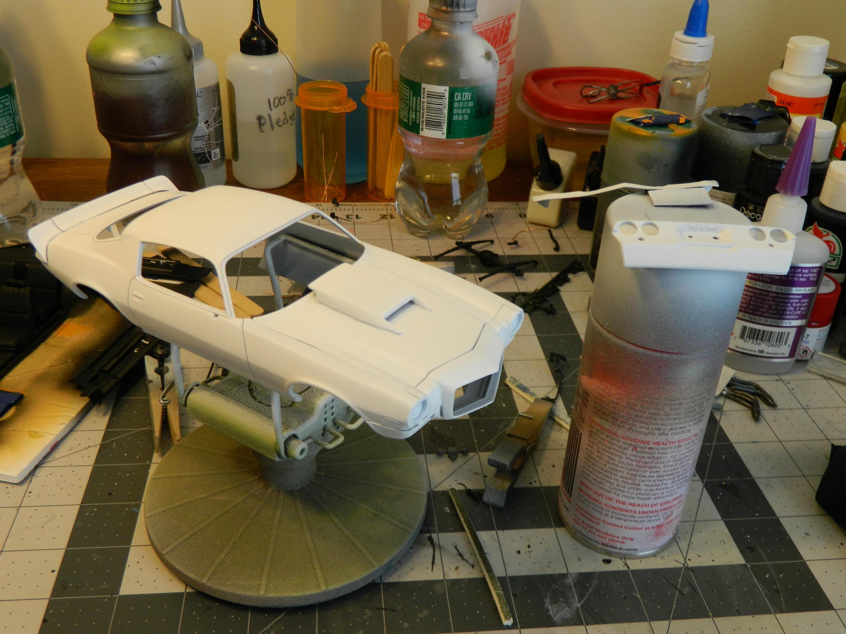

Dragonhawk1066 Posted May 27, 2020 Author Share Posted May 27, 2020 Got it in white primer now, just not sure when I'll get to the color coats. Quick mock of the seats on the interior pan, and a shot of the finished dash. I primed the seats with Stynylrez black primer, and liked the way they looked, kind of like the fabric material of many seats from back then, so I left them and just painted the inserts and sides and used some satin clear for the vinyl look. Quote Link to comment Share on other sites More sharing options...
espo Posted May 27, 2020 Share Posted May 27, 2020 Great looking dash. I like how you detailed the seats. As I recall the duller part was sort of a weaved vinyl and would have less of a sheen than the solid portions. Quote Link to comment Share on other sites More sharing options...

mustang1989 Posted May 29, 2020 Share Posted May 29, 2020 Good job on that dash. Man I just dunno if I could have the stones to put those "KC" lights on the front of this beauty. That's just me though. Looking forward to more..... Quote Link to comment Share on other sites More sharing options...
