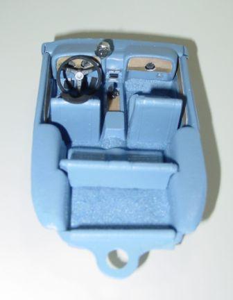

StevenGuthmiller Posted May 21, 2020 Posted May 21, 2020 Just a couple of pictures of the results with the metallic powder that I like to use over paint & Elmer's glue. It also makes a pretty good hood insulation, although this is one of those instances where the more fibrous appearance of flocking might look better. Steve 1

Ace-Garageguy Posted May 21, 2020 Posted May 21, 2020 29 minutes ago, StevenGuthmiller said: Just a couple of pictures of the results with the metallic powder that I like to use over paint & Elmer's glue... I was hoping somebody would post pix. Very convincing, and exactly what I need to get a hung-fire build moving again. Thanks. 1

StevenGuthmiller Posted May 21, 2020 Posted May 21, 2020 3 hours ago, RichCostello said: Steve, I really like that under hood insulation. I'm gonna have to try that! I noticed that HL has some new powders with that salt & pepper look that would work great for that. I use a combination of the gray and black metallic powders that I have for the insulation. By the way, another nice feature of embossing powder is the ability to mix it to achieve certain colors to some degree. You can't mix red and yellow to get orange, but you can mix like colors to some degree to change the hue. Both of the turquoise/green examples above were achieved by mixing blue and green to varying degrees. My set has no turquoise included, so I tried mixing them and was quite happy. Steve
