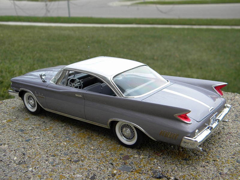

So, I am looking for some tires like the ones in the pics below. I am thinking of ordering some from Modelhaus tires unless I can find some in a kit. My problem is I cannot seem to contact anyone at Modelhaus tires. Does anyone know which would be best or a kit that has ones like the pics?
Later-
Are you looking for a specific brand tire, or just wide whitewalls?  A number of Revell kits include tires with separate whitewall inserts, a number of Round 2 AMT kits include tires with printed wide whitewalls.  The Round 2 tires are available in a separate pack of eight tires.
I'm not looking for a specific brand (although what I have read in some of the photos mentions Coker tires). What I need is a lower profile sidewall than the standard Revell kit tires that I've seen. The tires pictured are a wider than average tire too. So a fat lower profile wide whitewall tire.
If anyone has a photo of the tire they are recommending on a build, that may be helpful too. I want to use them on my 49 Ford.

I don't see anything low profile about the tires pictured! Do you mean thinner whitewalls?
If you want tires that feel "fatter" than the AMT pad-printed whitewalls from Round 2, the Revell tires with white plastic inserts might be what you're looking for. They can be found in the '50 Ford pickup, the '59 Impala, and others.
If you want a tire with thinner whitewalls (but thicker than a pinstripe "pinner" whitewall), the BF Goodrich Silvertowns in the AMT '57 Chrysler 300 might do the trick (not sure what other kits include these tires). They're a little on the large-diameter side though.
