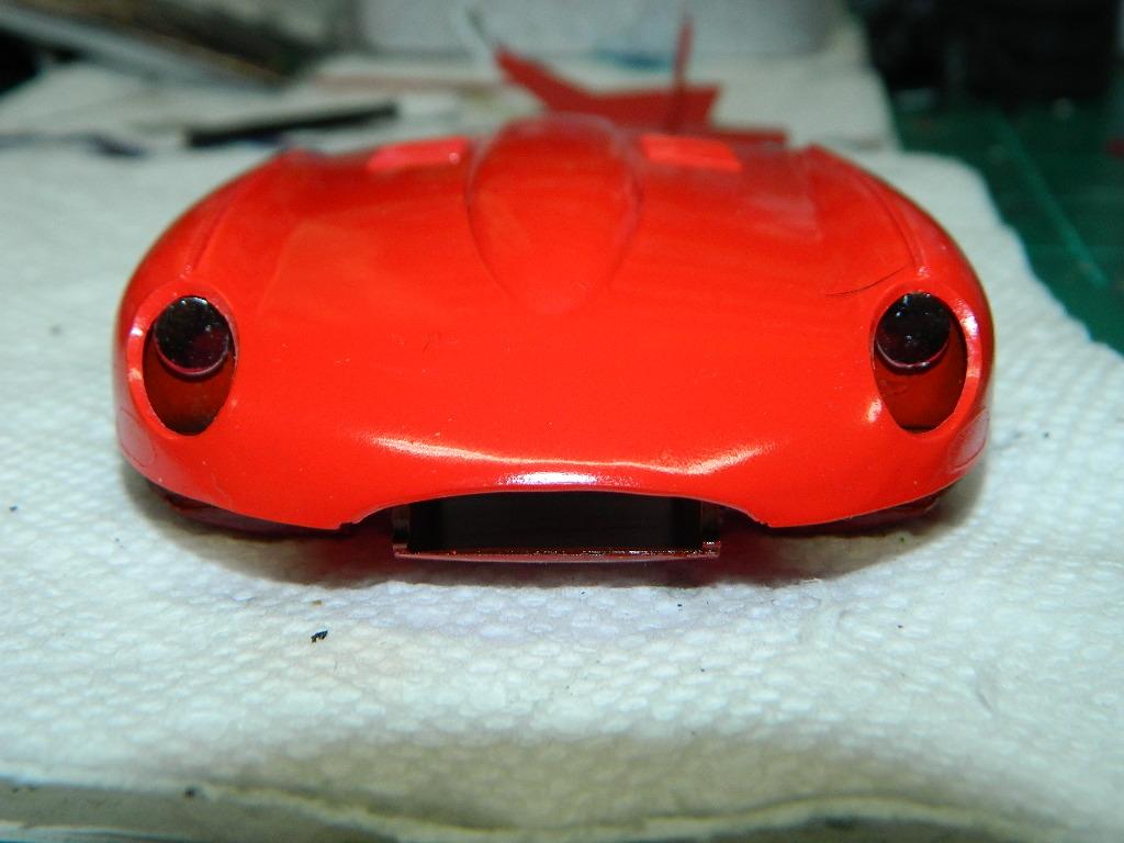

I like to gather pictures of the 1:1 and use them for my background and screensaver on my laptop.  I was staring at my background picture and noticed the headlight tunnels on a 1:1 Jaguar and I didn't see any on the Heller Jag.  Using some 11/32 styrene tubing, I cut out and shaped a couple of "tunnels" for my model.  I got the basic shape and now to cut them down further.

Thanks David!  I thought about the situation and concluded that tubing would be a good thing to use and I happen to have some 11/32 tubing on hand, so it was a perfect fit.

Noel, thank you for the idea, but that doesn't seem to be good for me, especially since I have styrene tubing on hand.  I would rather go through the proces of shaping and fitting the tubing than to go through the effort of copy paper and then transferring that image to very thin card plastic.  For me, that would be a waste of my time and energy.  And, there are no parts for headlight tunnels in the box and it appears to be an overlooked item when they designed the kit, but headlights are included.

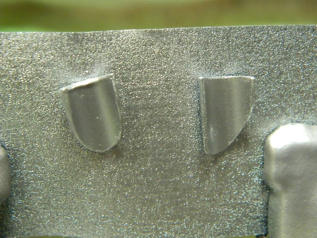

I got the body pieces into a couple of coats of Tamiya TS-86 Pure Red, the headlight tunnels into a coat of Tamiya TS-30 Silver Leaf and the rear deck into a coat of Tamiya TS-29 Semi-Gloss Black.

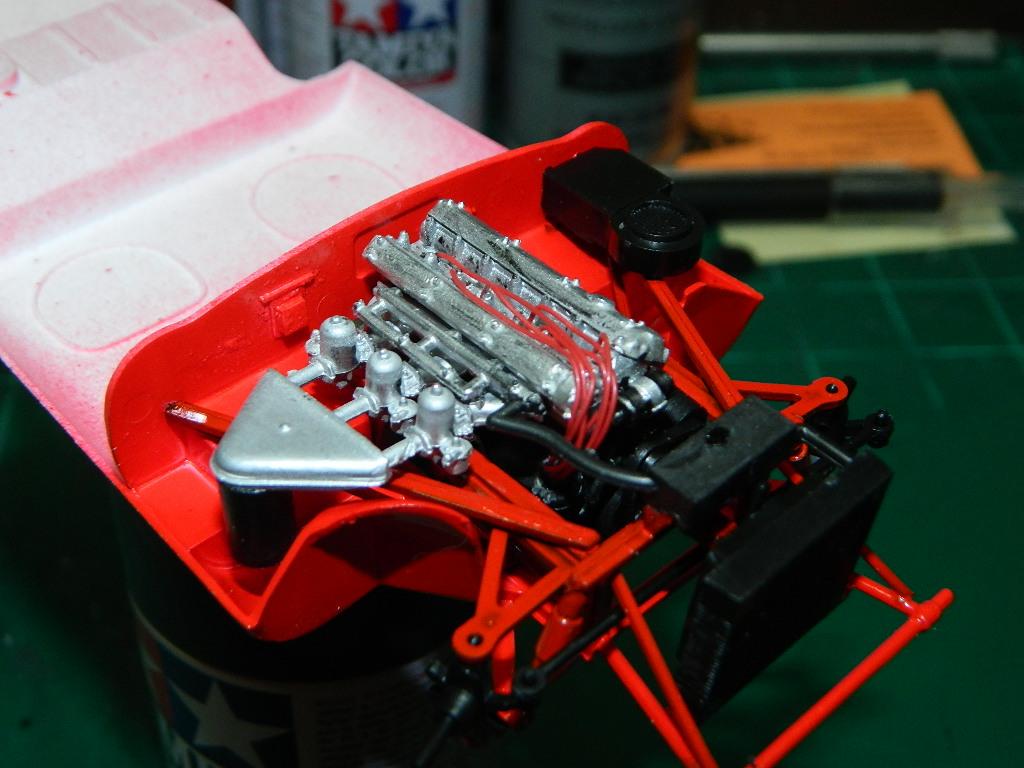

I have been adding more bits and pieces to the chassis of the Jag XK-E including the front suspension.  I also did a mockup with the engine to check the fit.  I added the headlight reflectors to the hood.

Thanks Don!  This is not a bad kit for building.  Some items are missing like the headlight nacelles, but those can be easily built using styrene tubing.  So far, it's not a bad kit.

I have decided to have embossing powder carpet.  I coat the floor with watered down white glue one side at a time and sprinkle black embossing powder until it is covered.  I masked off the front dash and the rear panel for black paint and the front wasn't burnished enough and the black paint ran under the tape.  I added the nacelles for the headlights.
