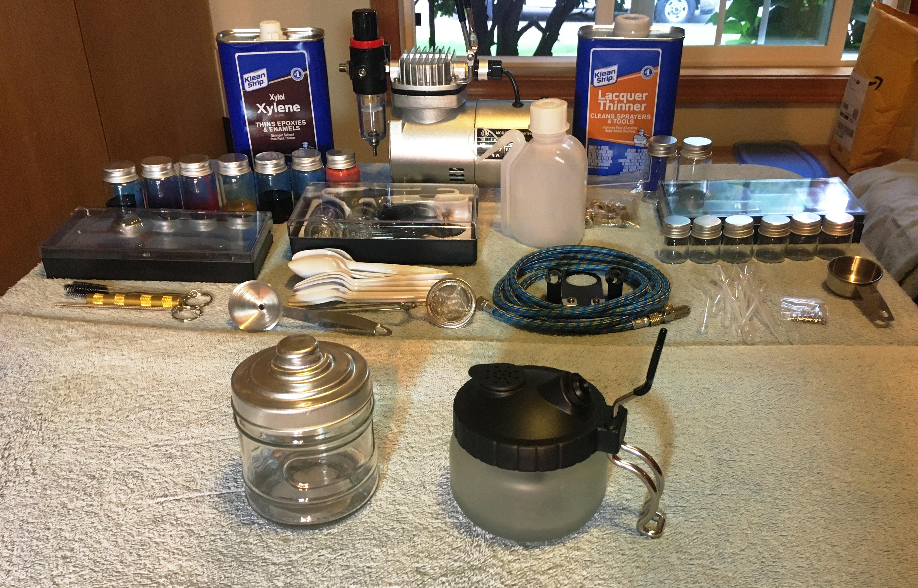

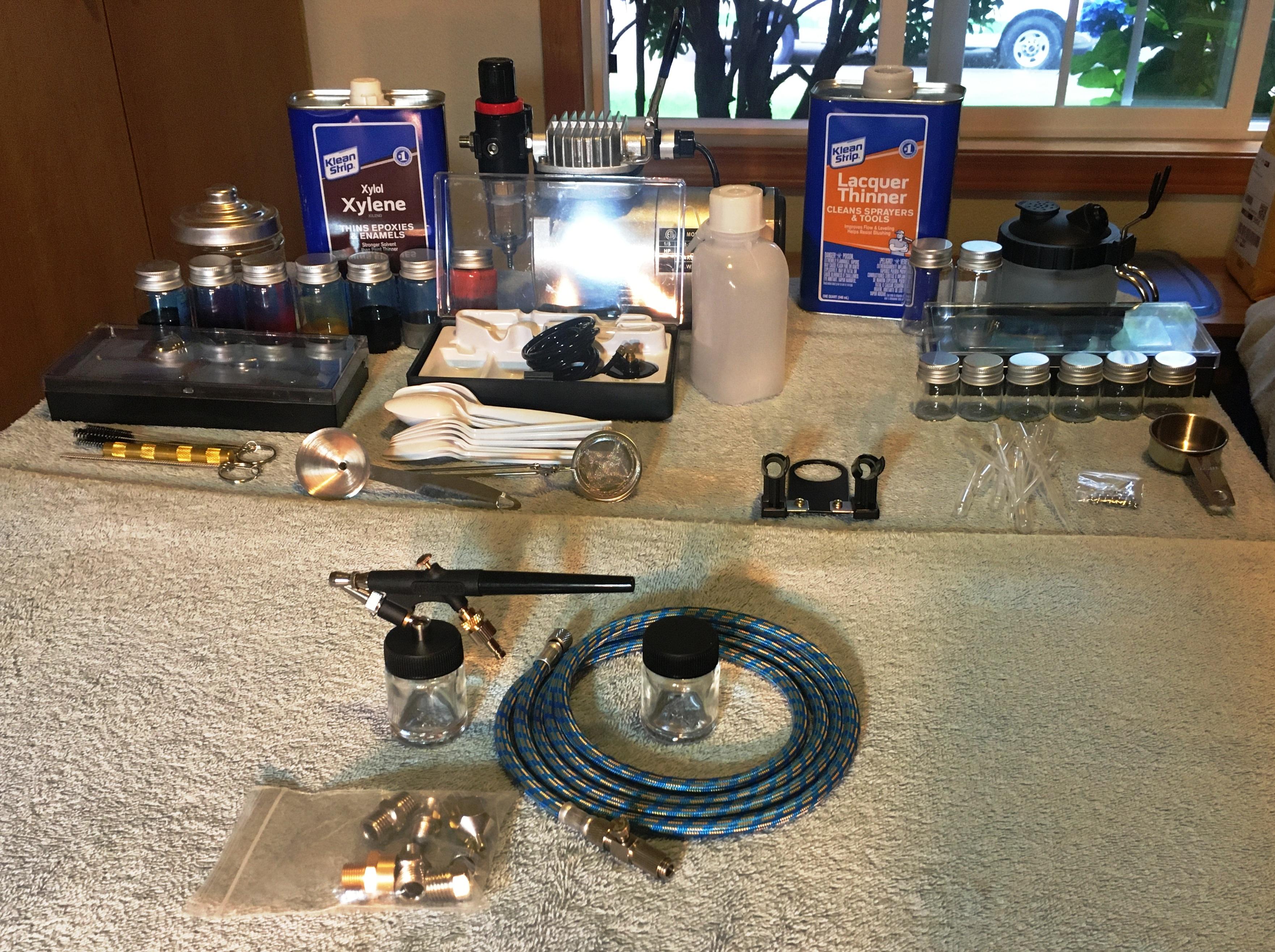

Bills72sj Posted August 22, 2020 Posted August 22, 2020 After seeing so many nice builds from others AND getting tired of "spitty" rattle cans, I am going to try my hand at airbrushing. After watching a dozen Youtube videos, I purchased a bunch of items to help me get started (hopefully, successfully). I made my own safe and mess-free decanter from a automotive Freon injector and a wide (enough) air intake band clamp. It works really well. Did I miss anything?

Matt Bacon Posted August 22, 2020 Posted August 22, 2020 Well, I see lots of stuff. But I also see a can of Xylene, so I really hope you've got also a high quality respirator mask (like a 3M 6200) and a paint booth with substantial extraction to the outside world and spark-free fans... That stuff on your desk can kill you quickly or slowly... please take safety equipment seriously. best, M.

Bills72sj Posted August 23, 2020 Author Posted August 23, 2020 10 hours ago, Matt Bacon said: Well, I see lots of stuff. But I also see a can of Xylene, so I really hope you've got also a high quality respirator mask (like a 3M 6200) and a paint booth with substantial extraction to the outside world and spark-free fans... That stuff on your desk can kill you quickly or slowly... please take safety equipment seriously. best, M. M., I bought the Xylene simply because it says it is for enamels. I may never use it if lacquer thinner works just as well. I do have an excellent paint booth with PLENTY of ventilation.

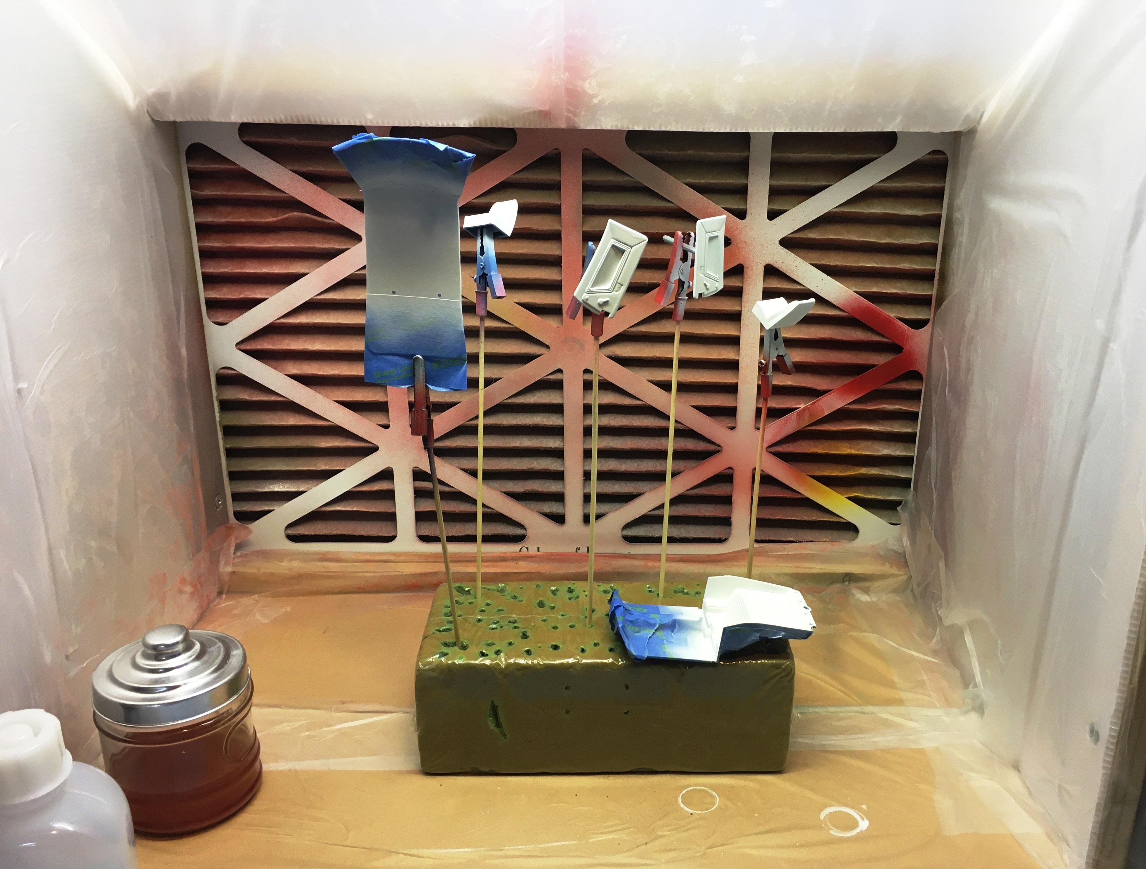

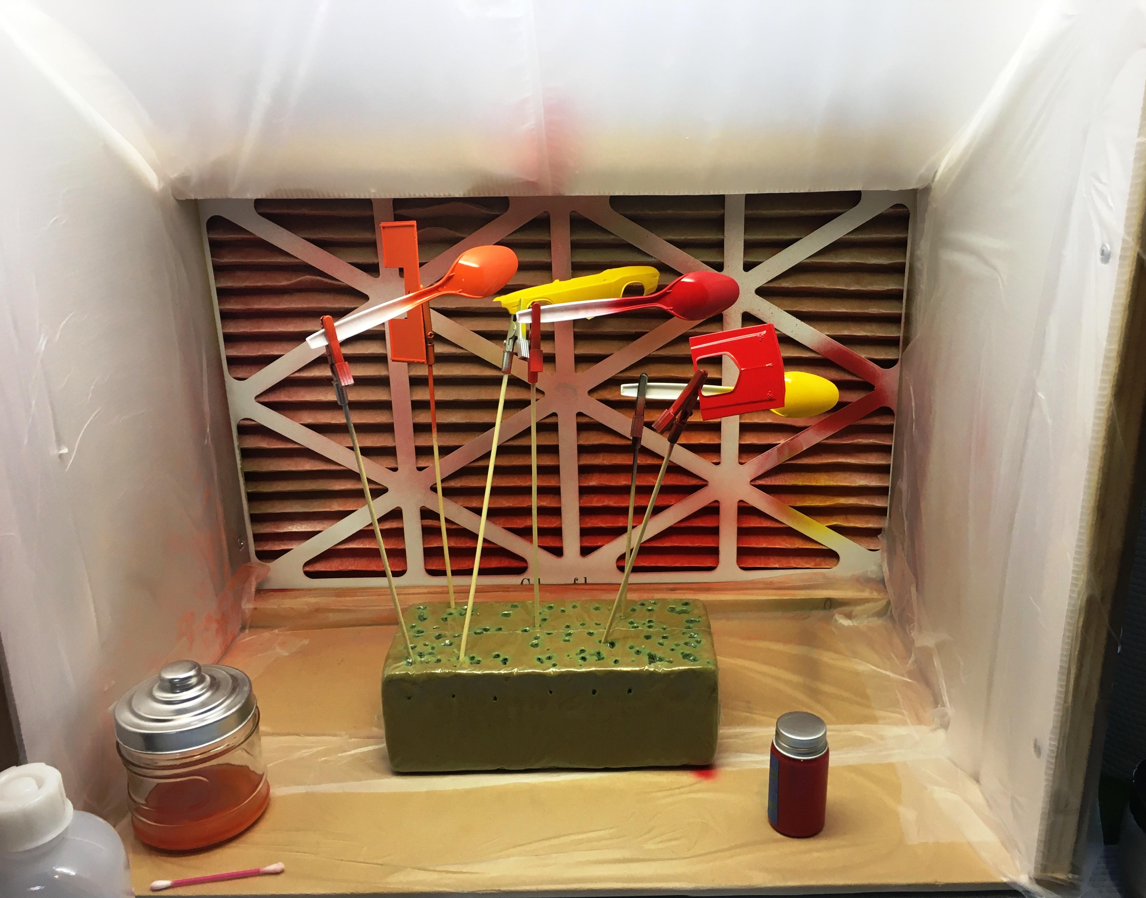

Bills72sj Posted August 23, 2020 Author Posted August 23, 2020 After cleaning and rewrapping my paint booth with 'Press and Seal', I finally actually used 2 of my 3 new airbrushes. I must say, airbrushing is WAY better than rattle cans. It is no wonder you guys get such awesome results. The color and thickness control is AMAZING. I am so glad I took the dive. So far I have shot 6 decanted enamels and one jar of acrylic thinned with household ammonia (probably not the best solvent). I am very pleased with the results. I hope to shoot some more parts for my Mustang tomorrow.
STYRENE-SURFER Posted August 23, 2020 Posted August 23, 2020 Fantastic! You certainly have a good looking setup. ? Glad to hear things are going well after being brave and jumping in... into one of the more challenging aspects of the hobby to wrap ones head around?
