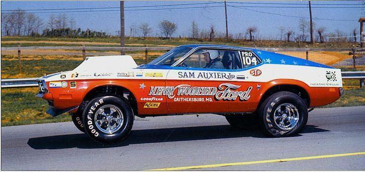

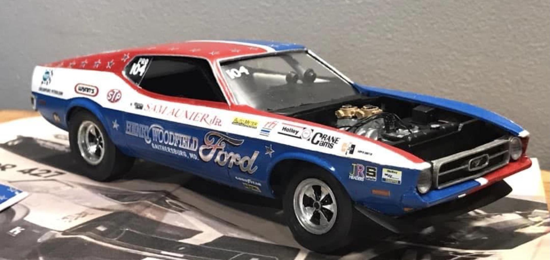

Mr mopar Posted July 22 Share Posted July 22 (edited) A Drag racing unit would be cool to see ! Edited July 22 by Mr mopar 3 Quote Link to comment Share on other sites More sharing options...
vamach1 Posted July 22 Share Posted July 22 19 minutes ago, Mr mopar said: A Drag racing unit would be cool to see ! Now that’s crazy talk. 😉 5 Quote Link to comment Share on other sites More sharing options...

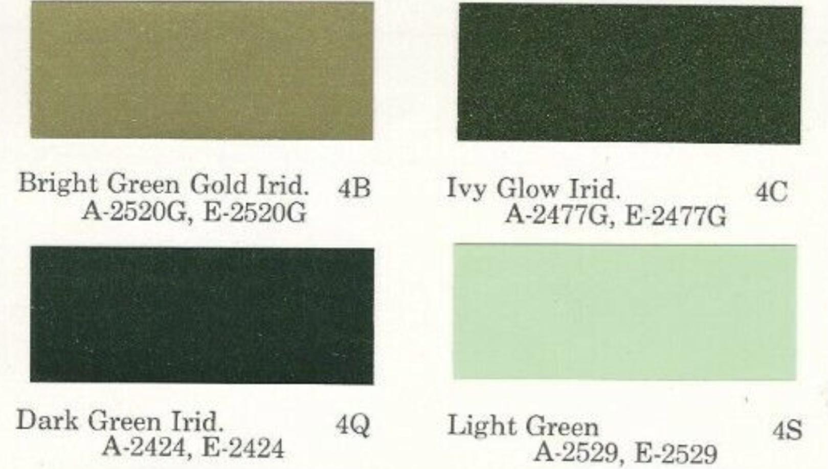

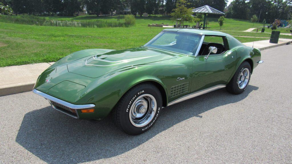

Hawk312 Posted July 22 Share Posted July 22 On 7/20/2023 at 8:59 PM, vamach1 said: Looks like the Ivy Glow. Thanks vamach1! Is it just me, or does that look almost exactly like GM Elkhart Green Metallic that you see on a lot of Corvettes of that era? 1 Quote Link to comment Share on other sites More sharing options...

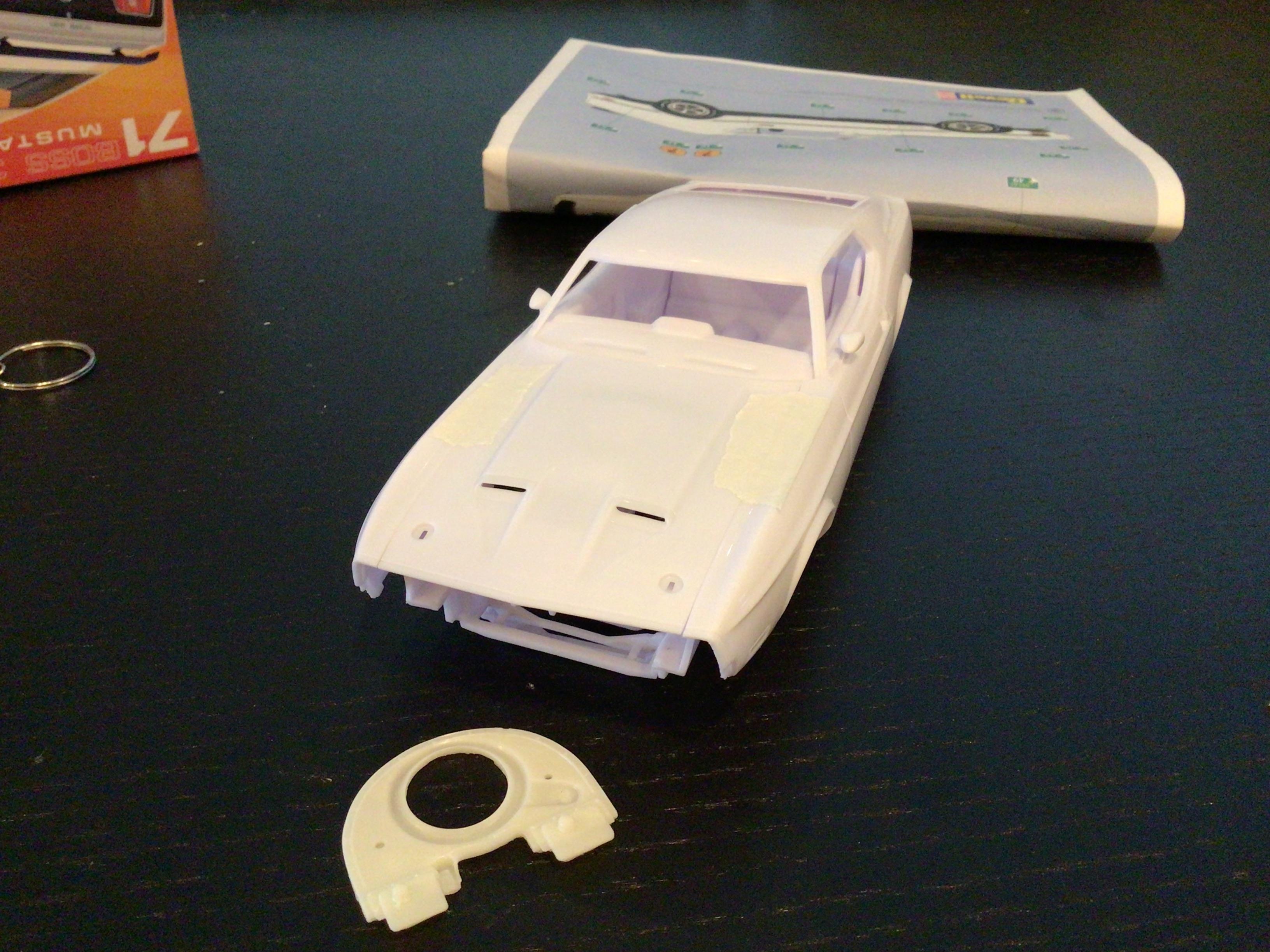

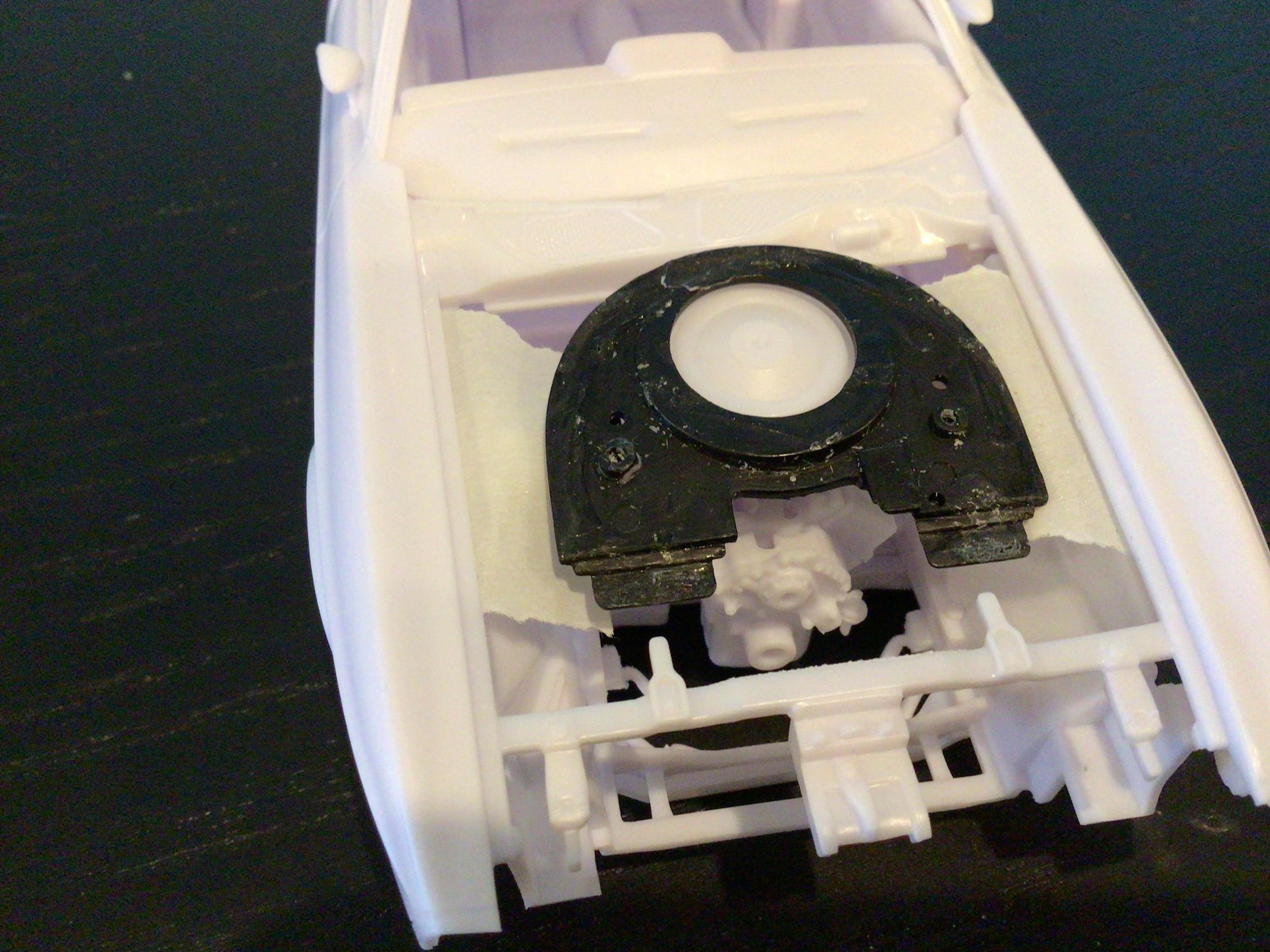

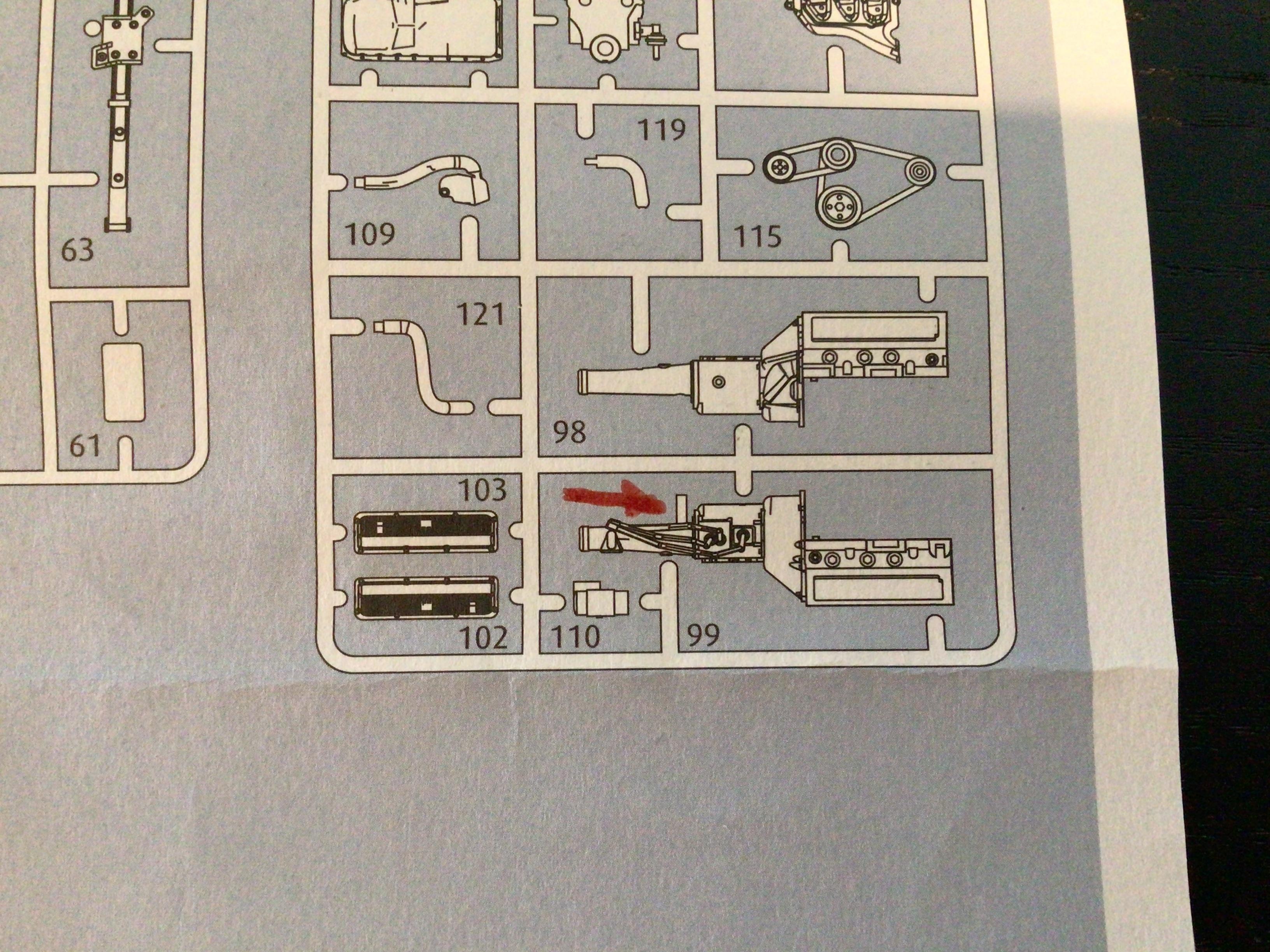

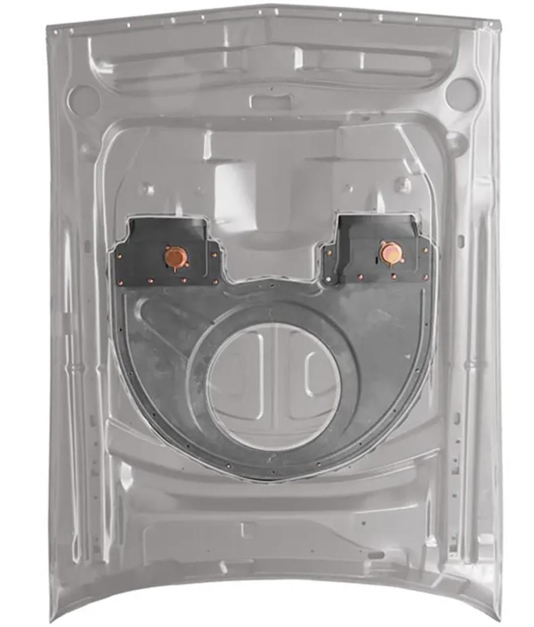

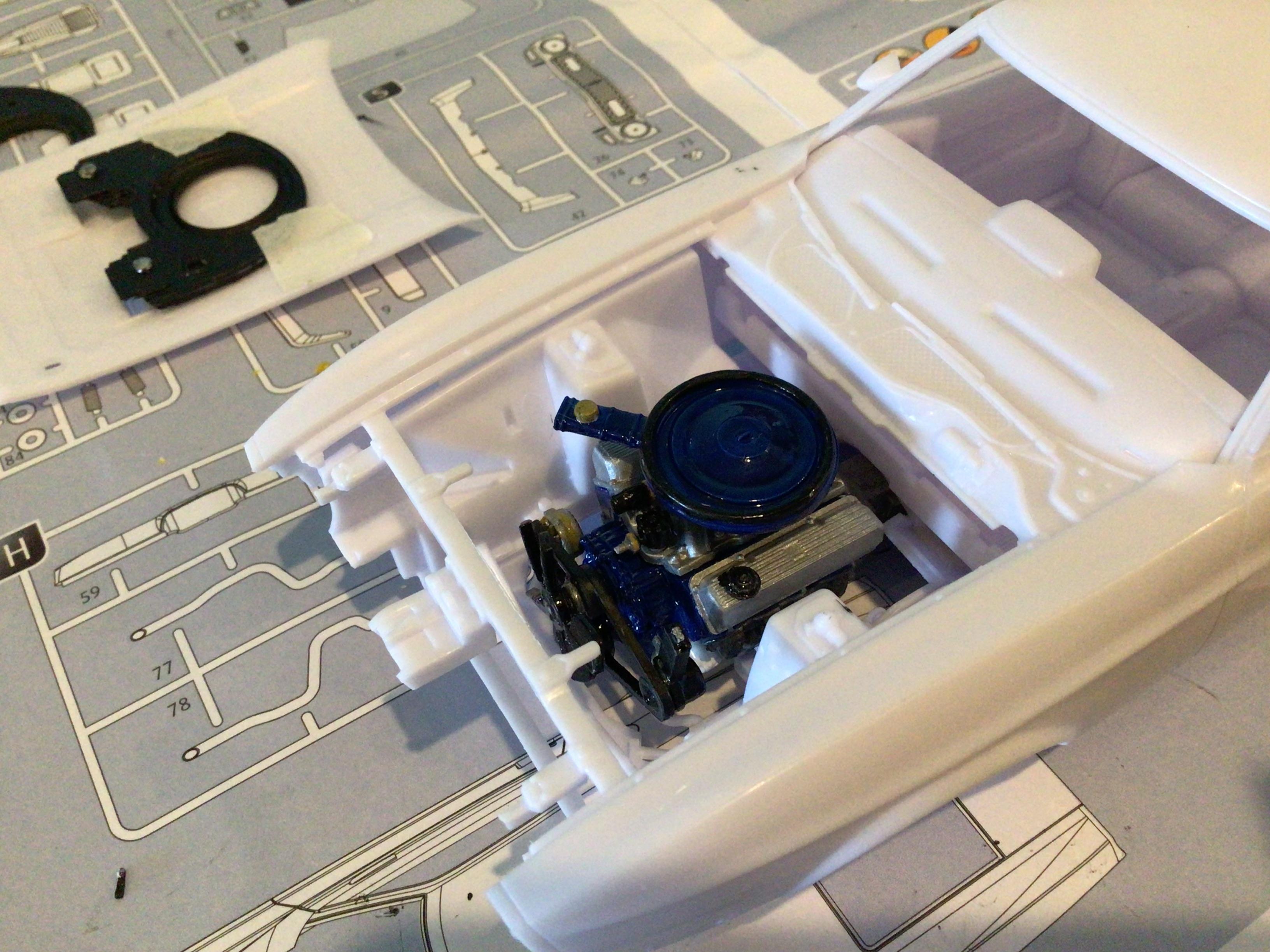

vamach1 Posted July 25 Share Posted July 25 (edited) Long before the Revell kit hit the shelves I took apart a Danbury Mint 1/24 Boss 351 diecast. Who would do a crazy thing you might ask. The thinking at the time was there wasn’t a decent kit out there to replicate an accurate Boss 351 in 1/25 scale so copies were made for use on the AMT or MPC 71-73 Mustangs. Now that Revell has produced an outstanding kit there was one part that I wondered if it could be added for additional realism. From the pictures you can see that the Ram-Air Plenum (molded into the hood on the Revell kit) could work as a separate part from my test fit using the DM piece. Let’s see where this goes as with a Mach1 version of the Revell kit will probably be out in less than a year I personally like the idea of separate part as long as the hood closes flush with the fenders. The third picture shows the hood does fit with the part on top of the air cleaner. Edited July 26 by vamach1 Pics 5 Quote Link to comment Share on other sites More sharing options...
Mr mopar Posted July 25 Share Posted July 25 3 minutes ago, vamach1 said: Long before the Revell kit hit the shelves I took apart a FM 1/24 Boss 351 diecast. Who would do a crazy thing you might ask. The thinking at the time was there wasn’t a decent kit out there to replicate an accurate Boss 351 in 1/25 scale so copies were made for use on the AMT or MPC 71-73 Mustangs. Now that Revell has produced an outstanding kit there was one part that I wondered if it could be added for additional realism. From the pictures you can see that the Ram-Air Plenum (molded into the hood on the Revell kit) could work as a separate part from my test fit using the FM piece. Let’s see where this goes as with a Mach1 version of the Revell kit will probably be out in less than a year I personally like the idea of separate part as long as the hood closes flush with the fenders. I have this part (resin casted ) I was hoping it would fit under the hood without modifying it ? 2 Quote Link to comment Share on other sites More sharing options...
vamach1 Posted July 25 Share Posted July 25 26 minutes ago, Mr mopar said: I have this part (resin casted ) I was hoping it would fit under the hood without modifying it ? I would carefully line it up with the air cleaner and glue it to the body color painted hood. It would probably not hurt to sand down the top of the intake manifold a few millimeters so the carb and air cleaner sit lower. Once I get more done on the kit I’ll let everyone know how it works out. 3 Quote Link to comment Share on other sites More sharing options...

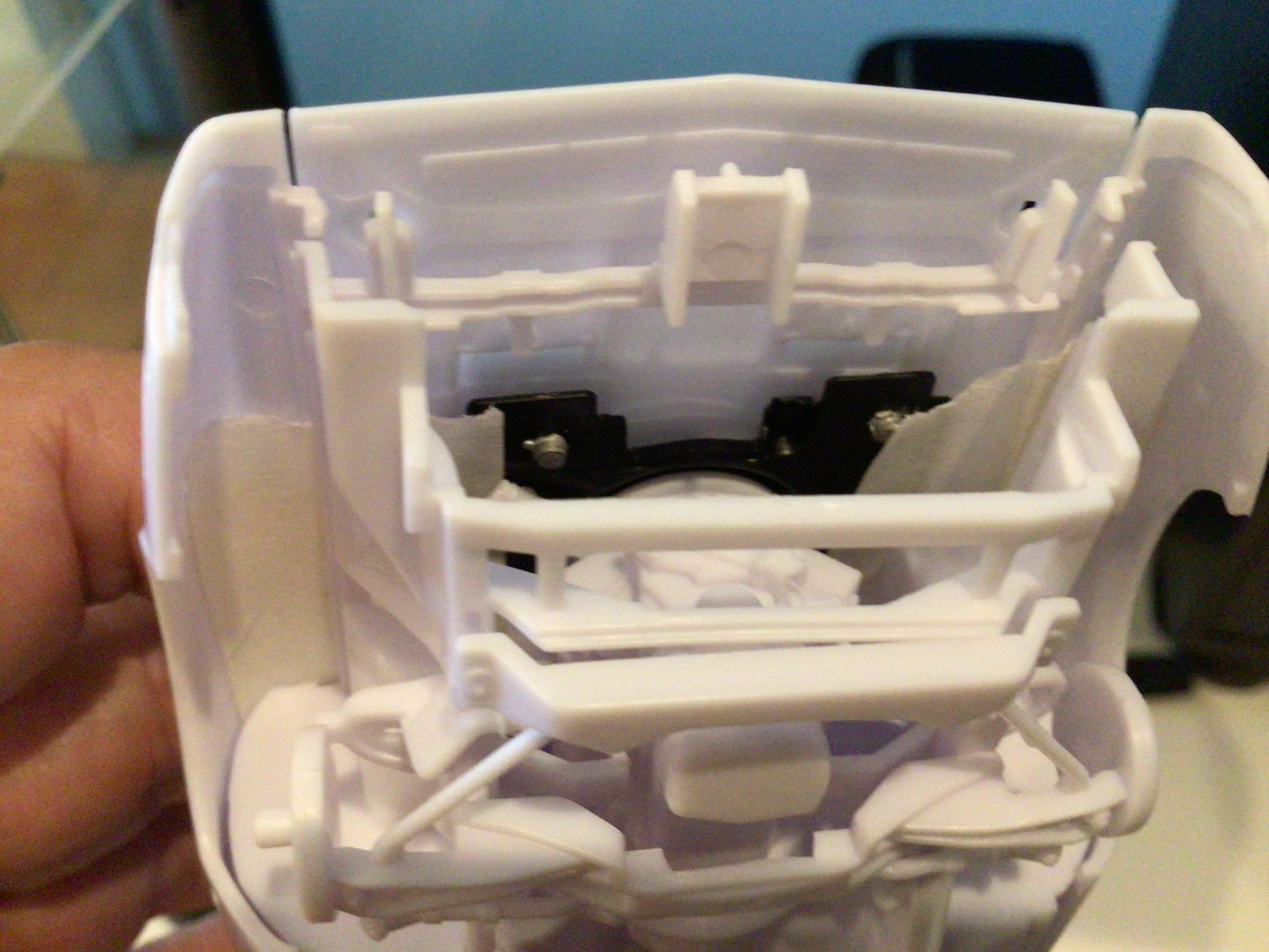

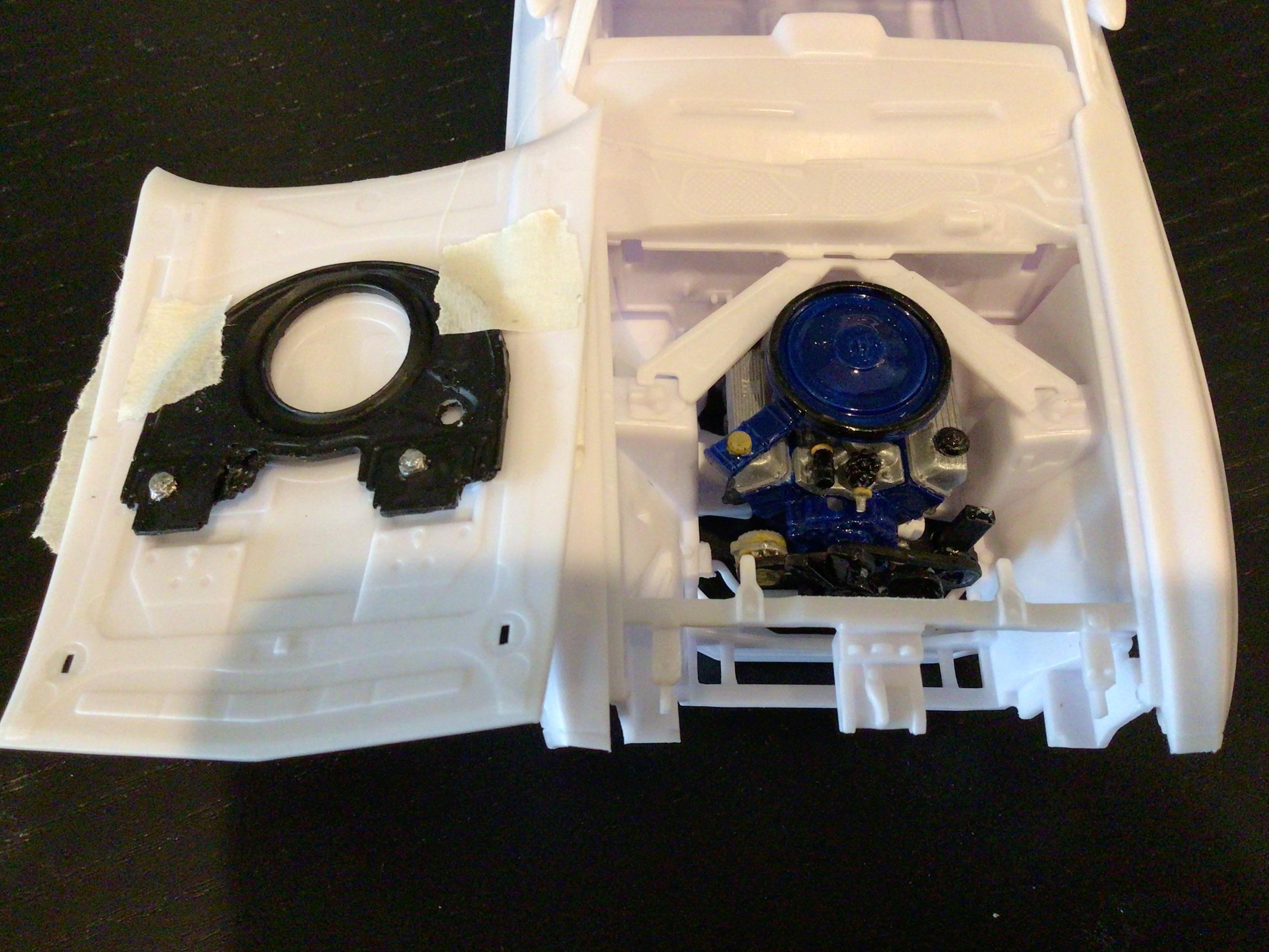

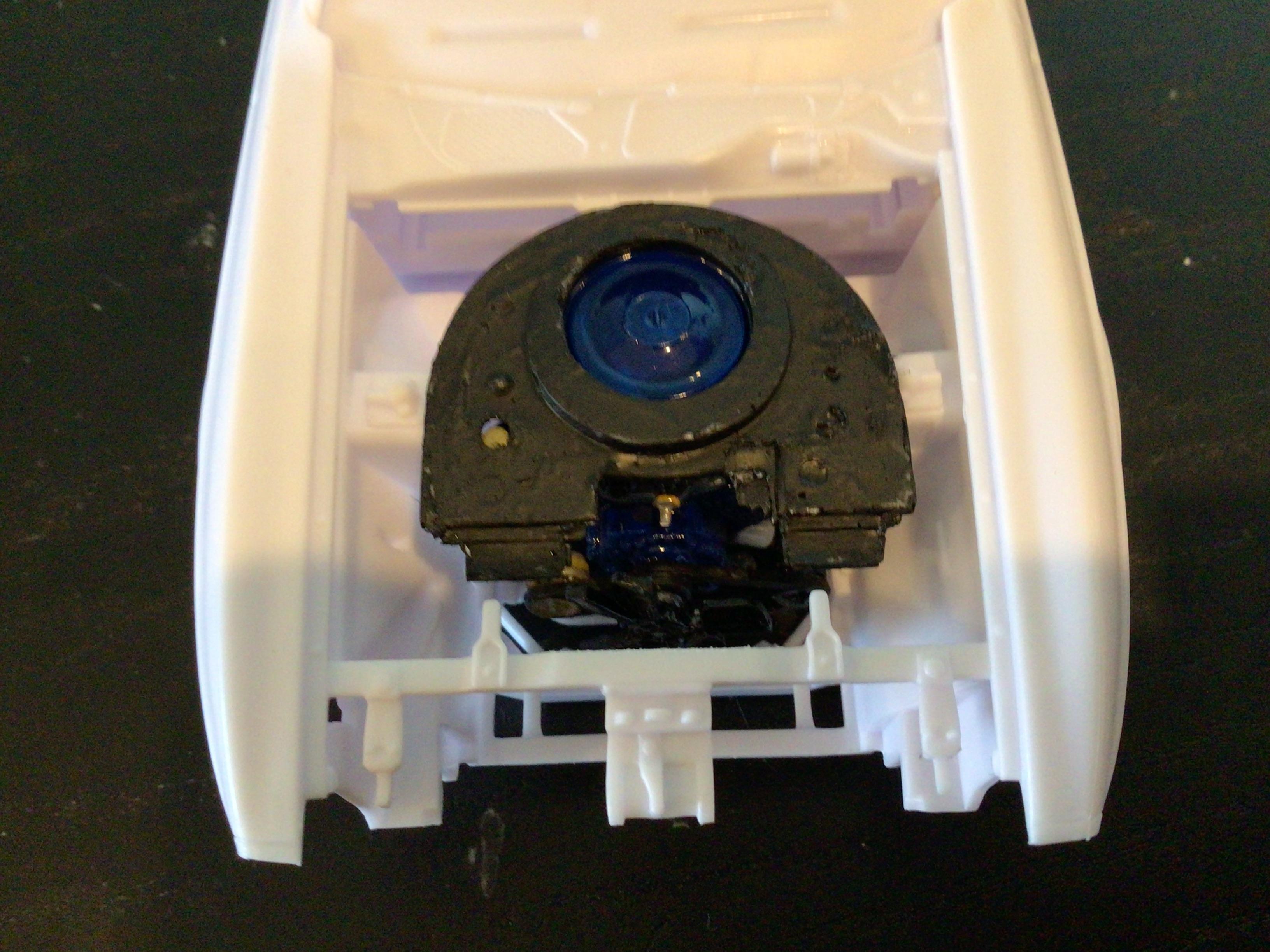

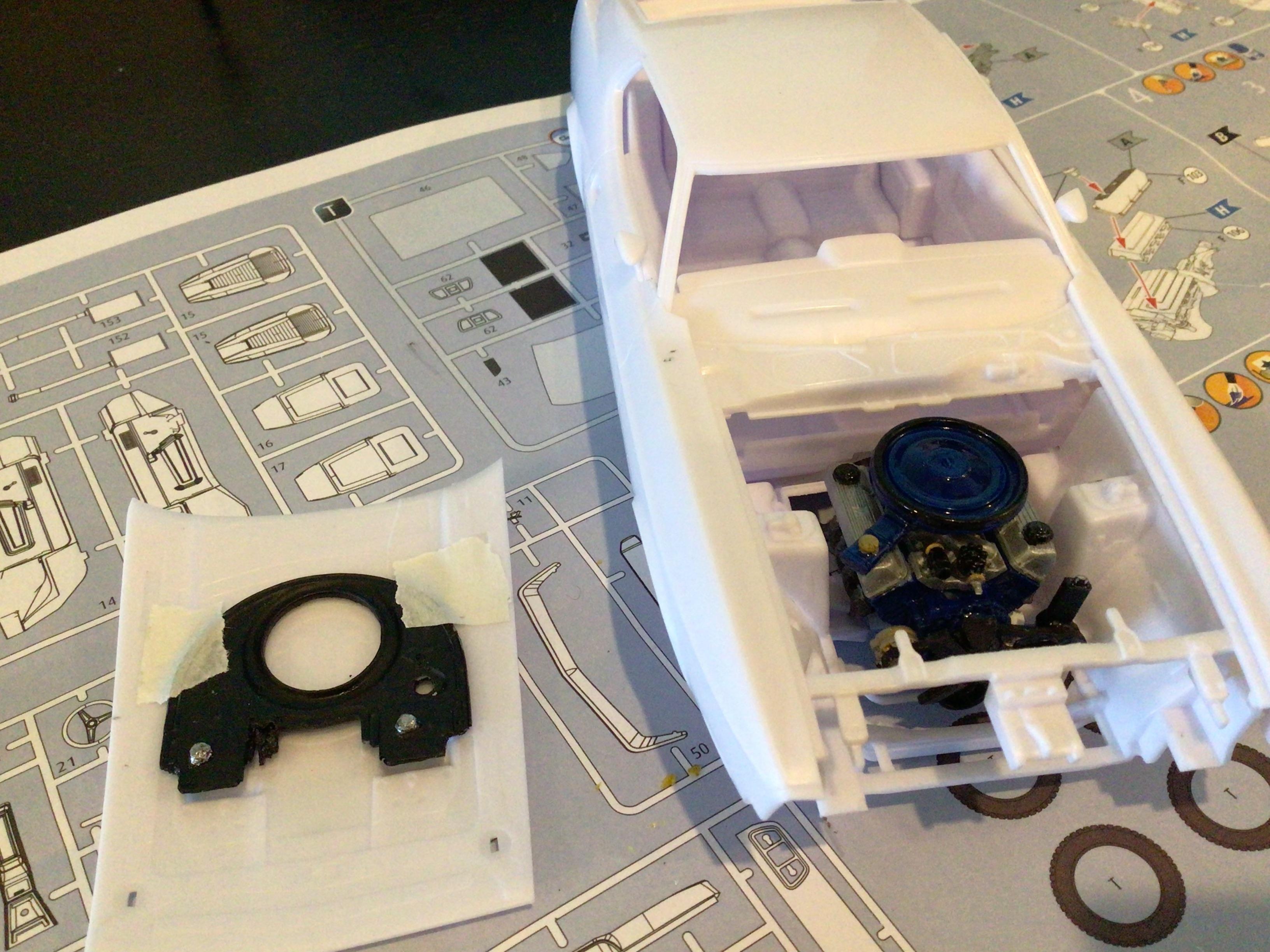

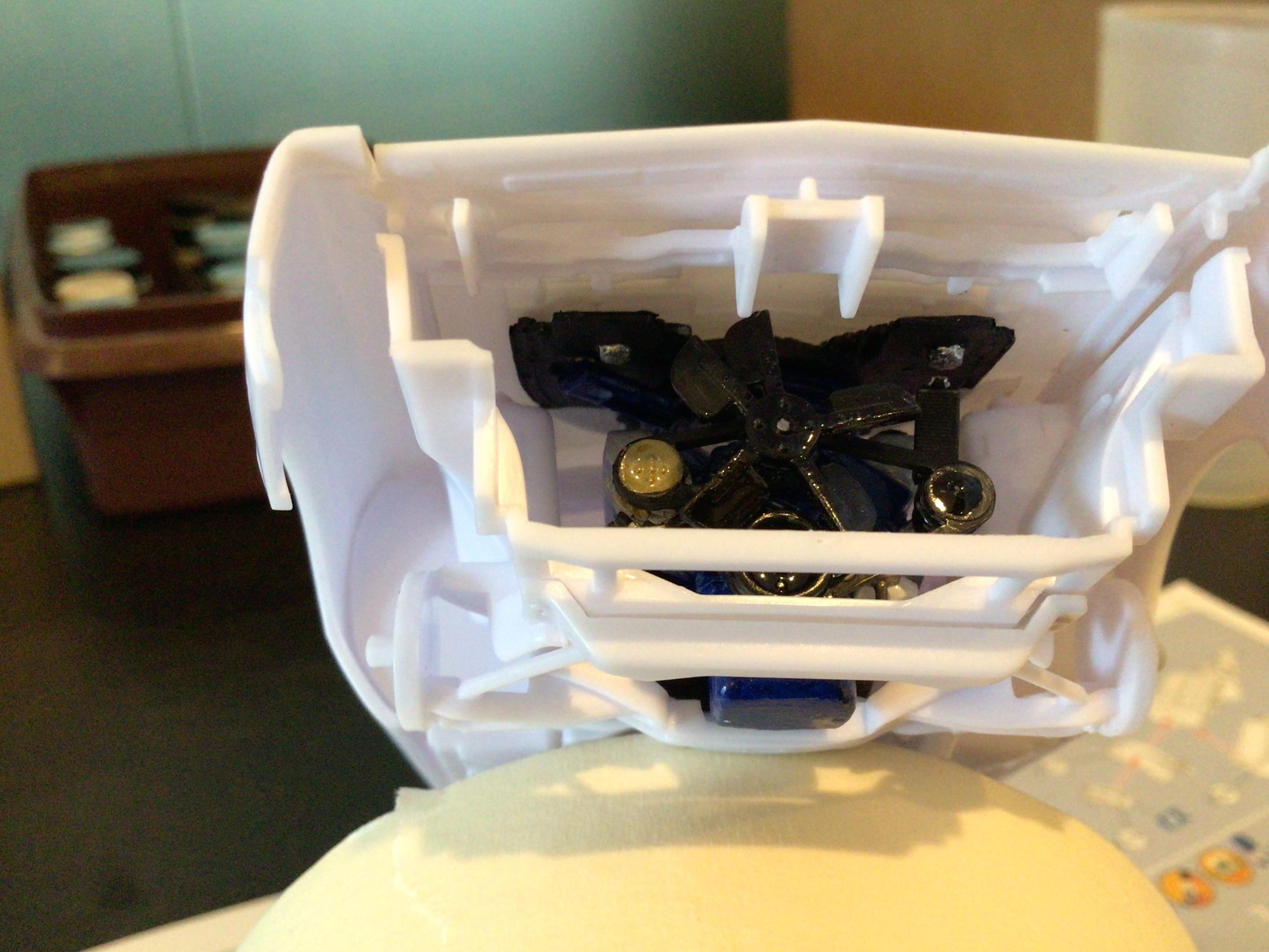

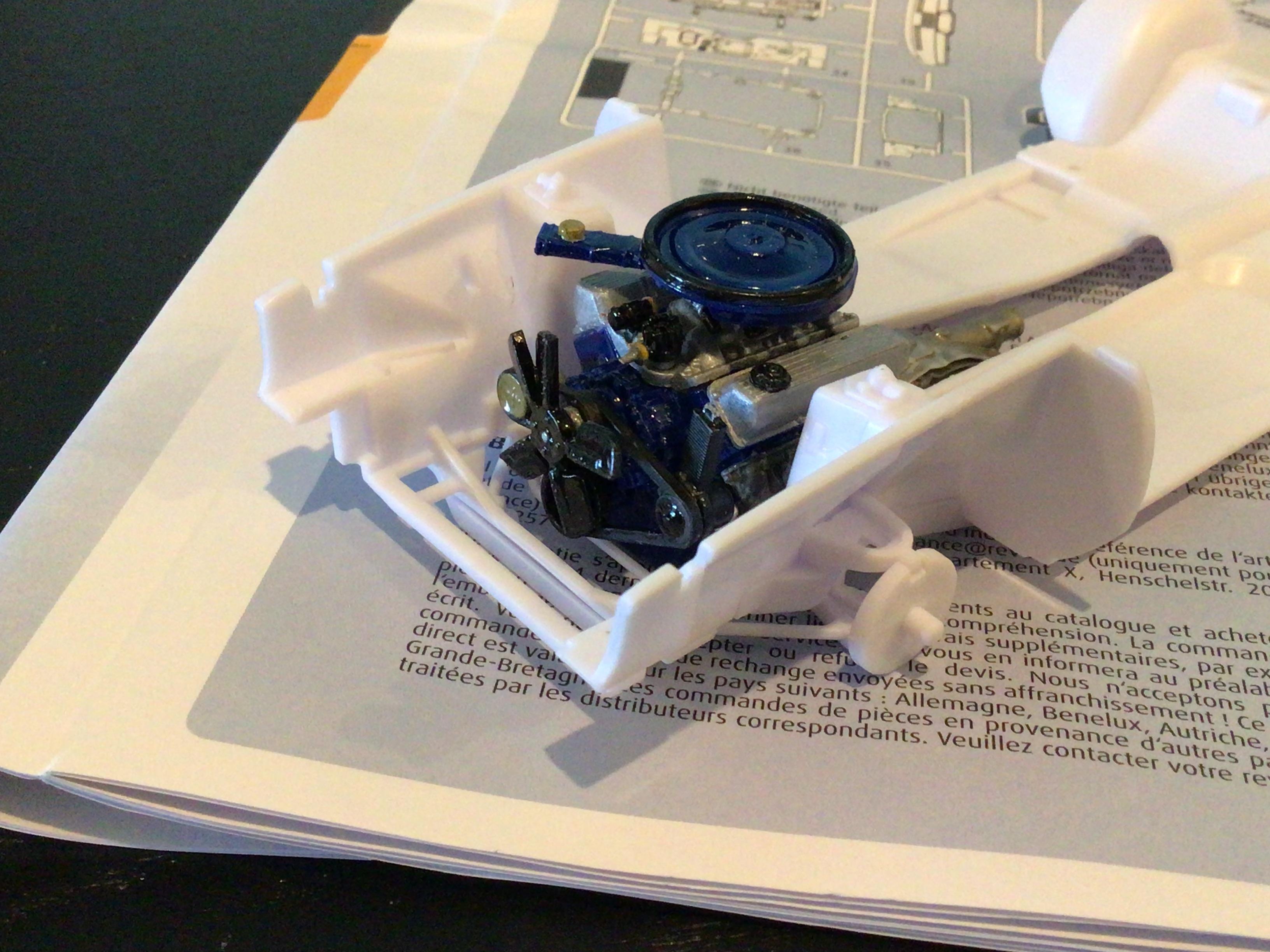

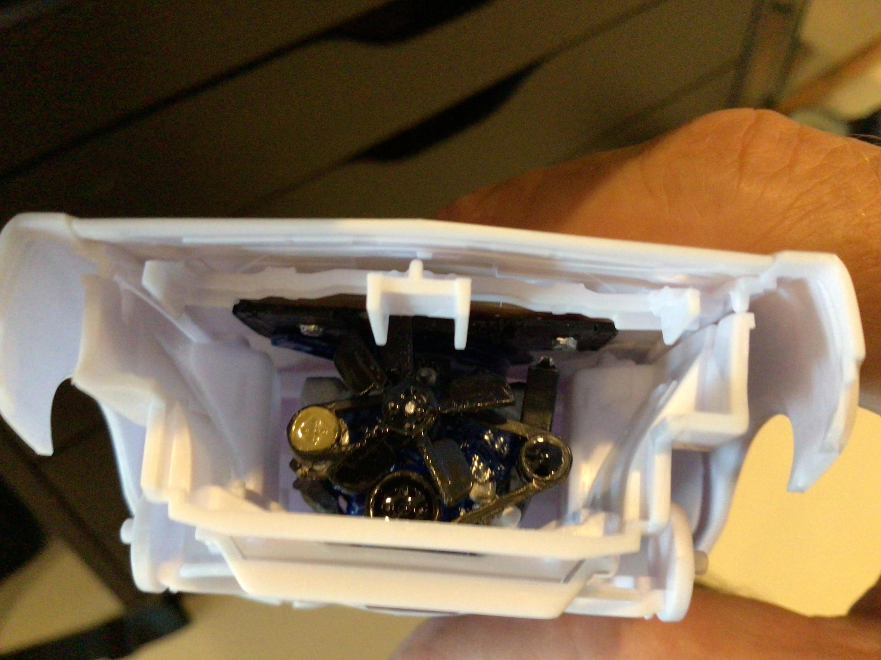

vamach1 Posted July 27 Share Posted July 27 I put the engine together and did more test fitting. My conclusion there would be no problem with a property designed ram-air plenum part fitting underneath the hood and on top of the air cleaner. The resin part I’ve been using is by no means a perfect fit but despite that it has shown that with a recessed area for the top of the air cleaner and indentation or hold for the vacuum motor that sits on top of the air cleaner snorkel there is adequate clearance. A better fitting part would be ideal especially the parts that connect to the twin scoops. This area is far enough of the engine that for the part I used this test fit did not create any problems. I made one modification assuming it would help “lower” the completed engine if clearance was going to be an issue. I cut off about half of the mounting pin as noted in the picture. Whether this helped or not I cannot say for sure but that locating pin just looked long to me. Since Revell appears to be pretty flexible in creating parts for future versions of the kit, it is my hope that a ram-air plenum part be reconsidered. Thanks for looking. Quote Link to comment Share on other sites More sharing options...
'70 Grande Posted July 28 Share Posted July 28 Do you think the firewall to shock tower braces might get in the way? Quote Link to comment Share on other sites More sharing options...
vamach1 Posted July 28 Share Posted July 28 6 hours ago, '70 Grande said: Do you think the firewall to shock tower braces might get in the way? No. Also keep in mind the resin part could fit better meaning despite it not fitting as flush as I would like it the hood still closes without any problems. Quote Link to comment Share on other sites More sharing options...

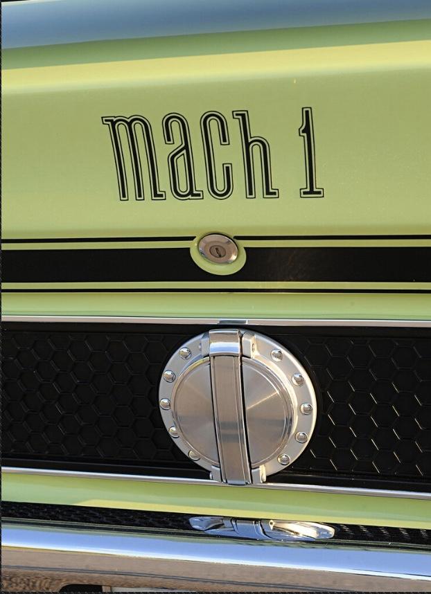

Luc Janssens Posted July 31 Share Posted July 31 Just picked up a copy at my local hobby shop. Took a photo of the decal sheet as it probably differs from the North American edition. Also what is part 57 on the chrome tree (gas cap for a racing version?) 1 Quote Link to comment Share on other sites More sharing options...
sfhess Posted July 31 Share Posted July 31 Mach 1s had a flip open gas cap. Other models had a twist-off gas cap. 1 Quote Link to comment Share on other sites More sharing options...
vamach1 Posted July 31 Share Posted July 31 1 hour ago, Luc Janssens said: Just picked up a copy at my local hobby shop. Took a photo of the decal sheet as it probably differs from the North American edition. Also what is part 57 on the chrome tree (gas cap for a racing version?) The 71 Mustang Mach1 gas cap was a one year option only and is designed to fit with the honeycomb panel. Any other Mustang that has one would have been added later. It “pops” open by pushing on it. While it might resemble a “racing” gas cap, it was undoubtably more expensive than the standard gas cap and thus was not available from the factory in 72-73. 1 Quote Link to comment Share on other sites More sharing options...
