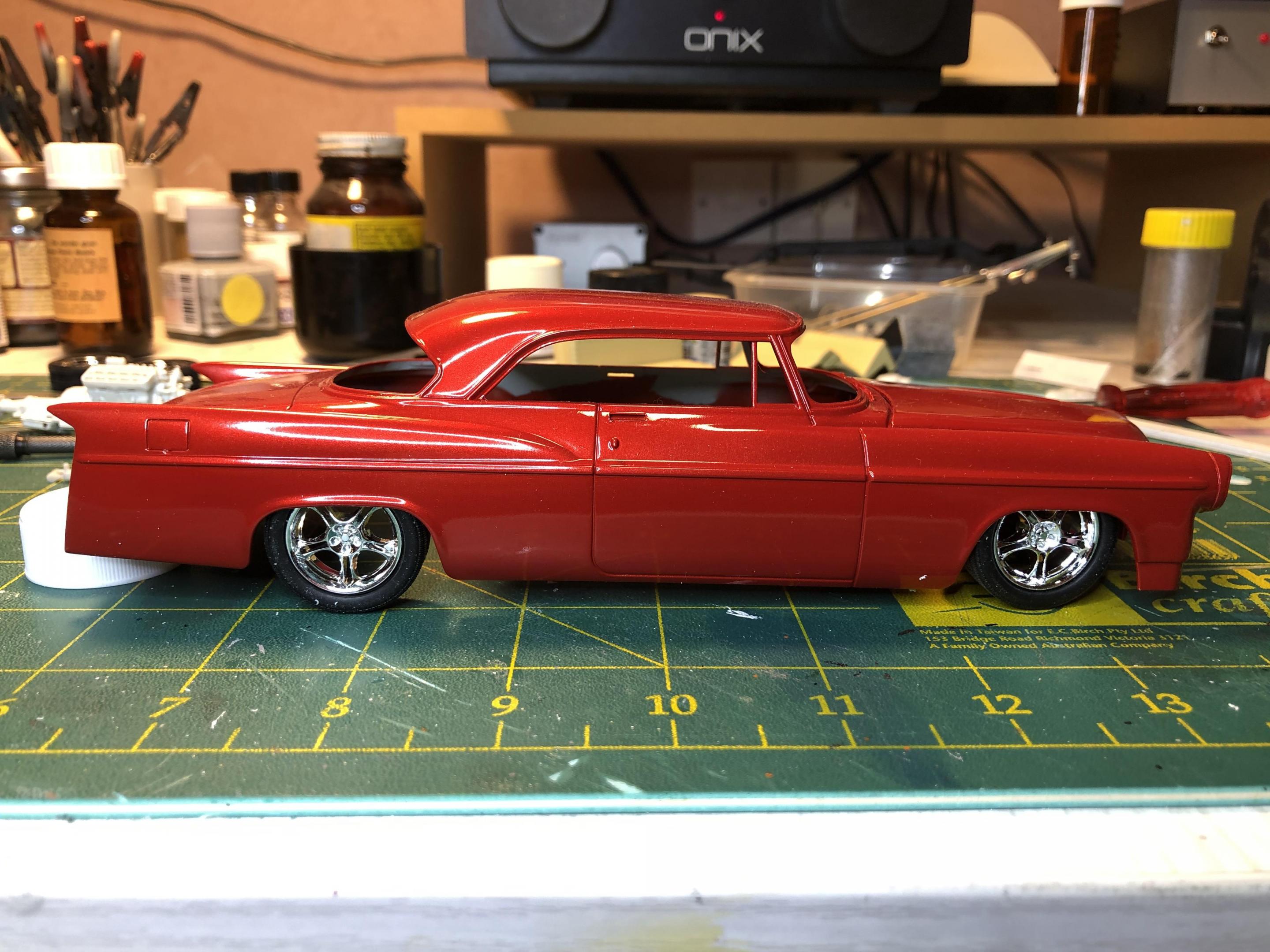

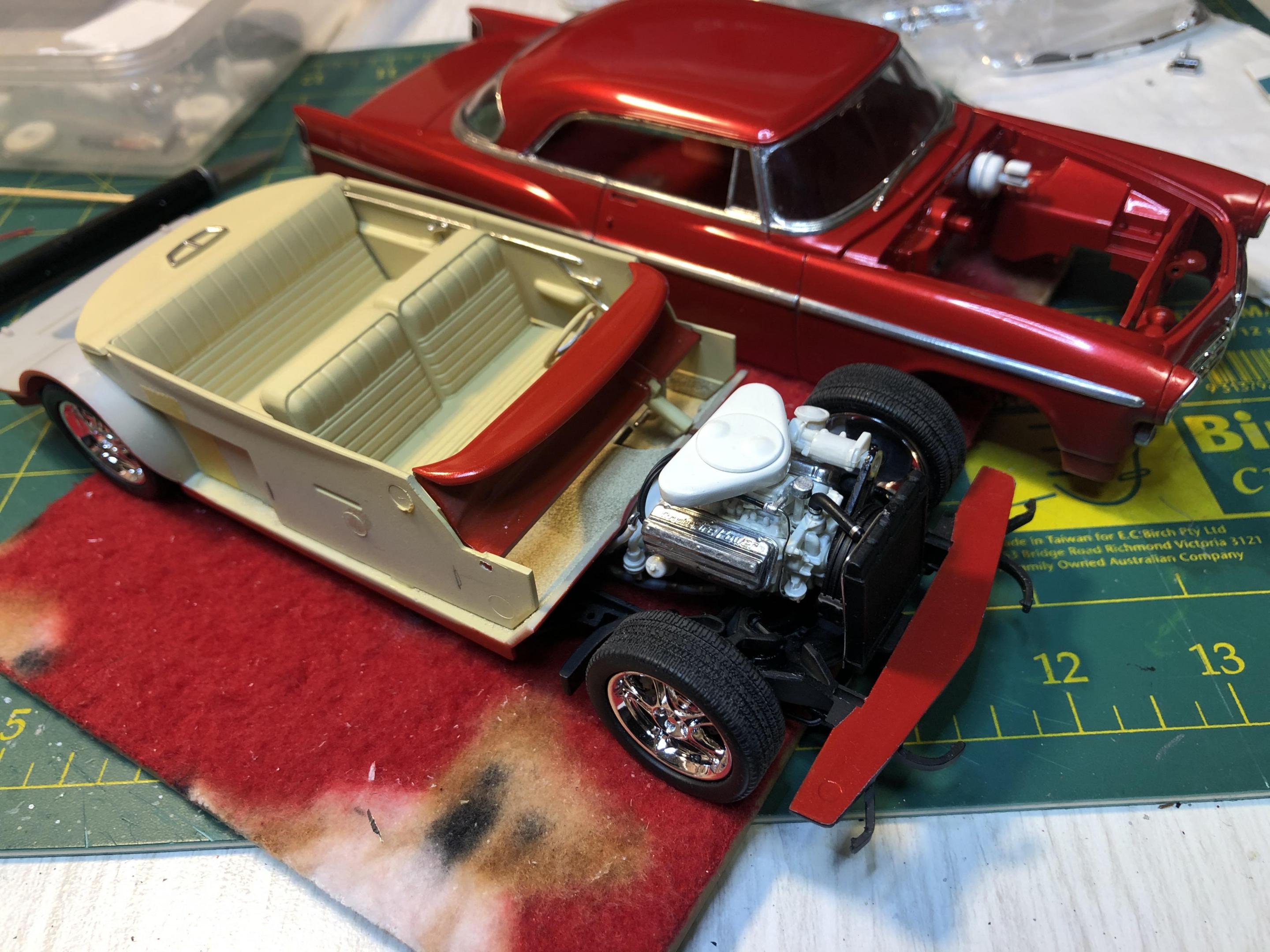

bill-e-boy Posted September 21, 2020 Author Share Posted September 21, 2020 The color is Tamiya Mica red in their new laquer bottle range with same clear coated. Not polished out yet To get the stance down at the rear I added lowering blocks, shortened the rear spring hangers and remounted the front of the spring higher in the chassis by making new pockets For the front I relocated the stub axles higher and shortened the spring a little and bored out the spring mount so it would mount higher Quote Link to comment Share on other sites More sharing options...

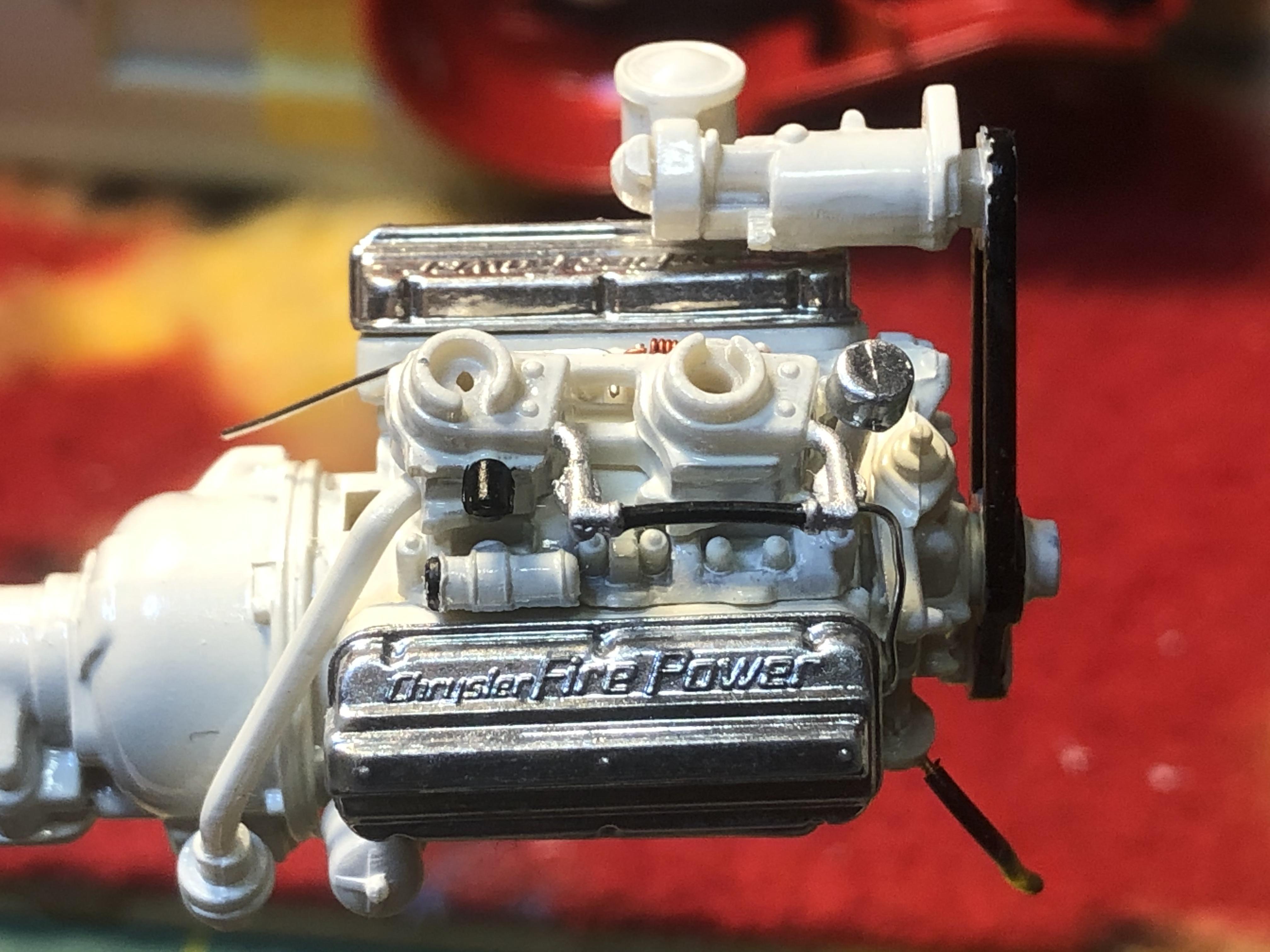

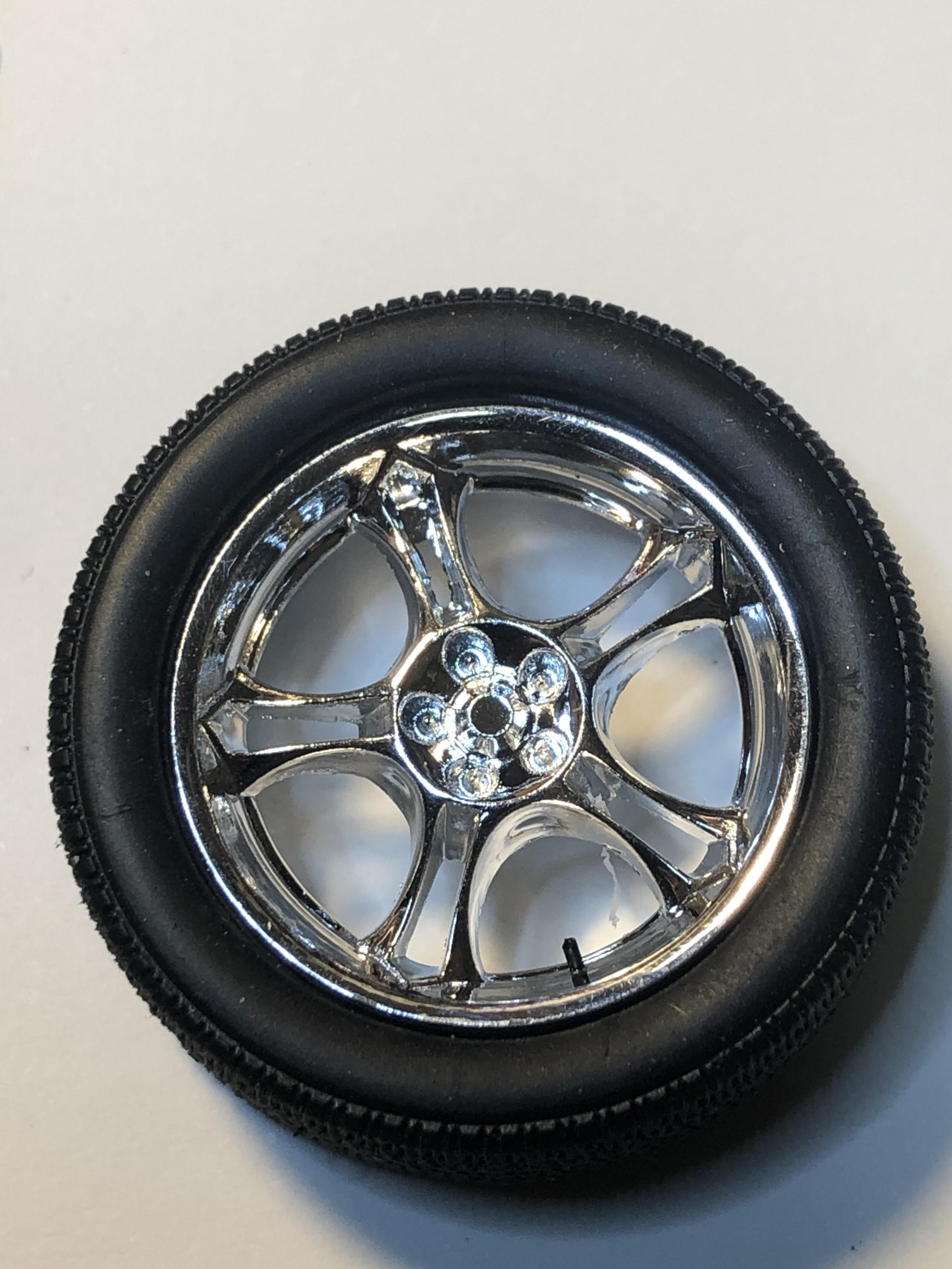

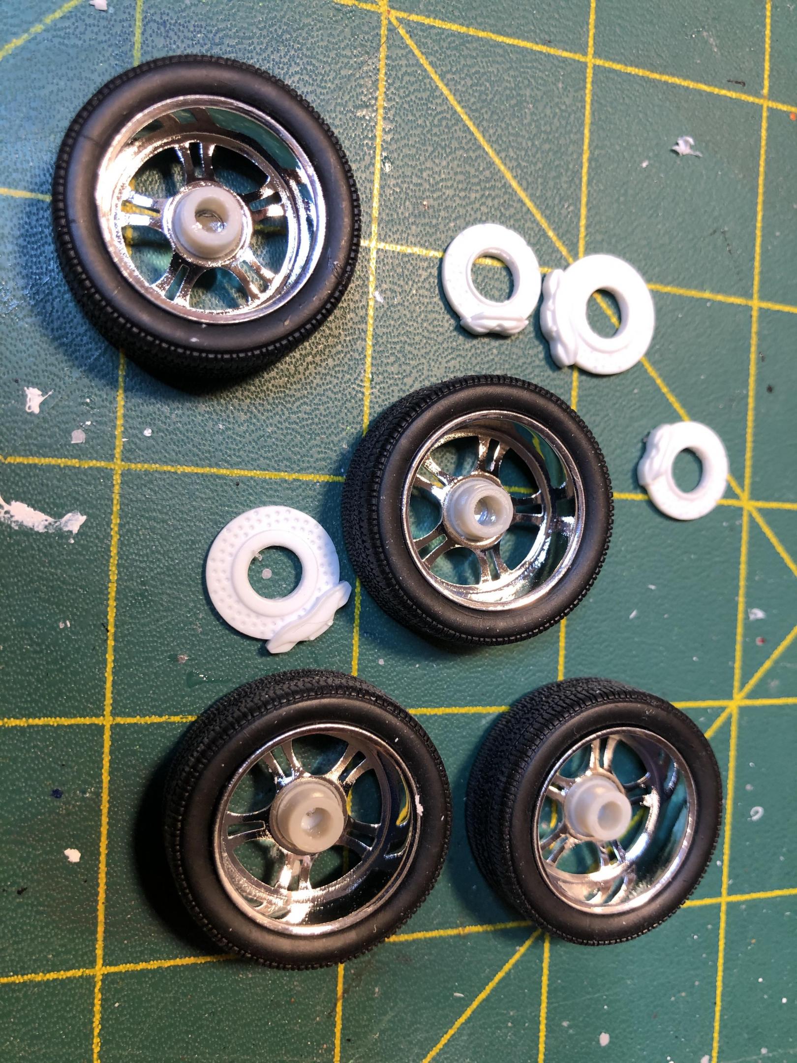

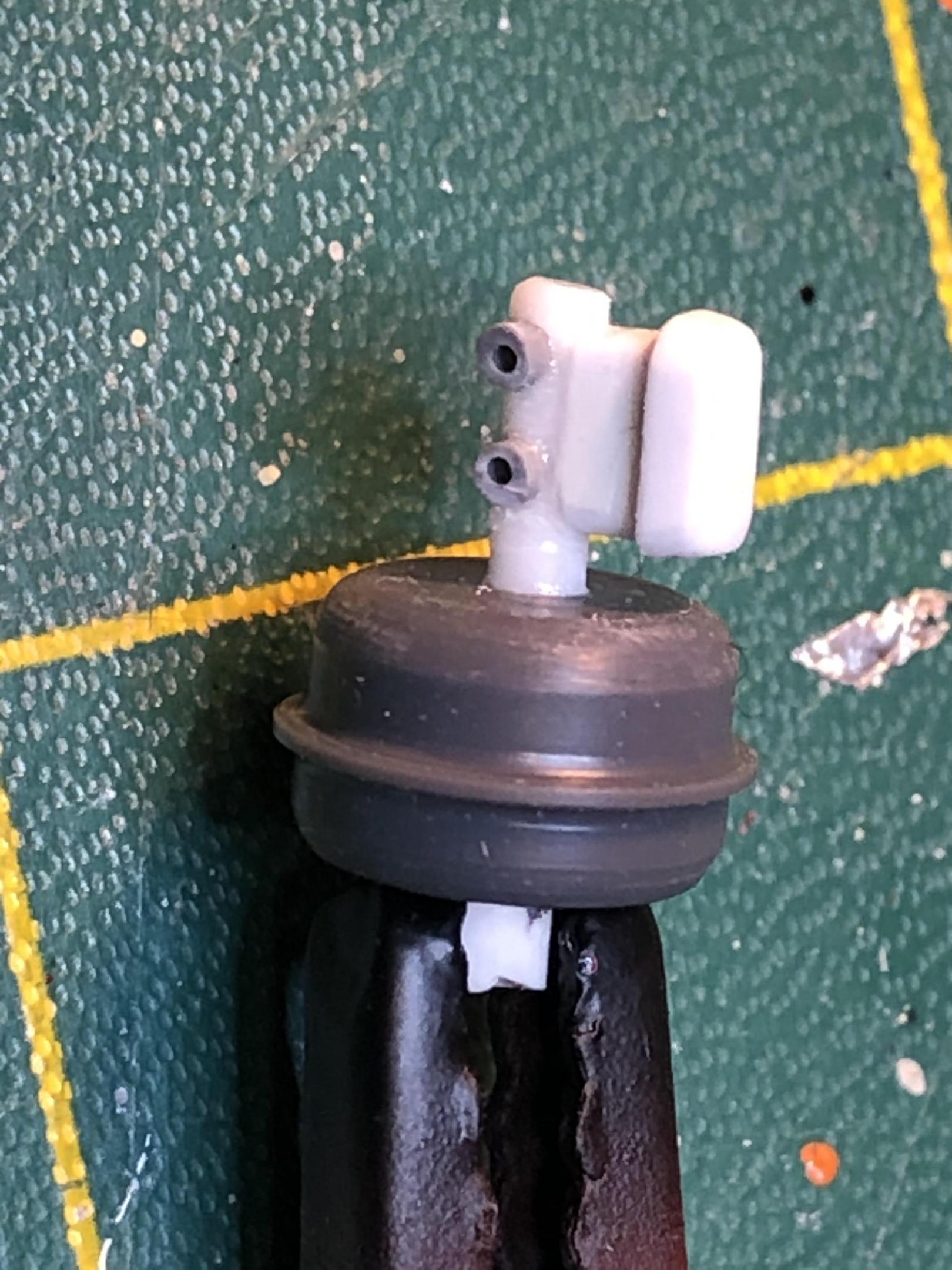

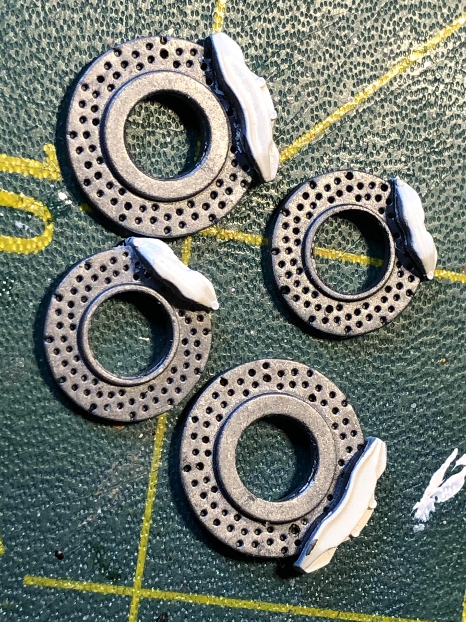

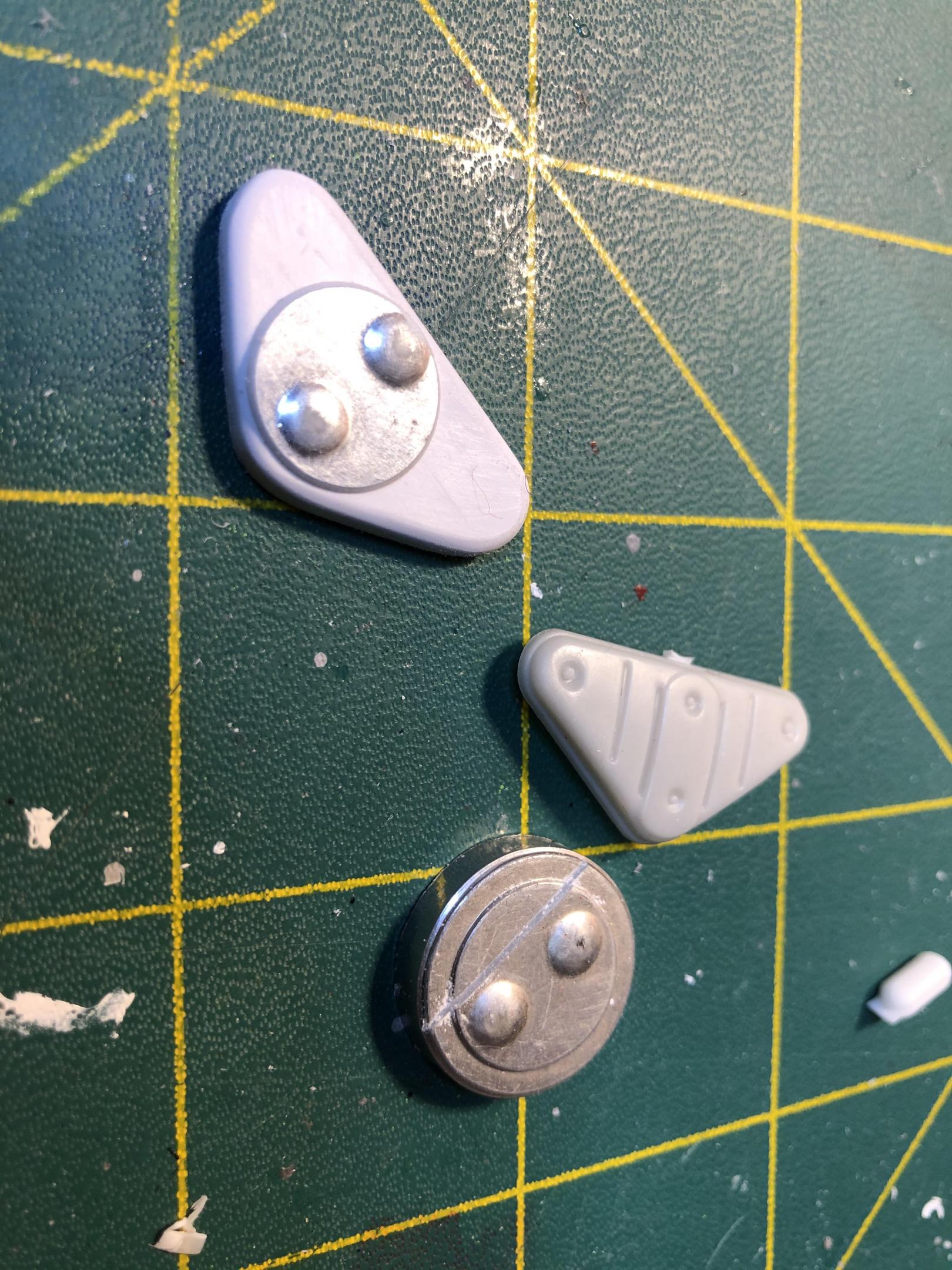

bill-e-boy Posted September 26, 2020 Author Share Posted September 26, 2020 Machined adaptors for the disc brakes and glued to wheel backs Painted the discs with gunmetal and the calipers in off white which is the contrasting colour I did not like the kit power brake booster so some time on the lathe to turn up a chamber and the rest made from various shapes made up to suit This was also painted with off white Quote Link to comment Share on other sites More sharing options...

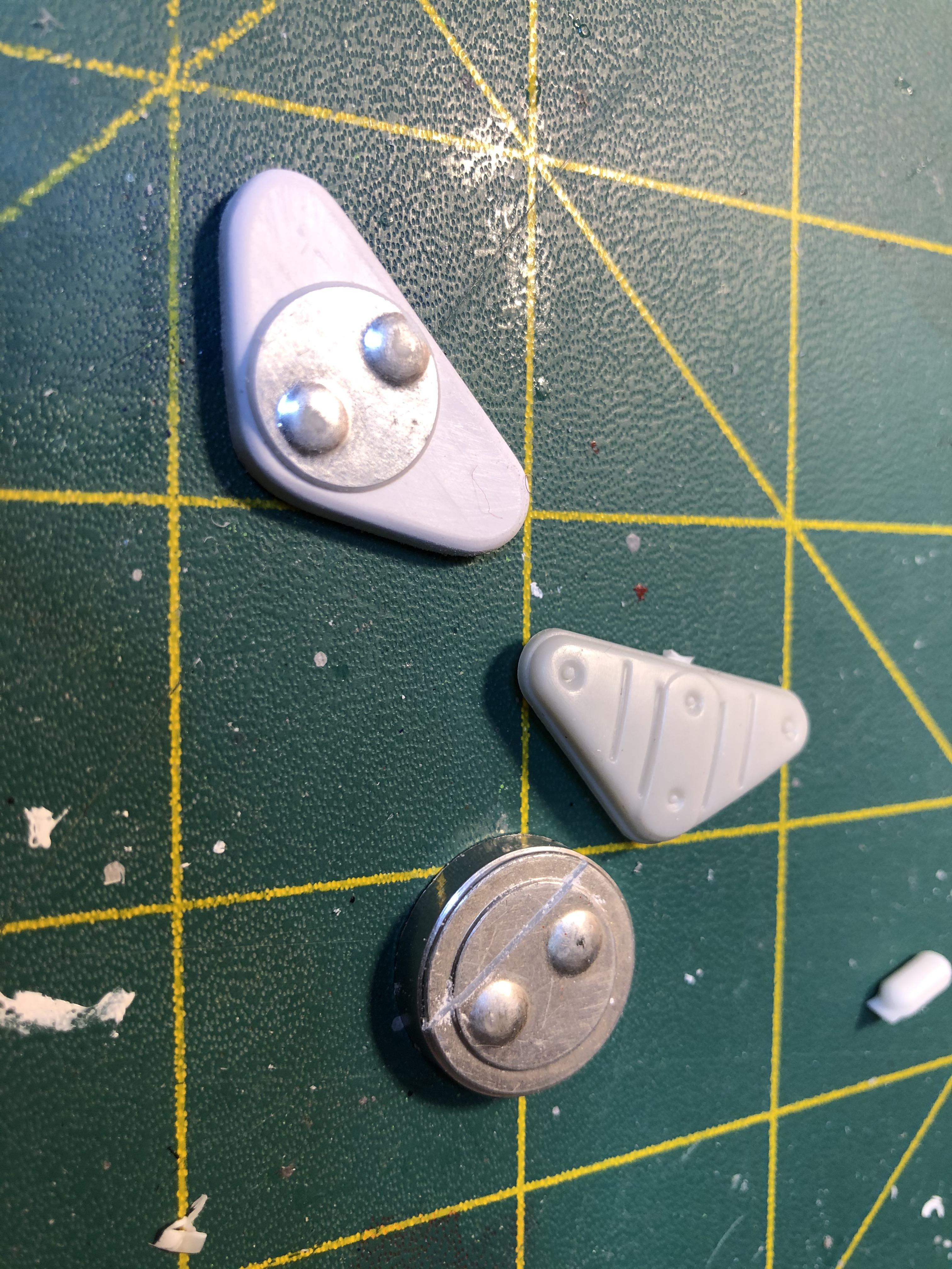

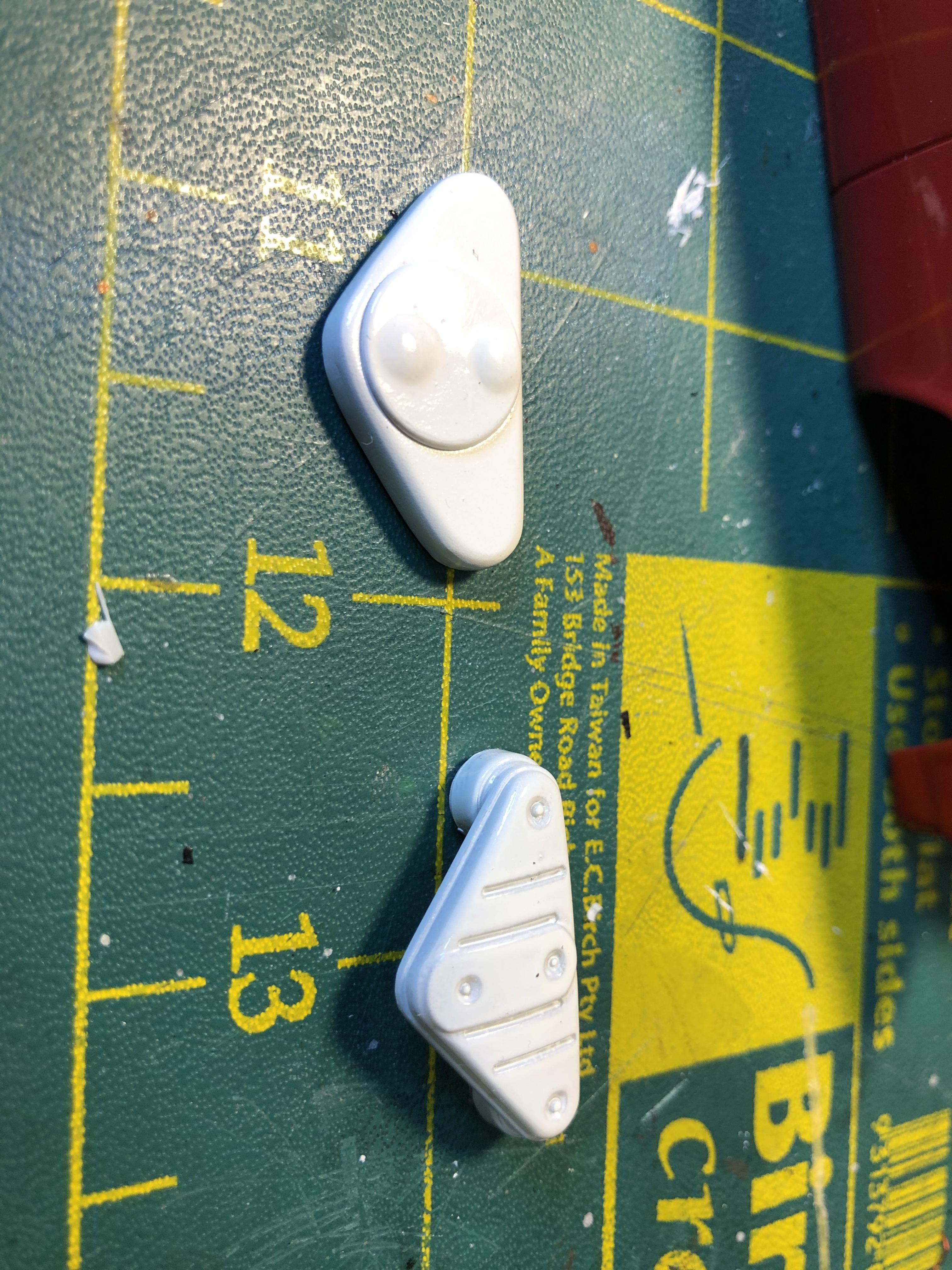

bill-e-boy Posted September 26, 2020 Author Share Posted September 26, 2020 I was wanting a more modern looking air cleaner than the original oil bath type. I made up a cover on the lines of the original and added the top from an air cleaner from the parts box To show the contrast I painted both in off white so I could see which worked best Quote Link to comment Share on other sites More sharing options...

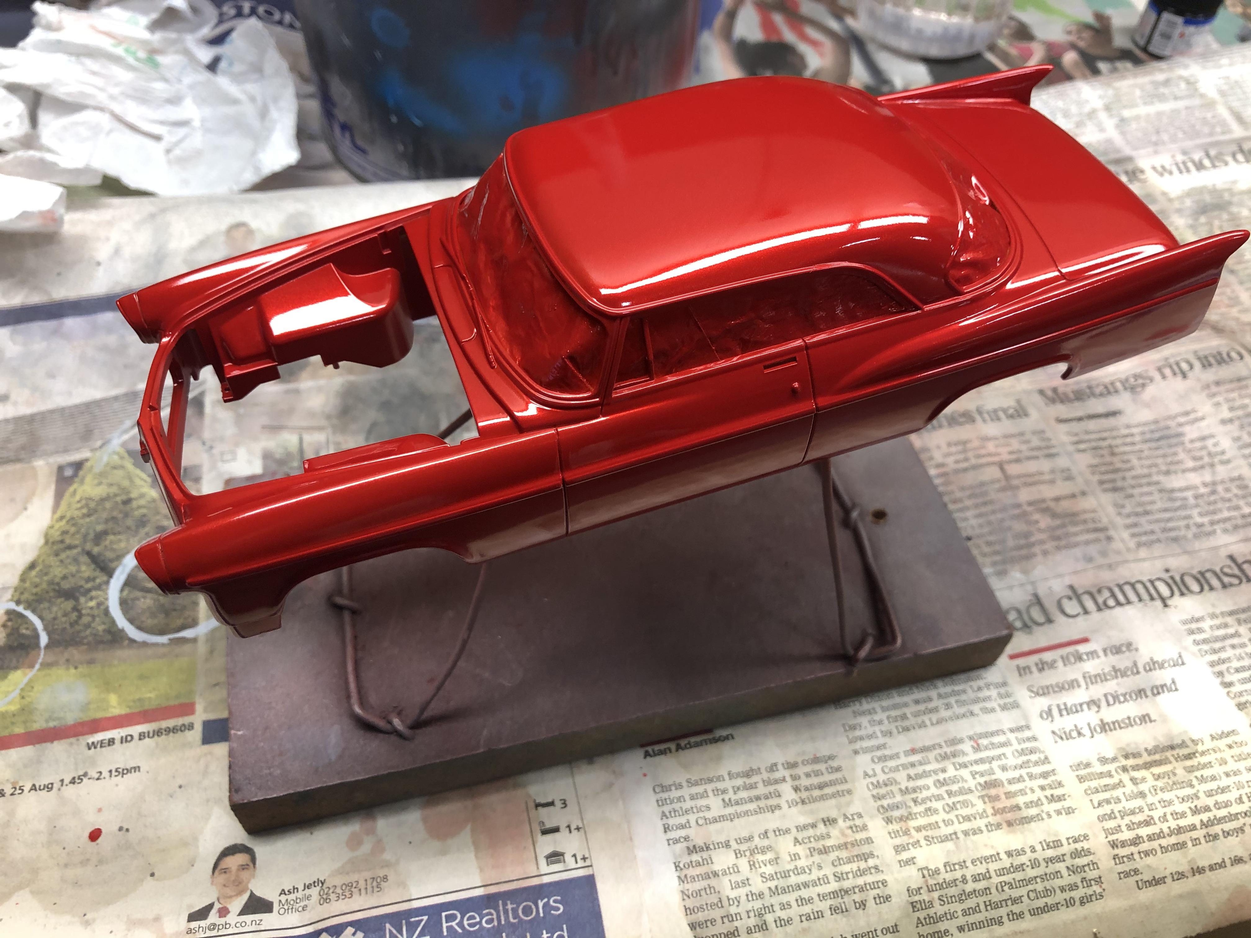

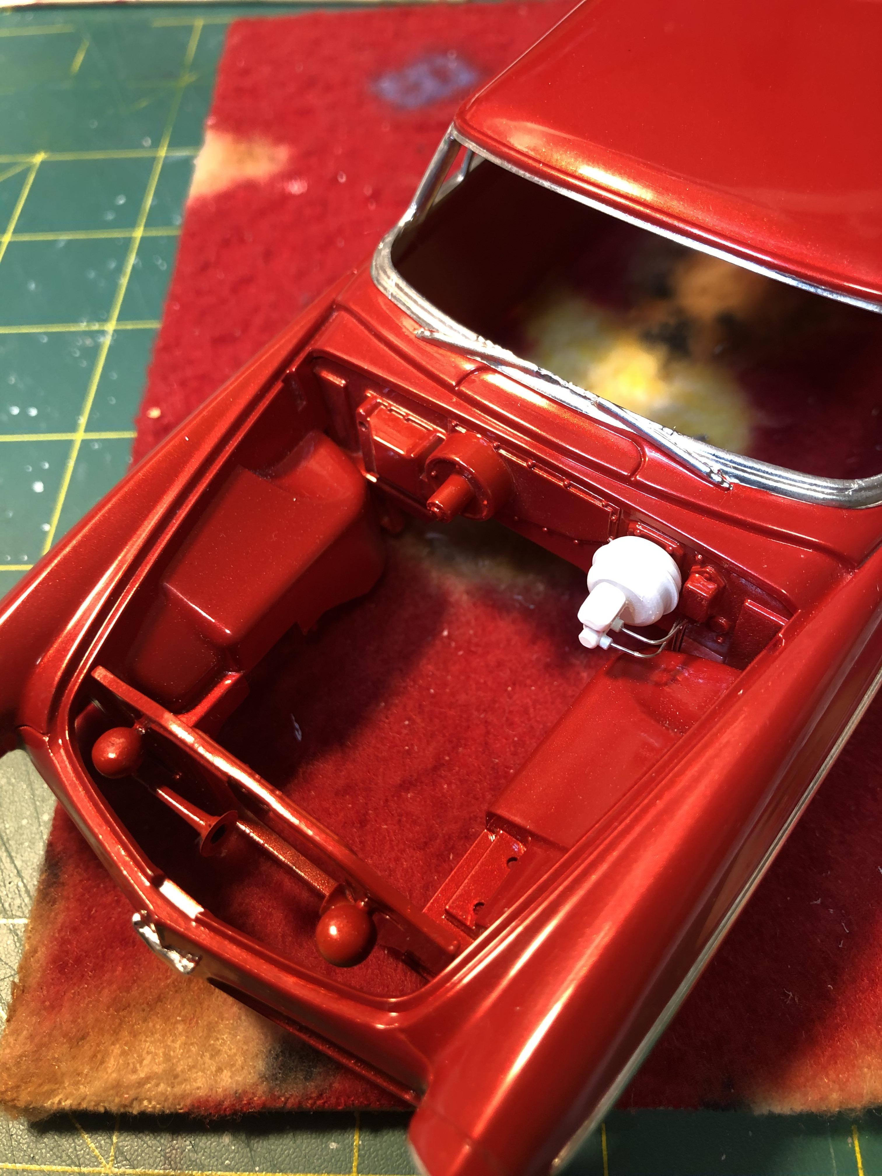

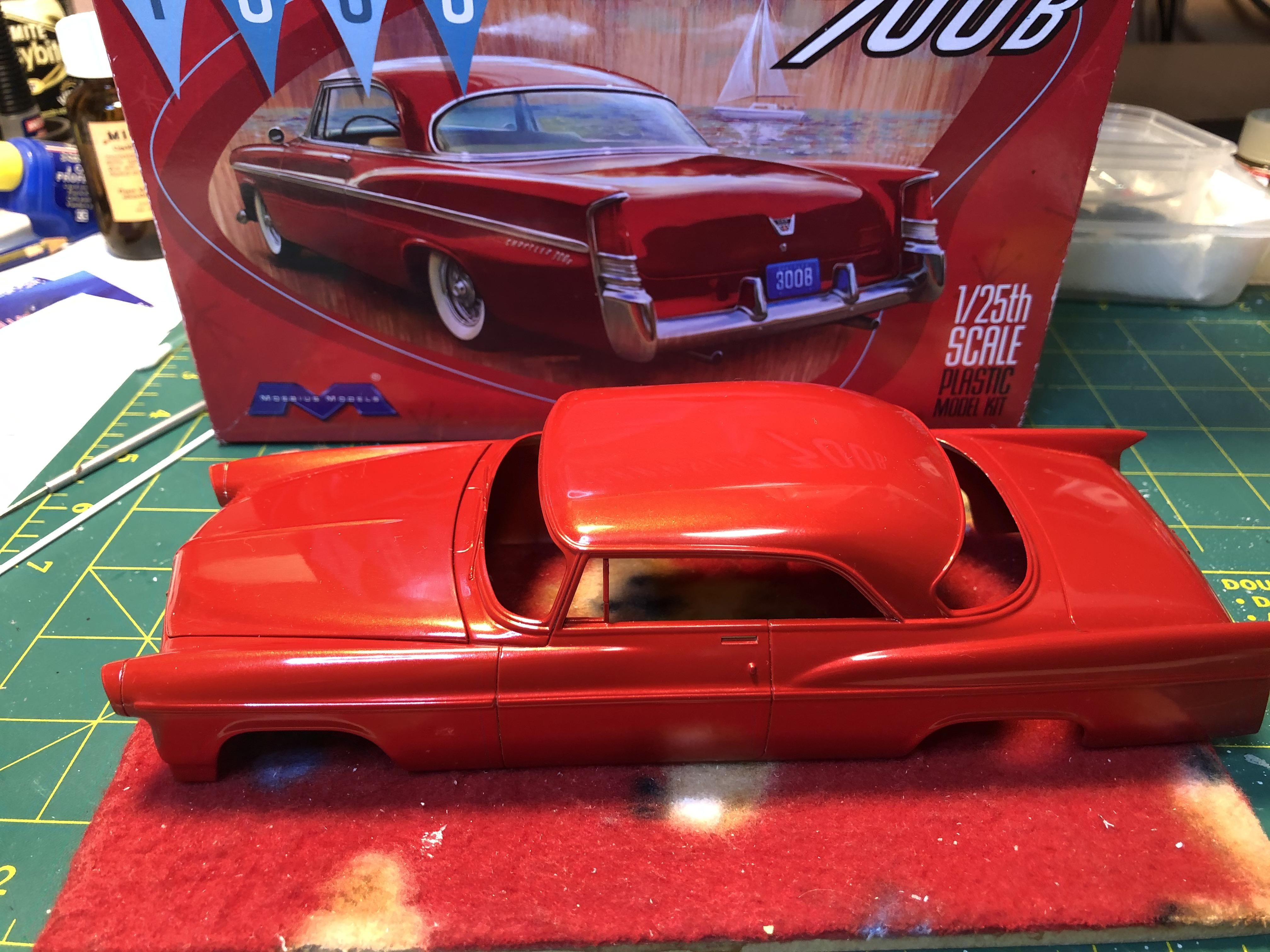

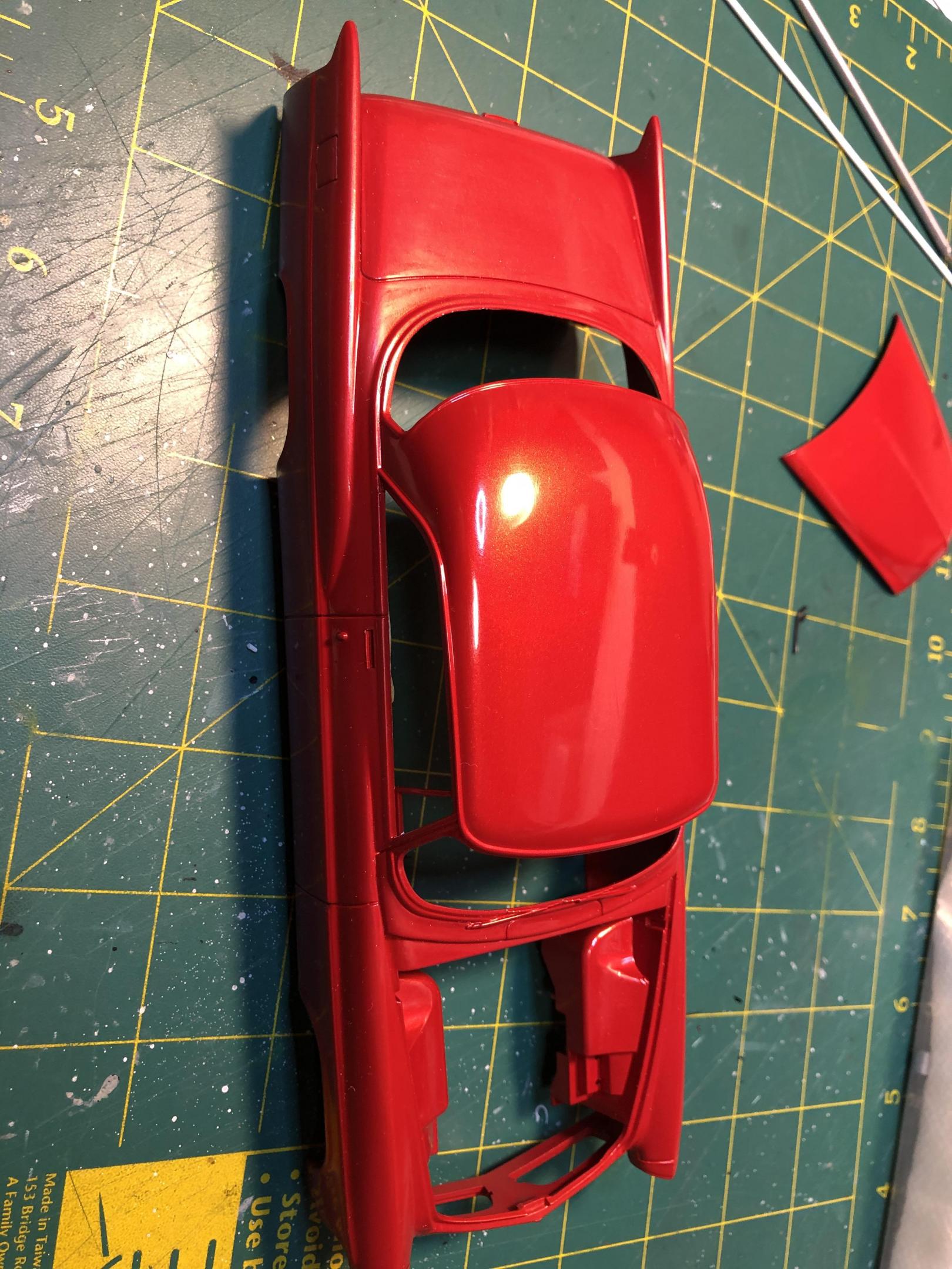

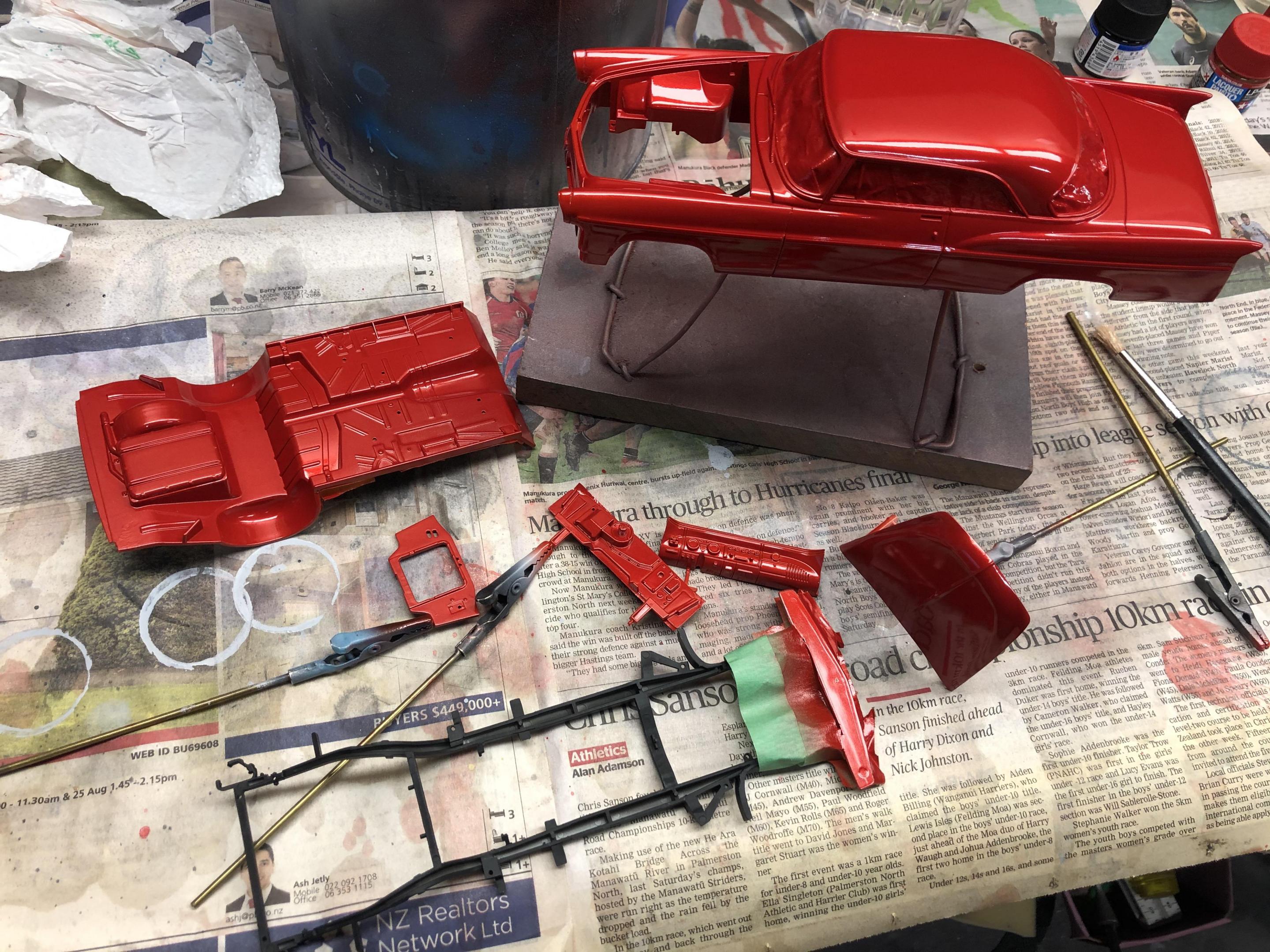

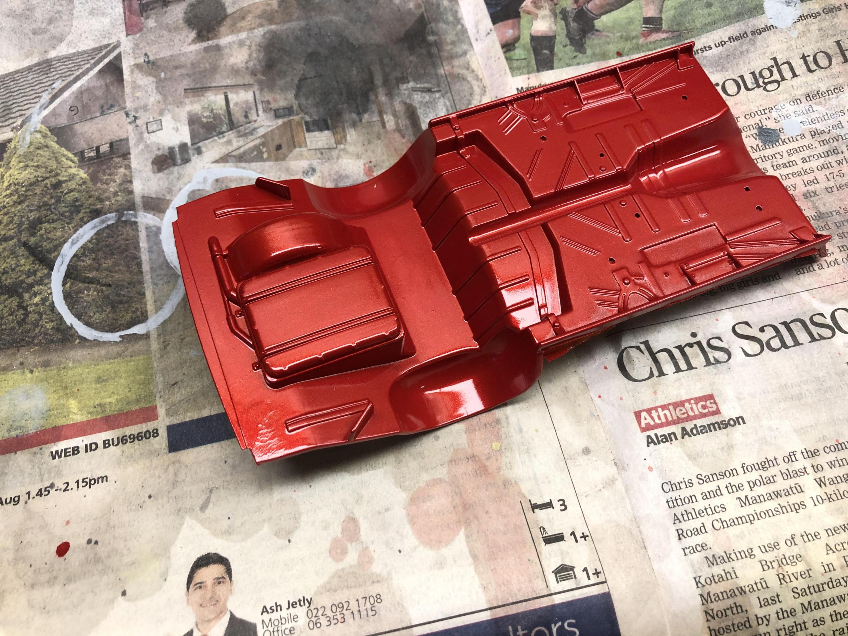

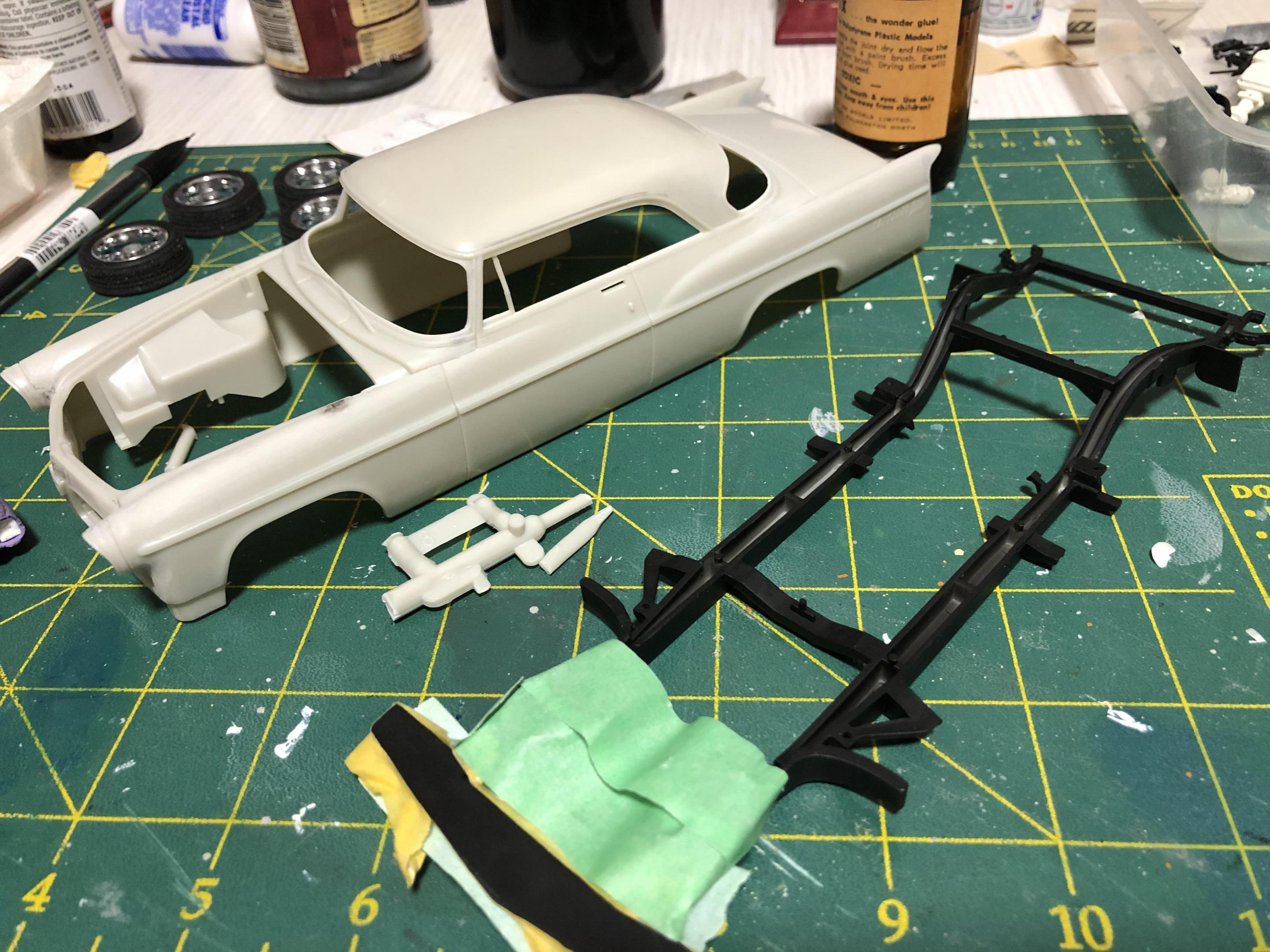

bill-e-boy Posted October 9, 2020 Author Share Posted October 9, 2020 Got some paint on The chassis is semi-gloss black. Pix shows splash apron top masked up for body color on the top as it shows through the grill and I wanted it to match up with the body color. The other pix a body and underside getting color on. Paint is Tamiya Mica Red laqueur in the little jars. All color clear coated with Tamiya as well. Its a nice product to use and I get good results. What am I going to do with all the Testors enamel jars I have. Quote Link to comment Share on other sites More sharing options...

bill-e-boy Posted October 10, 2020 Author Share Posted October 10, 2020 One thing I have to say is I had to spend an awful amount of time cleaning up the moulding lines on the body. They are faint but they are there all the same and need attention Quote Link to comment Share on other sites More sharing options...

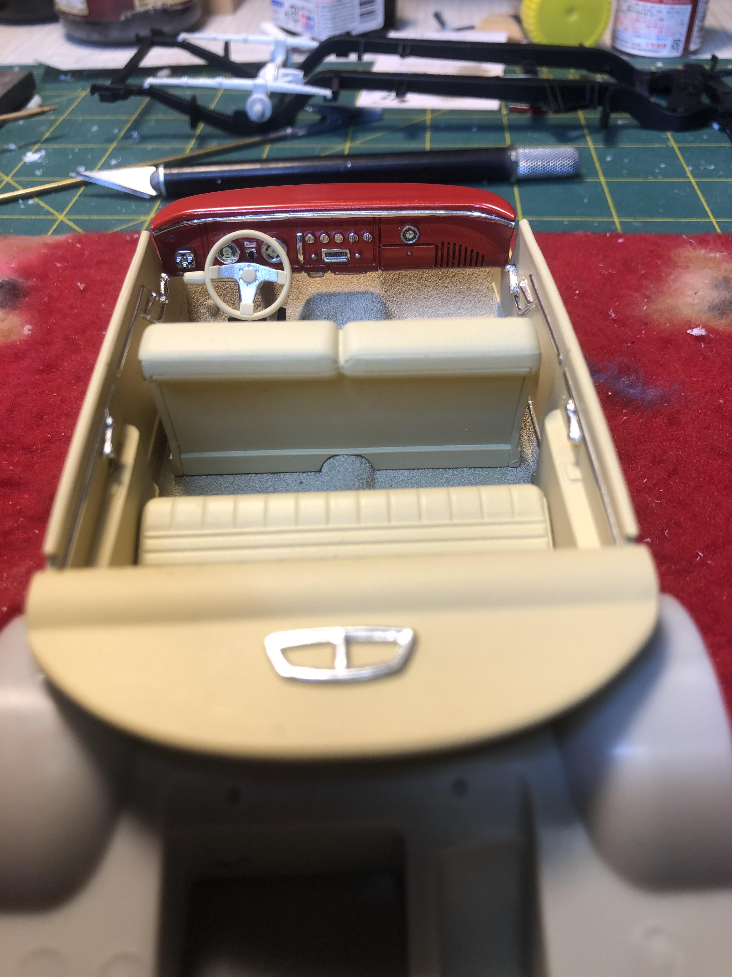

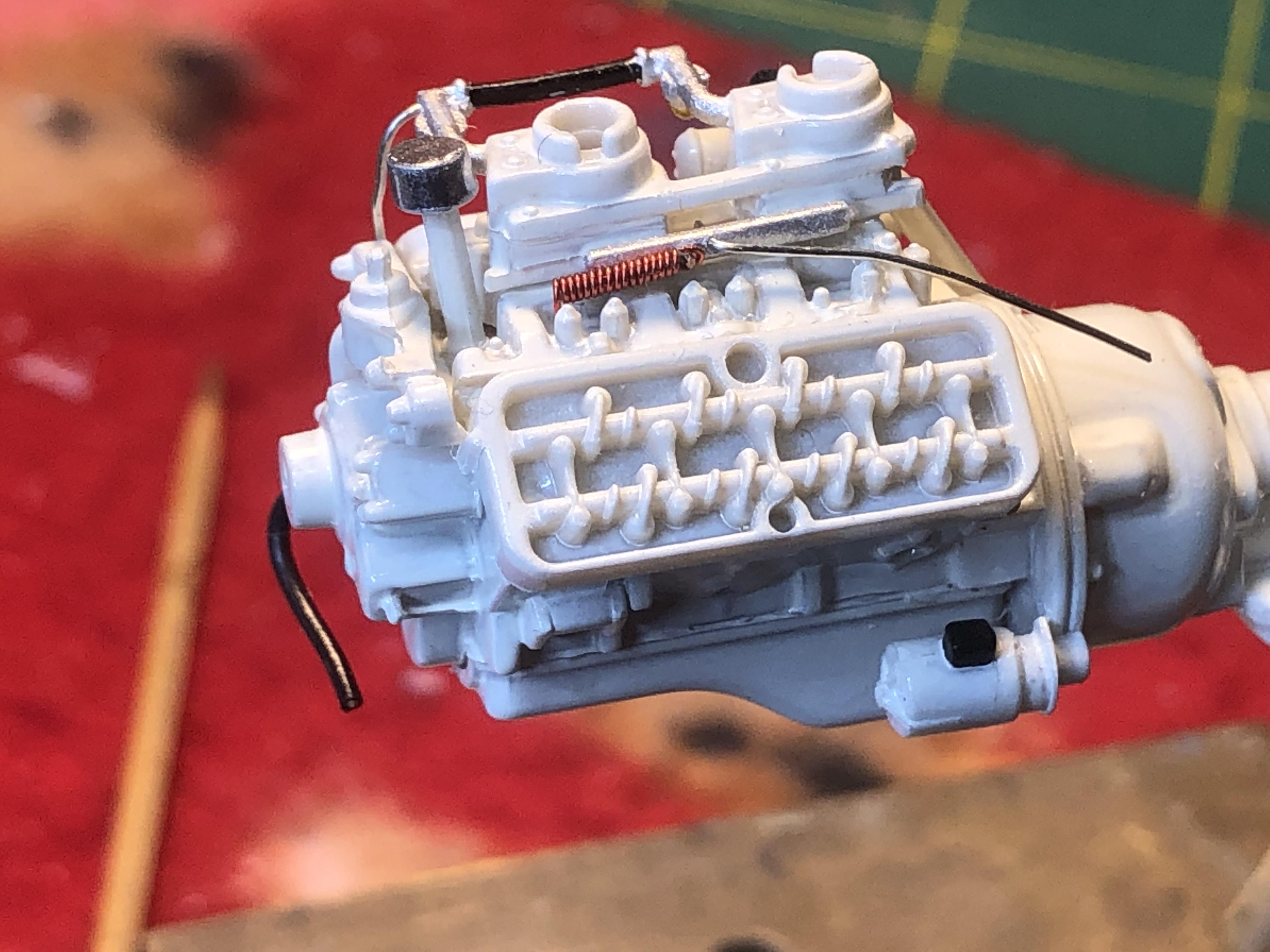

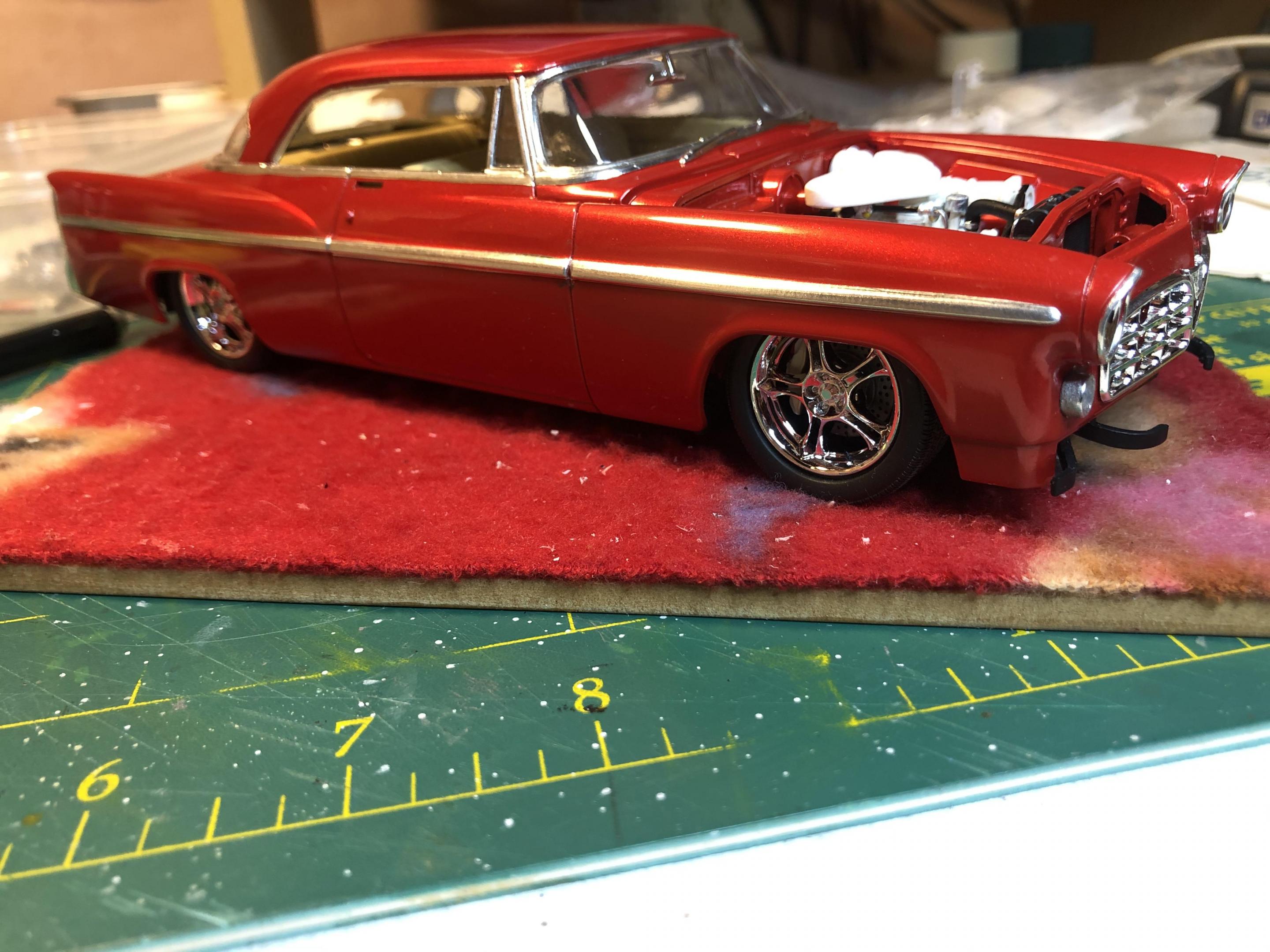

bill-e-boy Posted April 6, 2021 Author Share Posted April 6, 2021 A bit of an update Interior complete, engine wired and detailed, mounted in chassis. Chassis complete with suspensions and exhaust added. Some lines added to chassis It is low, real low - not even bagged. I lowered rear with lowering blocks and spring relocation. Front end lowered with dropped spindles Paint done and rubbed out and waxed. Presently foiling and getting ready to detail badges and other little things Quote Link to comment Share on other sites More sharing options...

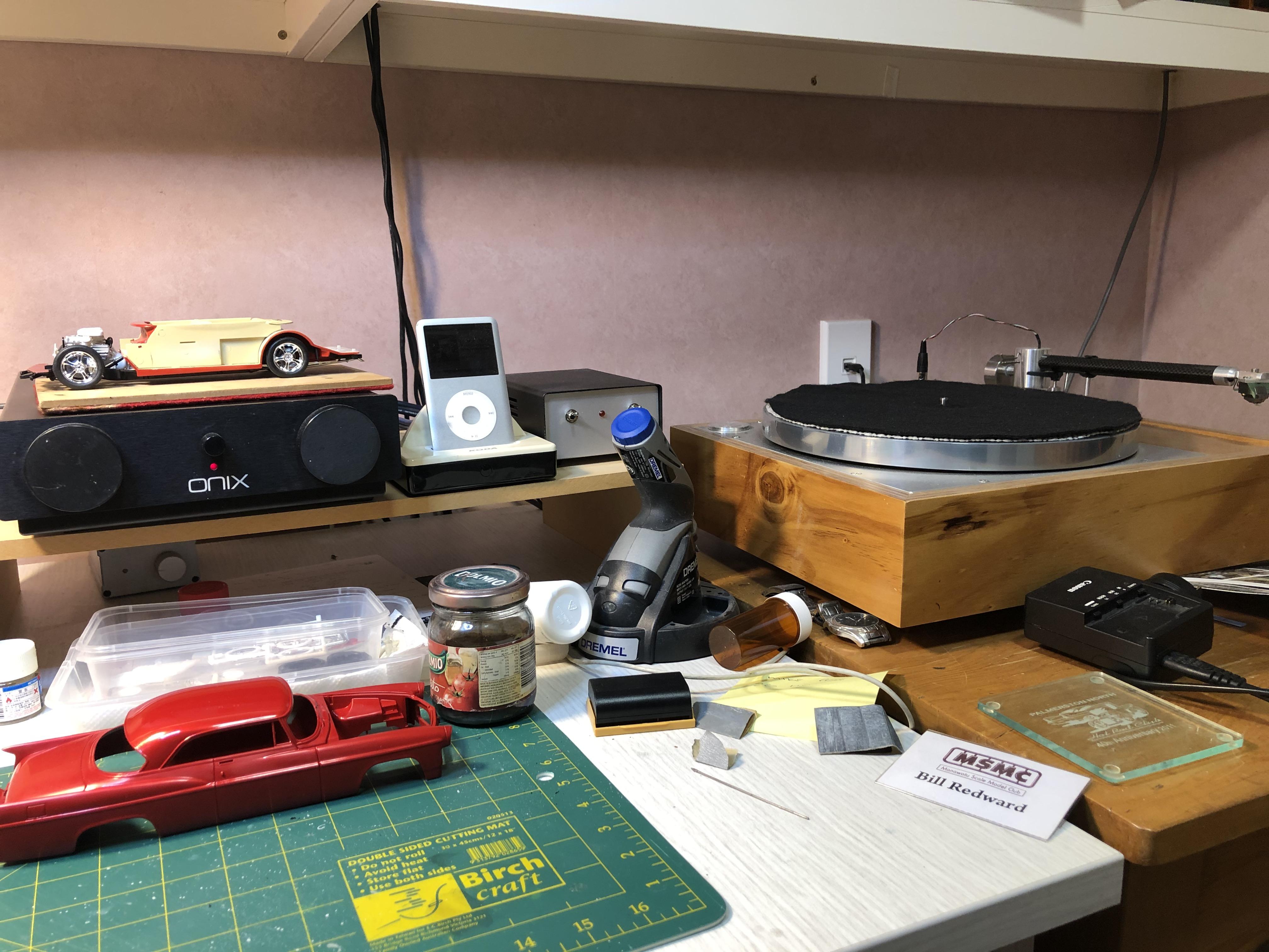

bill-e-boy Posted April 6, 2021 Author Share Posted April 6, 2021 And a background shot of my workbench and environs Quote Link to comment Share on other sites More sharing options...

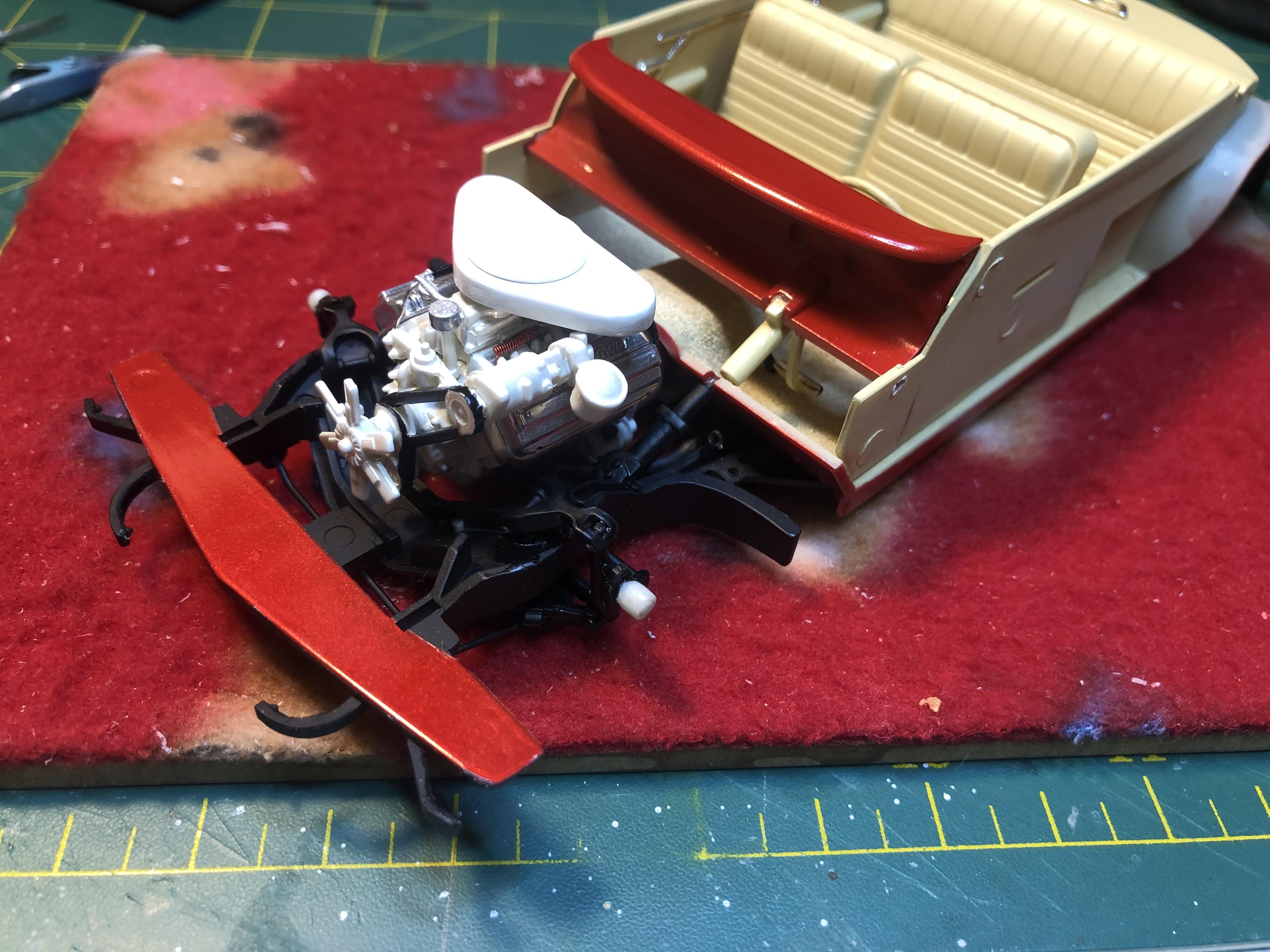

bill-e-boy Posted April 21, 2021 Author Share Posted April 21, 2021 Getting along with final assembly. Firewall and radiator support installed Quote Link to comment Share on other sites More sharing options...

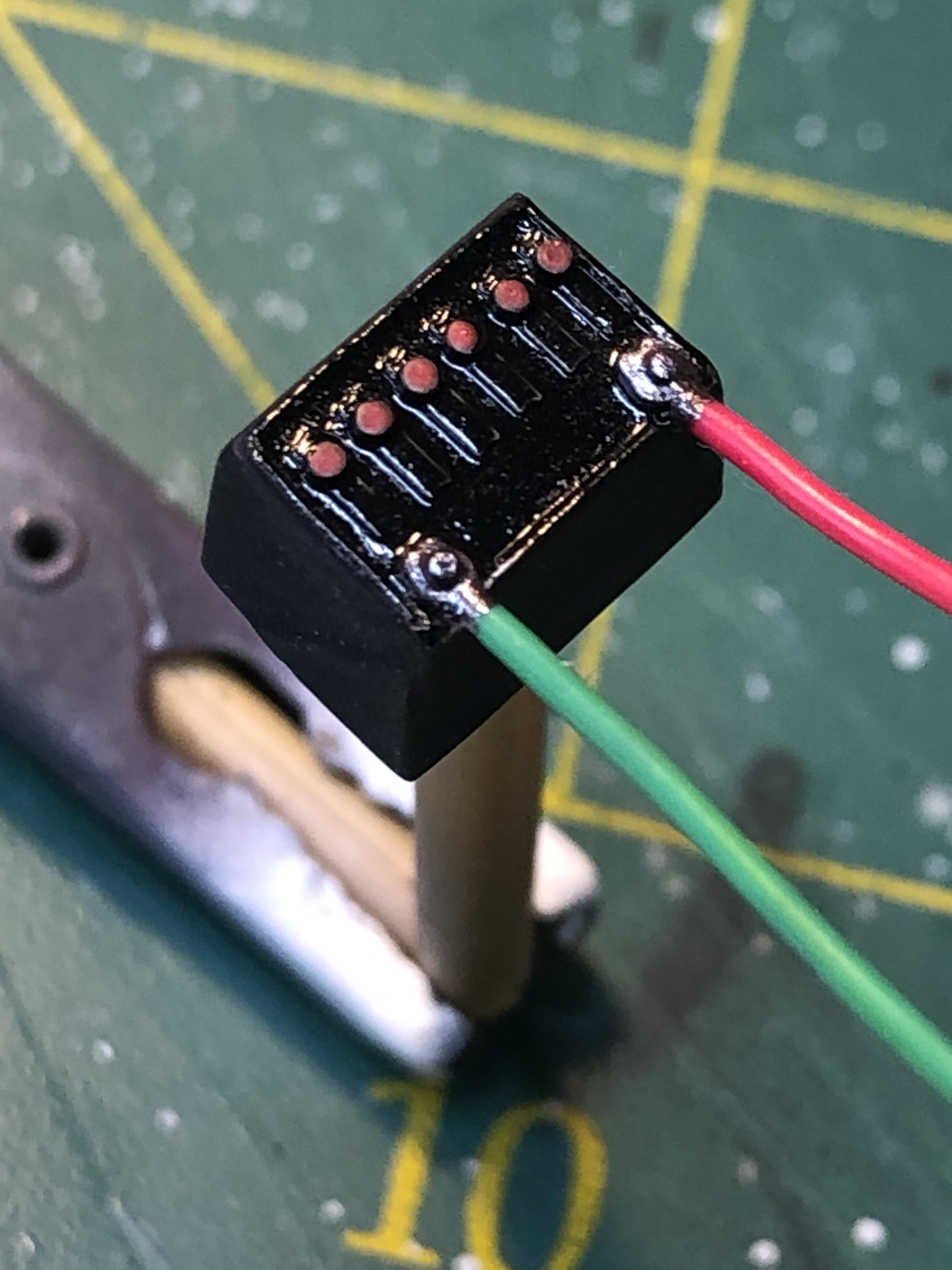

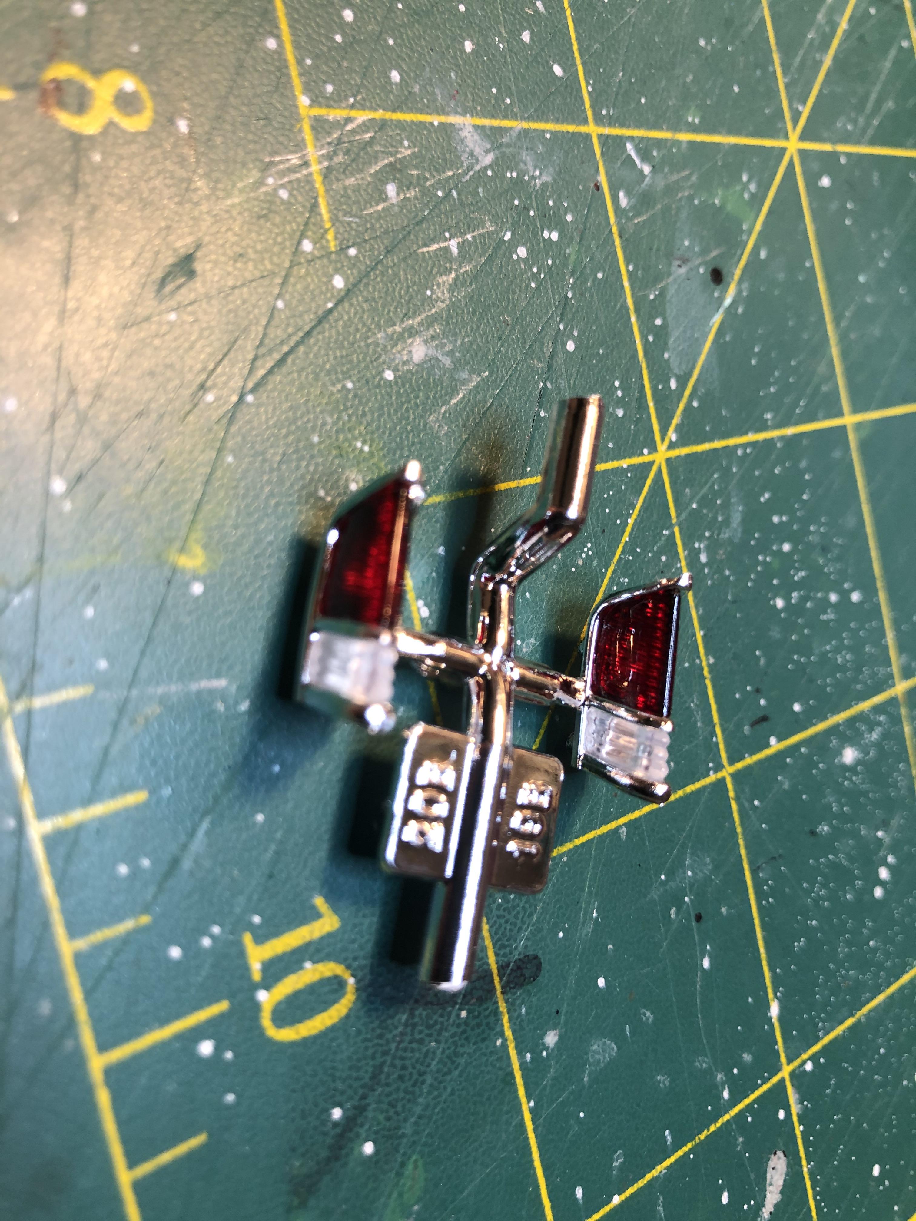

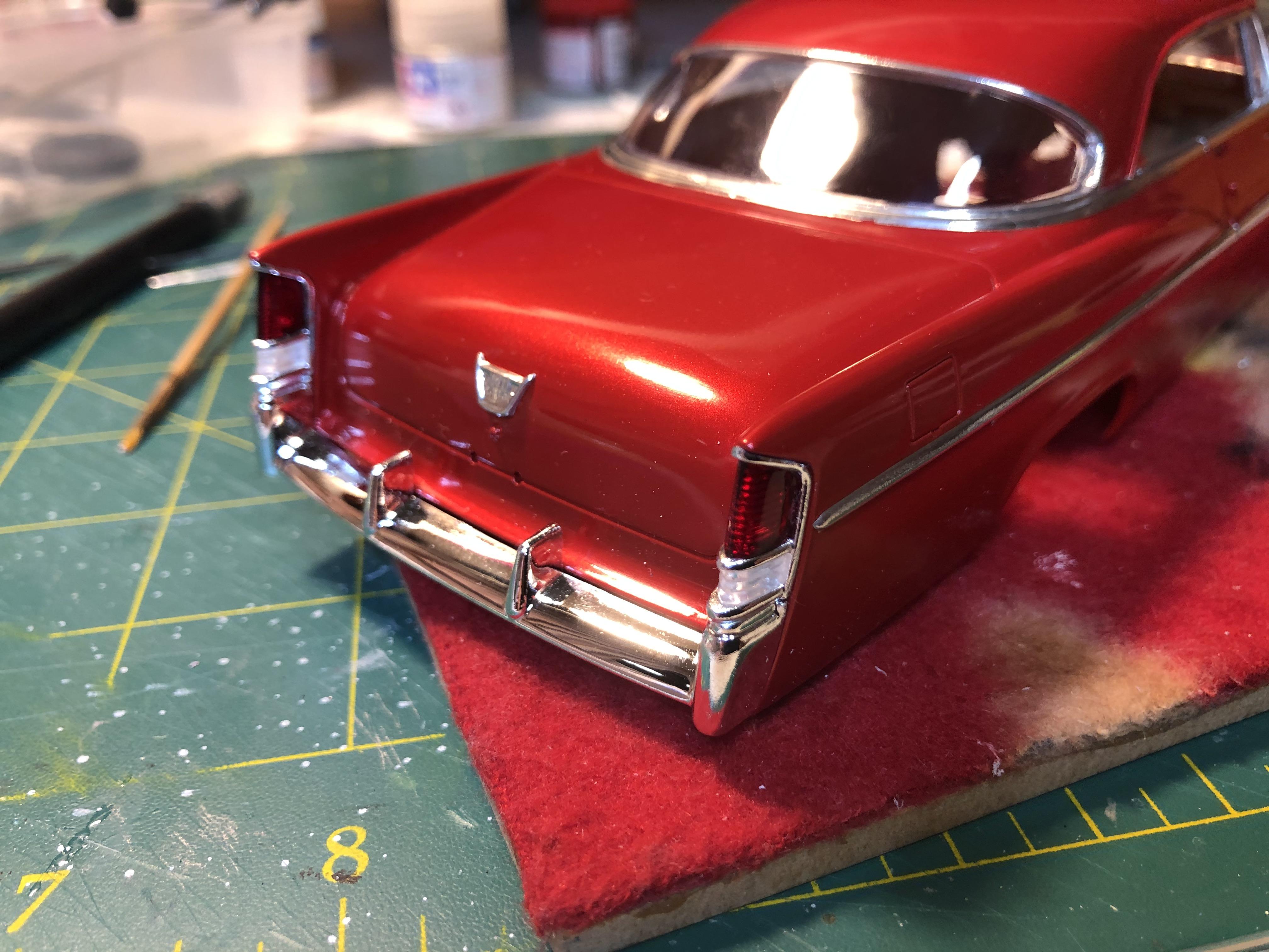

bill-e-boy Posted April 21, 2021 Author Share Posted April 21, 2021 I wasn't happy with the 6V battery so found one in the parts box and detailed it up I am impressed with the tail light detail - looks very real More work getting bling added. I now have parts A and B With a bit of work A+B+C Some more work yet before I get it "Under Glass" but it will be soon Quote Link to comment Share on other sites More sharing options...
