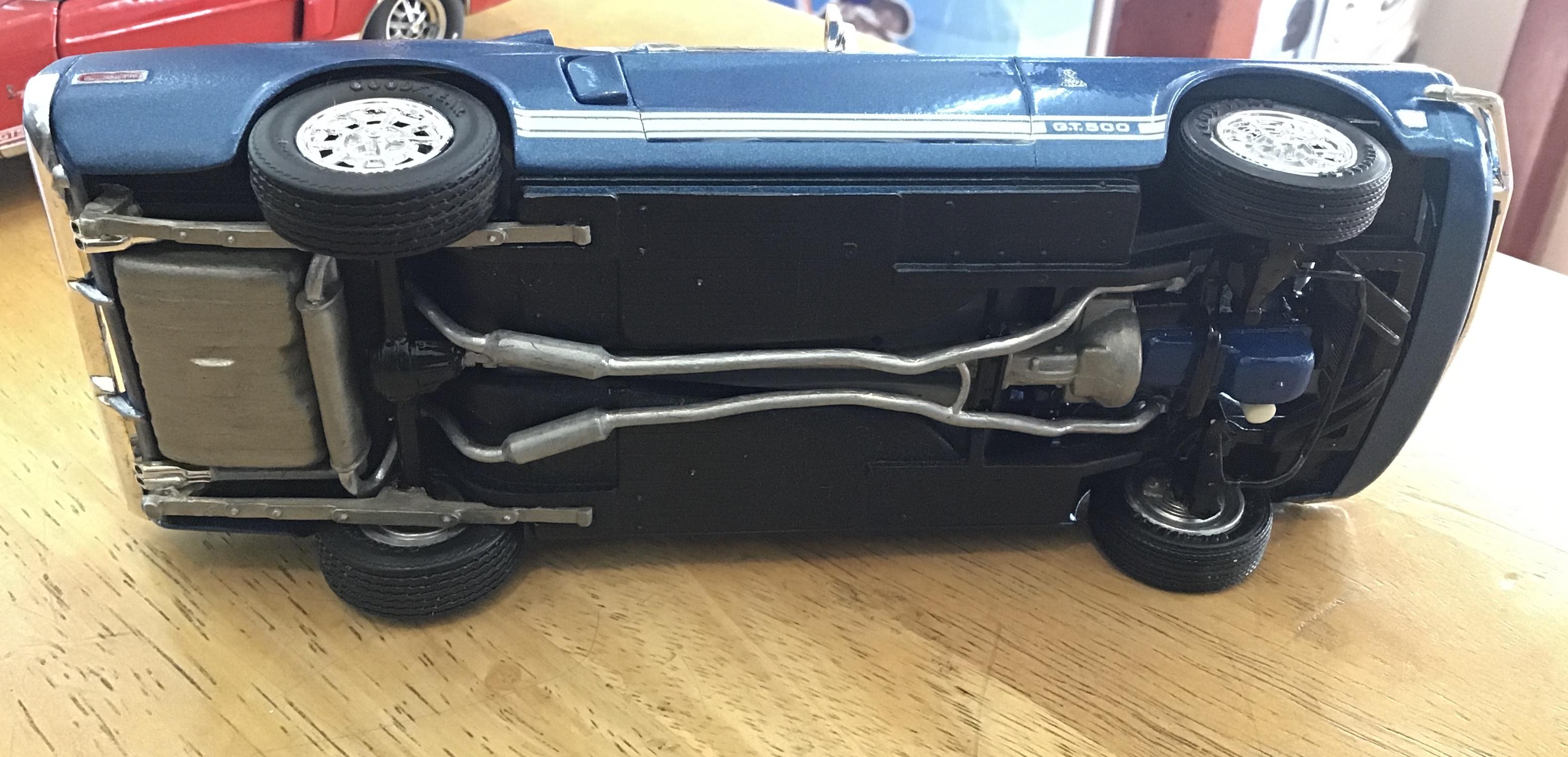

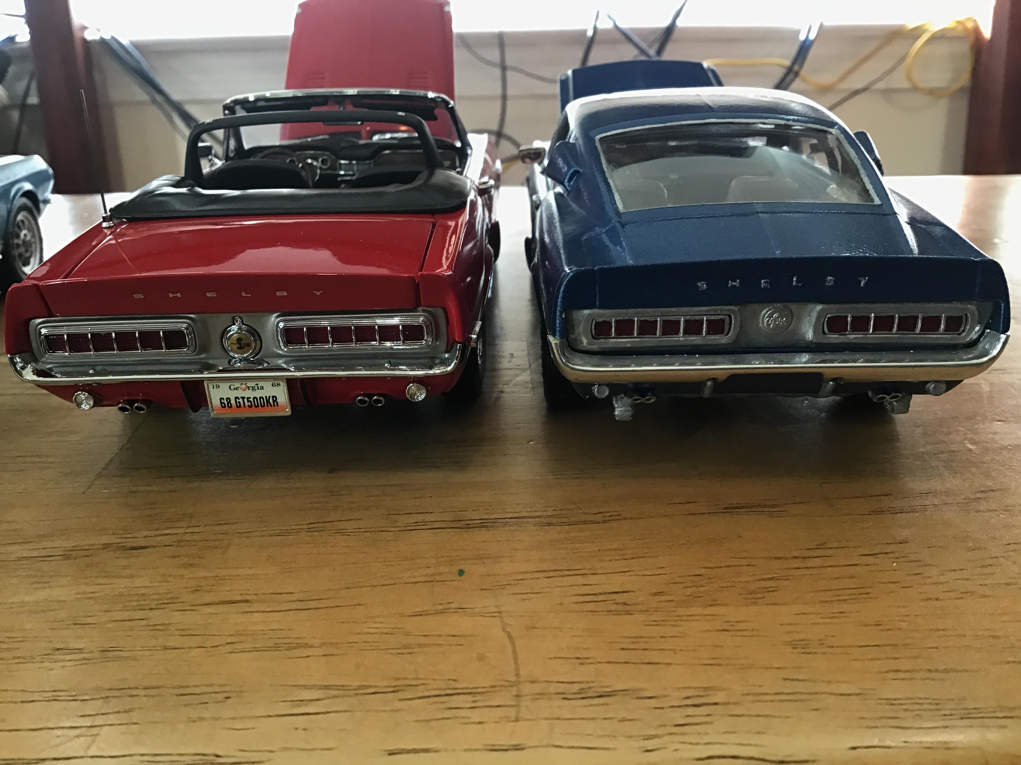

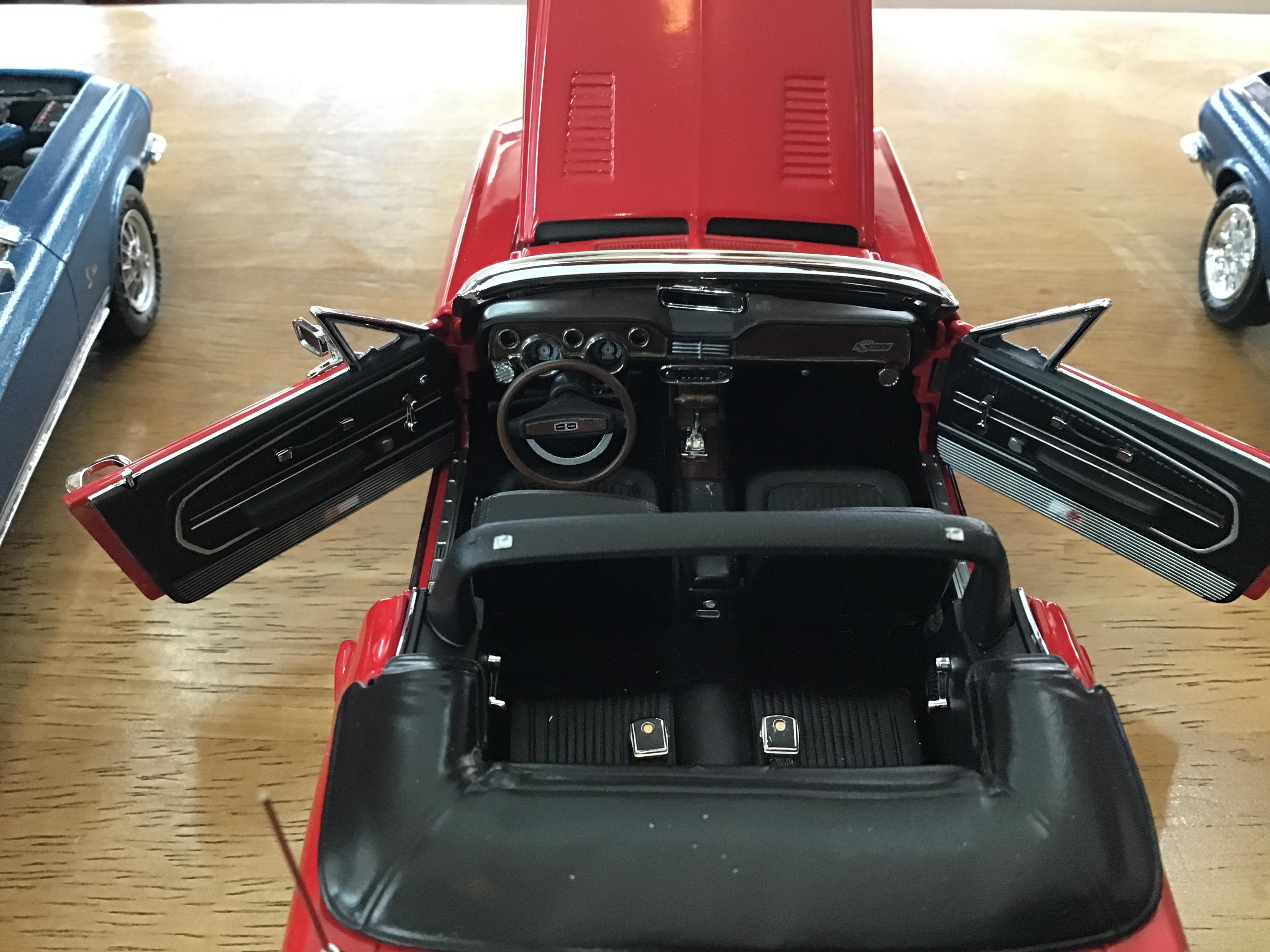

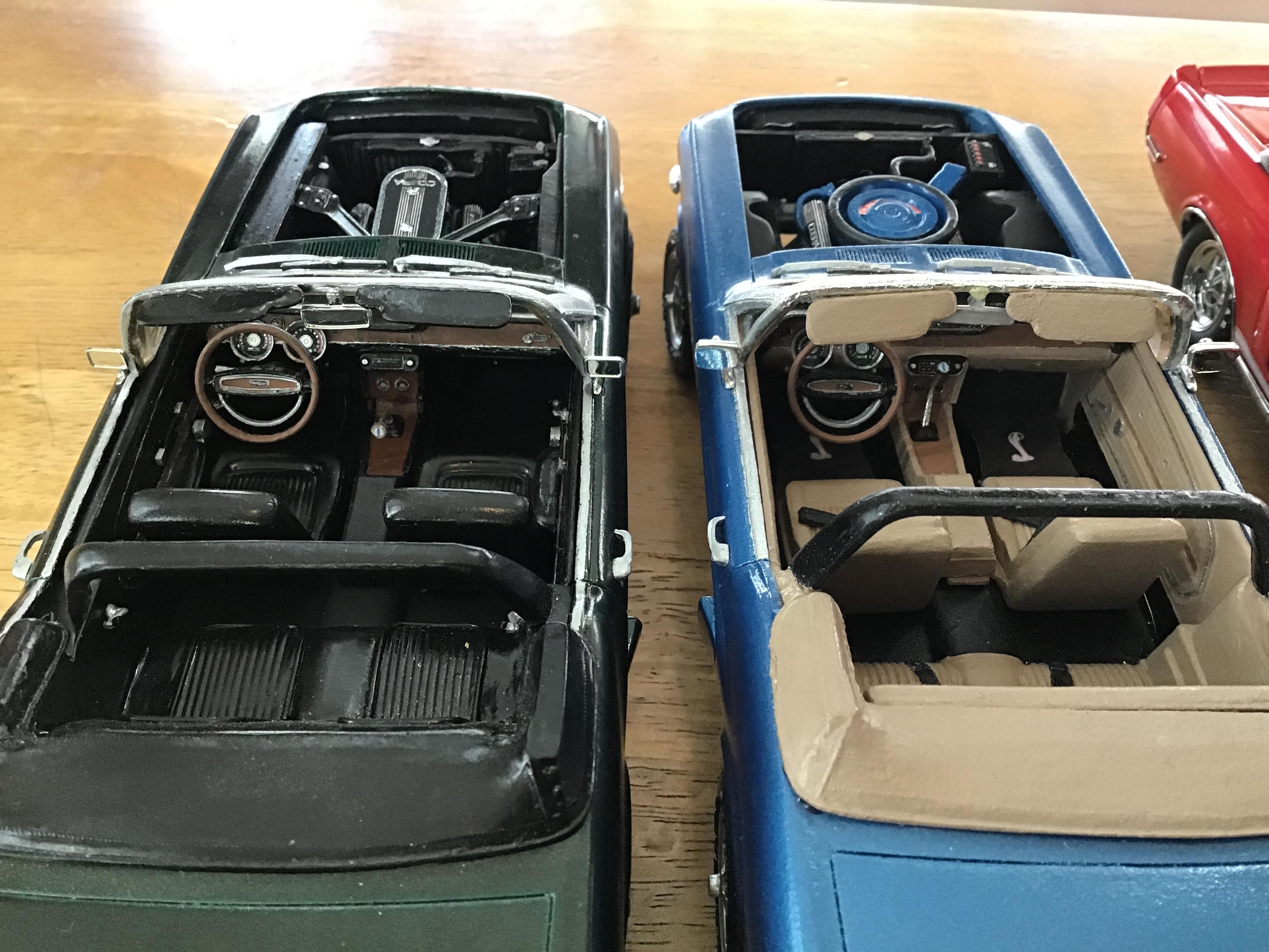

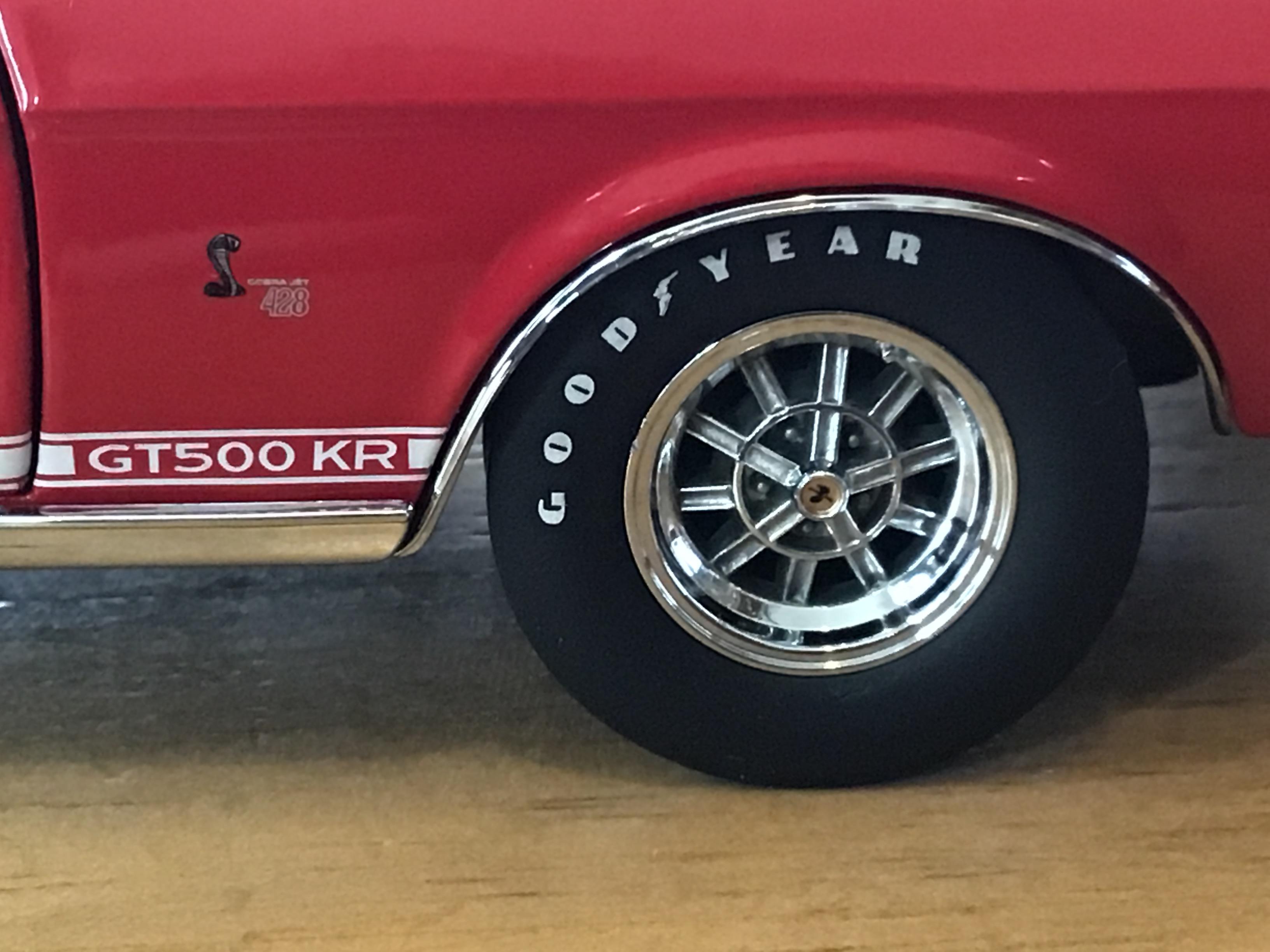

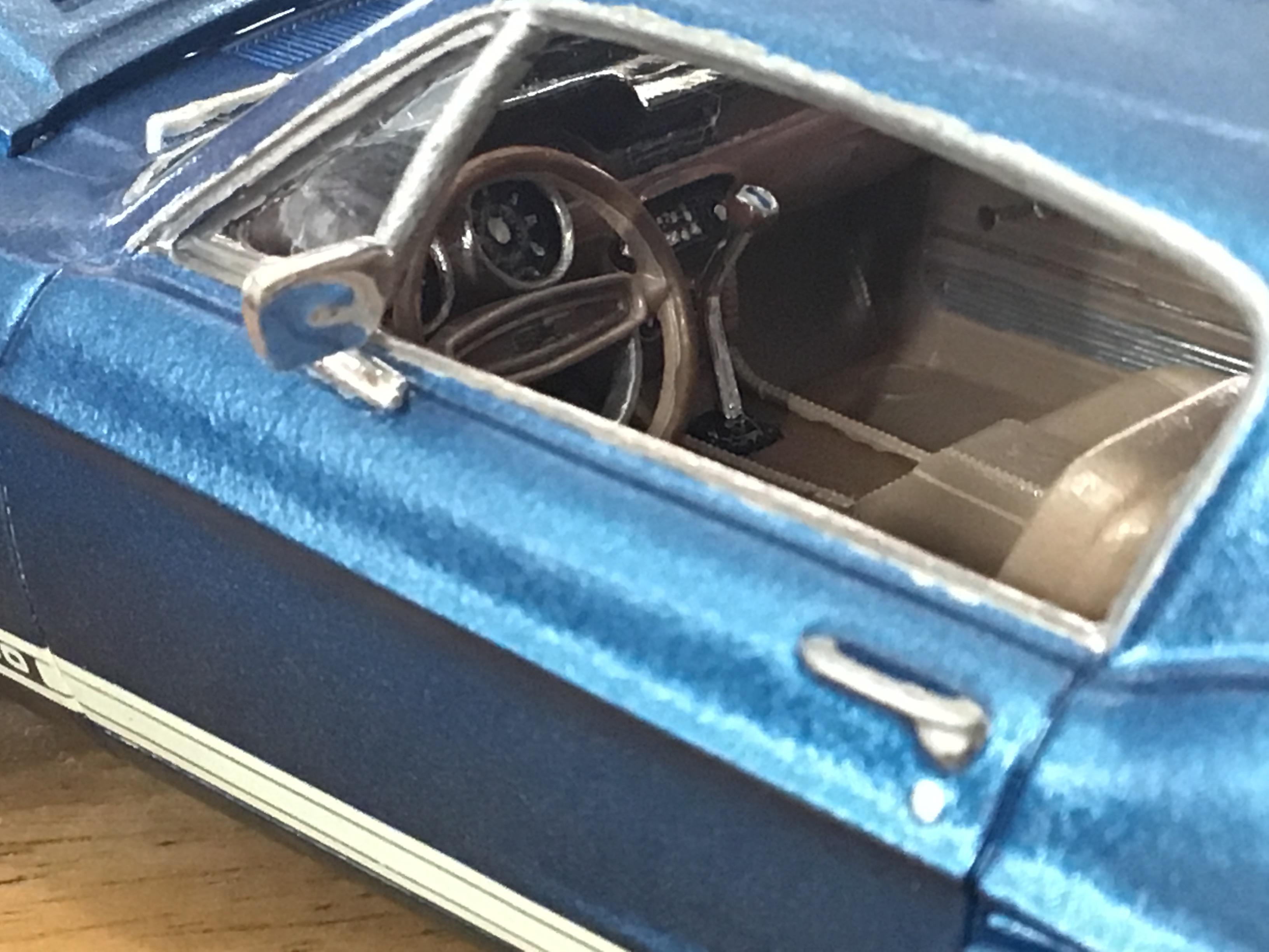

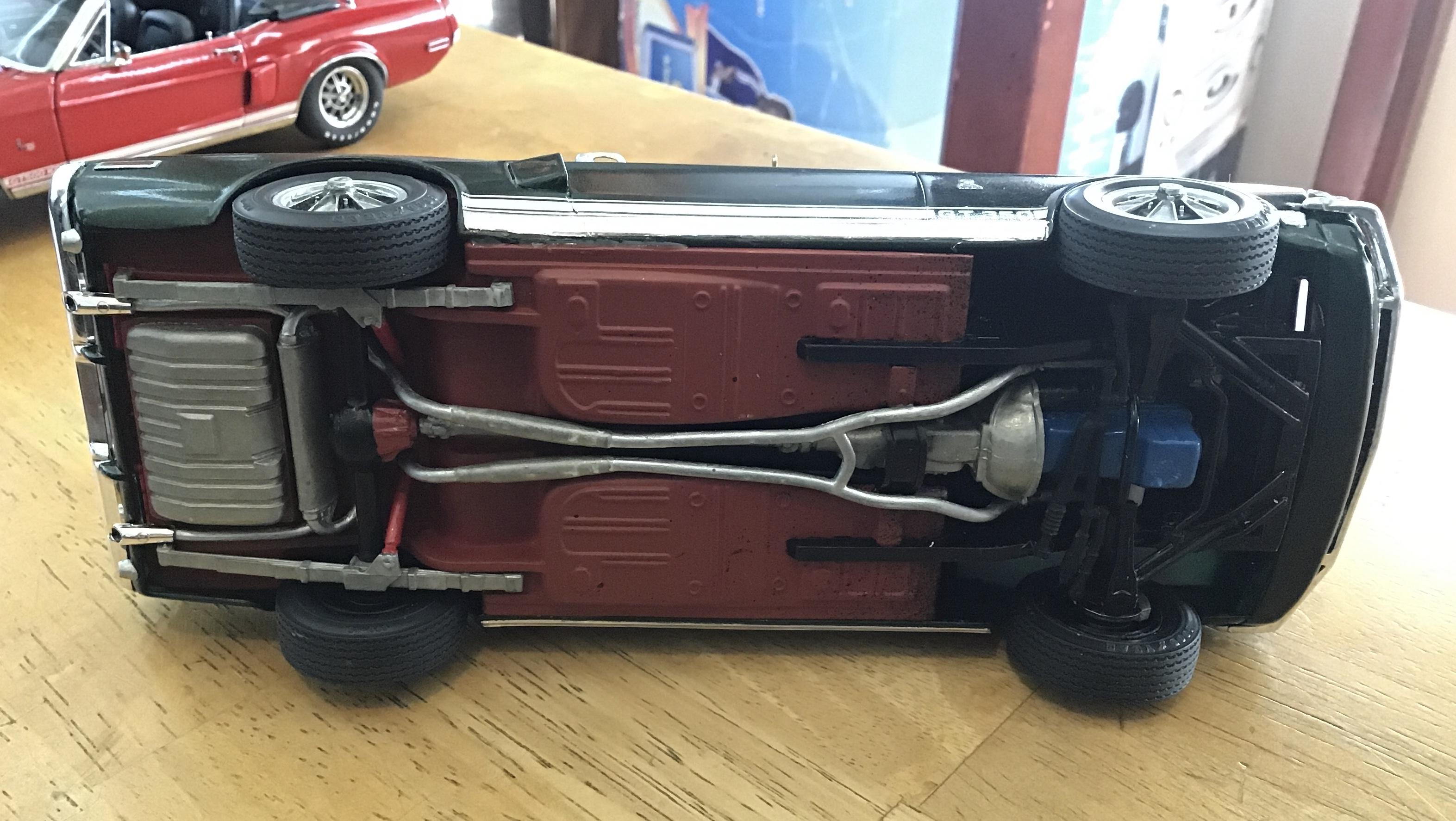

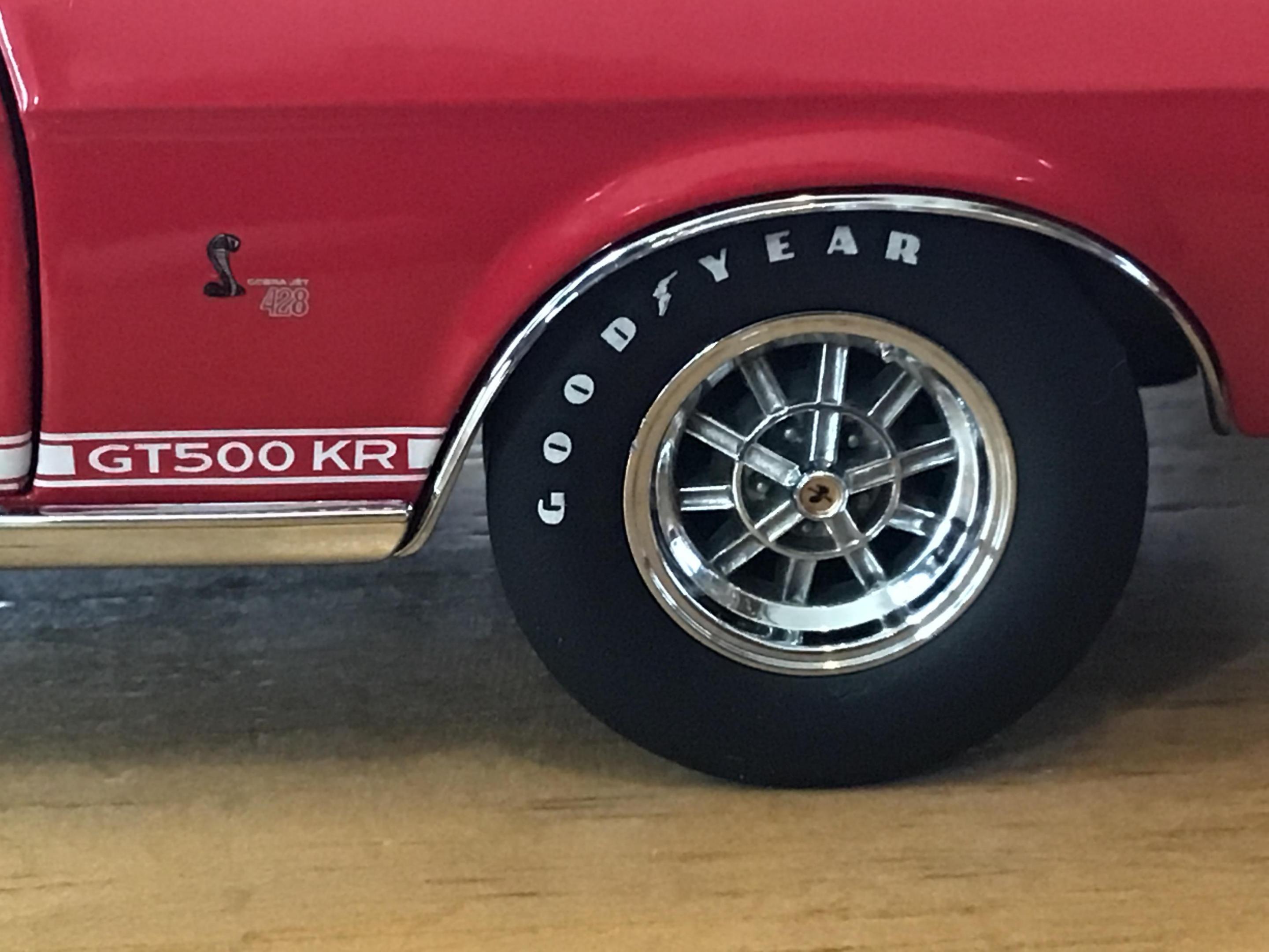

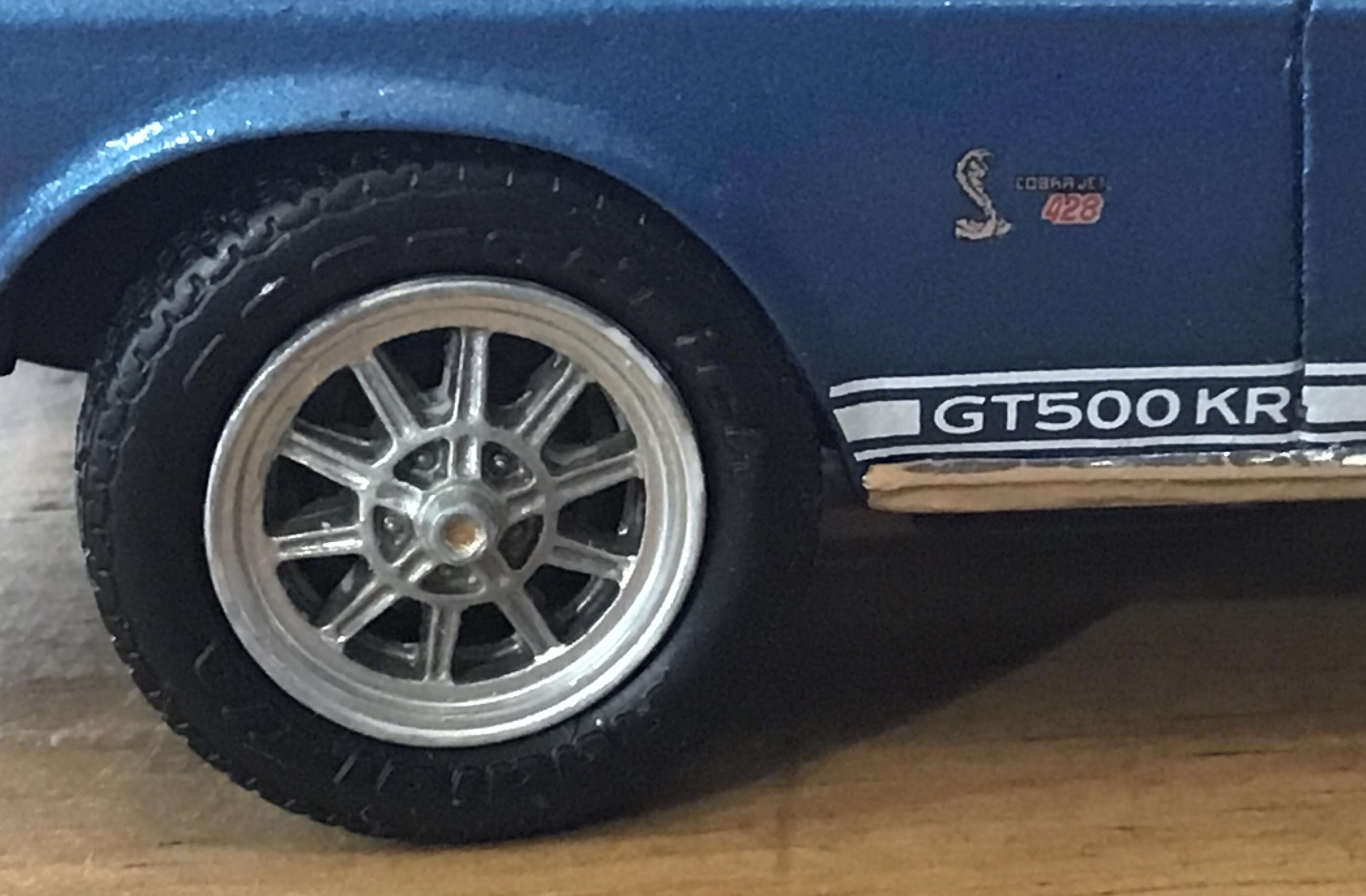

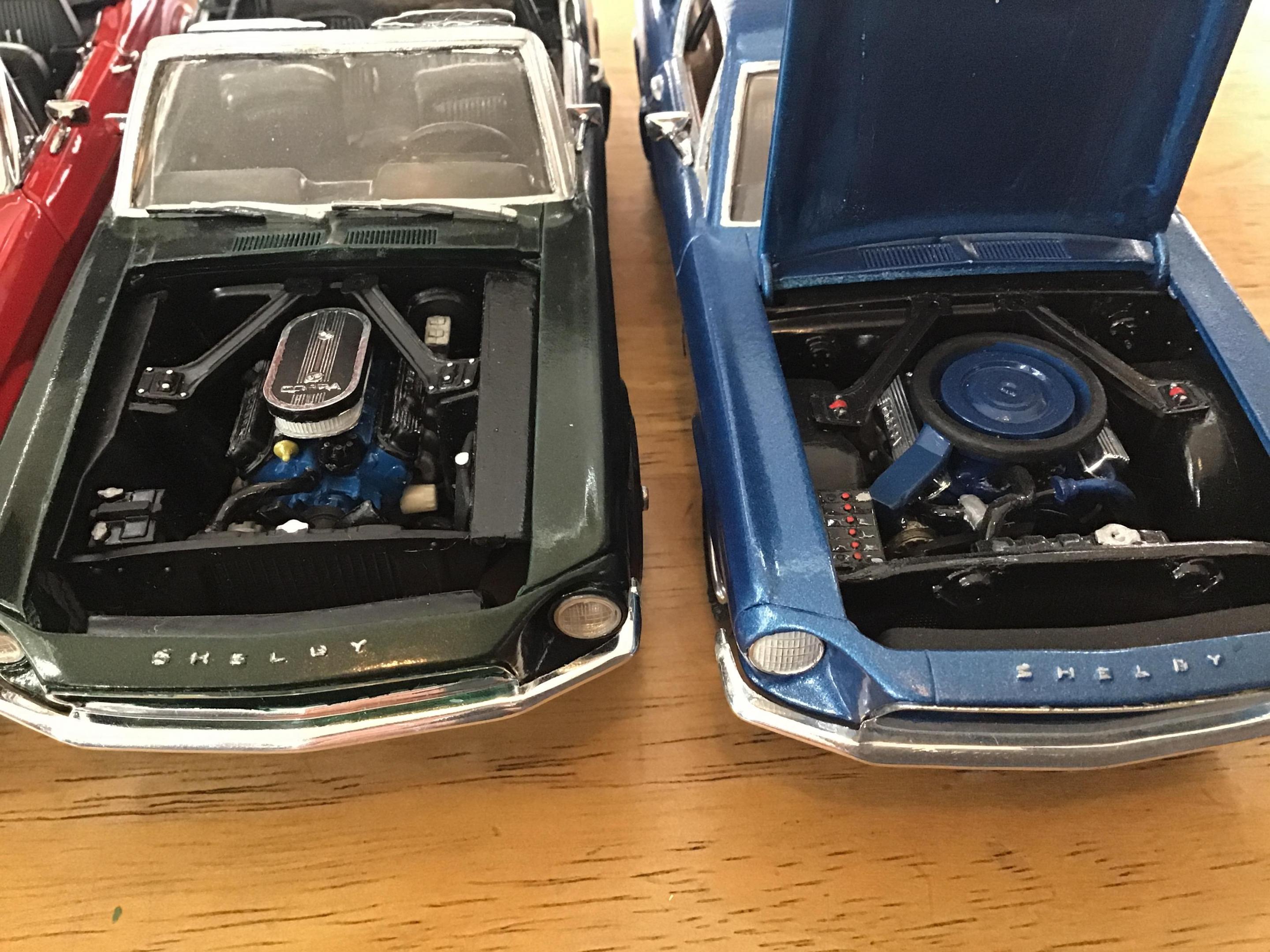

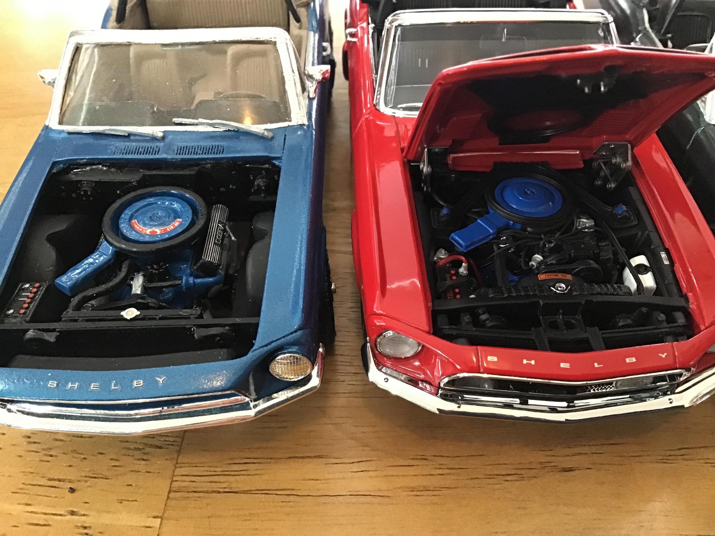

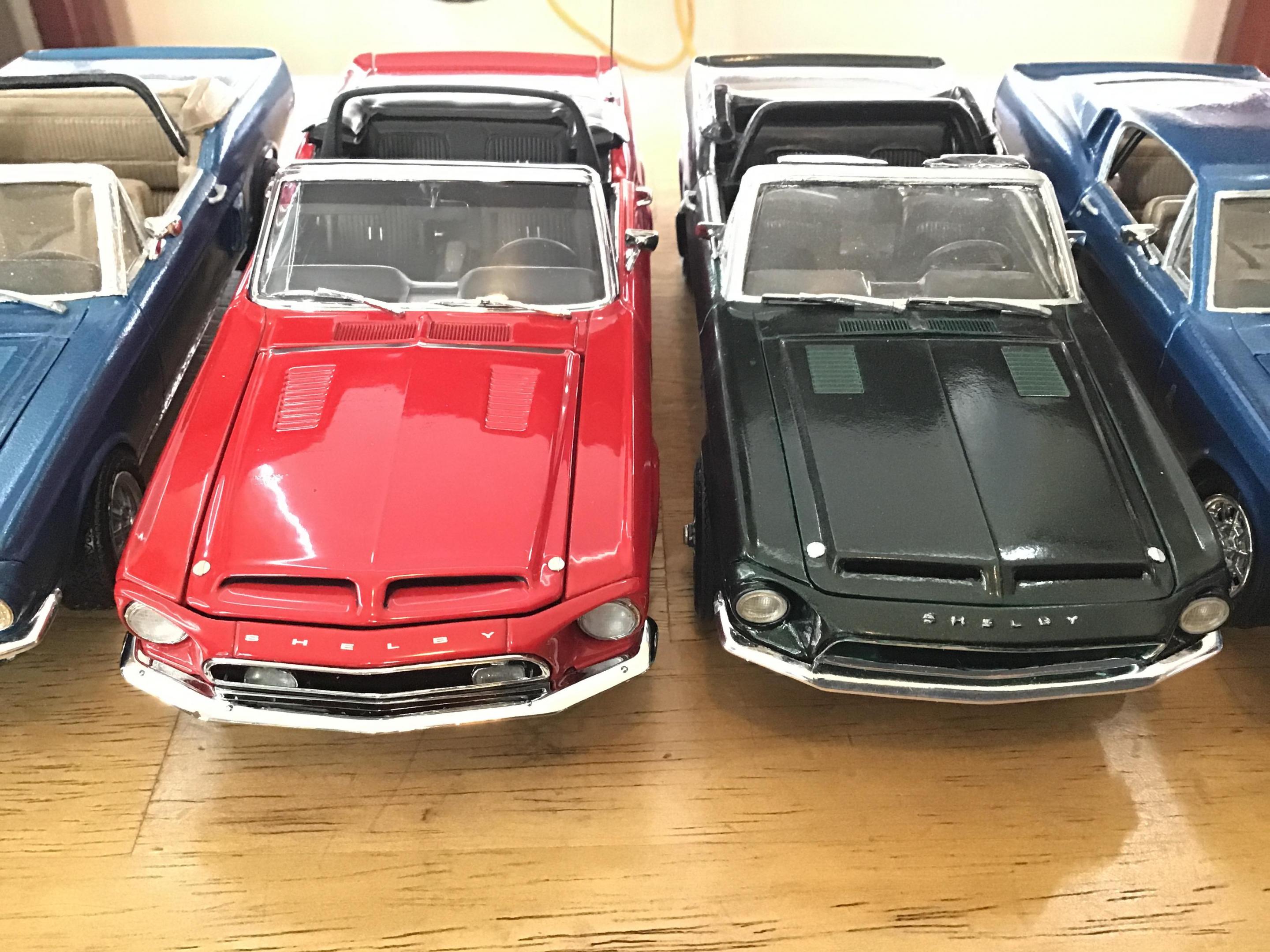

Welcome to the world of old kit molds where for numerous reasons the model companies were not concerned with 100% accuracy and as long as these molds are around there does not seem to be any incentive for their successors to spend a lot correcting or improving them when they figure there are work arounds like you have identified.  Keep us updated on your build - I like your creativity is trying other parts from other kits to make a more accurate 68 Shelby.  I’ve attached some photos of some I built and a one diecast (red) to show the shape of the front of the hood Mr. Obsessive has pointed out in his Green Hornet build and the HRM convertible conversion (green) which used the 67 chassis.  You are so right about the ten spoke wheels and those in the weird light green reissue kit are simply awful.  I recommend getting Keith Marks decals and look forward to your build and post any questions you have before you dive into your build.
