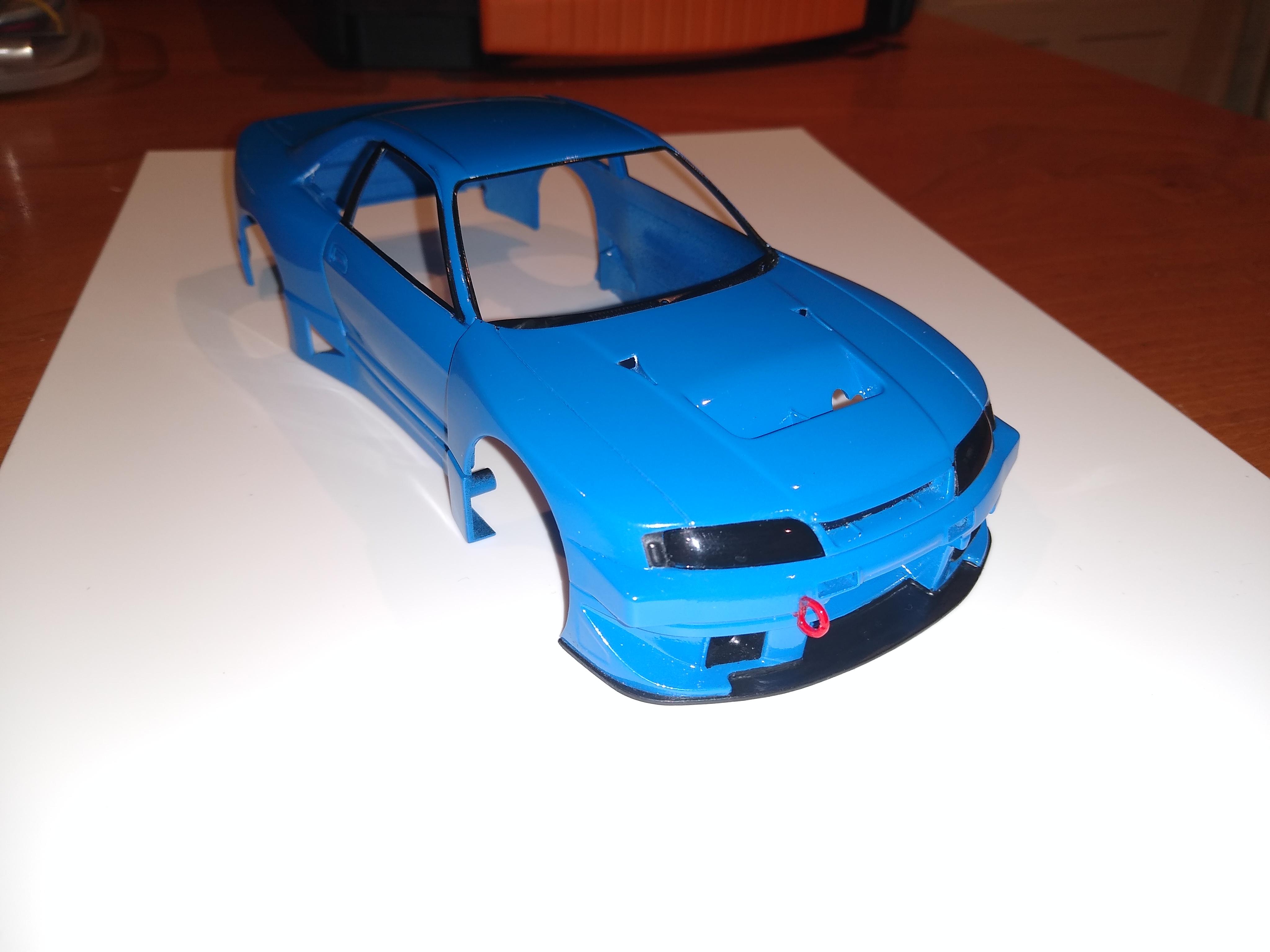

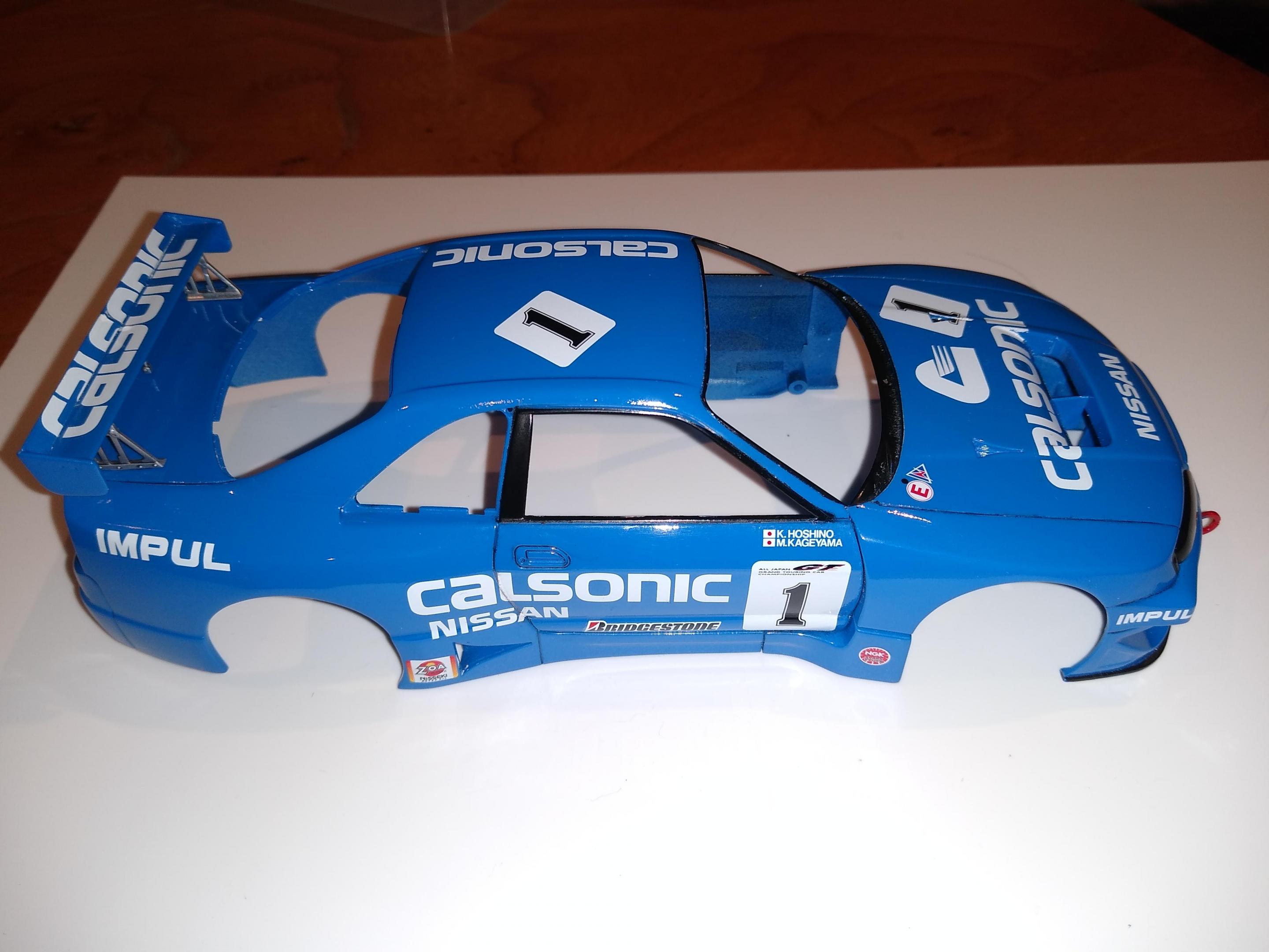

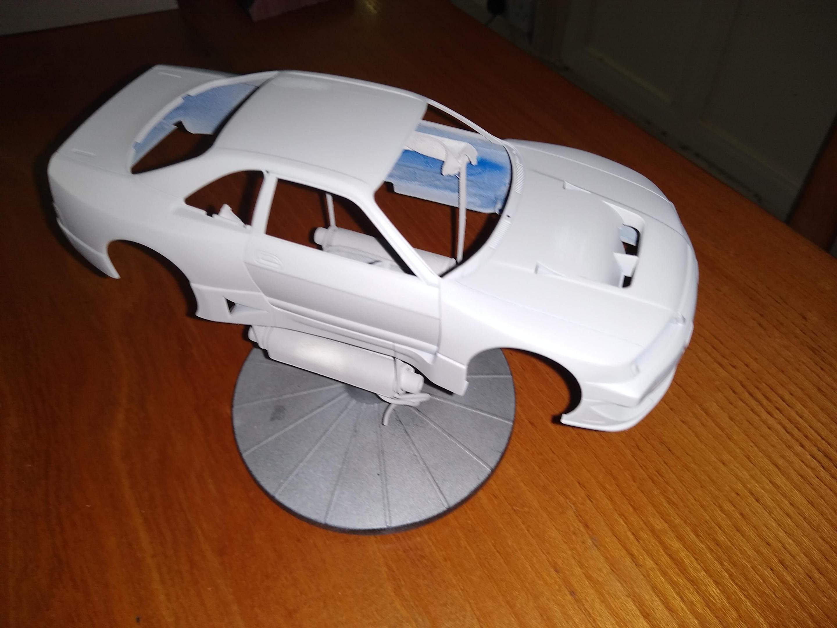

I started with the shell. The massive body kit on this thing renders the R33 almost unrecognisable, and needs a bit of gluing and a lot of paint!
1657334810_r33build(1).thumb.jpg.3b68d0d6a2b7371f131c90d2ab89cb2f.jpg197000929_r33build(2).thumb.jpg.2037206b3039ee763396aa2f1dbb4b76.jpg

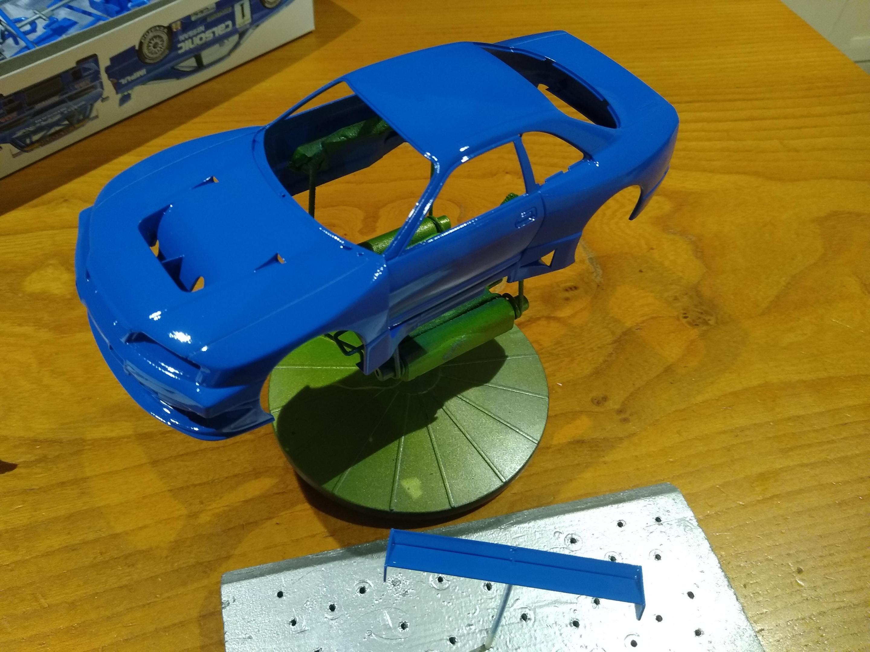

The primer went ok but I didn't do a great job of the colour (TS-44 brilliant blue), as the intended top coat wasn't "wet" enough, leaving it a bit rough. I ended up putting another coat over it & flatting it with sandpaper & polishing compound. In retrospect I might've done this the other way around, but it looks ok after the TS-13 clear coat & I'll repeat the flatting/polish before the decals go on. (The spoiler was an absolute pain and needed re-gluing twice, and goodness knows how much time to re-sand & touch up: I hate spoilers!)

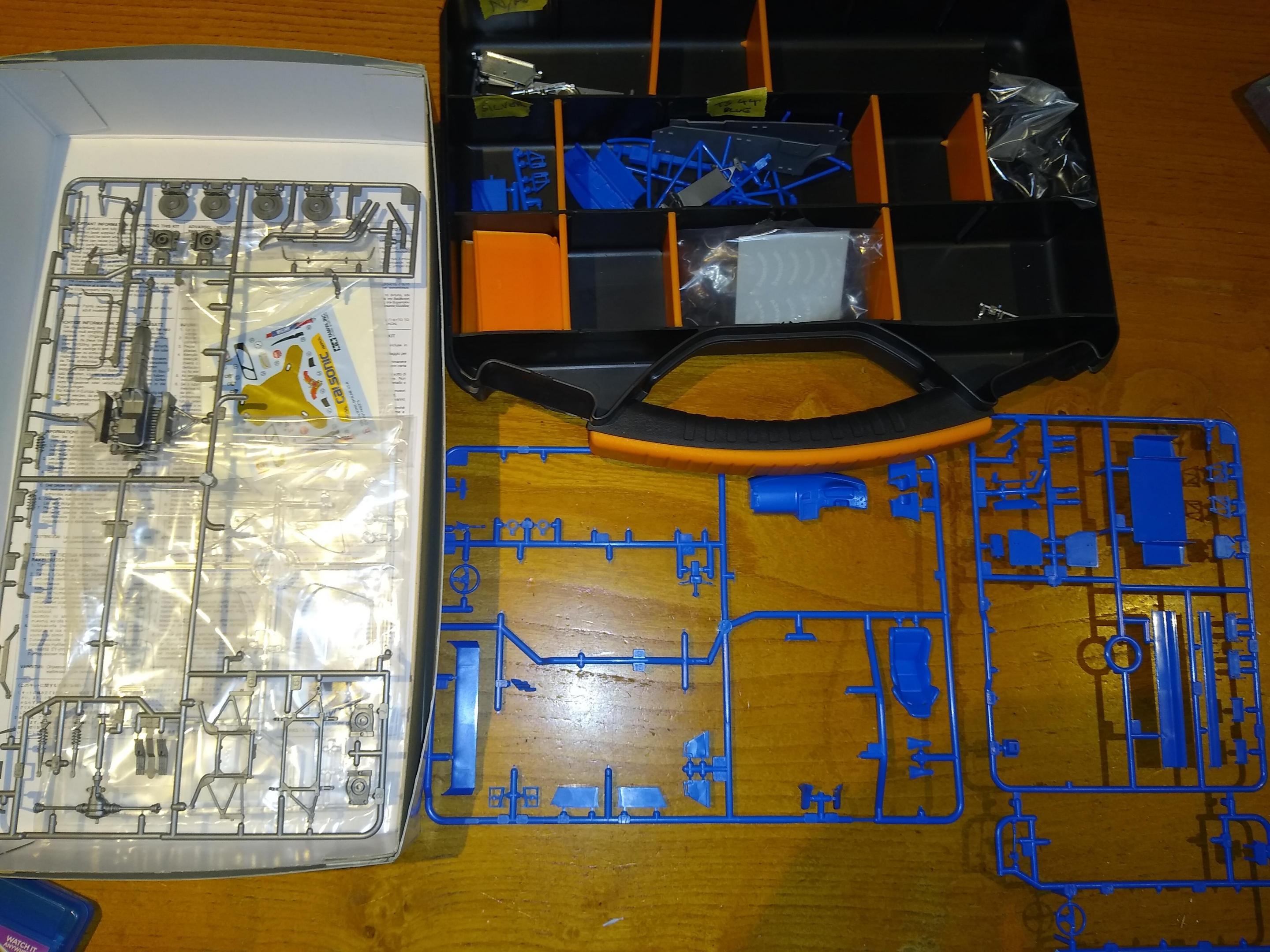

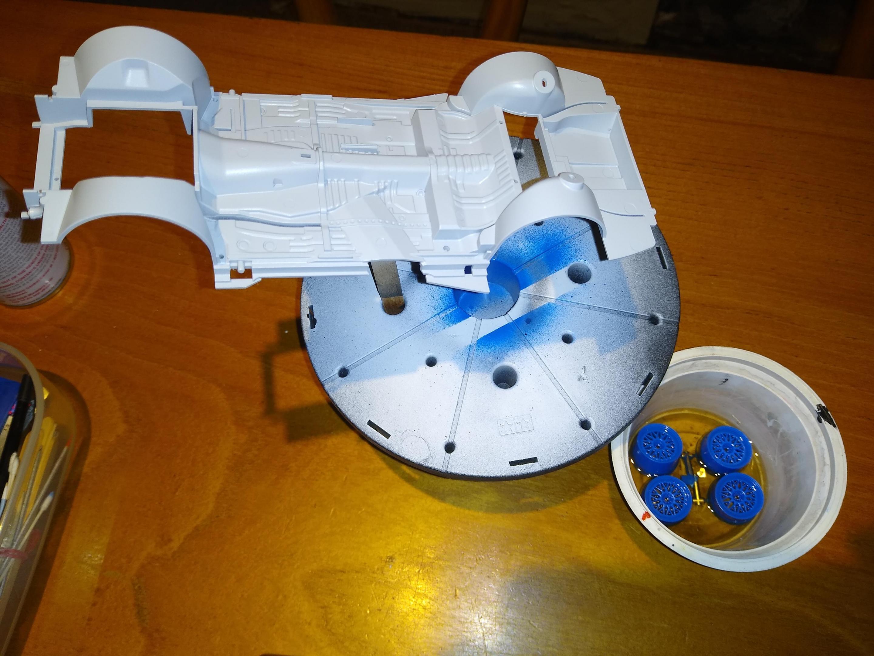

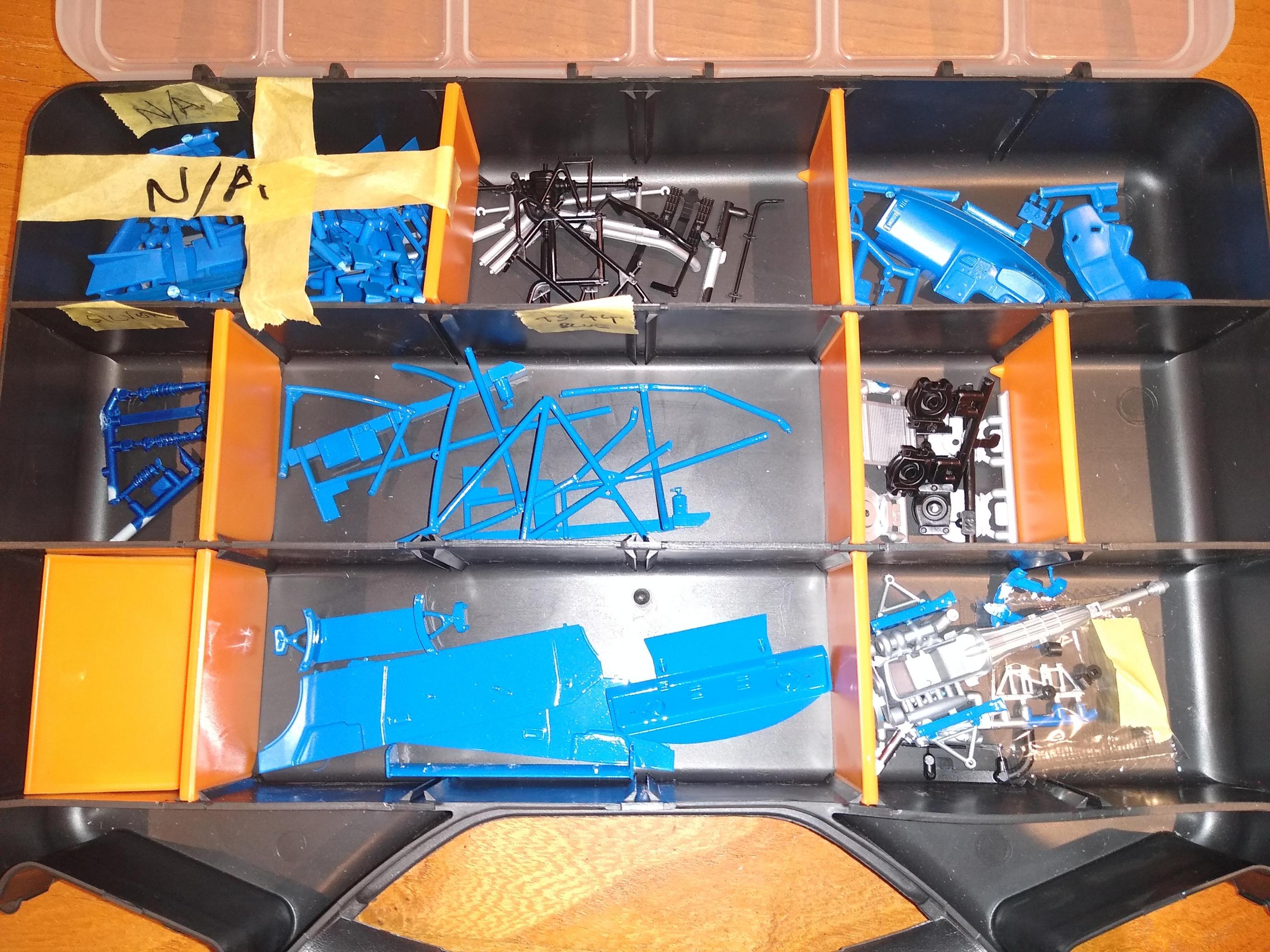

The last couple of sessions have been spent studying/organising & I feel like I'm properly on the case now. The chassis has been primered & the wheels stripped, and I'm starting to sort out the fiddly small bits. Gonna need to order some more TS-44 for the chassis: man, this thing really is BLUE...

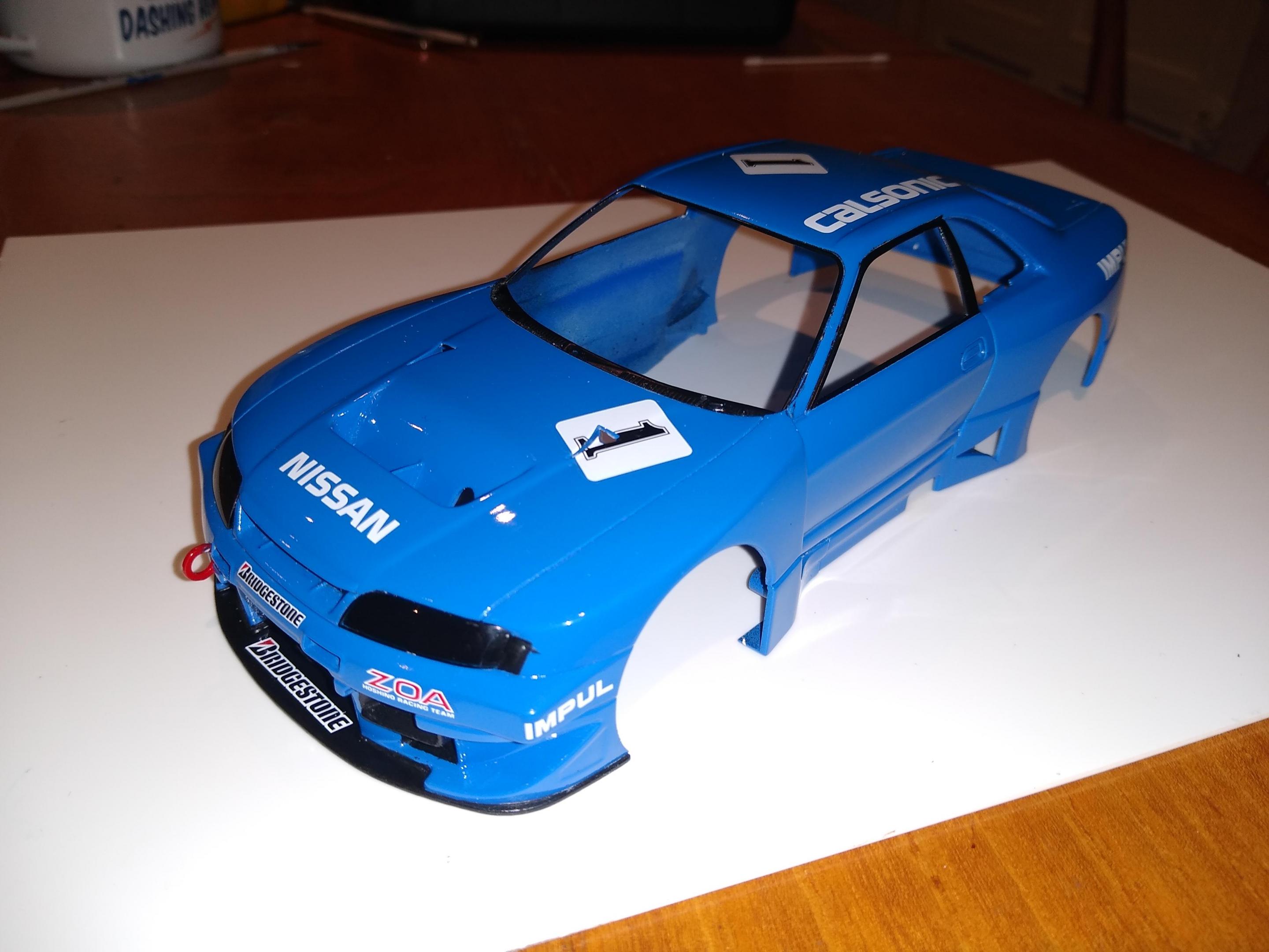

Hi guys. Been in full attack mode on this one. The bulk of my time has been spent on the shell: first wet sanding the clear coat, then polishing with Tamiya compounds. Annoyingly, because I didn't widen the panel lines during prep, a number of them were showing signs of the undercoat so I had to mask them off & brush in pinstripes of colour. (I will use panel wash later, but it doesn't disguise thin/worn edges.)
Finally, I was able to do something not BLUE & got the window surrounds masked & sprayed.

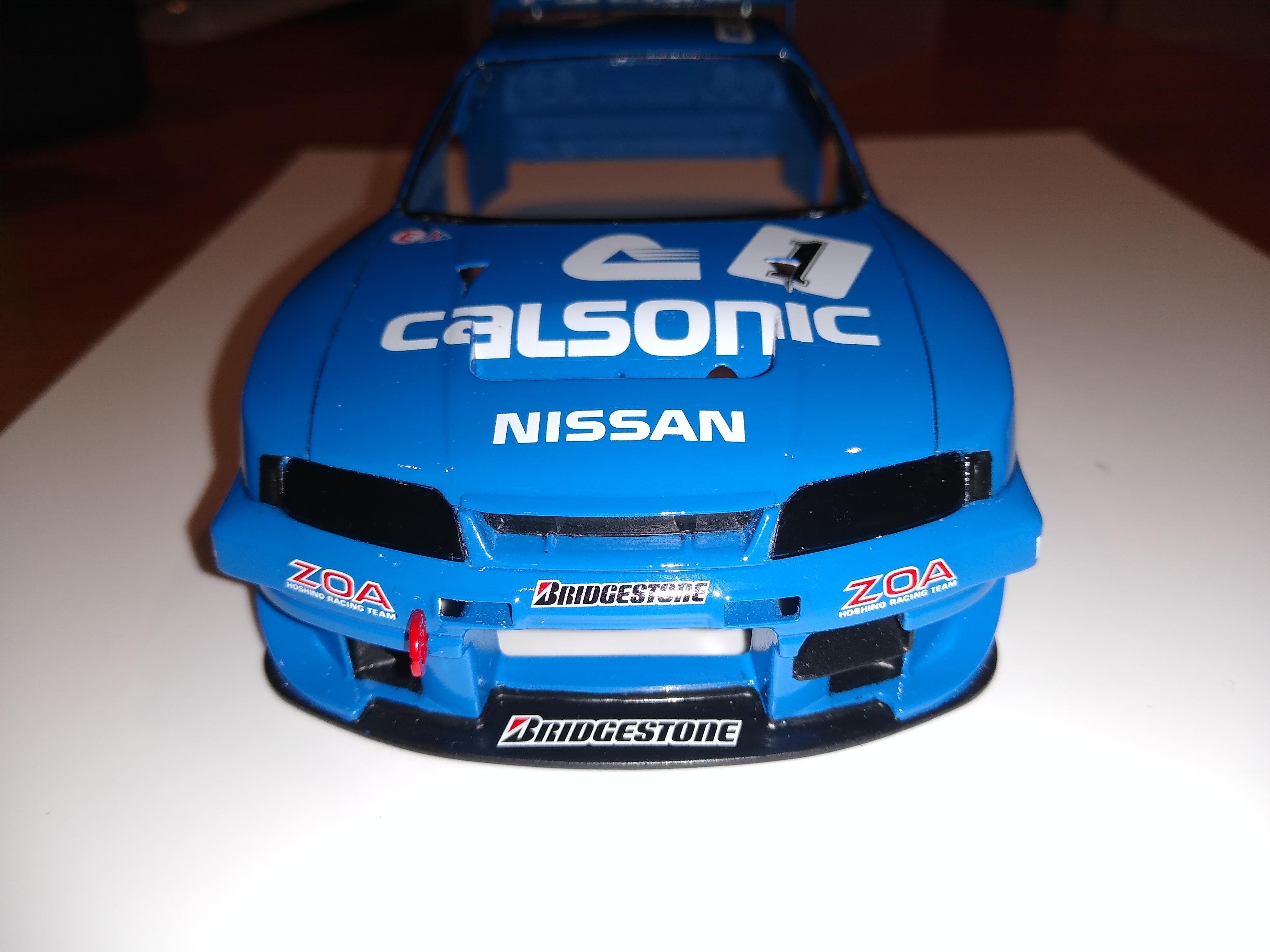

Next, some time consuming masking & brushwork on the front end. The light lenses are blacked out with lots of X-19 smoke. (They probably shouldn't be quite so dark, but I thought it looked badass!) It wasn't until it was too late that I noticed the (small) instruction to sand off the indicator bulbs on the corners. (This kit shares a body shell with that of the roadgoing GT-R which would have bigger front lenses covering everything.) After a few minutes of irritation, I discovered from my reference pics that other builders haven't bothered with this (including the example photo on the instructions!) & this area is commonly just painted black. I feel relaxed about it now!

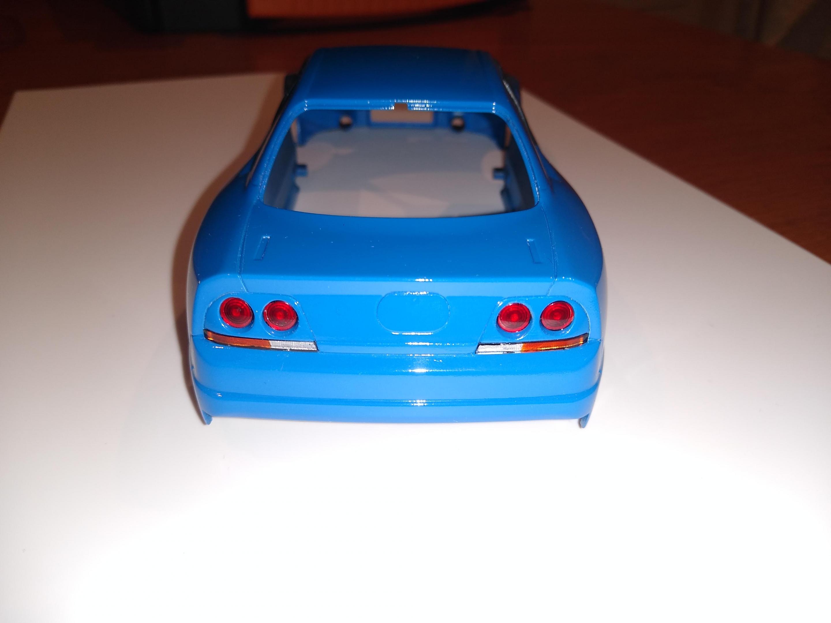

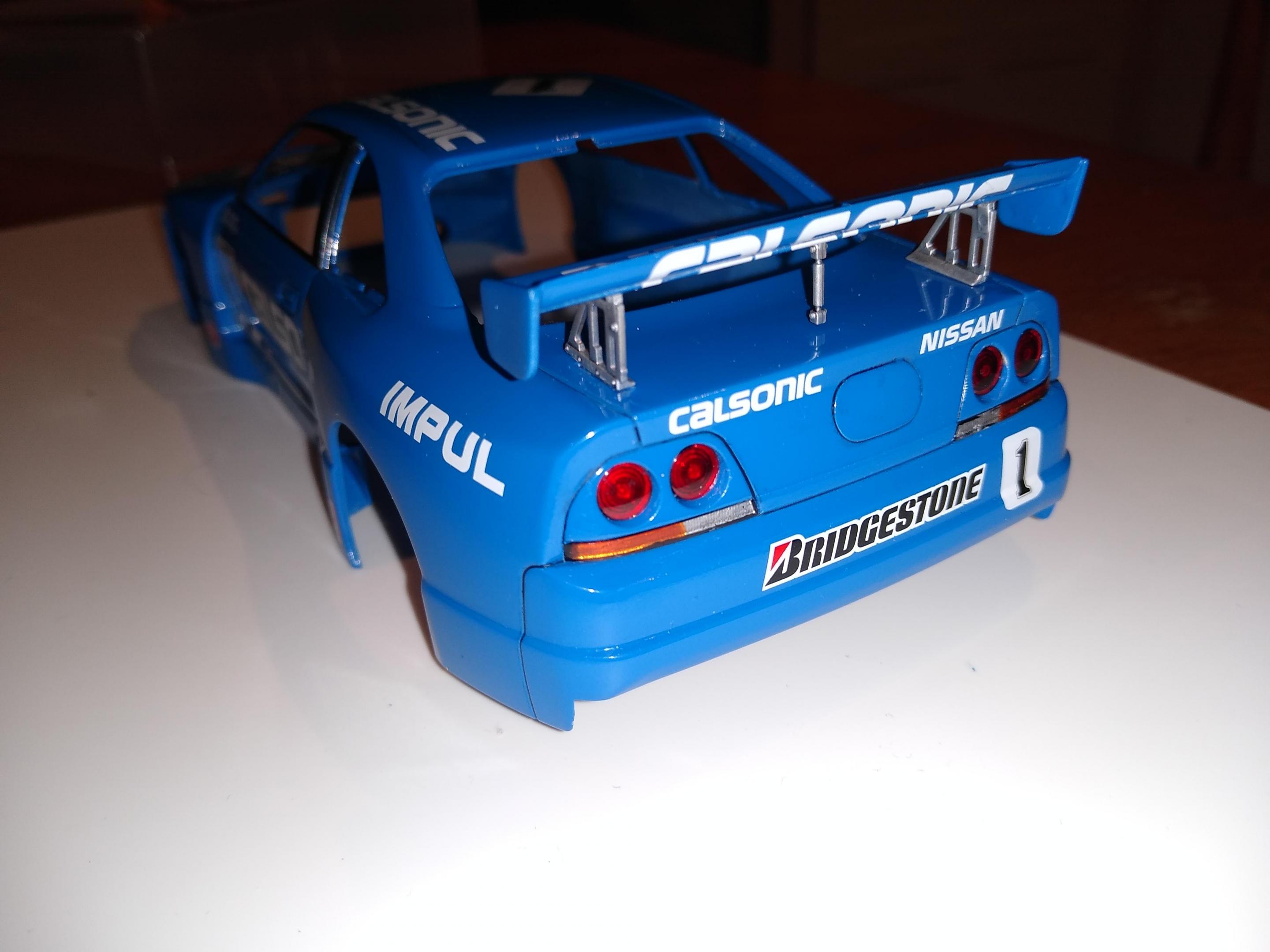

Quite pleased with the rear lights. I used the usual trick of running a black marker around the lenses & have now perfected a safe adhesion method using a brush & acrylic gloss varnish.

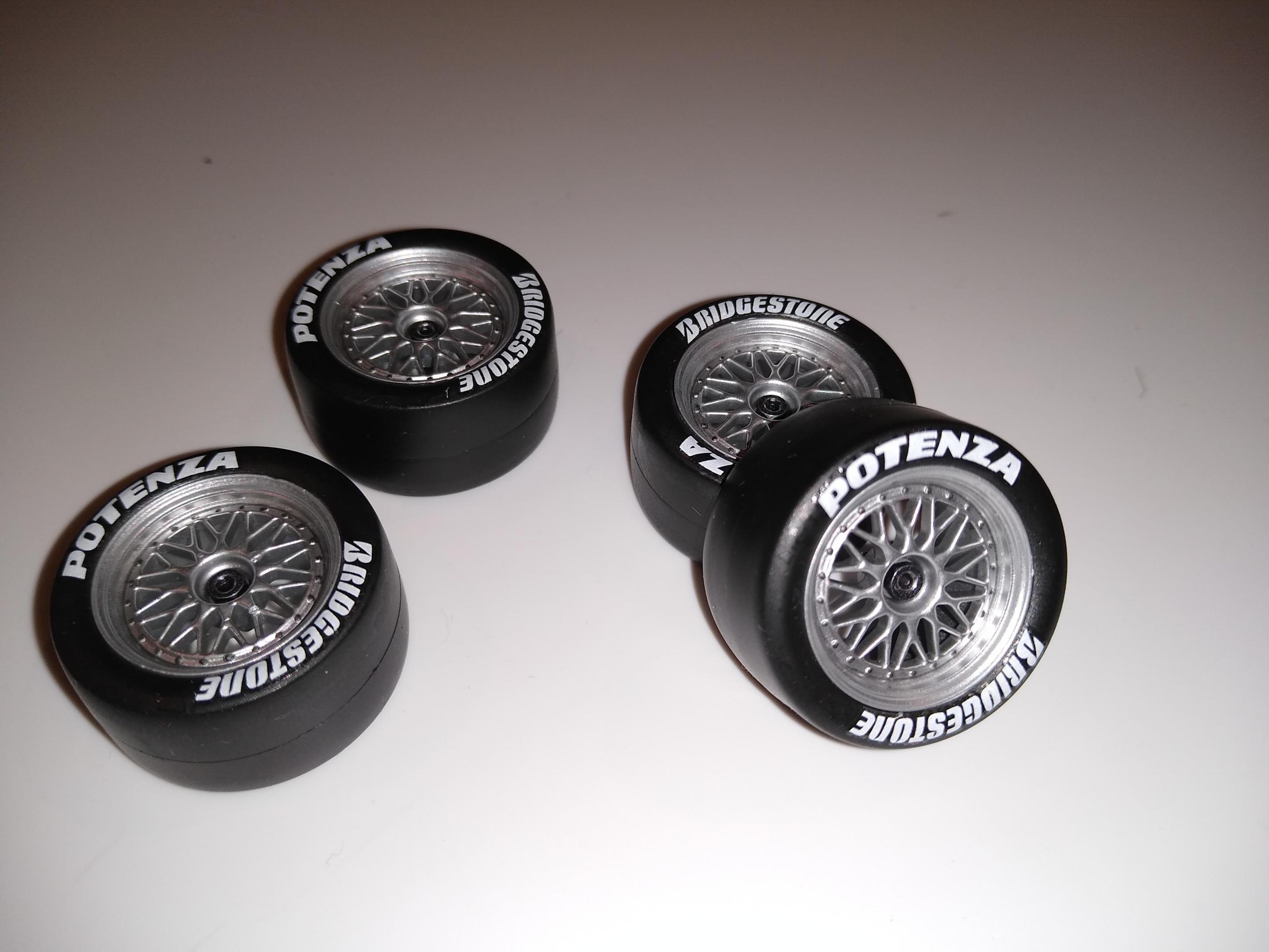

The wheels were sprayed with Tamiya silver leaf, before brushing the tiny hex bolts with metallic grey & the centre nuts with gunmetal. The rims were finished with some dark grey wash around the edges. Tyre decals make me nervous, but I took my time & followed a useful YouTube tutorial. My best wheels yet, I reckon.
With the exception of the seat & dashboard, everything is now sprayed up & ready for brushwork/gluing. (Then the decals, but I'm slightly dreading them & not allowing myself to think about them just yet!!)

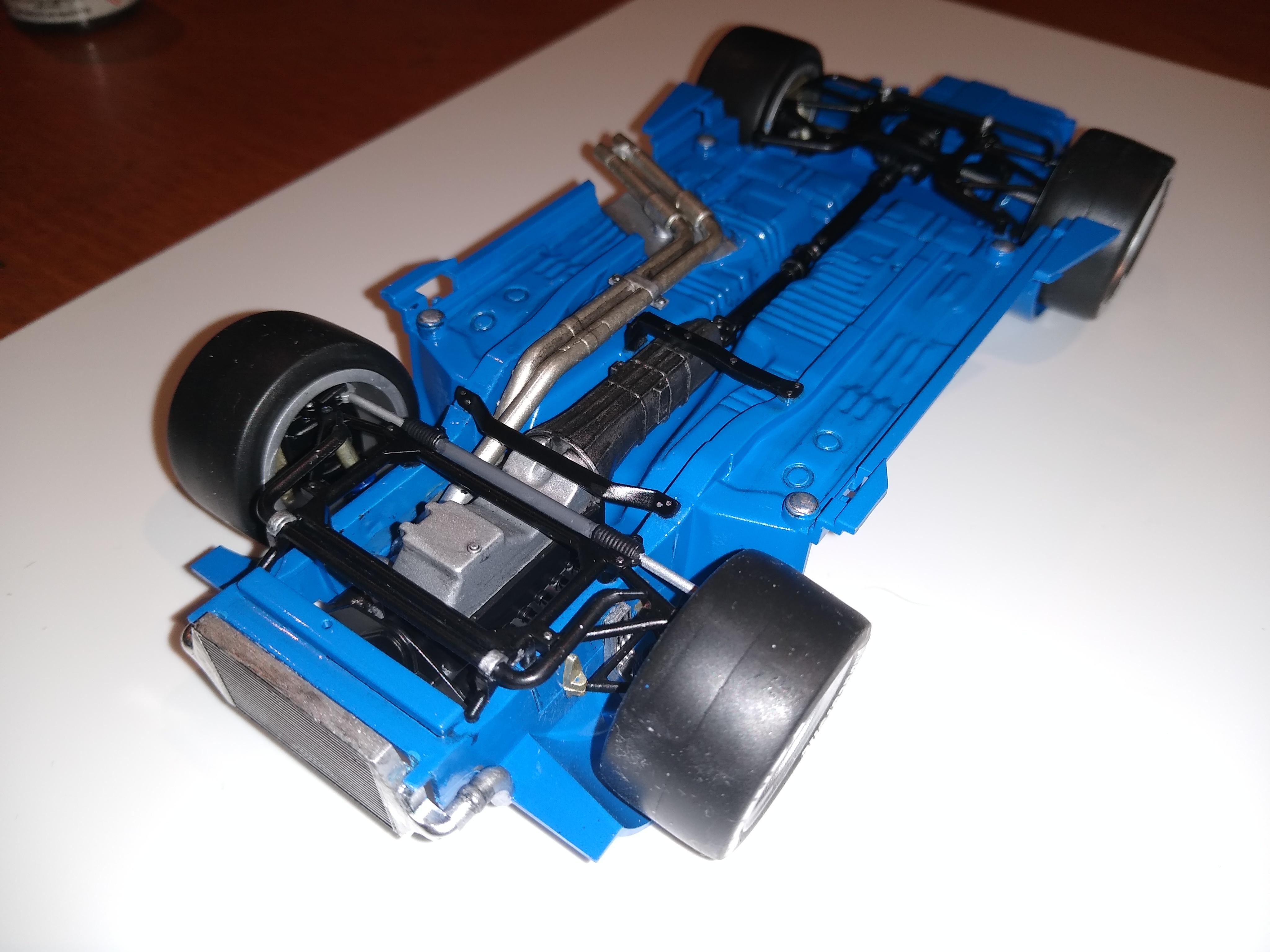

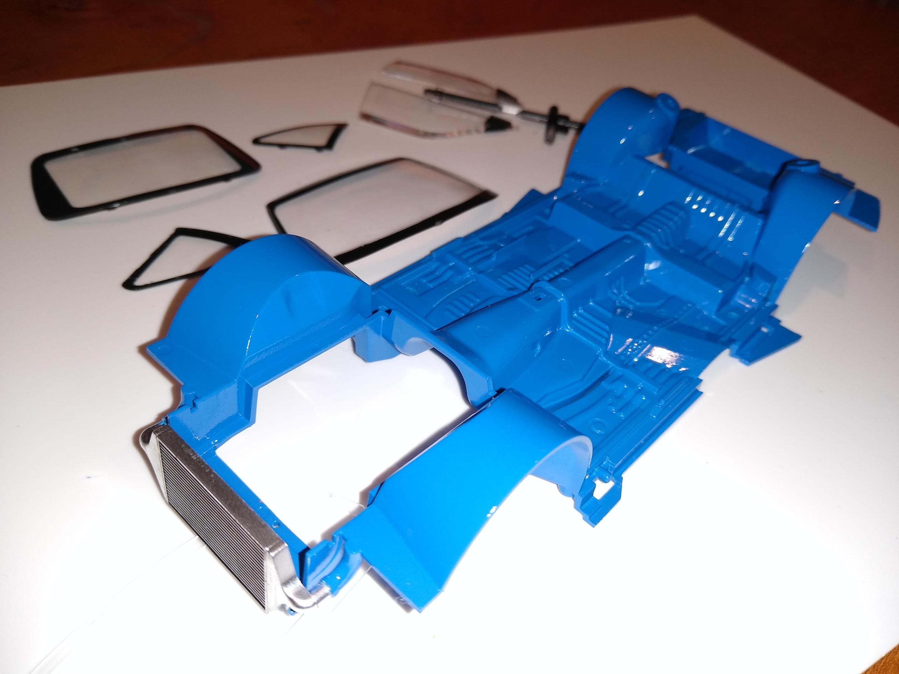

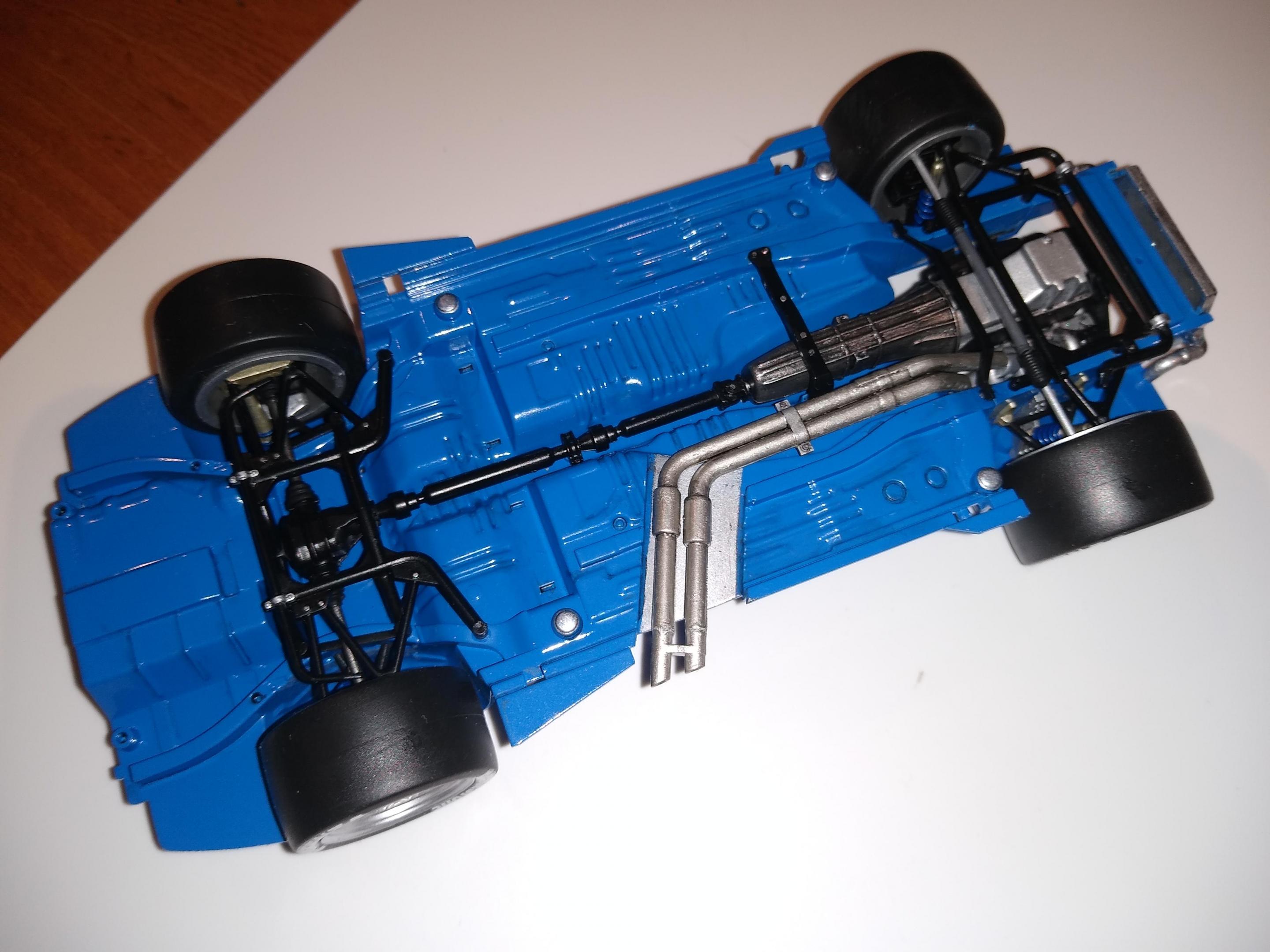

First up, got the underside done:
IMG_20201021_230105195.thumb.jpg.2fc8084ad2abdc7ccd9607dc02dfc564.jpgIMG_20201021_230349491.thumb.jpg.fd8edc9e3fae726397e138c547d9fc7d.jpg
I have to say, this kit goes together really nicely. Everything seems to just "click" & I can definitely recommend it.

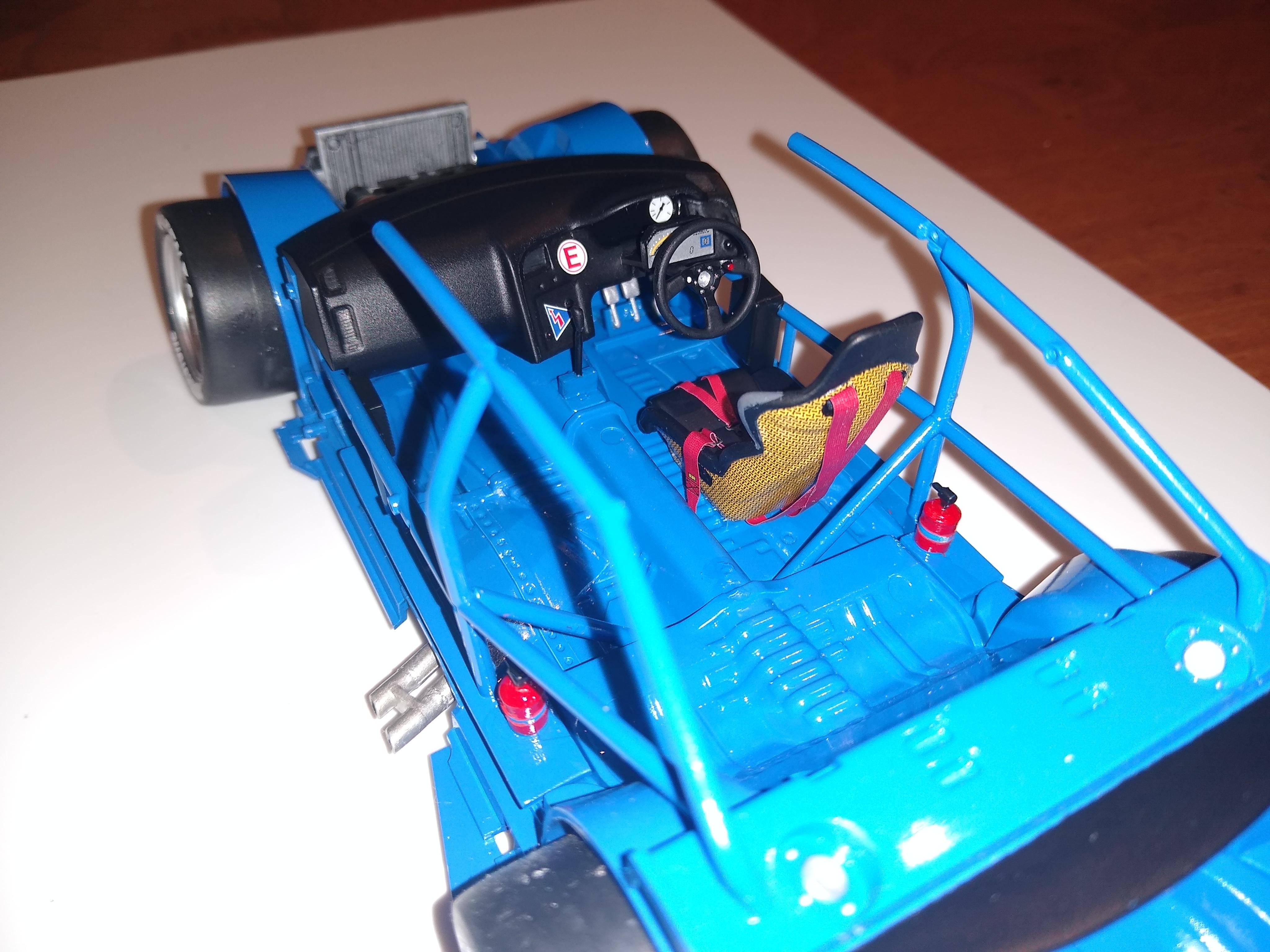

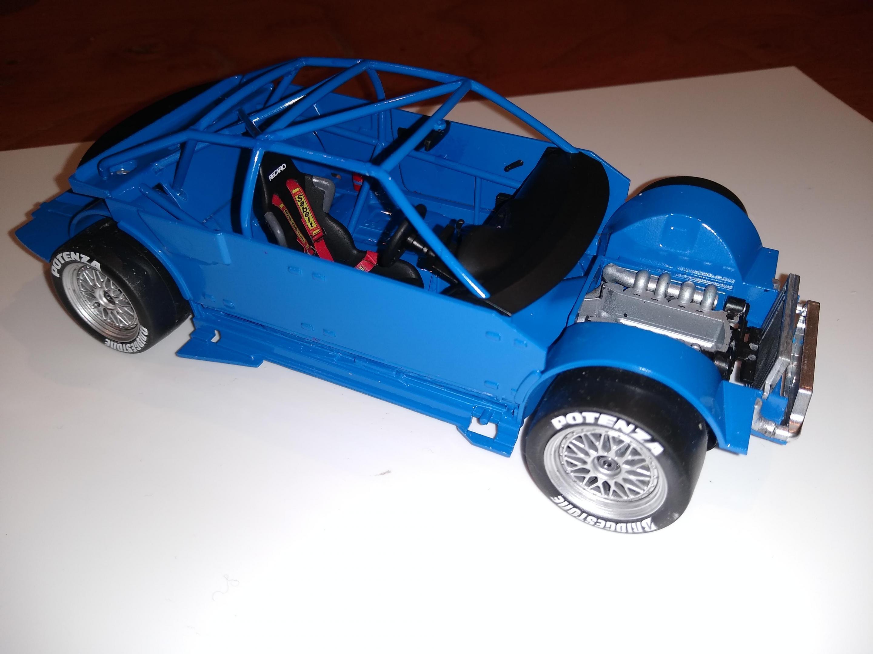

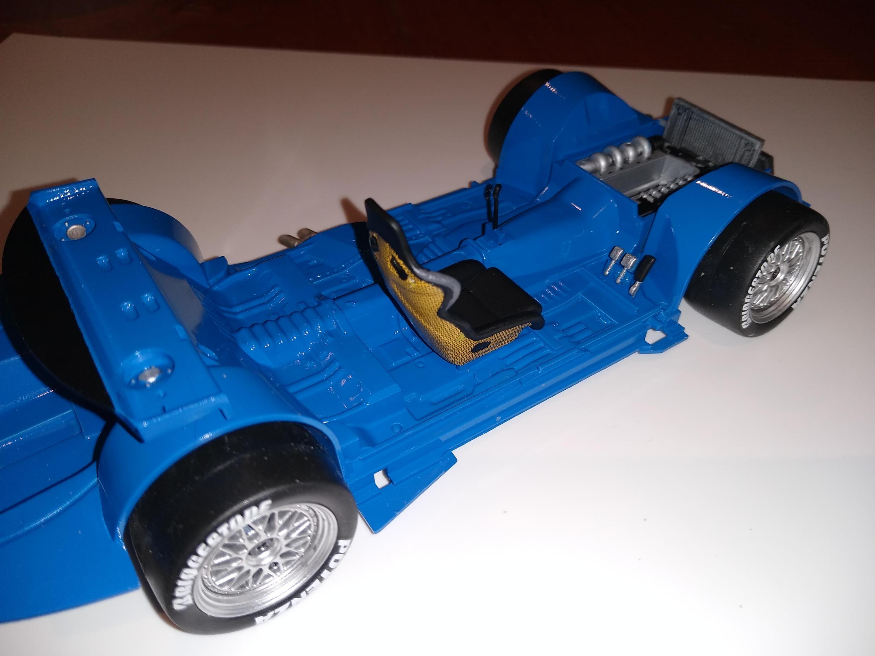

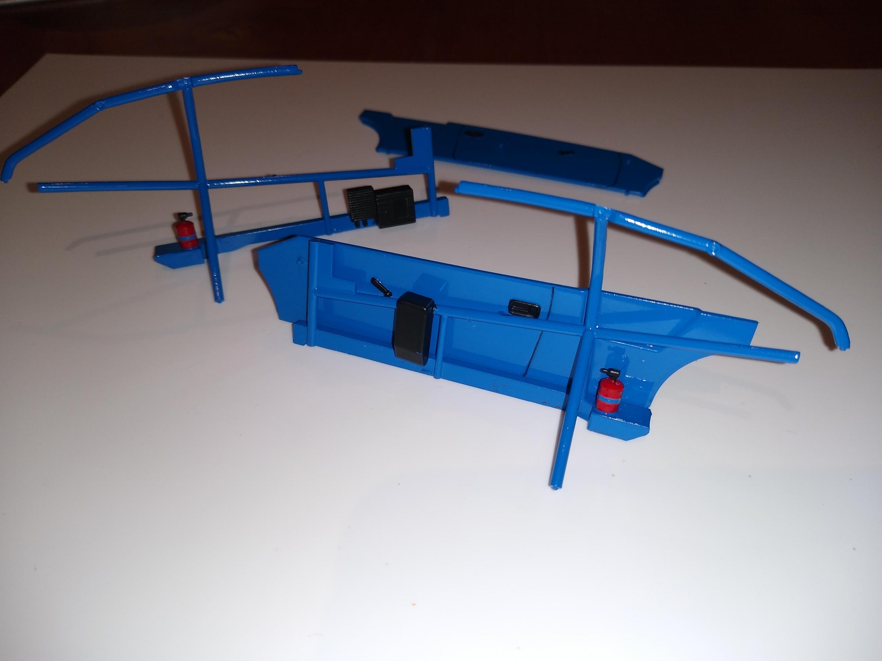

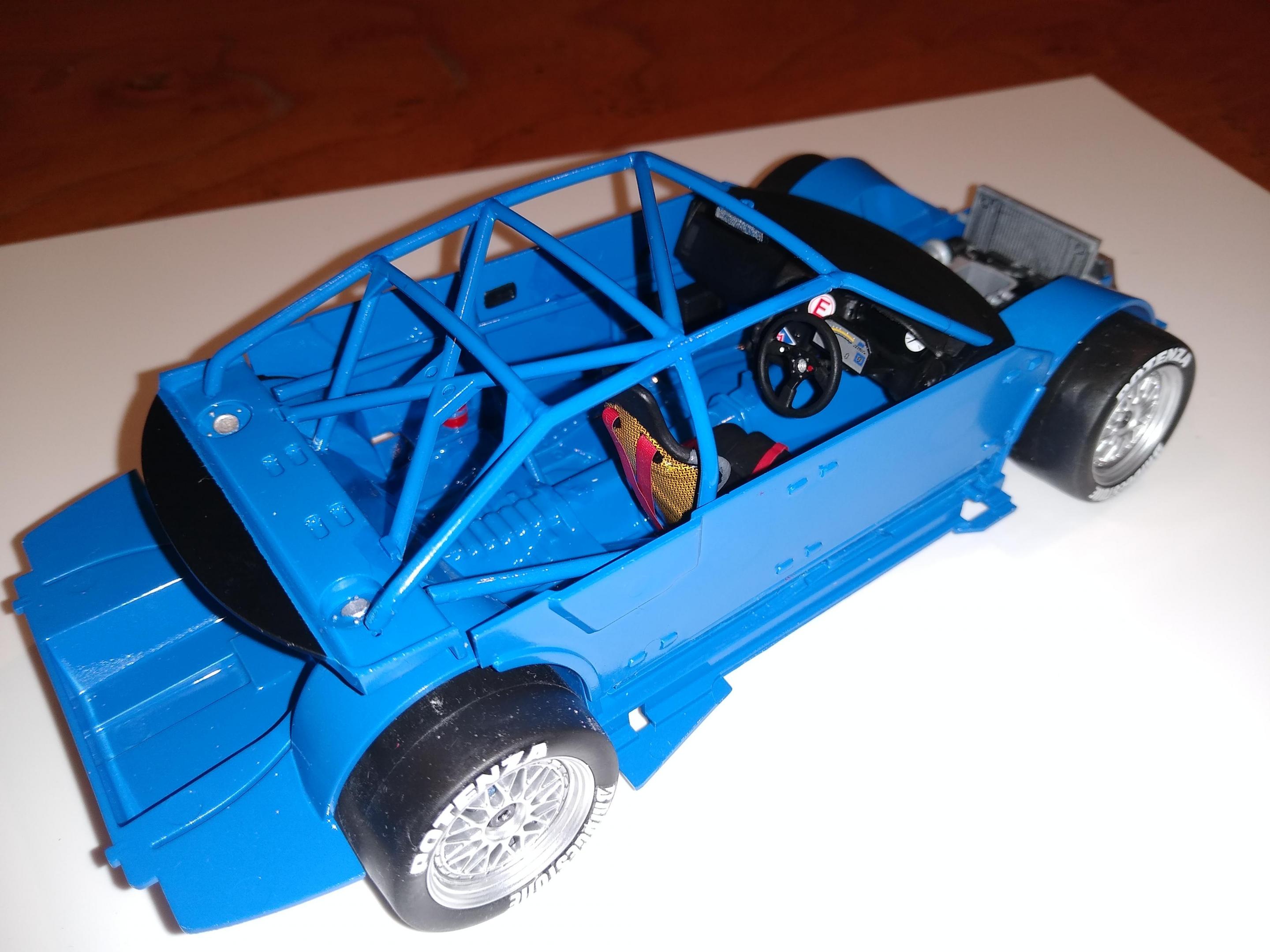

Up on her wheels now & almost ready for assembly as I've finished most of the interior components:
IMG_20201023_194749665.thumb.jpg.f31fb796800f2599adc06bad9108b97d.jpgIMG_20201023_194045279.thumb.jpg.d0f716e4b15fb0d02fc843918a6a8f9d.jpgIMG_20201023_200059581.thumb.jpg.0d7aaac6585ef1af22a56b97c5dc9eef.jpg

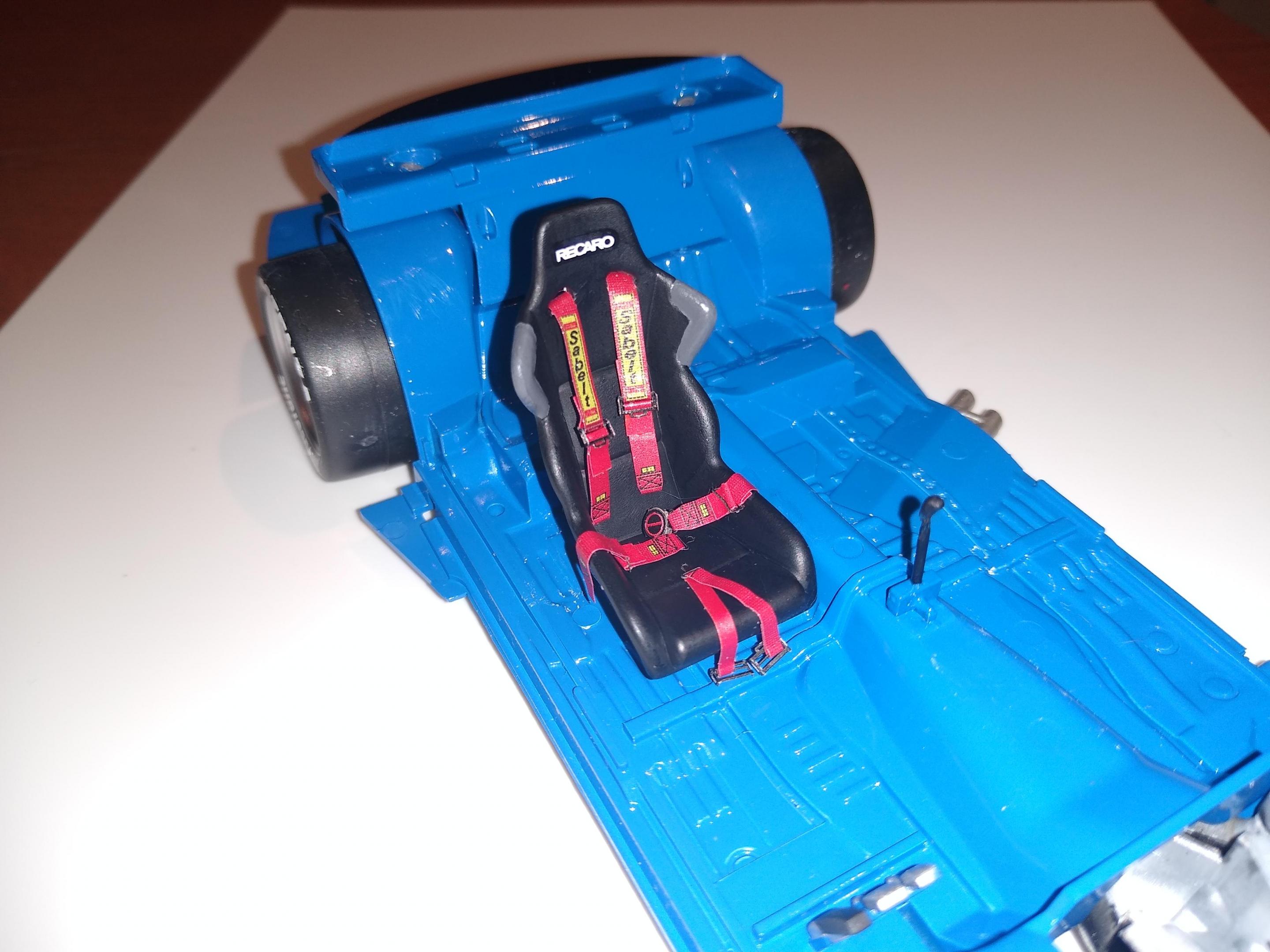

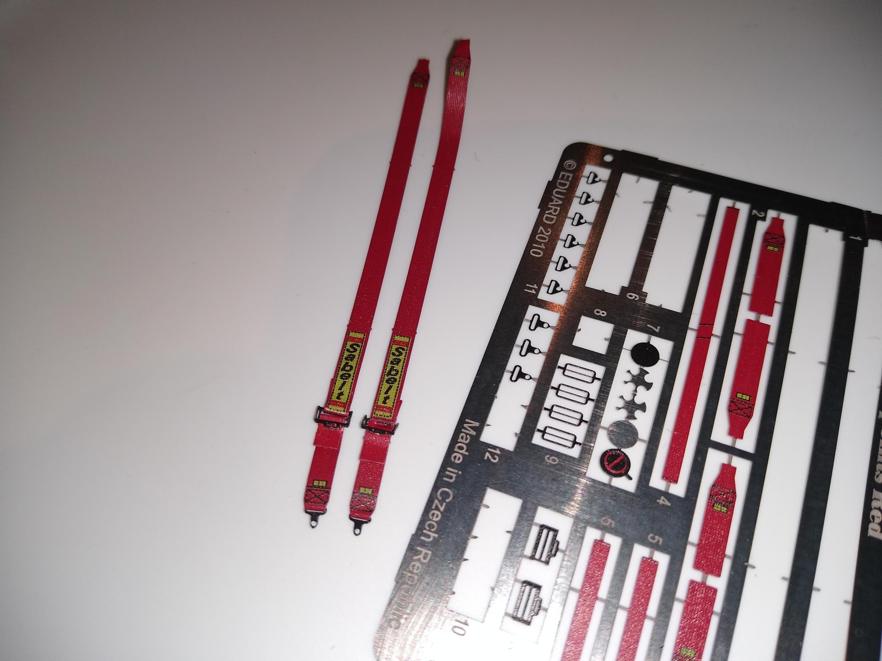

This is the second time I've used this PE seat belt kit. My 45-year-old eyes need every bit of light & magnification I can get hold of - man, they're fiddly!!!

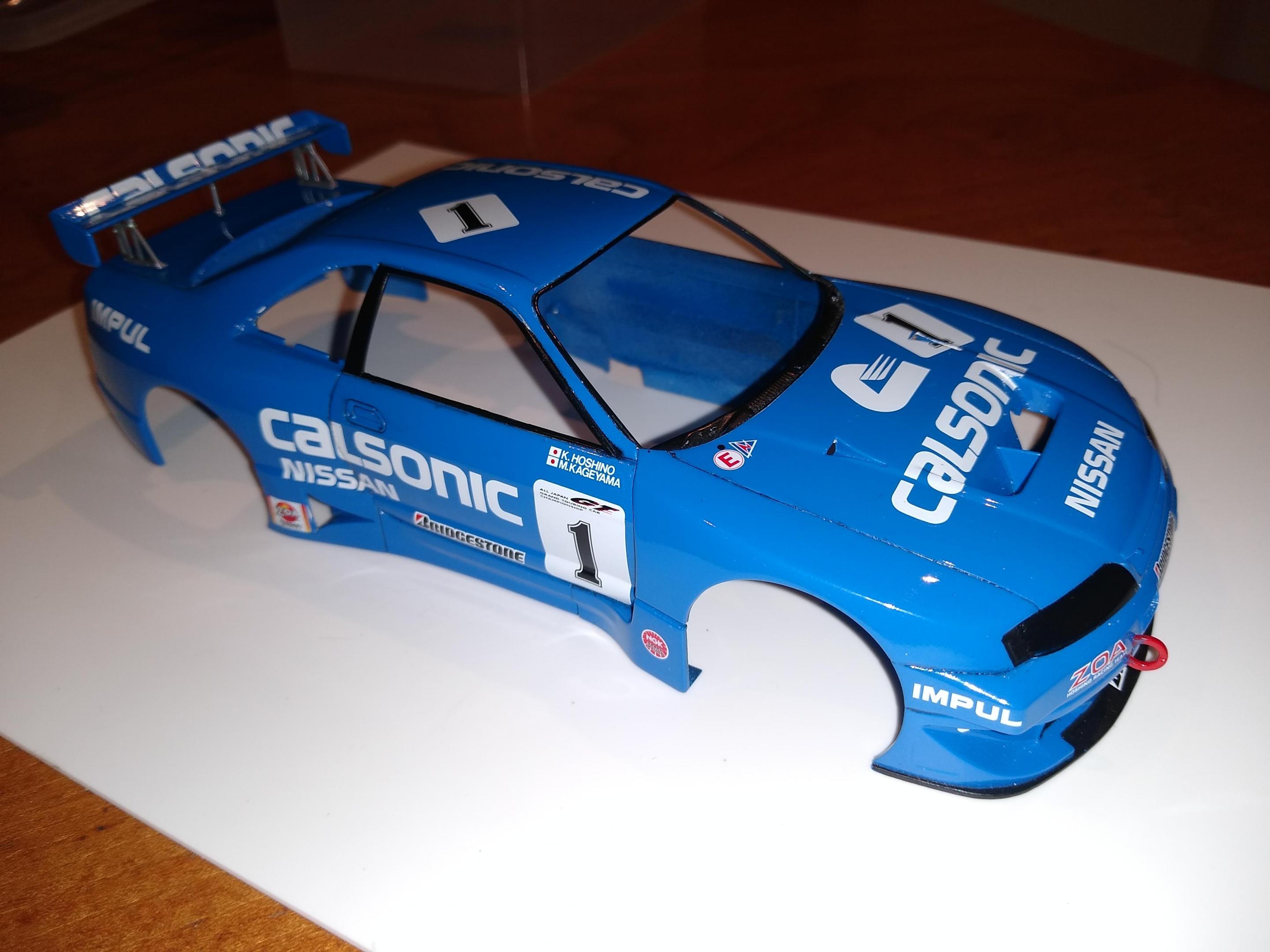

Got started on the race car decal fest. This is only model #5 for me (although 6 & 7 are also in progress) so decals still bring me out in a bit of a sweat, but I'm almost enjoying them now!!
Not far away now, so hopefully will be done by the next post. Cheers for looking in ?
Ok, all but done. Waiting on some non-fogging CA glue to put the windows in, but she's pretty much there.
The belts were testing but ultimately ok. I derived a good deal of help here from looking at approach taken in the superb Pennzoil R34 build by@lghtngyello03.
IMG_20201025_161044135.thumb.jpg.fba31014a0870f328f49084e26f9948f.jpgIMG_20201026_005758925.thumb.jpg.2b1559bd8ec7d547da7706e9a2bc1f2b.jpgIMG_20201026_005810375.thumb.jpg.0d43bcb841a2e90e4a348e18e7d6a346.jpg

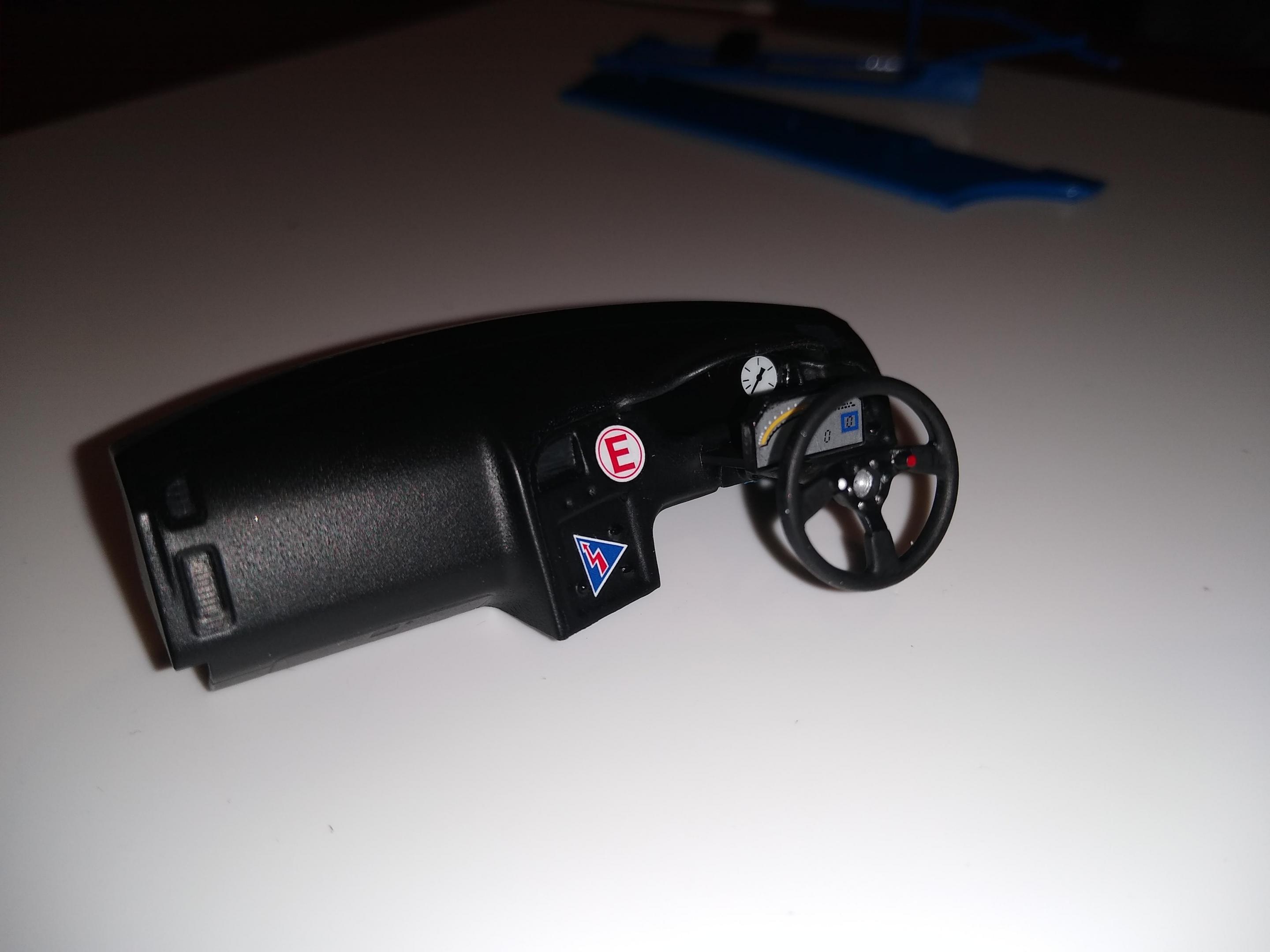

The rest of the interior went together pretty smoothly. I'll say it again, it's a really nice kit to work with.
IMG_20201026_004358392.thumb.jpg.d0aec750f44604e881ed44d0c599047c.jpgIMG_20201026_004425190.thumb.jpg.8430efdbbb533506d7b0c4951bf896bb.jpgIMG_20201026_004444529.thumb.jpg.1442c3189de9354f68483e43b120d259.jpgIMG_20201026_004453668.thumb.jpg.ba2df4969c29dca8848decf6e6b51d9a.jpg
Any gluing onto finished bodywork scares me silly but the spoiler was painless. I decided against the wing mirrors because you're supposed to put a hole through each door from a mark in the interior (no thanks); also the position seems a bit strange and they look mega flimsy.
So that's that: she'll be under glass when she gets some!?
