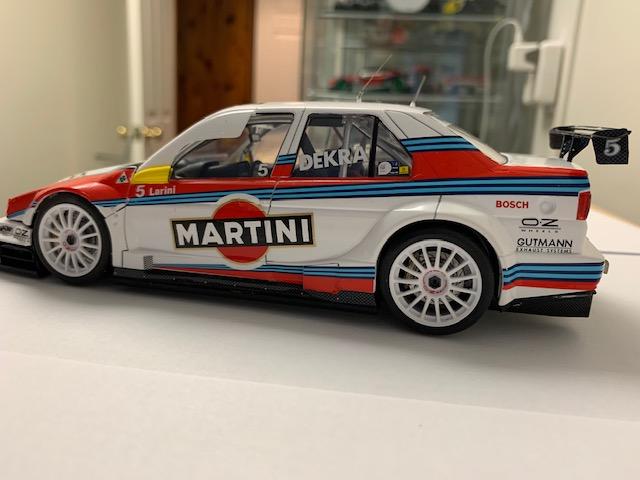

Gorgeous job on all that CF and the seatbelts and other interior details. Can't wait to see it finished in the Martini livery..its my favorite.  I have the Dekra version of this car built but don't have the Martini and this may be the push for me to re-visit this kit. Thanks for the WIP.
Link to post
Doug...looks real good. Getting those Martini stripes on the hood without wrinkles is a real challenge. I thought I didn't have this livery in my collection but I should have checked before I ordered one. Yep...its there. So I am going to do the red Martini version and ordered the CF and decals (which cost more than the kit BTW) I will use your WIP as a guide so I appreciate your post and the effort you put into it.

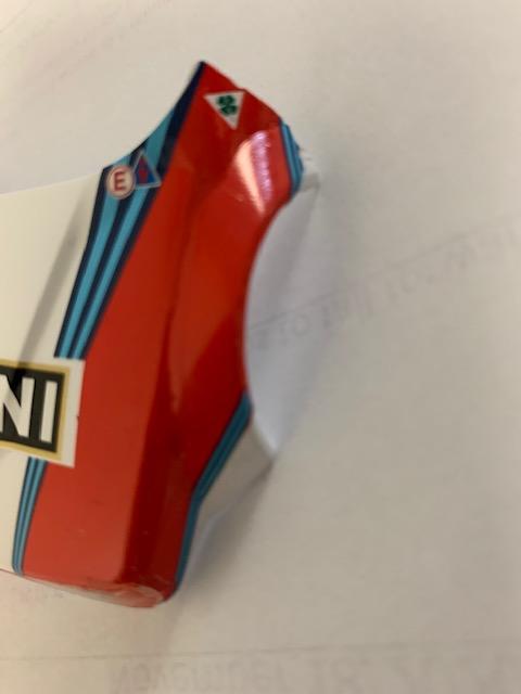

Hey Rich, thanks for the comments. If you end up building the same model I did, the trick is that you really have to put all the hood and side decals on in one sitting. The decals for the hood overlap - of course they don't tell you HOW they overlap, you just have to figure it out. Then the side decals have to line up. So block off the time, and breath deep. (But don't hyperventilate). In my kit, there was one red decal that wasn't called out in the instructions, and I used it as a doner to patch the blocks of red color if they tore during the setting process. Lucky break there. Attached are a couple of shots of the fenders. I went as far as I could without risking having them tear.
