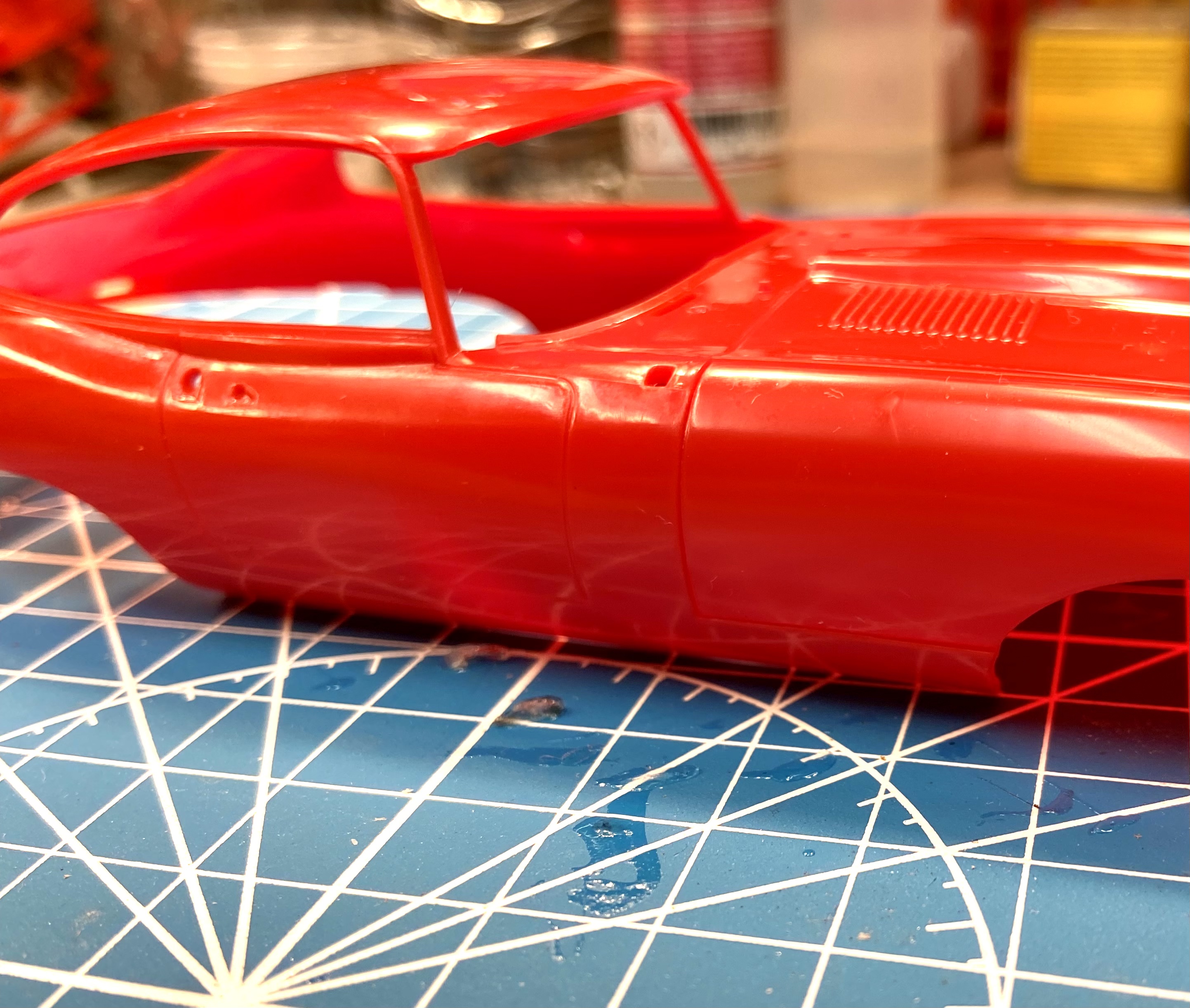

BVC500 Posted July 15, 2021 Posted July 15, 2021 12 hours ago, styromaniac said: Upon reading these posts I signed onto Michaels website today and got a discount coupon and bought one of the three Jags they had on the shelf. Was quite disappointed to get home and open the box to find this exact same problem....hood stretched over the A pillars in the bag and not aligning with the body...same as your photo. Is there any way to correct this without cutting the sides of the hood away and regluing and sanding in order to get tighter alignment? Was thinking of dunking the parts in hot water and then taping the hood and body together. I've only requested replacement parts from Revell once in my modeling history....a poorly chromed tree in a Roth Mysterion kit many many years ago. What's the current procedure? Why not heat it in hot water and slowly and carefully bend it back to its correct position?
gasman Posted July 15, 2021 Posted July 15, 2021 mine was the same way, a little hot water, and I was able to fix it.
styromaniac Posted July 15, 2021 Posted July 15, 2021 The plastic seems pretty thin. I was able to remedy some of the problem by inserting the chassis frame into the body shell...which pushed out the body sides slightly.... closing the gaps a bit.. A little more massaging is needed ...maybe a hot water bath with some clamping and subsequent cool down will solve the issue. All together...it sure does seem like a nice kit ...
Joe Handley Posted July 16, 2021 Posted July 16, 2021 12 hours ago, CabDriver said: Man, that hood fit is horrible... Mine was like that too, it’s just some warp, just haven’t tried to correct mine yet. 1

Rob Hall Posted July 16, 2021 Posted July 16, 2021 Yeah, I wonder if the issue comes from cramming the parts into an NA box instead lf the wider, flatter EU style box. I don't see this issue w/ the convertible version.

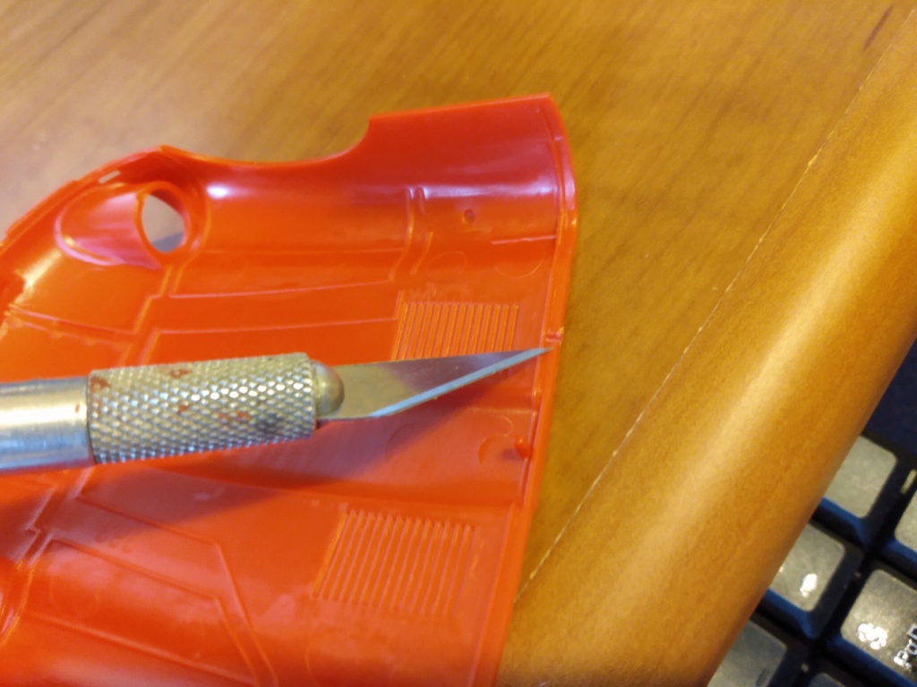

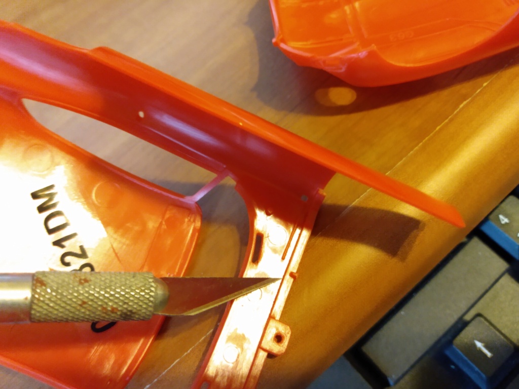

Classicgas Posted July 16, 2021 Posted July 16, 2021 (edited) I actually think these are the culprits. They stick out beyond the edge of the hood and body. I cut them flush and it fits fine. Edited July 16, 2021 by Classicgas
Joe Handley Posted July 16, 2021 Posted July 16, 2021 4 hours ago, Classicgas said: I actually think these are the culprits. They stick out beyond the edge of the hood and body. I cut them flush and it fits fine. I did that too, the pics posted were taken after I did that with mine.

styromaniac Posted July 17, 2021 Posted July 17, 2021 15 hours ago, Classicgas said: I actually think these are the culprits. They stick out beyond the edge of the hood and body. I cut them flush and it fits fine. Don't think so. Don't see how the location of those little nibs cause the hood sides to fail to properly close up . In fact...first thing I did after de bagging was to trim anything that looked like a sprue attachment point. I noticed when I picked up the bagged body shell and hood....the hood was riding up on the roof and A-Pillars in the bag just as the prior writer posted. I'm thinking his point about the plastic being soft and spread out due to the way it was packed is the cause.
Classicgas Posted July 17, 2021 Posted July 17, 2021 Whatever. Mine was a bit off and when I removed them it fit fine. Just trying to help.

Mike Chernecki Posted August 22, 2021 Posted August 22, 2021 2 hours ago, peteski said: Kit number 85-4509. I assume this is Revell's American release. If the body correction was done, which kit has the more accurate body? Ir are they both have identical plastic parts. Are both kits molded in red? This is the newer kit and it has the cleaned up body, the underside of the roof no longer has the swirls and ripples and the sinks marks have been cleaned up. Both the kits have the same issue of the hood being slid over the cowl for packing, therefore distorting the back end of the hood.
