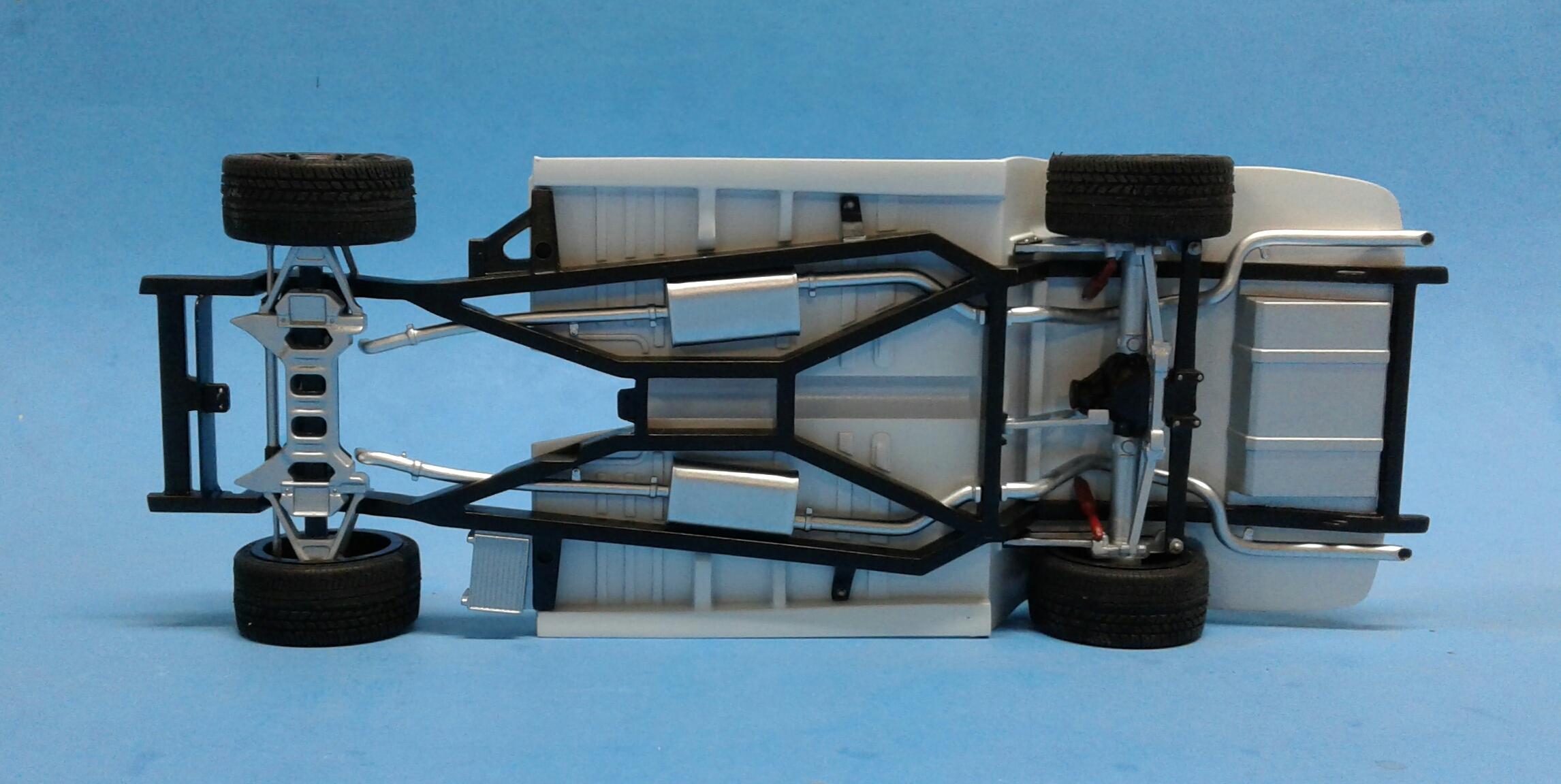

No problem Carl. The paint is just now starting to come off the body. Then I have to do the body work over. I have all of the other parts in paint now. While I'm waiting for the paint to strip off of the body, I can work on getting the engine all together and detailed. I'm not going to a great deal to it. Just basic stuff. I did get the chassis and floorpan completed.
I really like the contrast in the colors! This doesn't look like a chassis that would be going under a '49 Mercury!
Love the detail on the chassis, it’s becoming one of my favourite parts of a model, next to engine to build!
