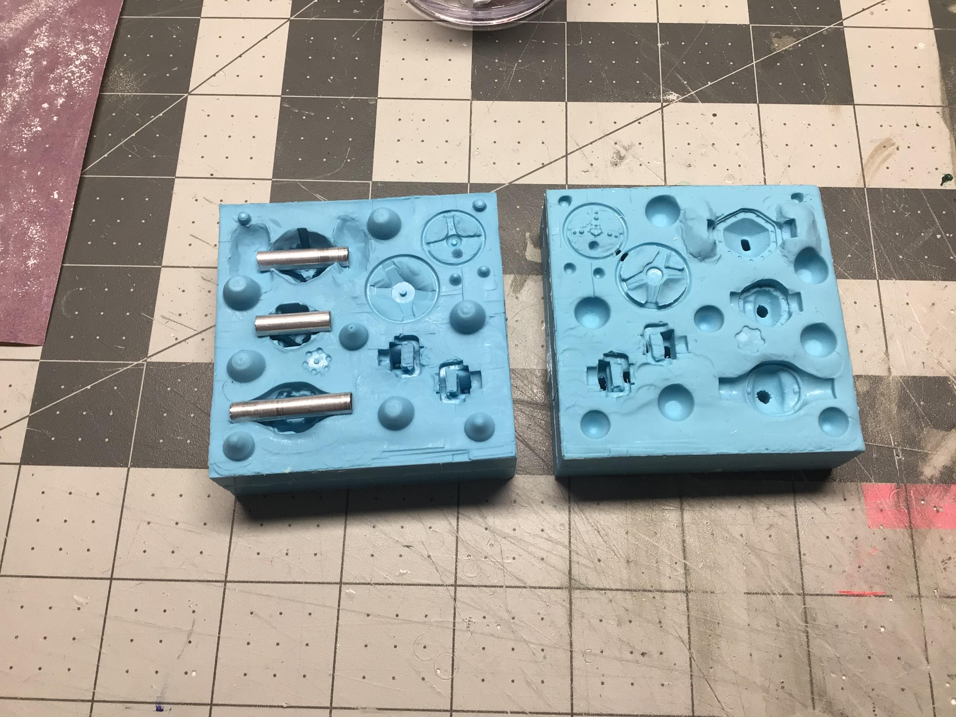

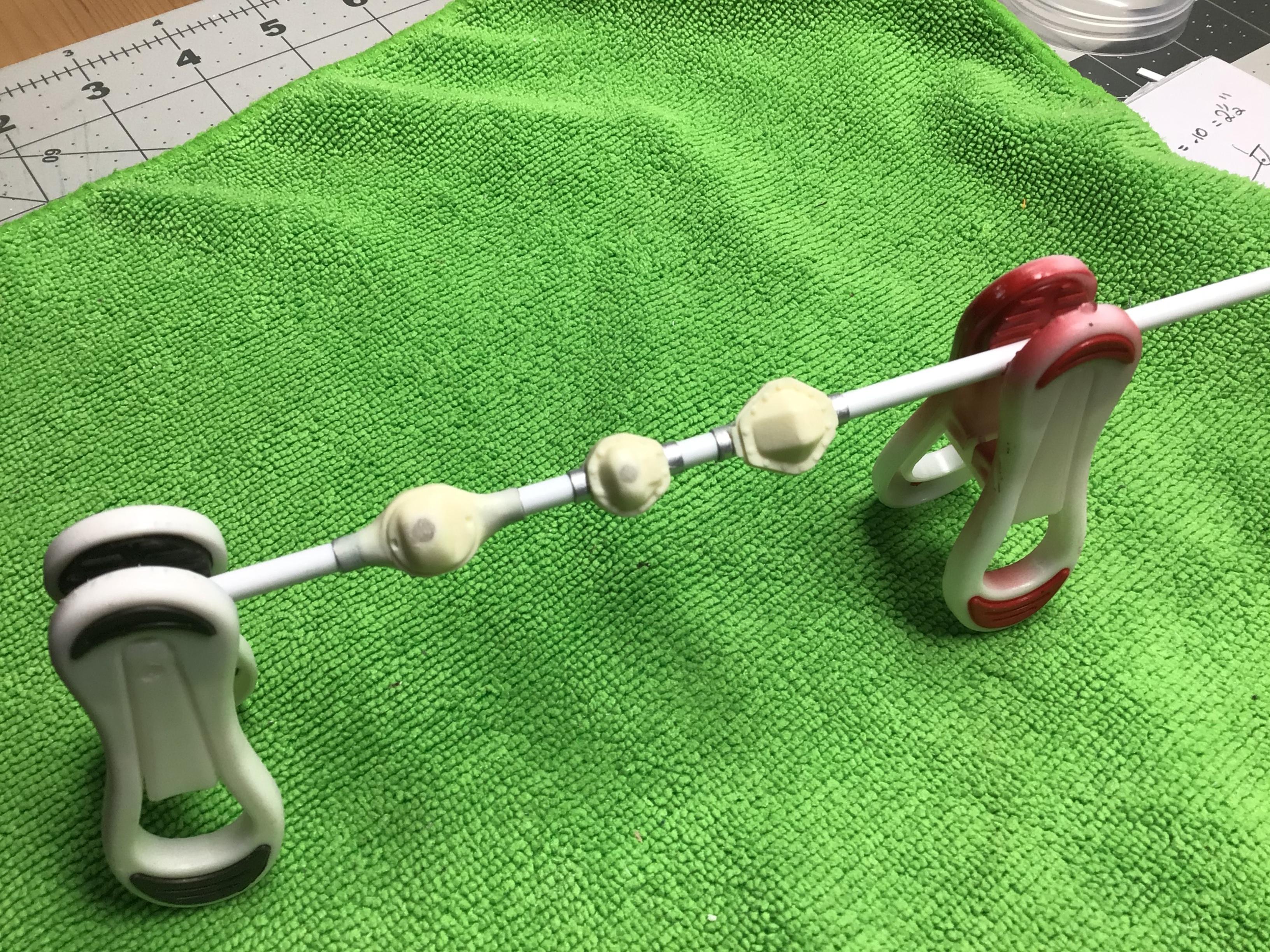

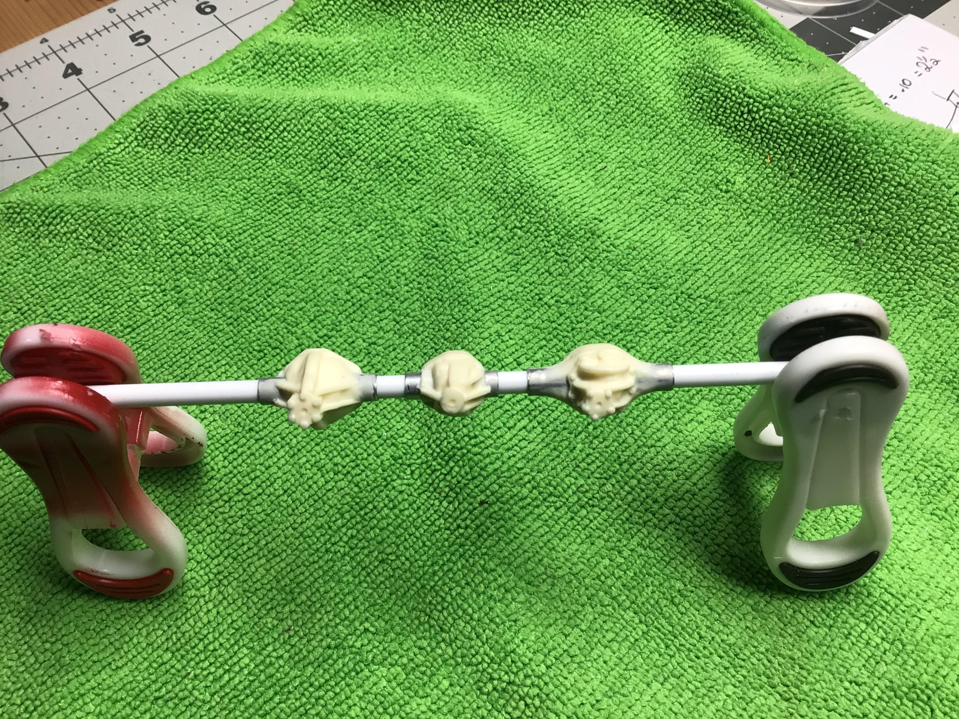

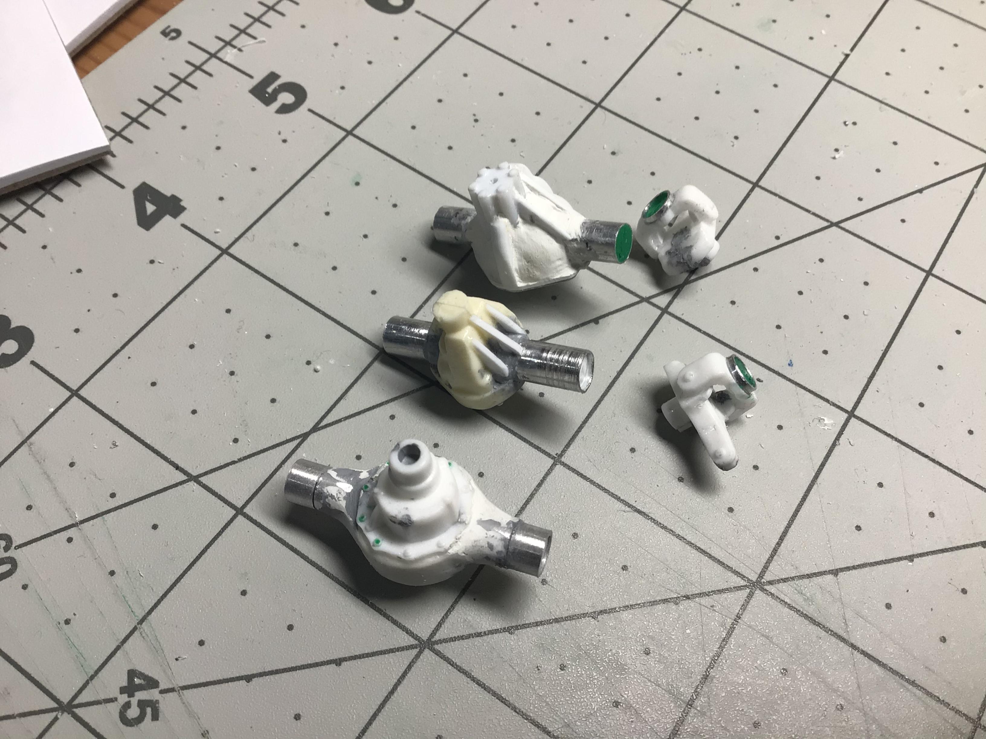

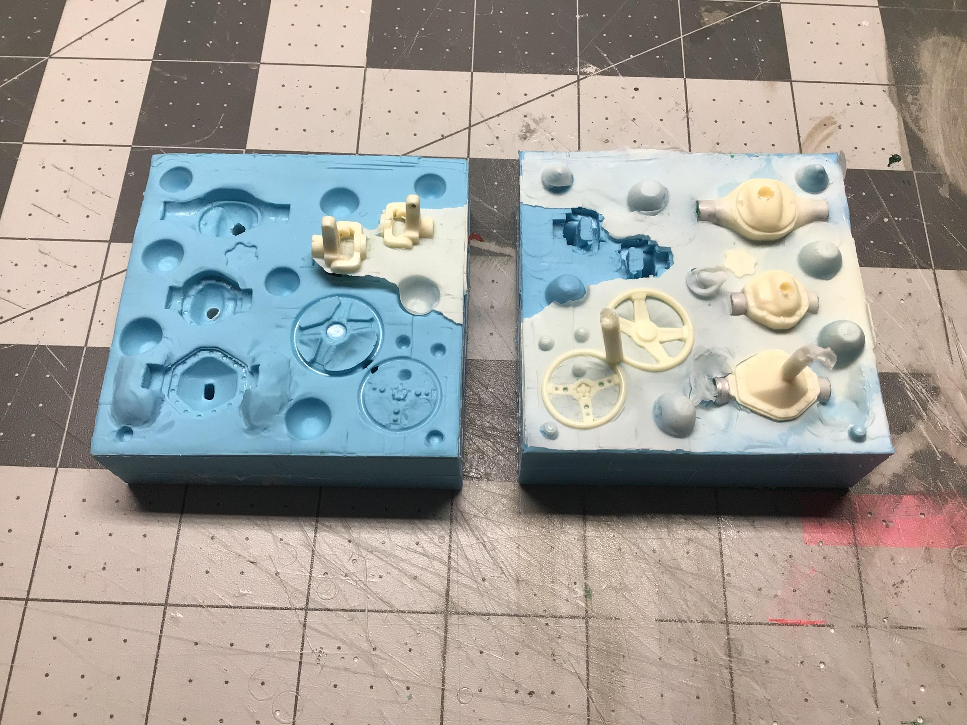

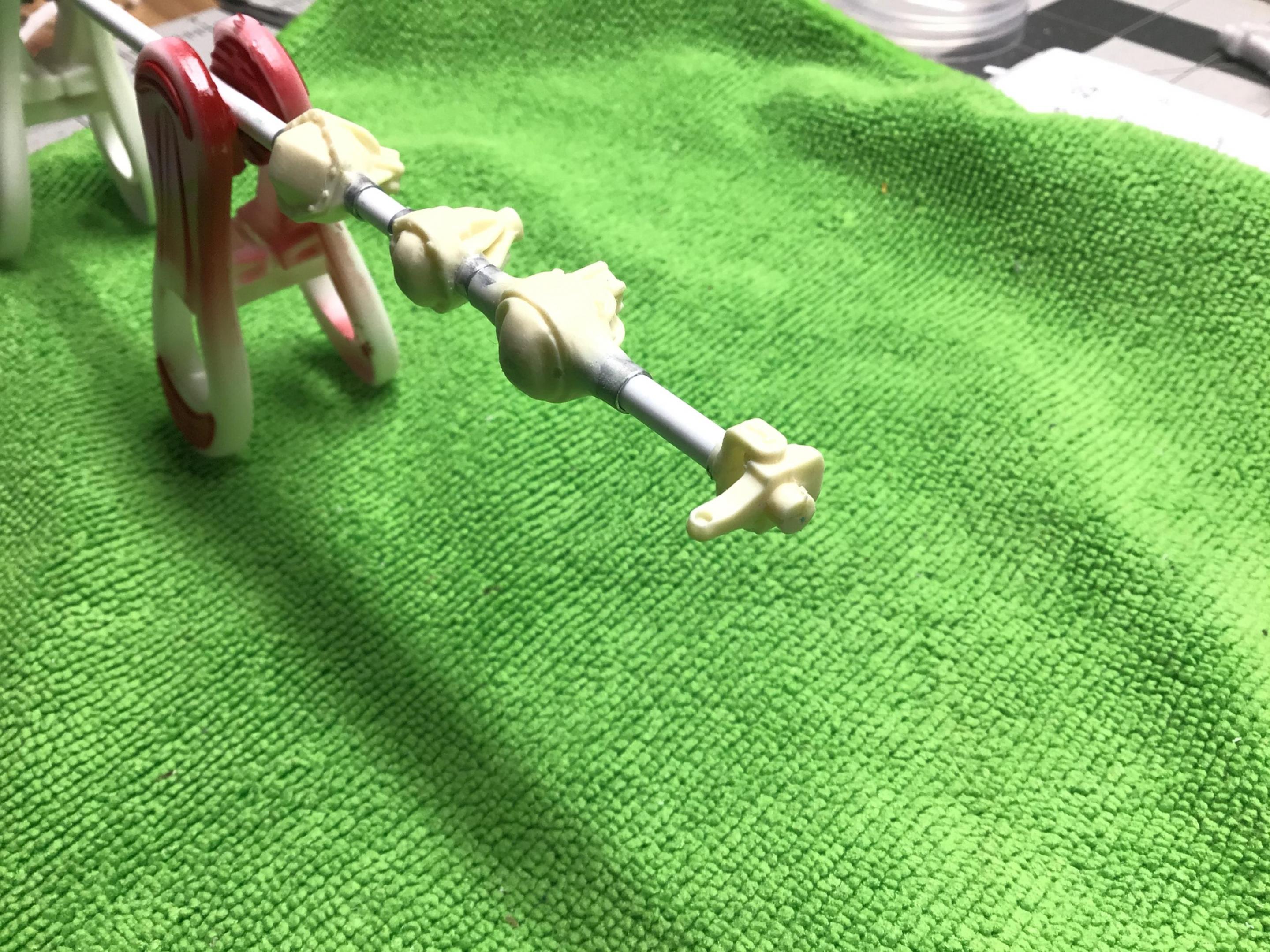

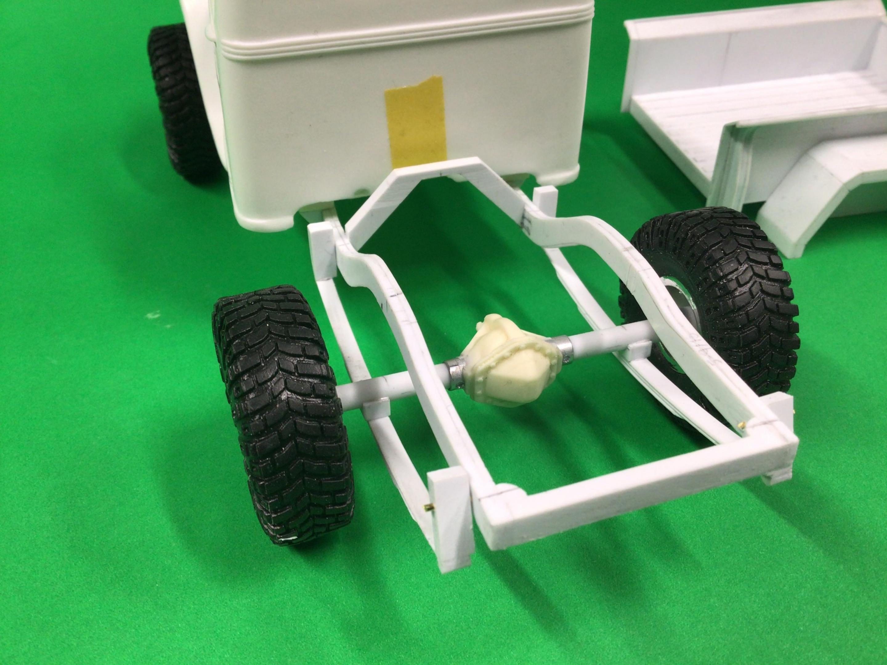

   I posted this as a daily accomplishment, but I figure more folks would see it here. I want to do a few custom 4x4 builds in the future so I came up with this idea to minimize duplicating my efforts. I’ve modified the Mobius F100 center sections (Dana 44 and Ford 9”) to take a 3/16” aluminum tube. This is 4” in 1/25 scale or 3-3/4” in 1/24th, which I think is not too far off. I hate all the spindly little axles found in most kits!  I also built a GM 14-bolt from scratch.
  I then made a mold so that I can cast the center section around the piece of tubing after temporarily plugging it with modeling clay to keep the resin out. A piece of .156 styrene tube will slide inside this and a piece of 3/32” rod (I use a coat hanger) for an axle. The diff can be left unglued until the rest of the drivetrain is in place to set the pinion angle. The F100 knuckles will be added to the front tube after being drilled for the metal axle.FCDF0B6E-5F79-4E79-A2C1-BBAA5B8FD3E9.thumb.jpeg.d92a3162d3b65a36b2630e35515b9a0b.jpeg9E817772-B766-4A9C-9D70-8D953B2D5FB4.thumb.jpeg.5cffb74dbe95711f7b2e775ed6b61275.jpeg25843F2B-991F-4BE8-B8B6-AEDC3097A6CF.thumb.jpeg.985734215c2515d320f64025cd338ace.jpeg9578FCFD-4D27-4D52-8B03-AEEFD60410D7.thumb.jpeg.246e5e8d93b7c0e9c3b4930a100b0b35.jpeg1BF5F6DC-CA02-40B8-B24E-04E6F1076C6C.thumb.jpeg.67e021f0182a6876fec5c01b96dfed39.jpeg60283AF1-EE88-4D61-8B77-A116B8A57E12.thumb.jpeg.115ffaf35227155a783b8194a6023446.jpegF9555BD2-A10B-41CD-BBB2-E88047B61101.thumb.jpeg.6e540a973cc35f5e3c9f2af51d592d92.jpeg
