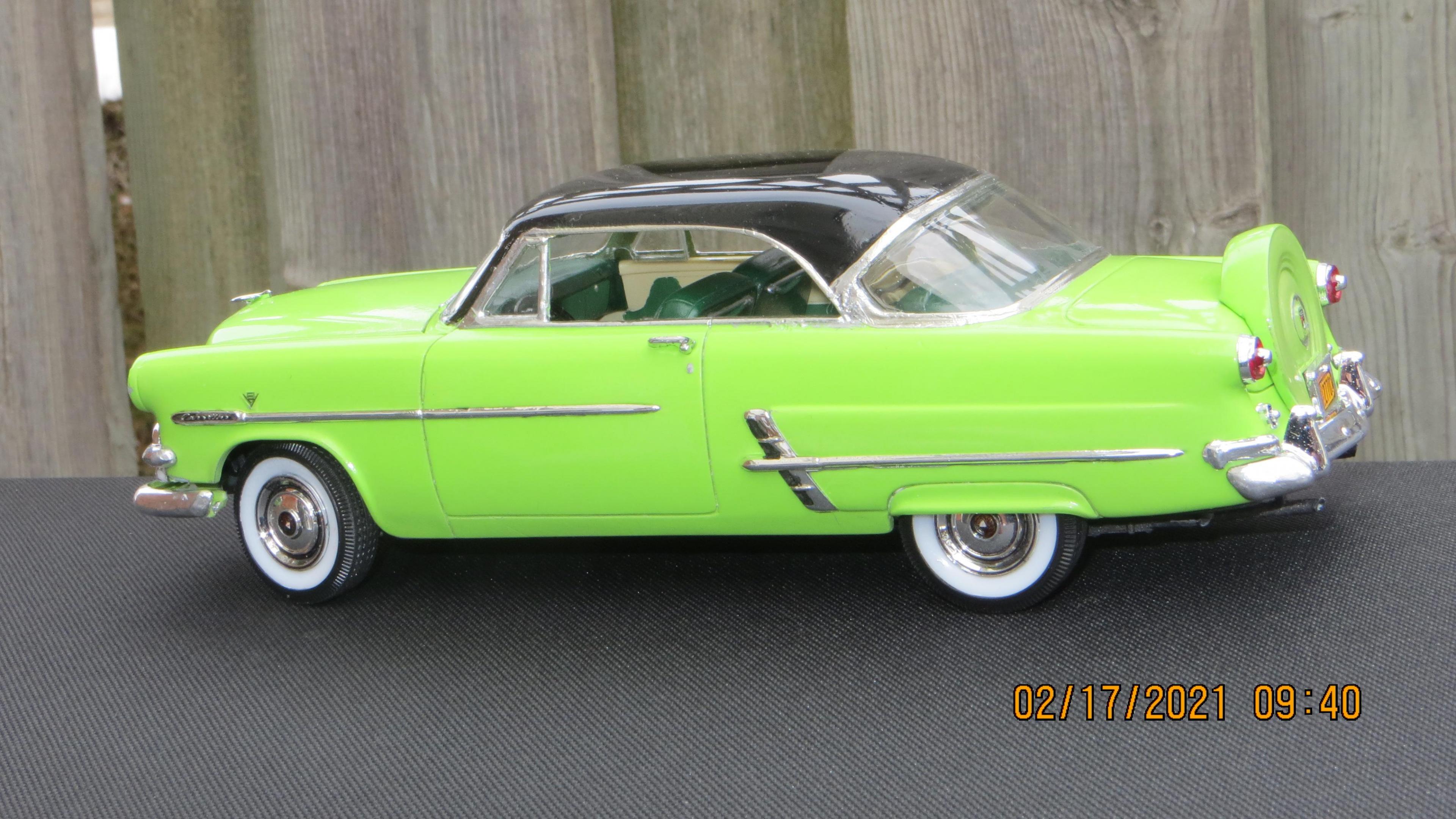

Bob Warfield Posted March 2, 2021 Share Posted March 2, 2021 I'm trying my best to glue on the chrome side trim without much luck. Early this morning I glued the very thin chrome strips on with white Elmers glue so as not to mess up one of my best paint jobs. A few minutes ago I tried to clean off a little excess glue and the trim popped right off. Before I pull out what little hair I have left can anyone give any tips on the correct way to do this? Thanks, Bob Quote Link to comment Share on other sites More sharing options...

Bob Warfield Posted March 2, 2021 Author Share Posted March 2, 2021 16 minutes ago, espo said: You might try the glue you use for all of the rest of your kits assembly. Be sure to remove the chrome plating from the mounting surface if you haven't already. These moldings are very thin and look to me like they would break very easily. How would you go about removing the chrome from only the back side? Quote Link to comment Share on other sites More sharing options...
espo Posted March 2, 2021 Share Posted March 2, 2021 I use a #11 blade to scrap the back side or use some sand paper. . You might want to place the trim face down on a micro fiber towel or some other surface that will not scratch the face of the molding. Go slow with real light pressure and you can press the molding against the towel and just sand a small section at a time. I usually put the glue in the grove so that you don't drop any on the body when you're installing the trim. You can also use some low tack tape to mask off the area around the grove if you're still afraid of glue getting out on the body. Quote Link to comment Share on other sites More sharing options...

peteski Posted March 2, 2021 Share Posted March 2, 2021 Elmers (and other similar PVA) glues are not designed to hold parts with smooth surface. They adhere to rought surfaces, like paper. Epoxy would likely work, but cleaning any extra glue would be tought. I like the idea of of taping the area around where the trim goes, so any extra glue would end up on the tape. But you should find a way to scrape the metalization from the glued areas. Maybe place the parts upside down on some soft surface (like a hobby cutting mat), then gently scrape the "plating" with a hobby knife. Quote Link to comment Share on other sites More sharing options...
StevenGuthmiller Posted March 3, 2021 Share Posted March 3, 2021 6 hours ago, GeeBee said: X2 X3. There is really no need for all of these contortions. The grooves in the body of the '53 Ford are quite deep. Mix up a little 2 part epoxy and lay some into the bottom of the groove. Allow the epoxy to tack up a little, (maybe 2 or 3 minutes) and then place the trim into the groove. If the epoxy is placed only in the bottom of the groove, (none on the sides) in a relatively thin application and allowed to tack up, there will be no glue squeezing out and therefore no excess glue to clean up. Once the epoxy cures fully, you'll have a tough time prying the trim out with a screwdriver! Steve Quote Link to comment Share on other sites More sharing options...
eastown Posted March 3, 2021 Share Posted March 3, 2021 I just used a small dab of C.A. glue applied with a toothpick in several spots in the cove where the chrome molding would go and that worked for me. Also I buy the cheapo Dollar Store nail files, hold nail file down and rub the chrome piece back and forth over the file to remove the chrome plating on the backside for more secure hold. Bob Quote Link to comment Share on other sites More sharing options...
